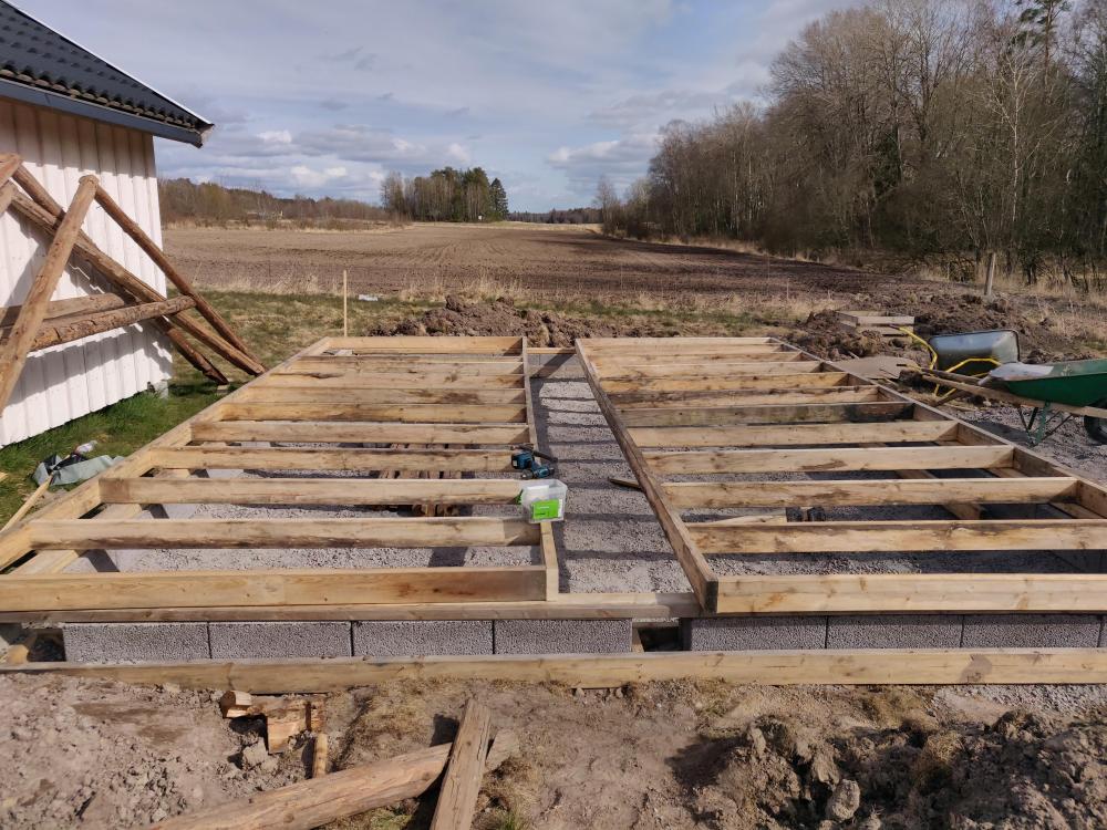

  15. Hello! Alright so the foundation is done and I began to puzzle the old frame but it just wouldn't work as the old sill was layed out right on the ground and then the studs were lenghtend after that. Sooo I had to frame it with some 145x45 studs. It's getting there alright!
  16. It's getting there. I've dug for the last two concrete blocks and leveled them and squared everything. It's off with about 5cm on one lenght but at this point I really don't care about that haha. Tommorow I'll get help to move the gravel you can see on the first photo.. the truck driver delivering the gravel put it pretty much as far away he could get even though I pointed him where to put the gravel closer to the foundation. I'll probably need about 20 more tons before it's all done.
