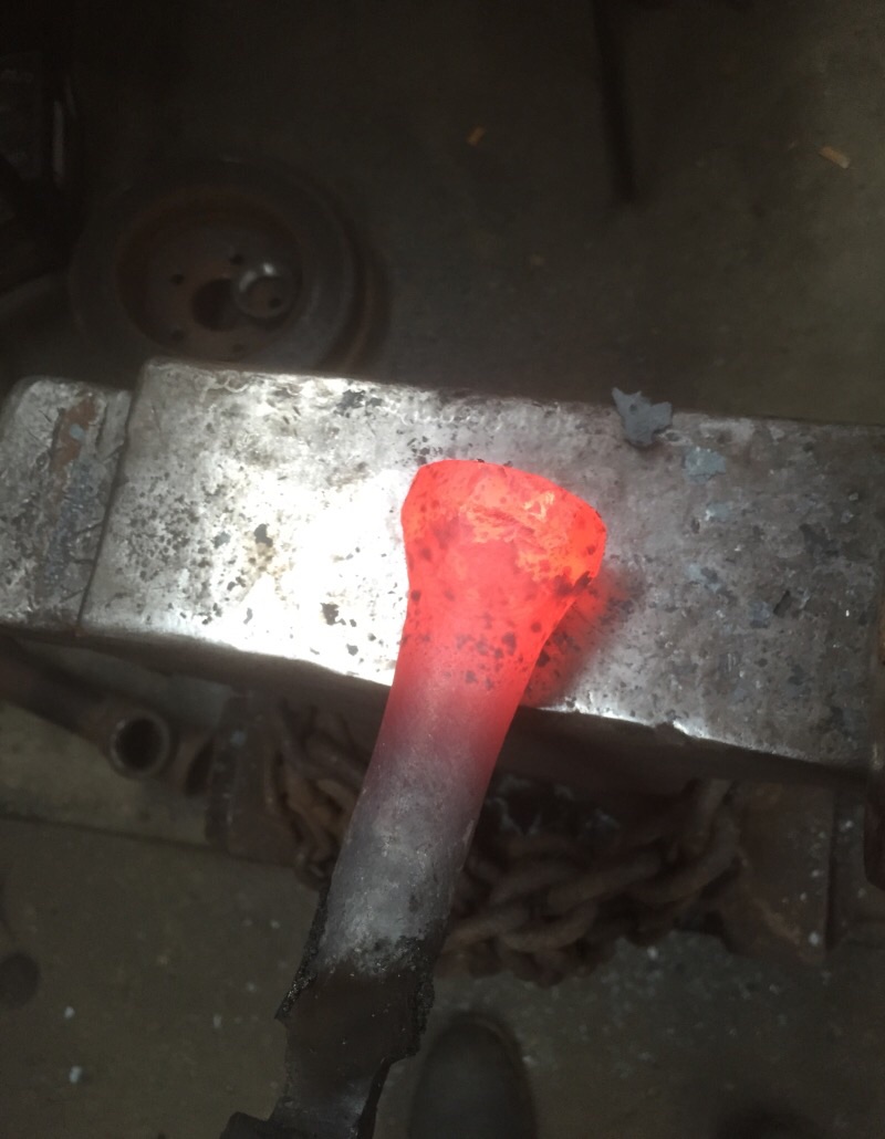

Daswulf Posted April 9, 2018 Share Posted April 9, 2018 Tried out my new demo forge other then the blower I plan to use that needs wired yet. Made a ball stake from a tortion bar for in the demo anvil. Tested out the bigger spring fuller and got a little over excited with it. As far as the ball stake: fit to length, upset the end part pretty well stoping to keep it round and even. Once upset to shape form the hardy hole end. Then start hammering in a circle making sure to go from top down around the edges. Stop once in a while to hammer the sharp edge on the outside into the meat of it and also tilt to drive the underneith in to prevent mushrooming, thenback to the top. Do that till you get a good uniform ball half or quarter. Done right it doesn't take much grinding. I also use a DA sander to clean up then with these I have been heating non magnetic then quenching the ball section in water slowly then some quick full dunks then wait and ball area again. ( yeah totally hokey) once almost fully cool dunk the whole thing to cool. That's working for me. I recommend better methods lol. So far with some cold hits on the ball stake ( this one stands just over 4-1/2" tall and under 2" wire at the top) and on trying out the demo forge both are great. Quote Link to comment Share on other sites More sharing options...
