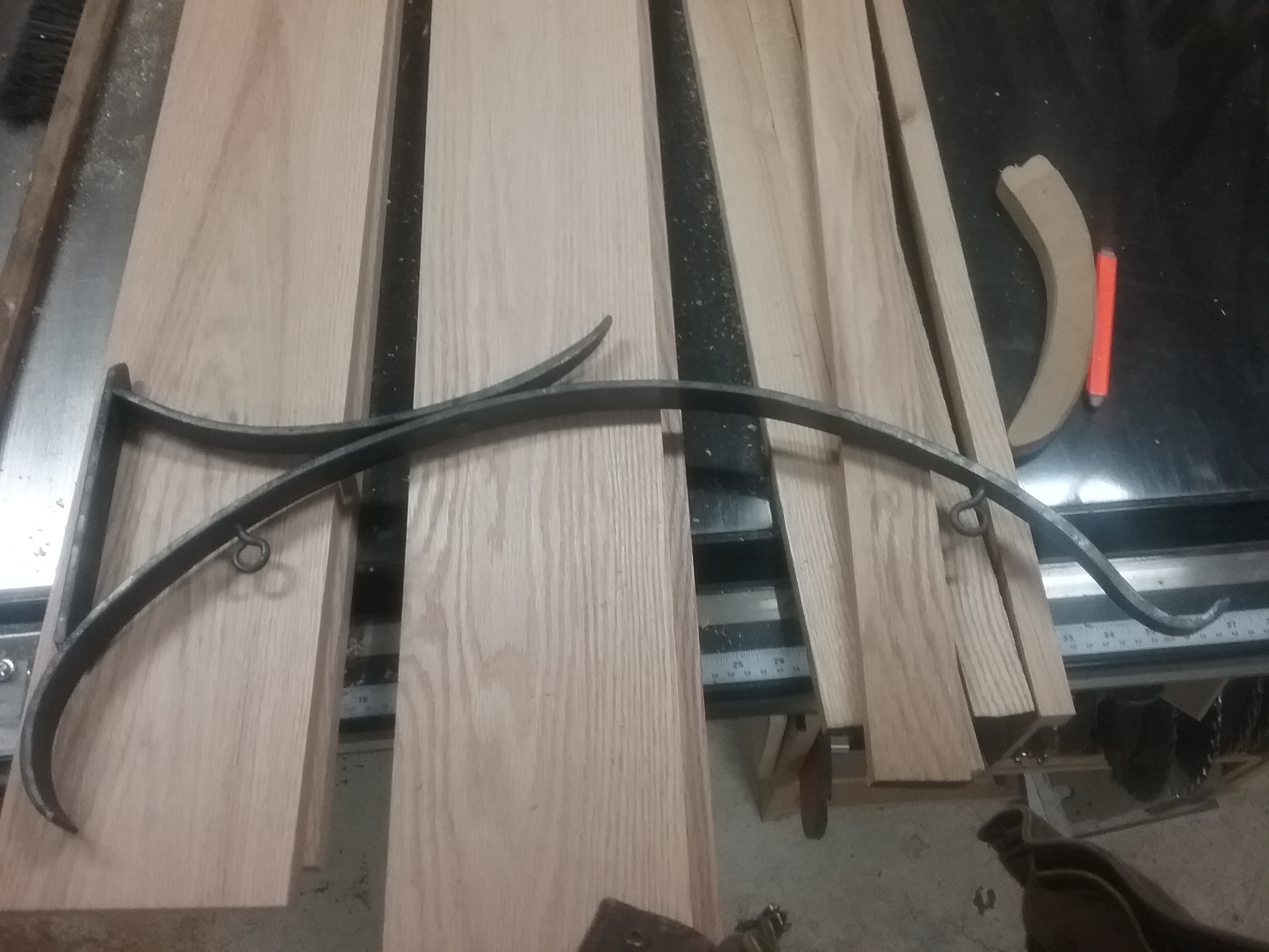

Jonah k Posted April 4, 2018 Share Posted April 4, 2018 Built this sign hanger for our timber frame entrance to cover some of the less than ideal jointery at the peak. Oops. Oh well this tuned out alright Quote Link to comment Share on other sites More sharing options...
C-1ToolSteel Posted April 4, 2018 Share Posted April 4, 2018 Nice work, Jonah. Great lines. Quote Link to comment Share on other sites More sharing options...

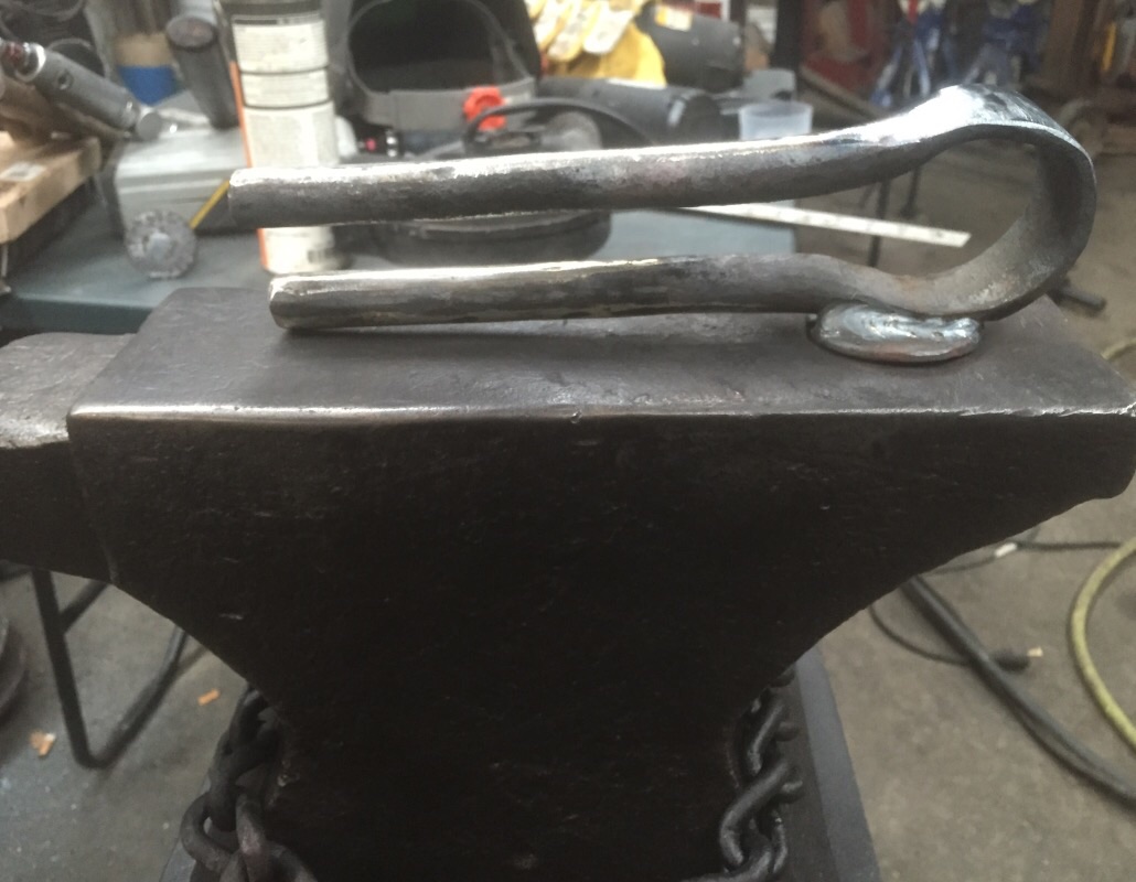

Daswulf Posted April 4, 2018 Share Posted April 4, 2018 Nice hanger Jonah. Realized I needed some tooling for my 100lb. demo anvil with its smaller 3/4" hardy hole. Made a 3/4"spring fuller, and started a 1/2" spring fuller. Quote Link to comment Share on other sites More sharing options...
Glenn Posted April 4, 2018 Share Posted April 4, 2018 If you make tooling for the smaller hardie hole, you can make a sleeve to make that tooling fit a larger hardie hole. Anvil specific tooling, and you will always be lacking a full set of tooling for the other anvil. Quote Link to comment Share on other sites More sharing options...
ausfire Posted April 4, 2018 Share Posted April 4, 2018 Nice clean weld there, Das. Quote Link to comment Share on other sites More sharing options...
Daswulf Posted April 4, 2018 Share Posted April 4, 2018 4 hours ago, Glenn said: Anvil specific tooling, and you will always be lacking a full set of tooling for the other anvil. Some tooling I can use in the vise. Spring fillers just work best on the anvil. Not that they couldn't be made to work in the vise. Yeah, I can make sleeves for my other anvils for these tools. Aus, it's all about the gas and settings. Quote Link to comment Share on other sites More sharing options...
