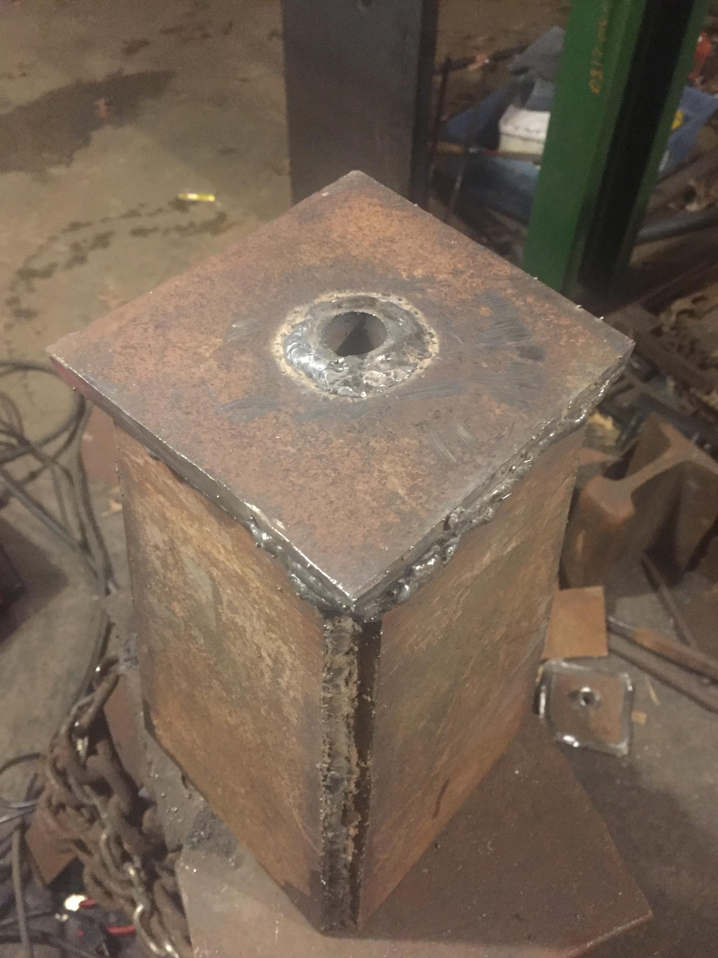

JHCC Posted April 17, 2018 Share Posted April 17, 2018 Got the end of the tuyere cut off, cut a new faceplate, and started drilling out the hole for the air pipe. After several frustrating hours of coaching my ASD son through his homework, it was a relief to get into the shop. Quote Link to comment Share on other sites More sharing options...
JHCC Posted April 18, 2018 Share Posted April 18, 2018 Welded up the new faceplate for the tuyere. Tight as a drum! (Oh, and remember that yarn bowl I made for Lisa? She took it to a knitting group, and now the owner of the yarn shop wants to carry them.) Quote Link to comment Share on other sites More sharing options...

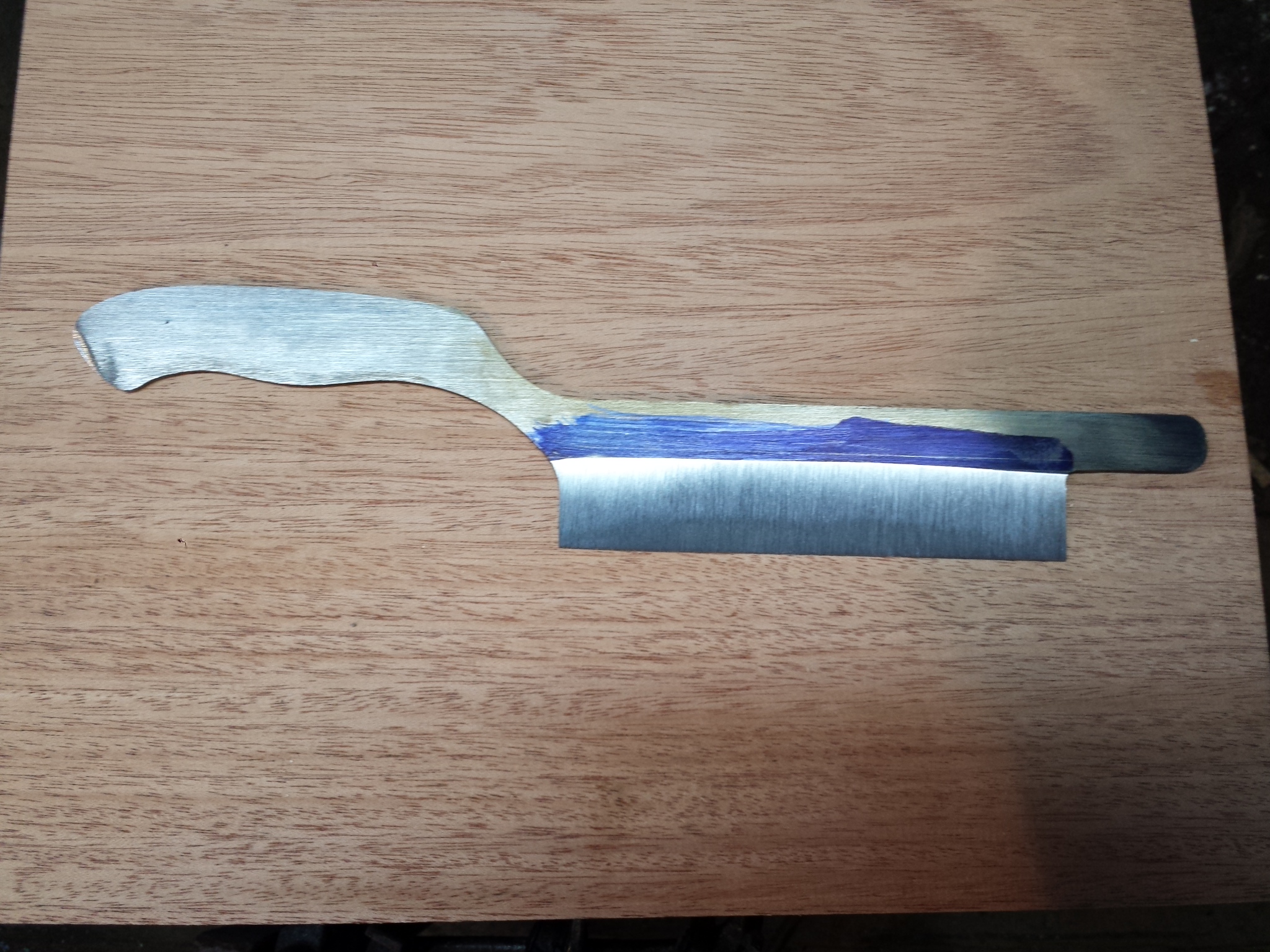

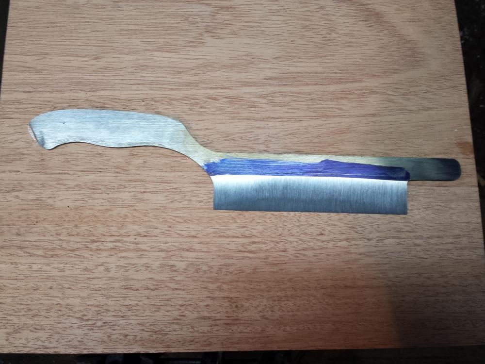

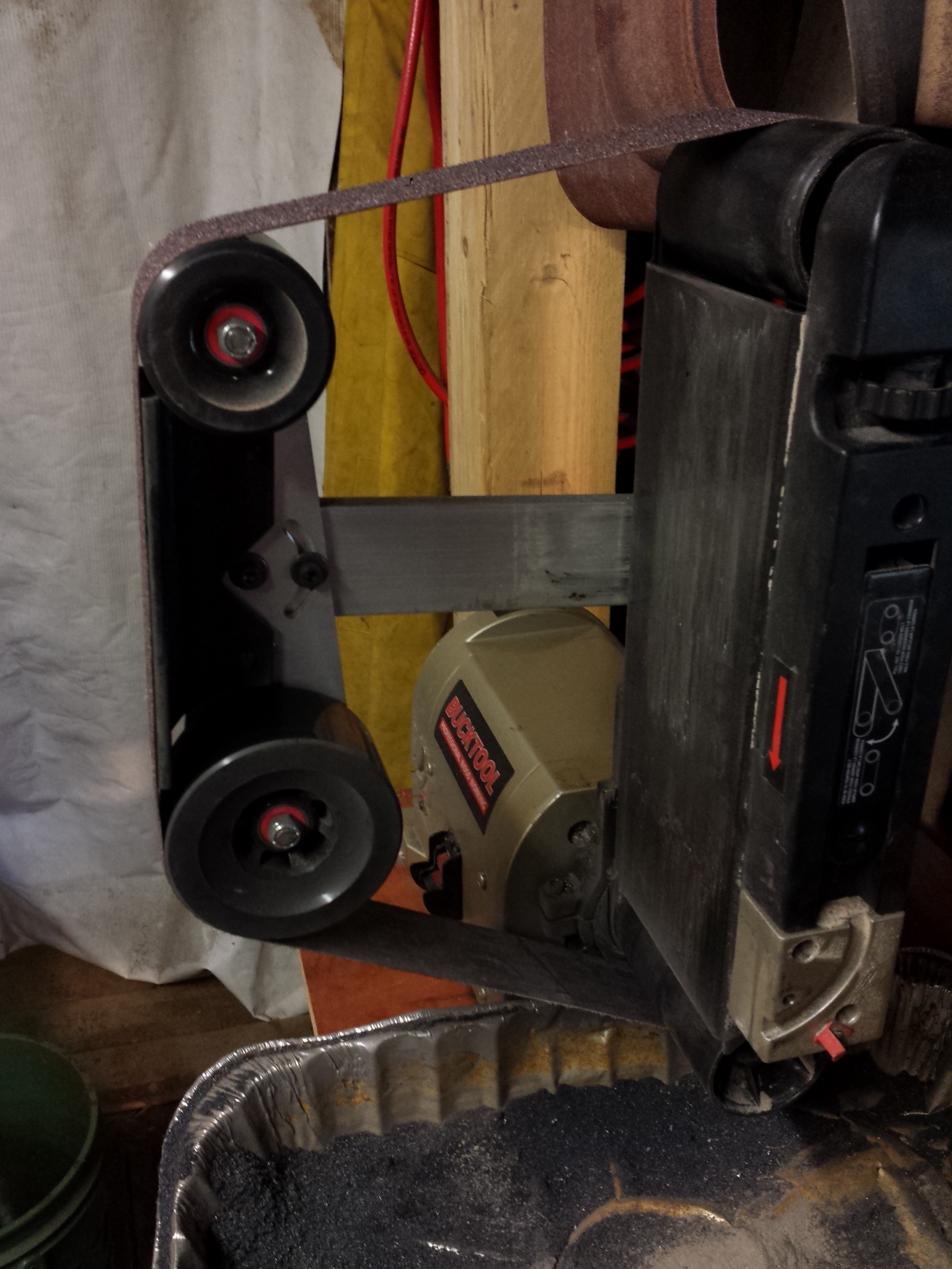

sfeile Posted April 18, 2018 Share Posted April 18, 2018 Got my new grinding attachment hooked up, and got the blade of the tobacco plug cutter I started ground down and ready for holes and heat treat. Quote Link to comment Share on other sites More sharing options...

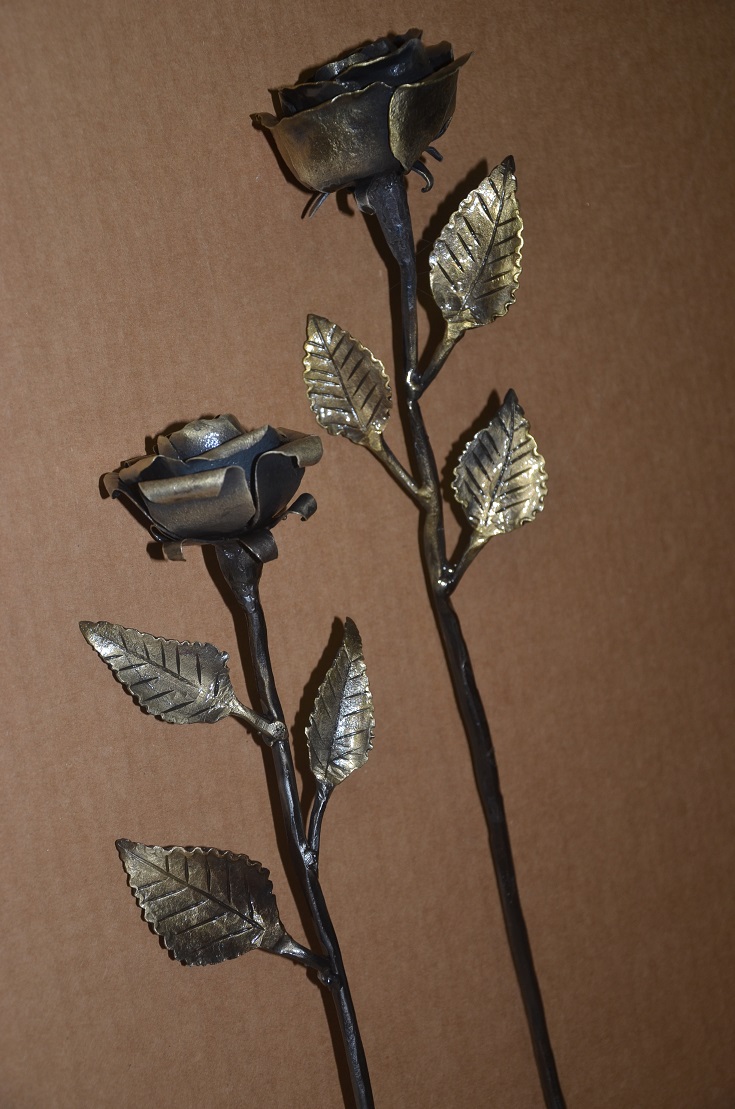

ausfire Posted April 19, 2018 Share Posted April 19, 2018 A guy came by and wanted a steel rose to give to his wife for their wedding anniversary. Made a couple: Quote Link to comment Share on other sites More sharing options...

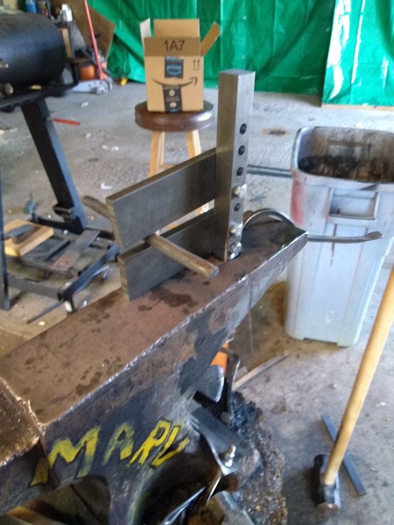

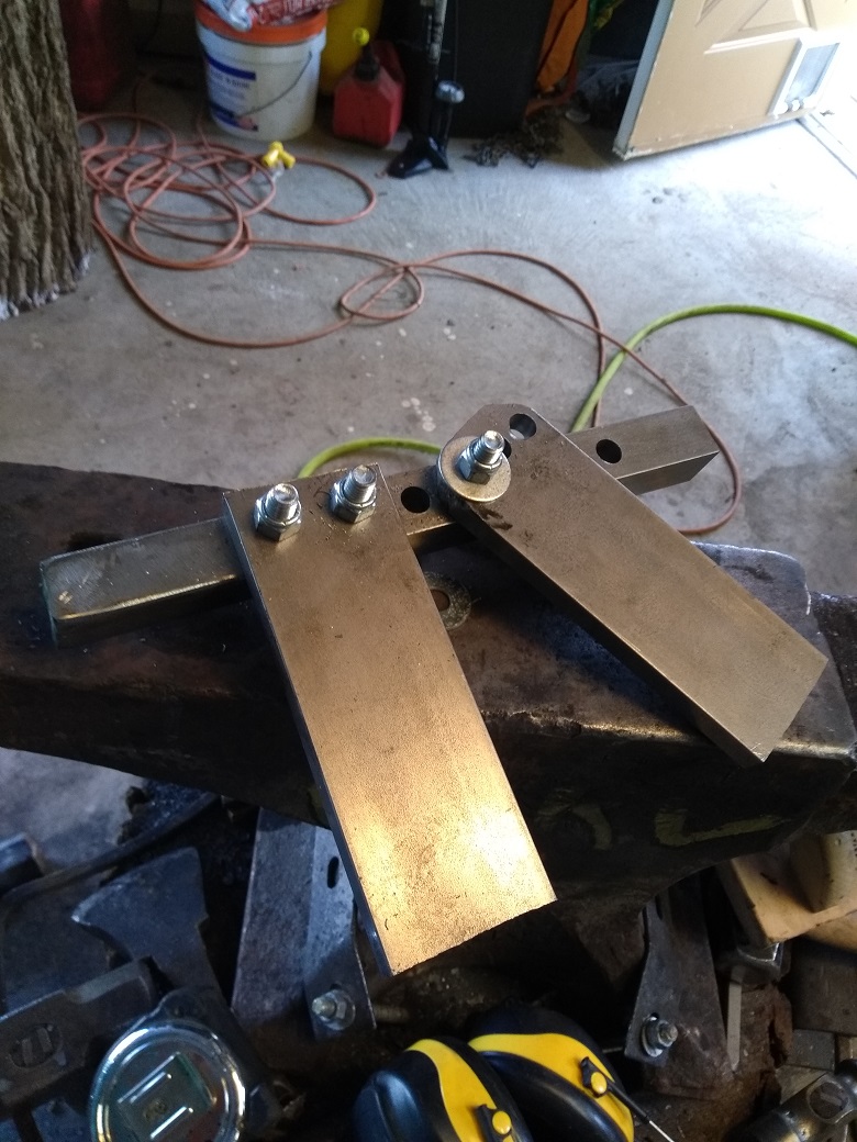

MotoMike Posted April 19, 2018 Share Posted April 19, 2018 Built a fullering tool. Not sure if it has a name, but plan on using it like a spring fuller. I have not yet rounded the dies. considering leaving a flat section as well. with the staggered spacings I can get from about 1/4 up to 5 inches in 1/2 inch increments. Quote Link to comment Share on other sites More sharing options...
Lou L Posted April 20, 2018 Share Posted April 20, 2018 On 4/17/2018 at 9:55 PM, JHCC said: Welded up the new face plate for the tuyere. Tight as a drum! What is the diameter of the hole in the faceplate? Mine is a bit too small at 5/8”. I have since learned that between 3/4” and 1” is better and matches traditional designs. Quote Link to comment Share on other sites More sharing options...
jlpservicesinc Posted April 20, 2018 Share Posted April 20, 2018 from what I have read.. The tube inside the Tue iron should taper from about 3" down to the 1-1.25" thus increasing the velocity of the air as well.. there is a ratio for a traditionally designed blower.. If you completely close off the air duct the blower will become super easy to turn as the fan blades just egg beat the air inside.. Yet if you open the end of it completely to atmospere, it will get quite a bit harder vs having it connected to the tuyere in regular fashion.. I always thought it was pretty neat.. I based the opening on the side blast I made years ago on this factor.. Bottom blast vs side blast that is.. Quote Link to comment Share on other sites More sharing options...

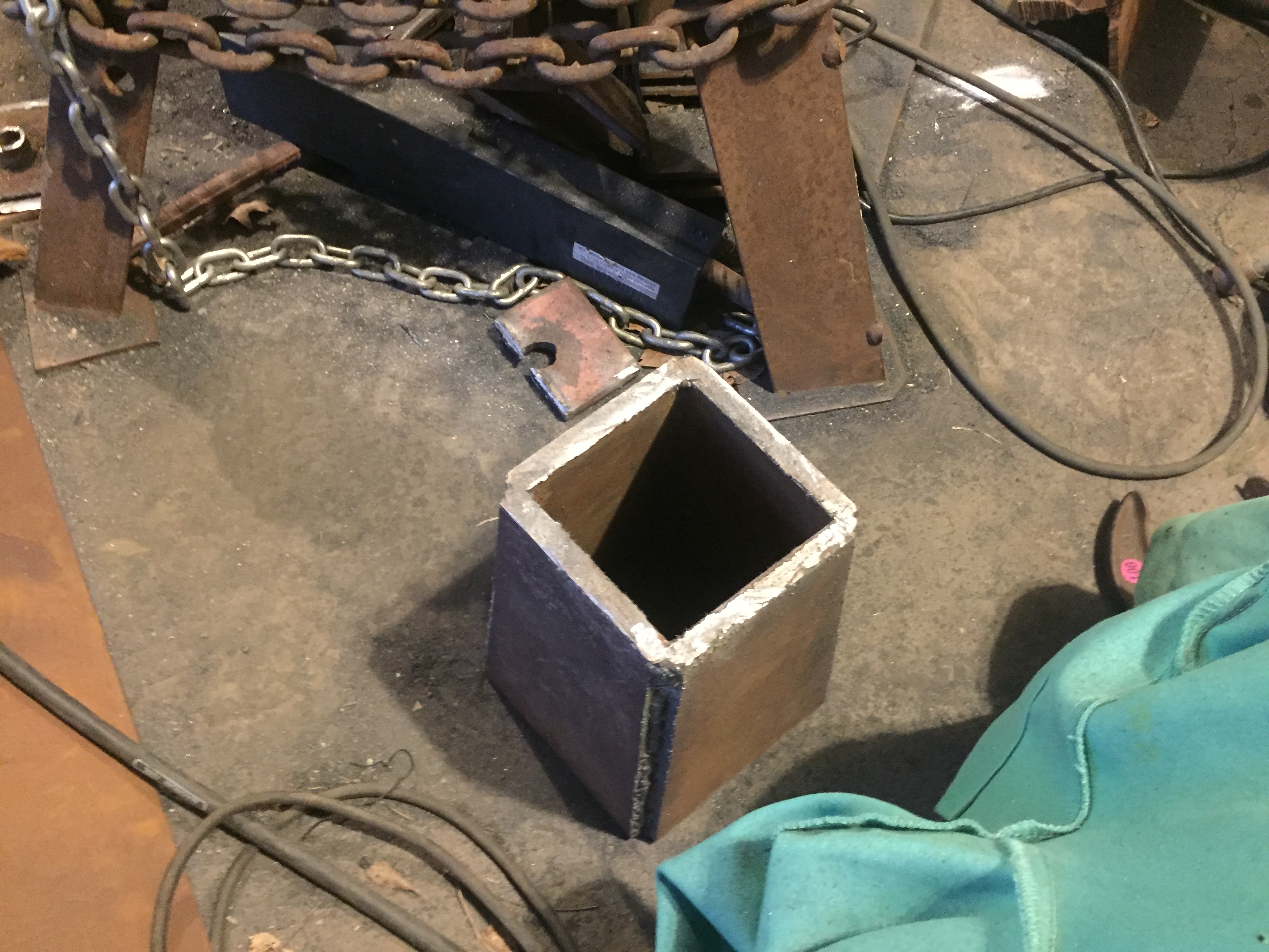

JHCC Posted April 20, 2018 Share Posted April 20, 2018 Welded on the base of the bosh. 34 minutes ago, Lou L said: What is the diameter of the hole in the faceplate? Mine is a bit too small at 5/8”. 13/16”. Quote Link to comment Share on other sites More sharing options...

Lou L Posted April 20, 2018 Share Posted April 20, 2018 Nice...I’m envious. As an aside, the walls of your tuyere shroud are much thicker than mine. I built a bosh that can hold 20 gallons of water because everything I read said it was necessary. However, even with the thinner walls my water never boils and I only keep it about 1/3 full. You don’t need to make a huge bosh unless, of course, you plan on using it for making soup. Quote Link to comment Share on other sites More sharing options...
JHCC Posted April 20, 2018 Share Posted April 20, 2018 8 minutes ago, jlpservicesinc said: JHCC are you going to do a complete redesign on the JBOD? I’m seriously thinking about it. My steel supplier has some big chunks of sheet that I can get for cheap (before Lisa spends our whole tax refund on yarn). I could just put the new tuyere into the JABOD, but I’m more and more tempted to seize the opportunity to build an all-steel forge. 13 minutes ago, Lou L said: I built a bosh that can hold 20 gallons of water because everything I read said it was necessary. The one I have planned will hold about 12 gallons. That’s not including the tuyere itself, which holds another two. So long as I don’t let it boil out completely, I should be fine. 17 minutes ago, Lou L said: You don’t need to make a huge bosh unless, of course, you plan on using it for making soup. That’s why I have a slow cooker. Quote Link to comment Share on other sites More sharing options...

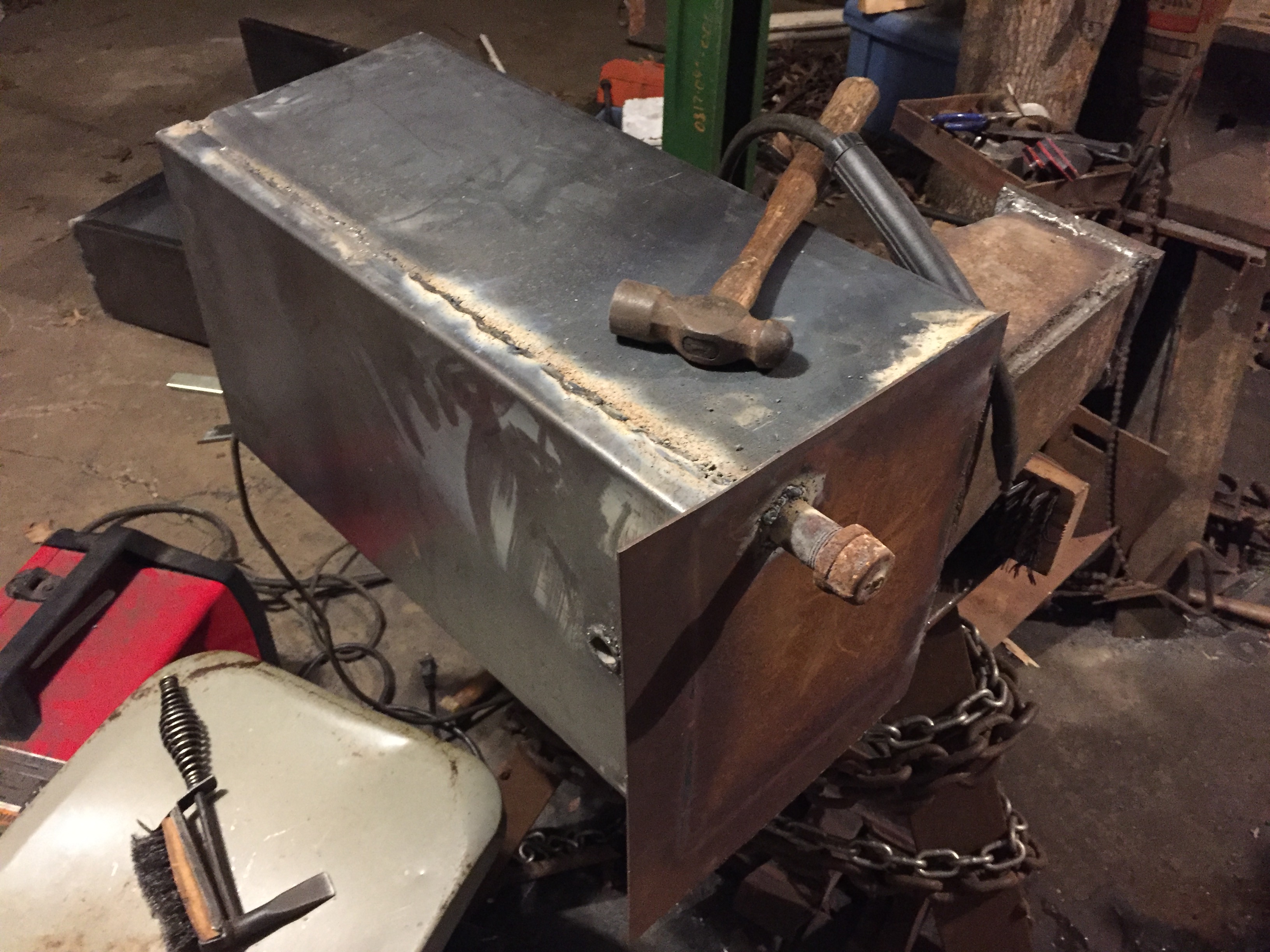

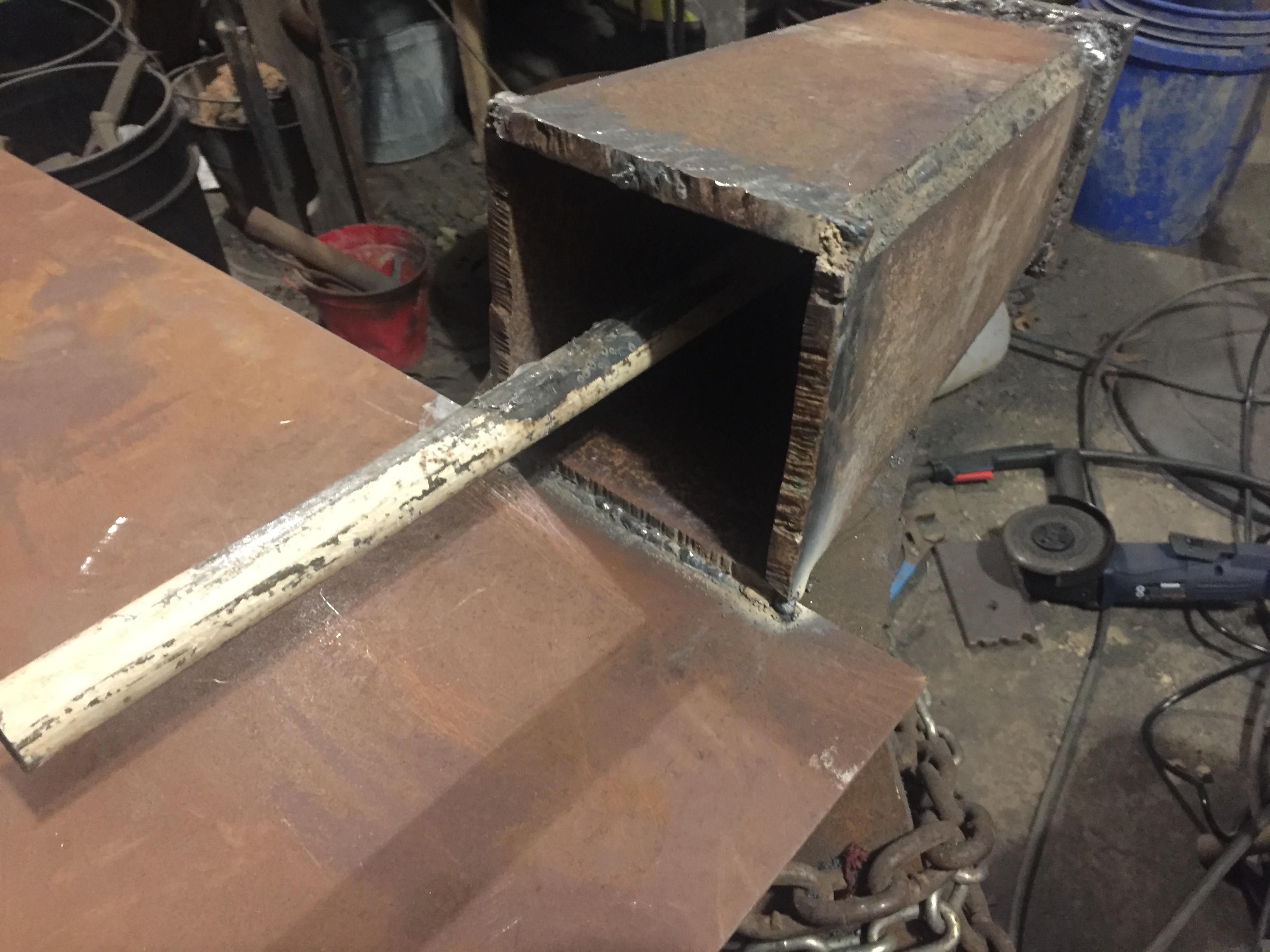

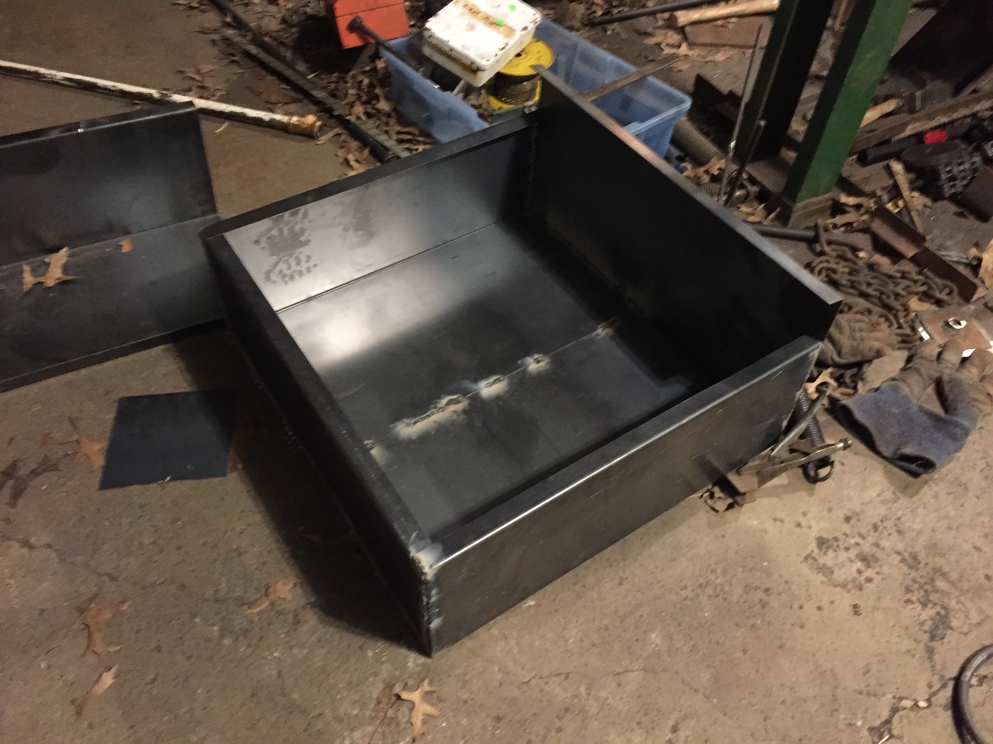

JHCC Posted April 21, 2018 Share Posted April 21, 2018 Significant progress. The tuyere and bosh are almost entirely welded up, although I haven’t yet checked for leaks. That bit of pipe is for the drain and will have a valve screwed on later. I’ll probably go Lou’s route of caulking the tank with silicone. Also made the decision to go ahead with a new forge. Bought the metal and welded up the pan. Quote Link to comment Share on other sites More sharing options...

JHCC Posted April 21, 2018 Share Posted April 21, 2018 3 hours ago, Stitch said: Those welds are looking way better John! That one weld on the tank is actually the worst on the whole project: it seems like all the problems that could have cropped up on the others were saving themselves for this one. I think I’m going to have to weld over it a few times to get it acceptable. This project is the first time I’ve welded sheet, and it’s definitely a learning experience. 3 hours ago, Stitch said: How many miles of wire have you gone through as of yet? Not sure, but that 10 pound roll of .035 flux-core was definitely a good investment! Quote Link to comment Share on other sites More sharing options...

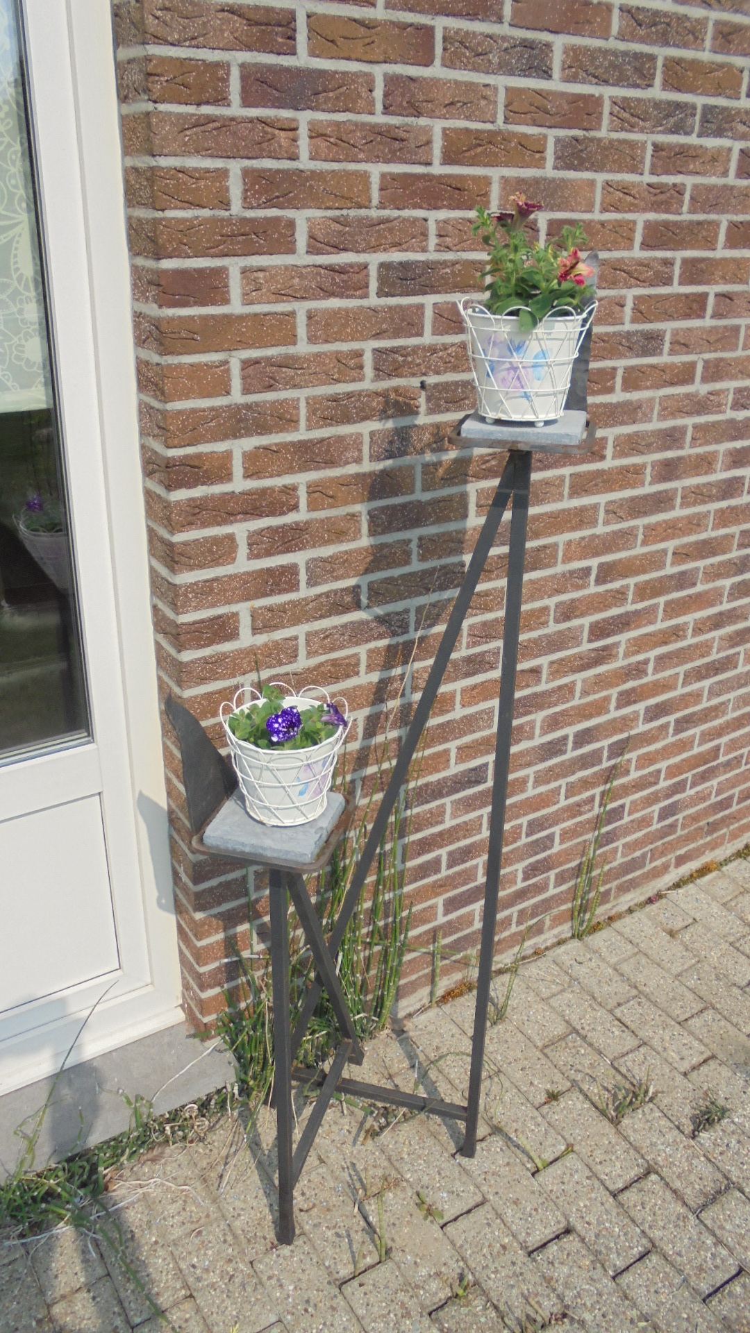

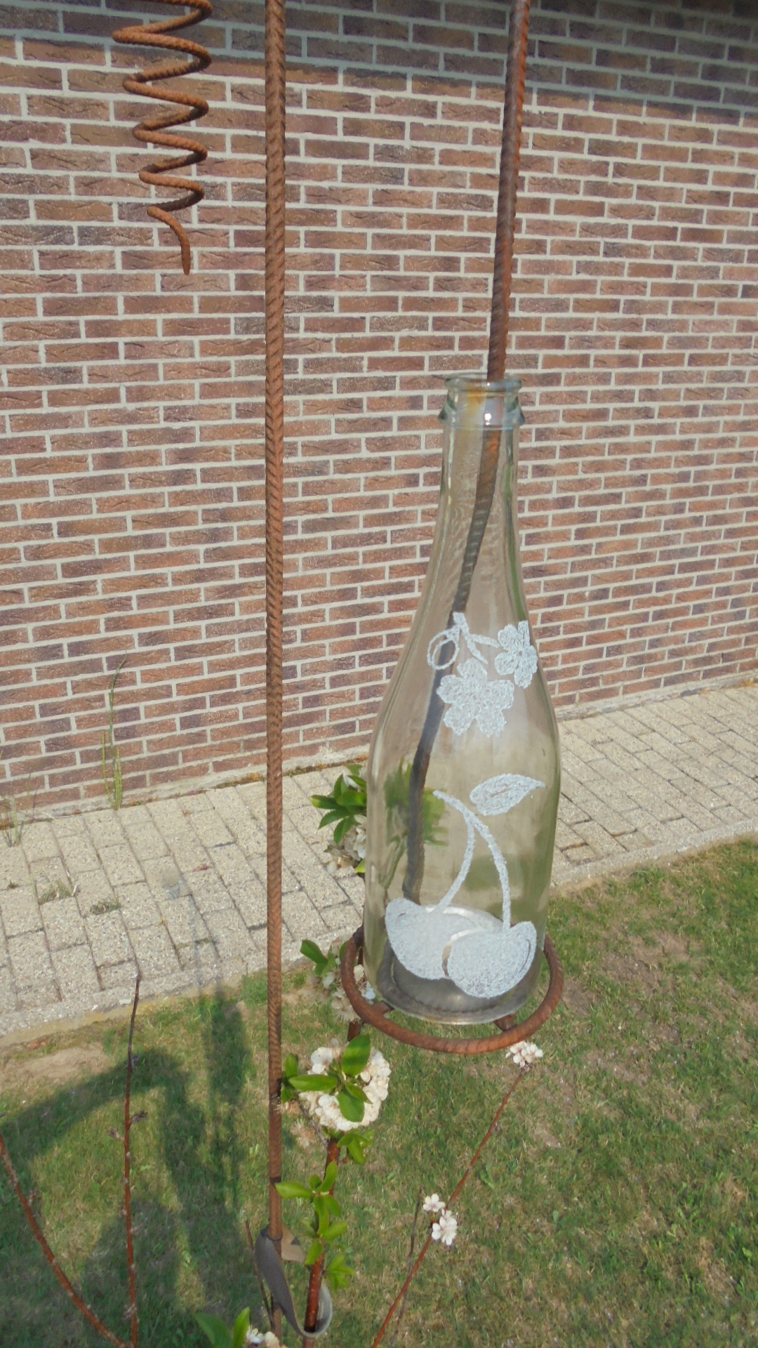

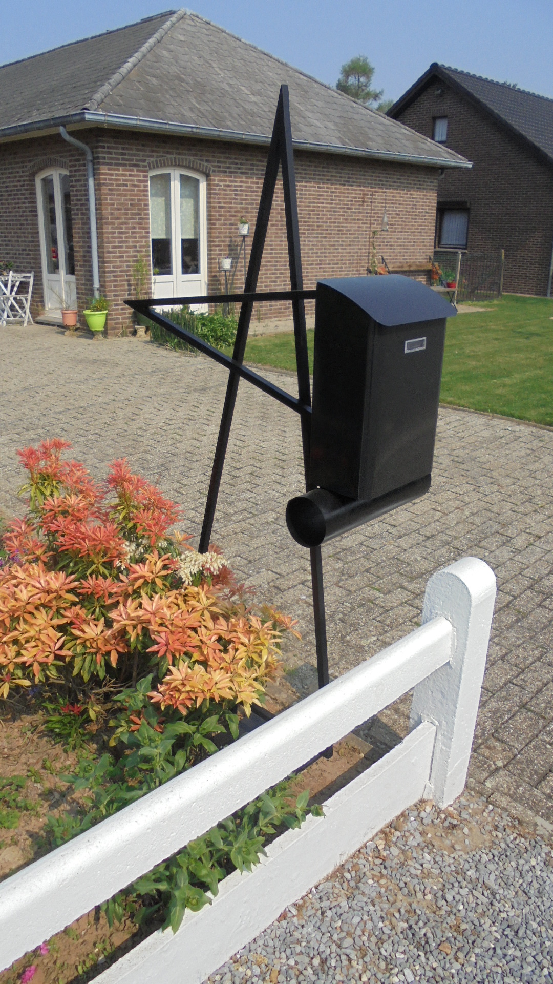

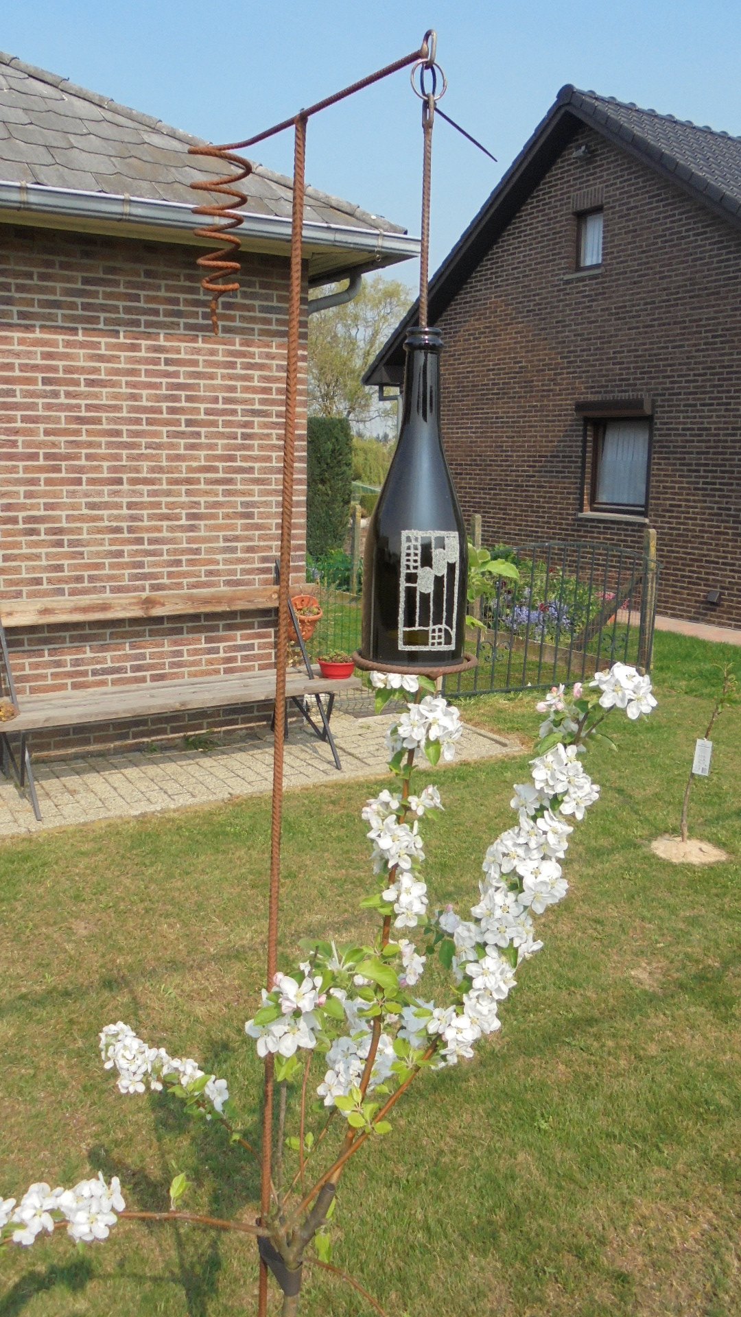

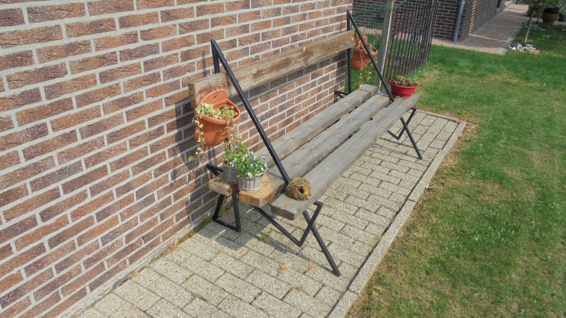

Hans Richter Posted April 21, 2018 Share Posted April 21, 2018 Hi Gents, a ride with the Lambretta accompanied from Lisa, trough acres of orchard in full blossom made me feel ‘triangular’. I create a new mailbox stand how fits by the already made plant stand and garden bench. Guys the world is beautiful. Cheers, Hans Quote Link to comment Share on other sites More sharing options...
bubba682 Posted April 21, 2018 Share Posted April 21, 2018 The Lambretta brings back memories of Germany and Denmark and the cafe's havin a beer watchin the bikes go by.... Quote Link to comment Share on other sites More sharing options...
Daswulf Posted April 21, 2018 Share Posted April 21, 2018 3 hours ago, JHCC said: This project is the first time I’ve welded sheet, and it’s definitely a learning experience. Yeah you need to dial it it just right on sheet metal. To hot and you'll burn through. Not not enough and you don't get the penetration and have a bigger bead on the outer surface. It'll help to use scrap pieces to test on and dial it in before you go to the main piece. Stitch, Hans, cool stuff ! Quote Link to comment Share on other sites More sharing options...
JHCC Posted April 21, 2018 Share Posted April 21, 2018 38 minutes ago, Daswulf said: Yeah you need to dial it it just right on sheet metal. My biggest problem has been how much it’s been moving around, and what fit nicely before welding gets out of whack mid-weld. I’m seeing the wisdom of welding clamps. Quote Link to comment Share on other sites More sharing options...
Daswulf Posted April 21, 2018 Share Posted April 21, 2018 Ah, there's the other fun part of welding sheet. Keep it as cool as possible to keep from warping. Get the pieces lined up and just tack it together then stitch weld it Skipping areas and moving to another area while the last one cools, then back again. Quote Link to comment Share on other sites More sharing options...

BIGGUNDOCTOR Posted April 21, 2018 Share Posted April 21, 2018 The other issue is shrinkage of the weld bead. As it cools it shrinks and pulls the two pieces together. Size of bead, thickness of the items being welded, alloy (stainless is really squirrely), all affect the outcome. Peening the welds will spread them out and help to flatten things backout. I have seen that done by old school body and fender guys to keep a car panel straight. For sheet I liked .023" bare wire with a gas. Quote Link to comment Share on other sites More sharing options...

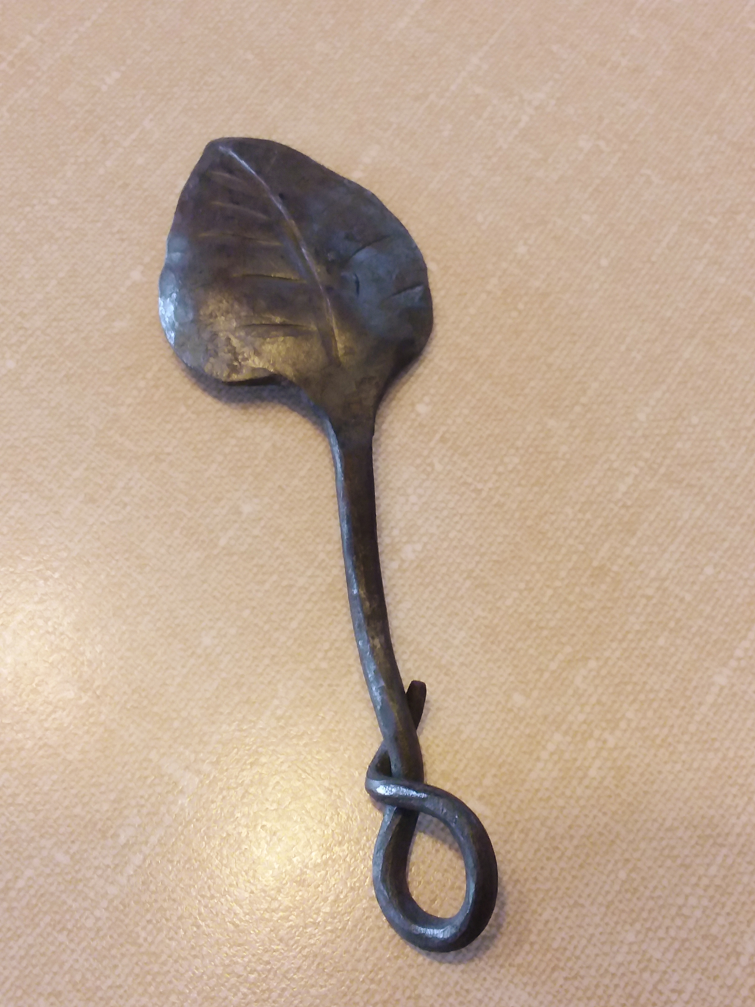

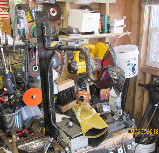

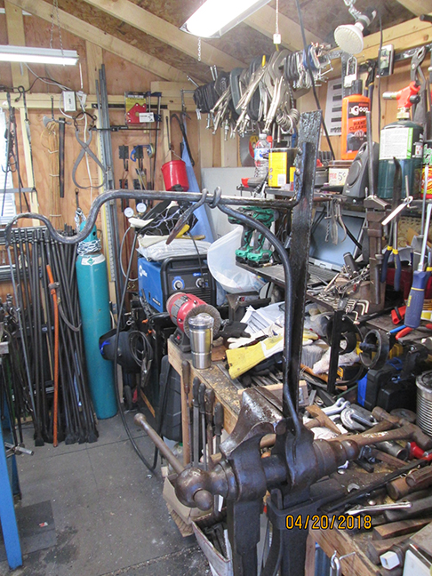

Arthur210 Posted April 21, 2018 Share Posted April 21, 2018 Cut side slots on my JABOD. Shortened the reins on a pair of tongs. Finally, made my first leaf: I really should have made myself a chisel first. As it is, I used the side of my coal rake to make the veins. A small-diameter fuller would also be useful, since the edges of my anvil are a bit too rounded for a sharper transition between the leaf and the stem. Still, that was a satisfying first attempt. Quote Link to comment Share on other sites More sharing options...
