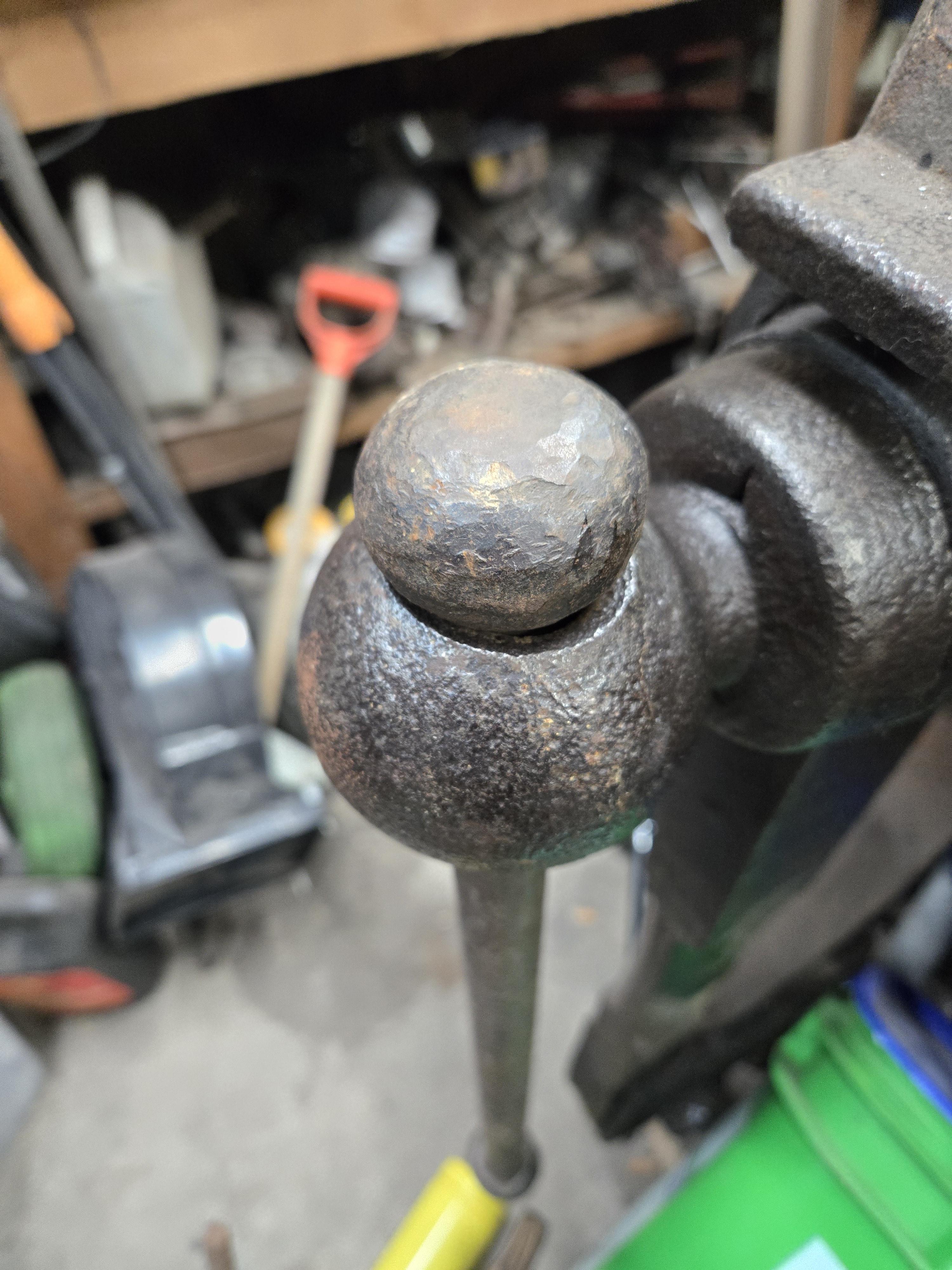

I did ball ends on a new handle for my big vise by upsetting. Yeah, it was a bear. Especially the second side with the screw attached. Yeah, I deffinately did it the hard way but I was proud of my work.

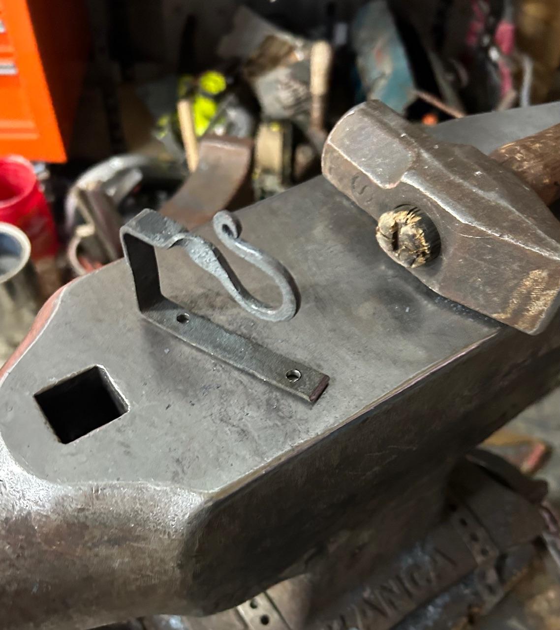

Super cool skulls and I feel you Goods. I made a little hook while heat treating a couple blades and some other experiments.
Cool hook Rojo.
Just to say on the post vise ball ends, the stock was one inch round and there was more room in the screw opening but it works fine.

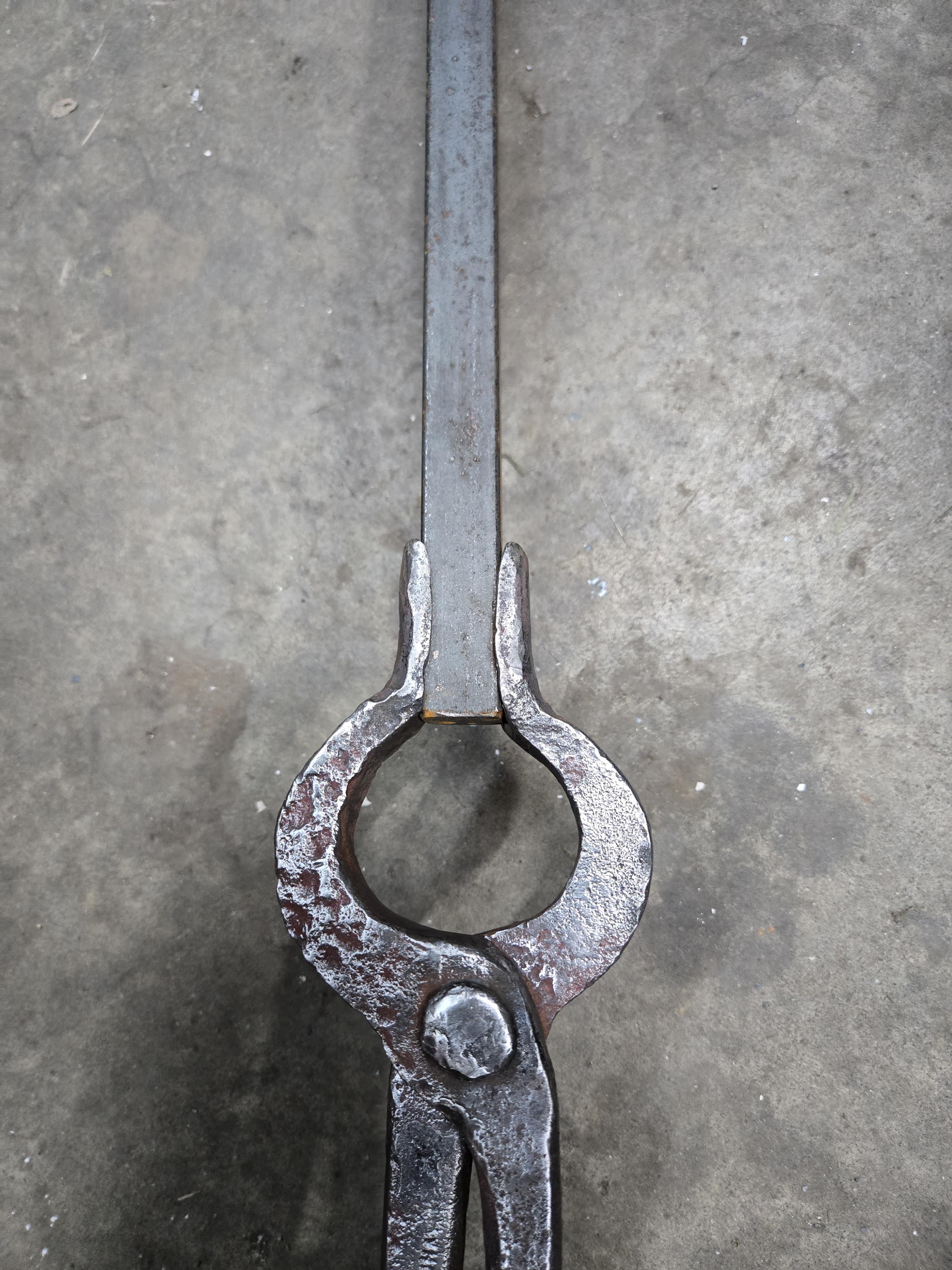

I needed a pair of tongs to hold 1inch, so I modified an old pair meant for 3/4" round.
Dang Das, you made those by upsetting? Nice job. I would have went the easy route and welded a collar on the ends.
Now you tell me.. :lol:
I don't know, I just wanted to do it this way.

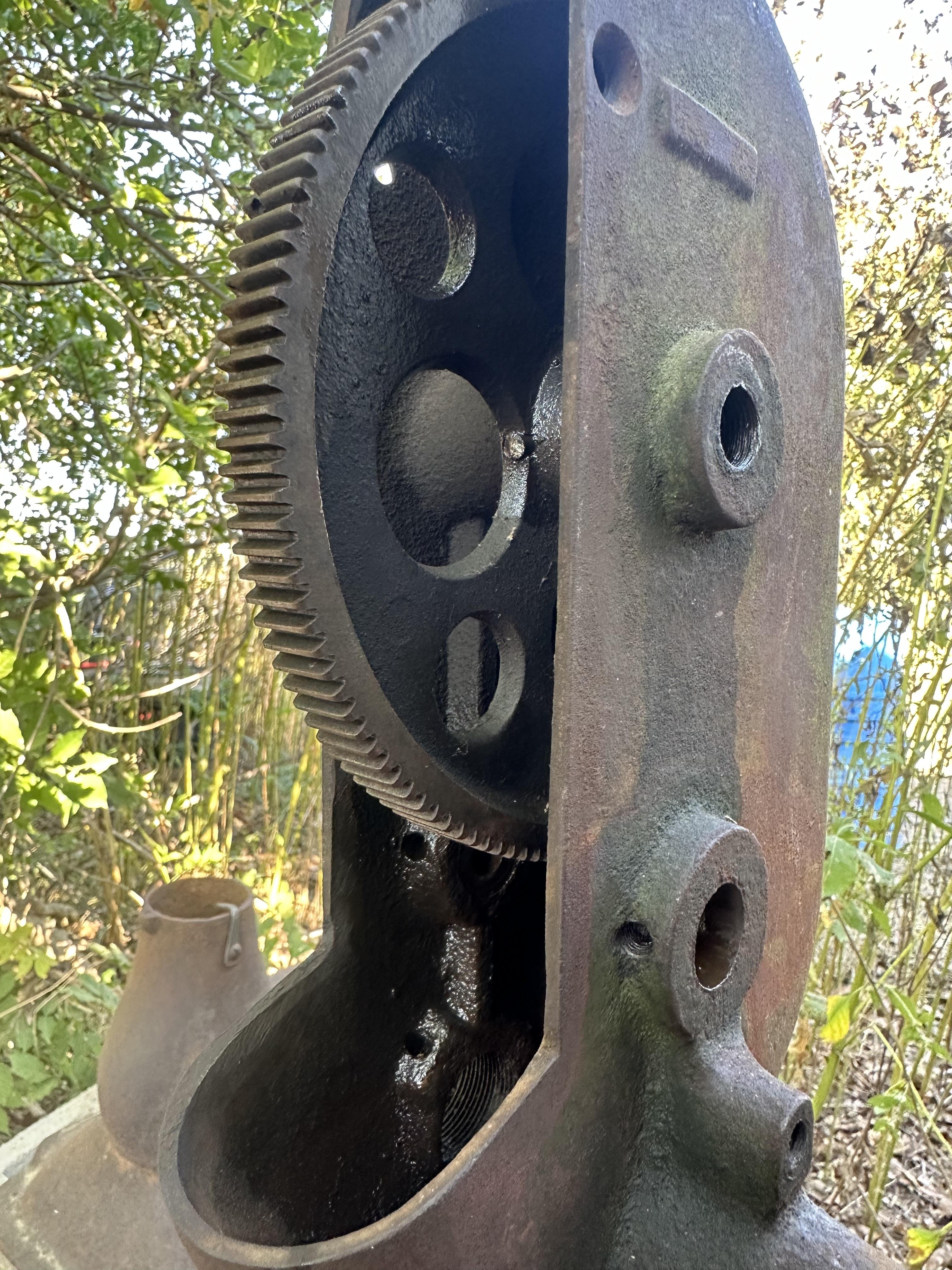

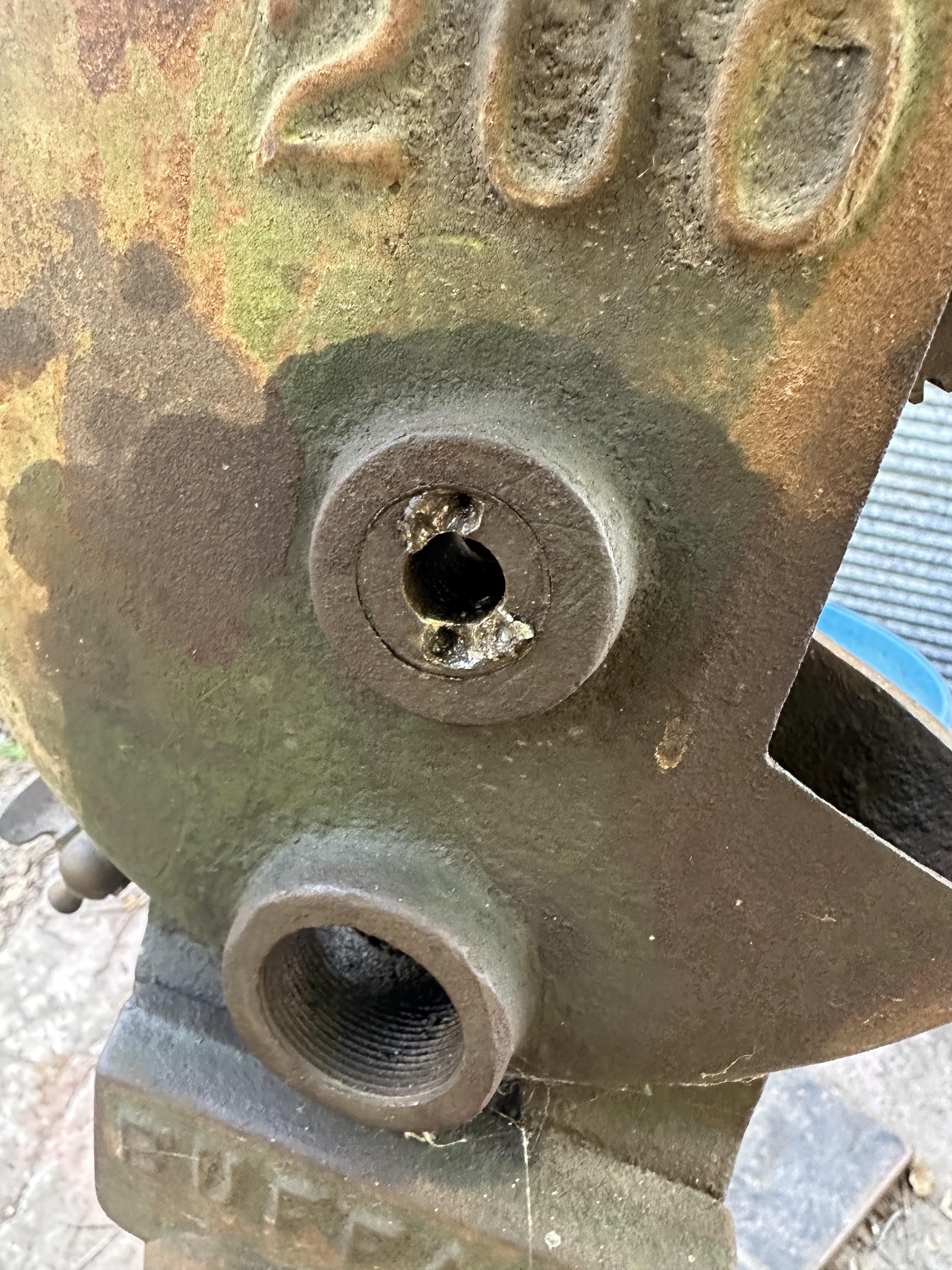

Been tearing down a Buffalo silent 200 to restore,
Shaina found me a parts doner so imma take two and make one good one
im stuck on getting the pin out of the gear and the the side adjustment bushing that’s threaded does not wanna come out
Once it’s completely apart it’s my intention to sand blast all the cast parts, make new legs, have a few new parts machined, and then re assemble, prime and paint this dude,  a deep full on restoration
I’ll probably have more in it then I could buy a dozen beat up ones for lol
There was a long LONG thread about taking forge blowers apart and a few guys actually knew how to get the pin out and better yet, get it all together and working again. I don't imagine it's still here, maybe in the archives?
Frosty u lesson take before , never took apart what you don't know to make work again.
Or if you disassemble something take picture before you do it.
thanks for the advice but This ain’t my first Rodeo natkova,
thats kinda the reason I buy broken blowers in the first place :rolleyes:

 I got everything moving little bits at a time but it’s been a pain, it’s moving vary slowly,
I know the silent 200 had a couple of different variations
for instance I’ve seen some with a separate cone that puts pressure on the bearings but this one just has it machined in the shaft
this one has a really good body and has the nice little fancy brass drain valve but both of these 200s are in rough shape
the parts donor say full of water so long that i think someone drug it out of a pond, the bottom worm gear is shot, gear teeth are toast on it so there’s no bringing that one back but it’s got a lot of good parts

Ive done some buffalo, champion an Otto’s before
but in all honesty this is my first silent 200 so I’m learning on this model
it looks like a well built machine I cant wait to to try it out after I get the last few things off
the gears are in excellent condition on this one but the shafts and adjusting bushings are in rusty condition and a little boogered up
I think where people run into trouble on hand crank blowers is tuning those adjustments in so everything spins freely
it’s got a funky offset bushing with a a stationary shaft in it and those pin holes to move it so I can see if you don’t get that dude in there right it could lock up
Figuring out and repairing small engines and machinery is your day job so even if you've never seen a device before and have no personal knowledge of it, you know how to figure it out. Everything has a sequence of assembly and another of operation having experience with these two mechanical basics is knowledge and so on.

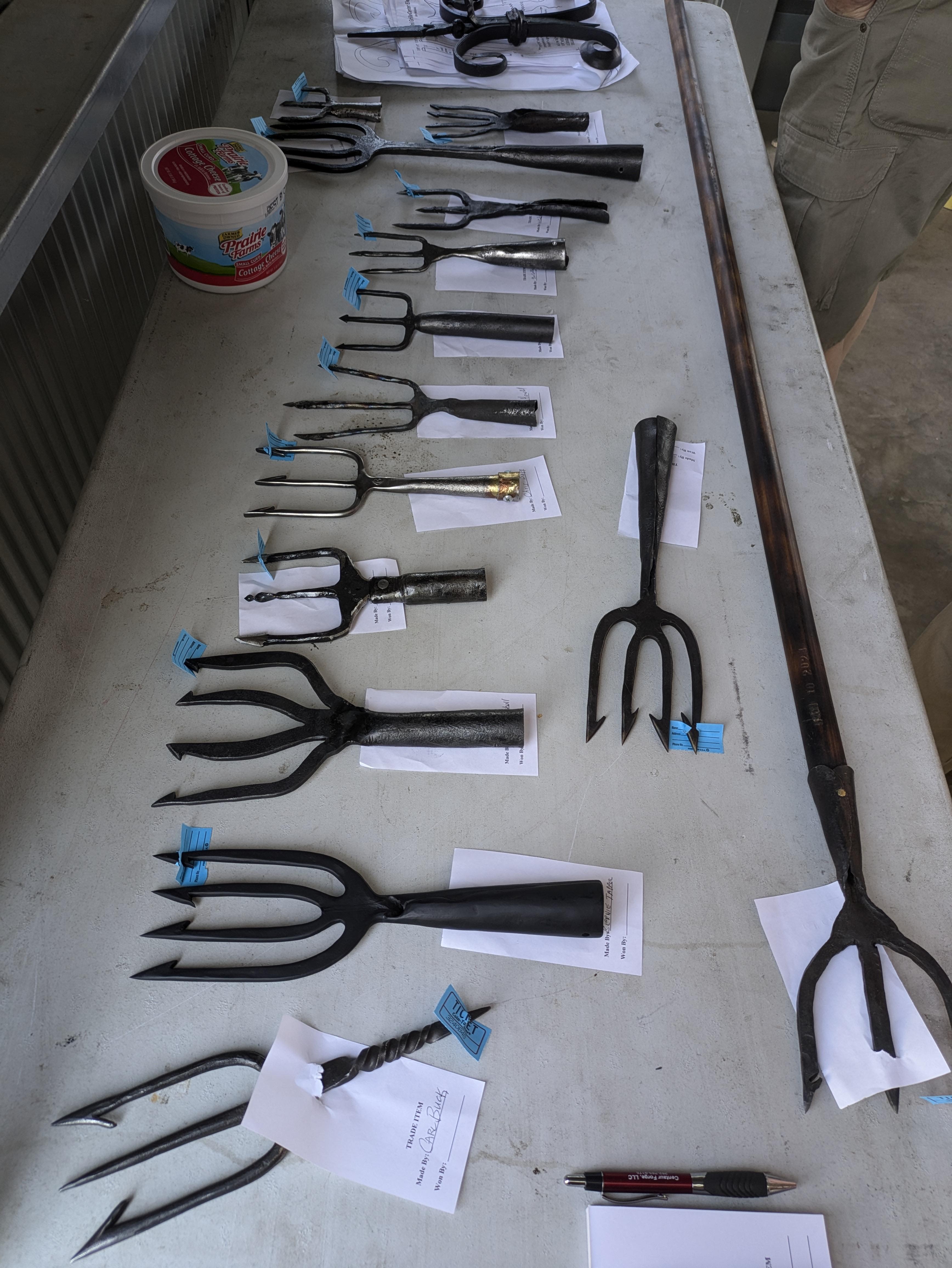

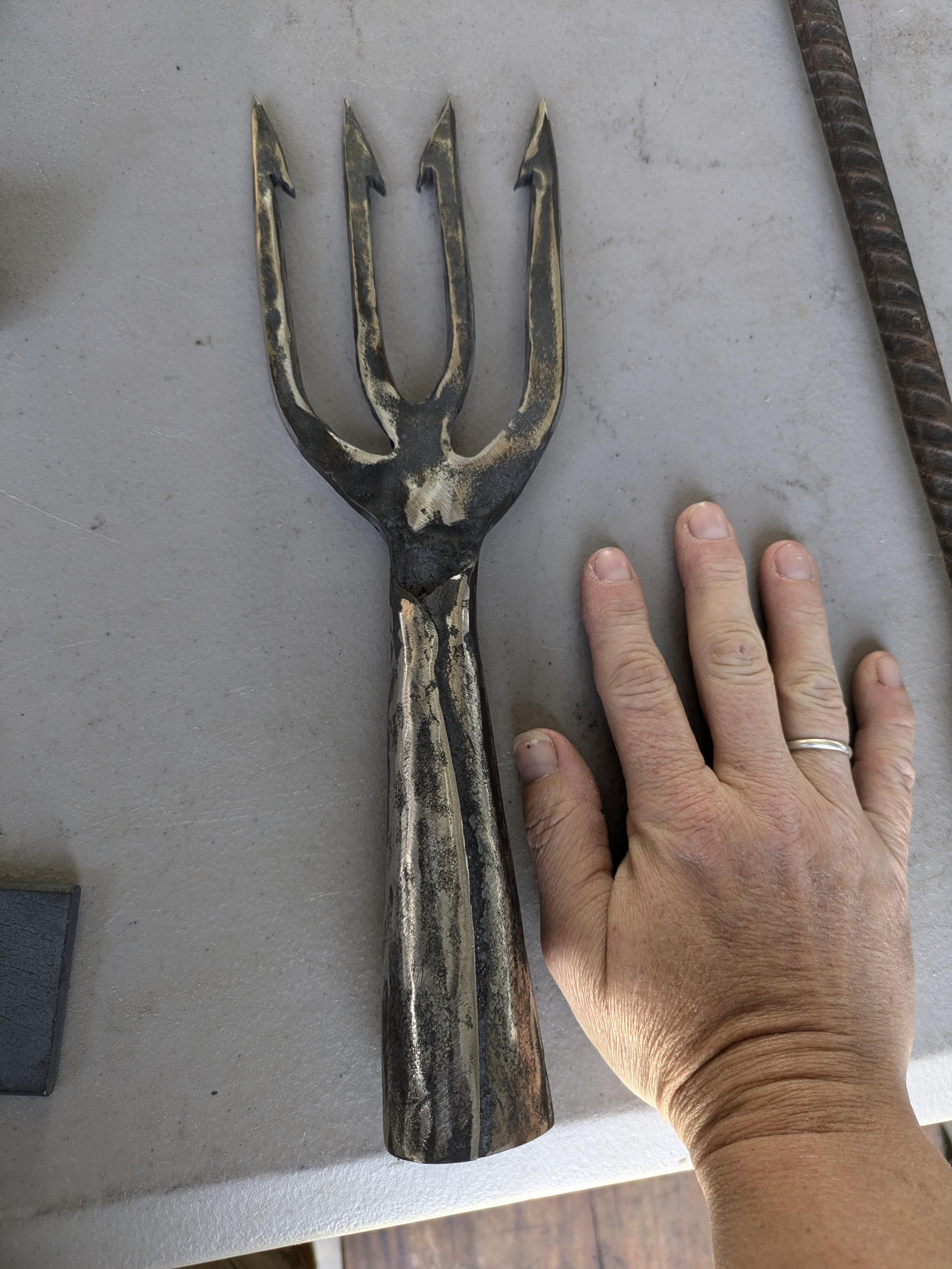

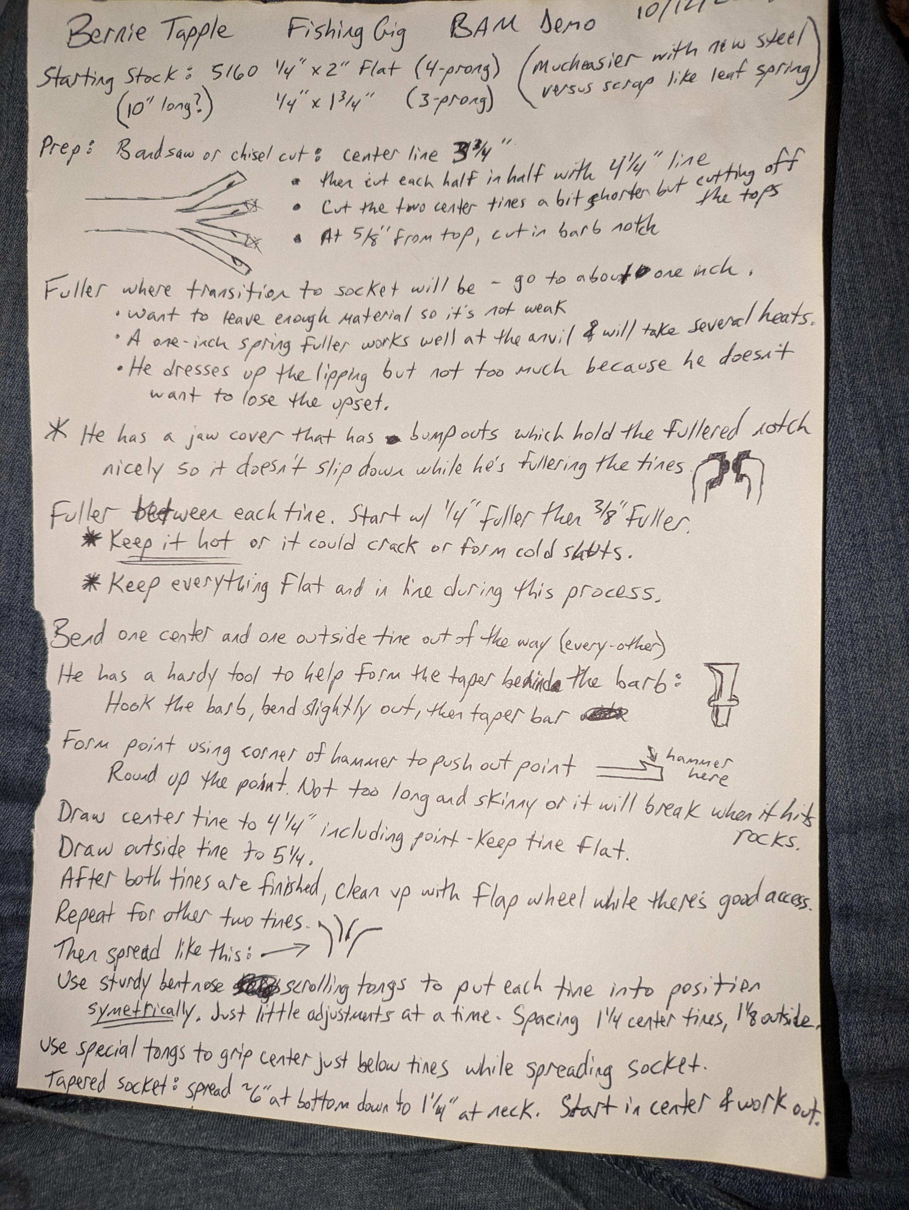

Yesterday was the BAM meeting with gig demonstration from Bernie Tapple. I took a page full of notes (and later rewrote more legibly and added doodles). I don't fish but I still want to try again using the tips and tools Bernie mentioned to see how much better I do.
Maybe I'll make one into a devil's fork or Olympus Trident, lol
Here's the table with everyone's attempt at the fishing gig prior to the meeting. It was the trade item.

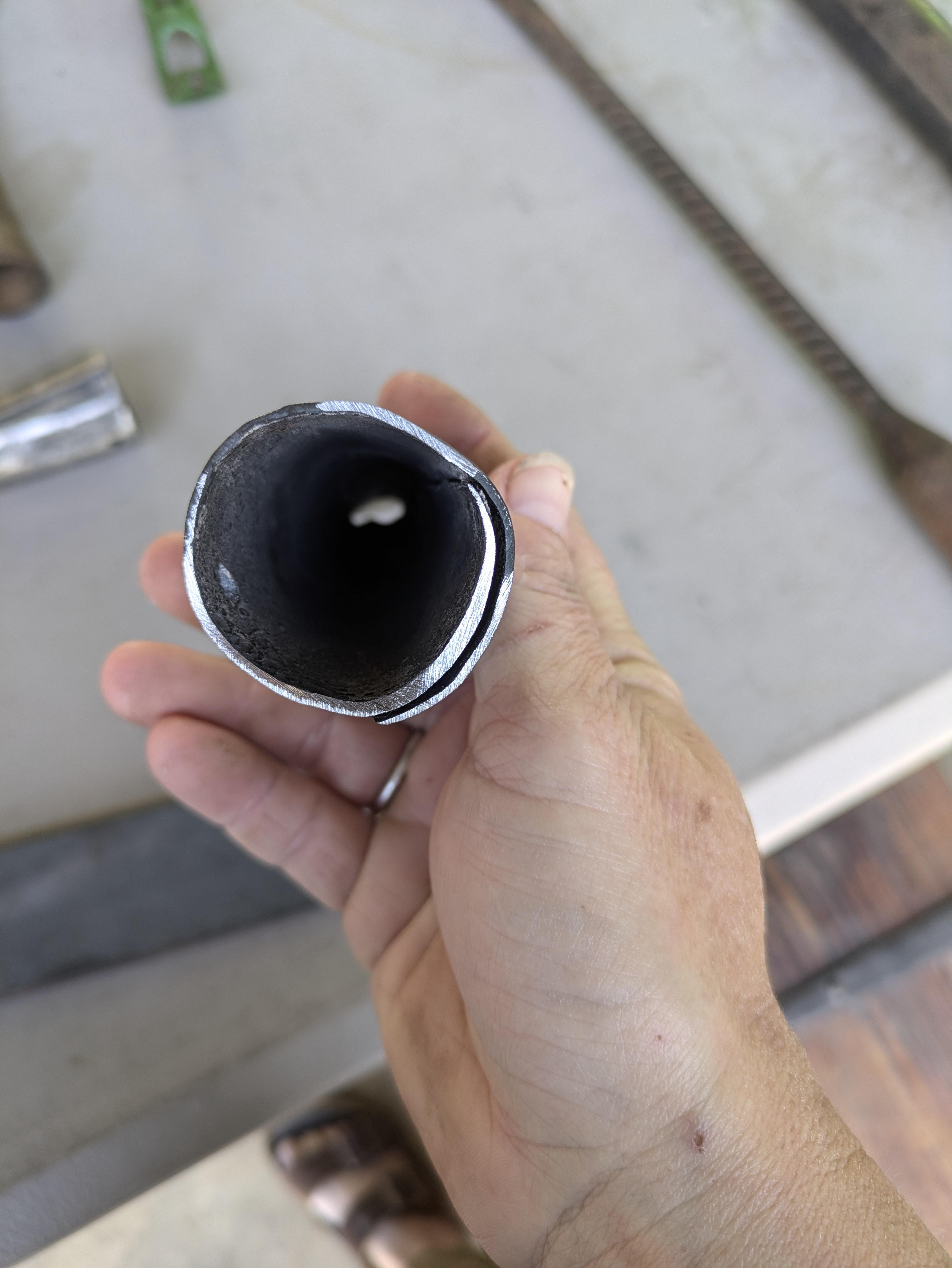

Here's a front/back/and inside view of socket on one of Bernie's gigs. My hand for scale.
PXL_20241012_155054511_MP.thumb.jpg.18ca19a3bc2510d06b8ab75bafe338f0.jpgPXL_20241012_155048655_MP.thumb.jpg.461a7711d81e13f67e9b6eac66f1ffda.jpgPXL_20241012_155038337_MP.thumb.jpg.9d32722e4fe792546360ae4a52908159.jpg
Here's front and back views of my second and third attempts. All three attempts combined a total of approximately 20 hours of forging time. Then Bernie goes and knocks one out start to finish in less than 2 hours. But he's got hundreds of gigs in practice, lol

My third attempt (4 tines) also has an attempted forge welded socket seam. I started to melt the bottom after the third weld setting heat so decided to call it done before I totally messed it all up, lol
Then finally, a pic of my notes from the demonstration in case anyone is interested in giving it a shot.

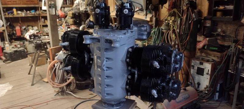

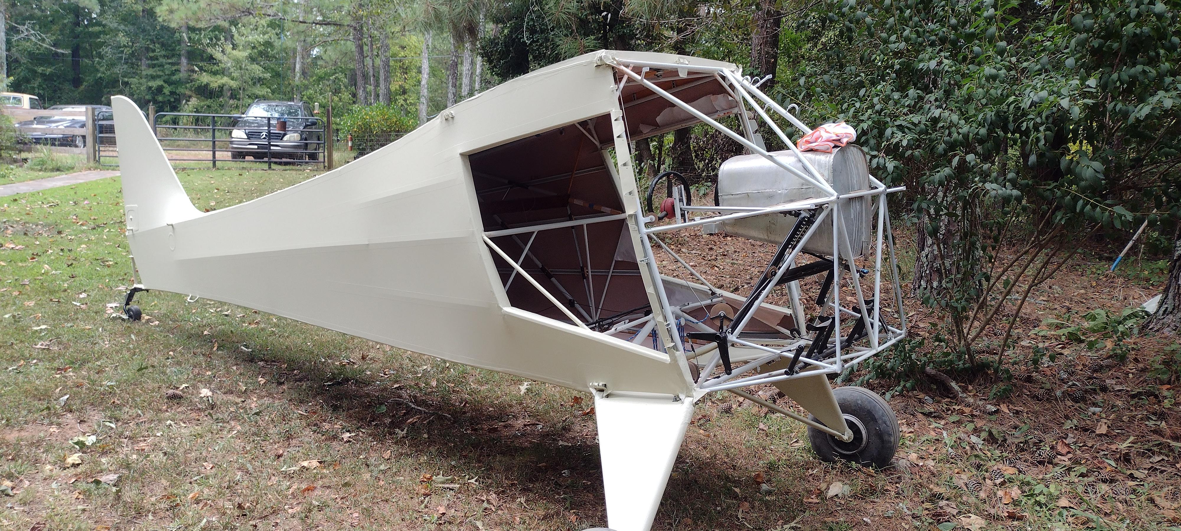

I've had so much going on of late, I haven't been able to get any forge time at all.  I've got a brand new bag of coal, unopened, just waiting to coke up in the forge. But I have a project in the shop, that I need to get to a certain point, before I can take a break from it.  But I'm getting closer. :D  Mabe I'll be able to get back to the forge some time in Dec. Here's a few pics of the project that's taking all my time of late.

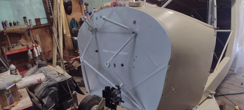

Finally got it on it's own 3 feet:onwheels2.thumb.jpg.0b9ba0002d6e86374159782ac1134b9f.jpg
Firewall, and motor mount installed:
Engine almost ready to install:

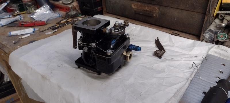

Did an "IRAN" (Inspect Repair As Needed) on Carburettor:Carb(Copy).jpg.af7ddd84d2343df9bc55eb0e5432d9eb.jpgCarb(Copy).jpg.af7ddd84d2343df9bc55eb0e5432d9eb.jpg
