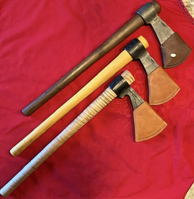

I got the tomahawks done today:IMG_0018.jpeg.c5a22f77cda10f22d8b5606ad85a4974.jpeg

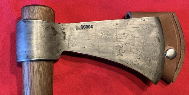

I’m pretty happy with how this one turned out:IMG_0019.jpeg.bae514d1a94c969bd9bee8f99ffdfabb.jpeg
It was from a failed Harley Davidson drive chain billet about a year ago. A bunch of passes at welding heat and it all worked out.

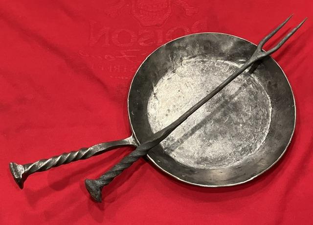

I also worked at a local festival demonstrating yesterday and among a couple give away leaf key chains, I forge my first frying pan and a bbq fork to match it. (Fork still needs some clean up.)
Now I have to forge out a Rr spike spatula to go with the set.

Looking really good David. What's the stripped handle? I also particularly like the incising you did on the lower two. A spikula seems to be a logical addition to the set.
Frosty, the striped handle is curly maple. I ordered a selection of different handles. The others shown are walnut and osage.
Will, I’m willing to help out, but Dyers would be about a 4hr drive. There are other smiths in northern IN with skills much better than my own!

Goods, with that nice of work the spatula should be a piece of cake.  On the ones I've done the biggest help was someone to hold the flatter to finish it out.

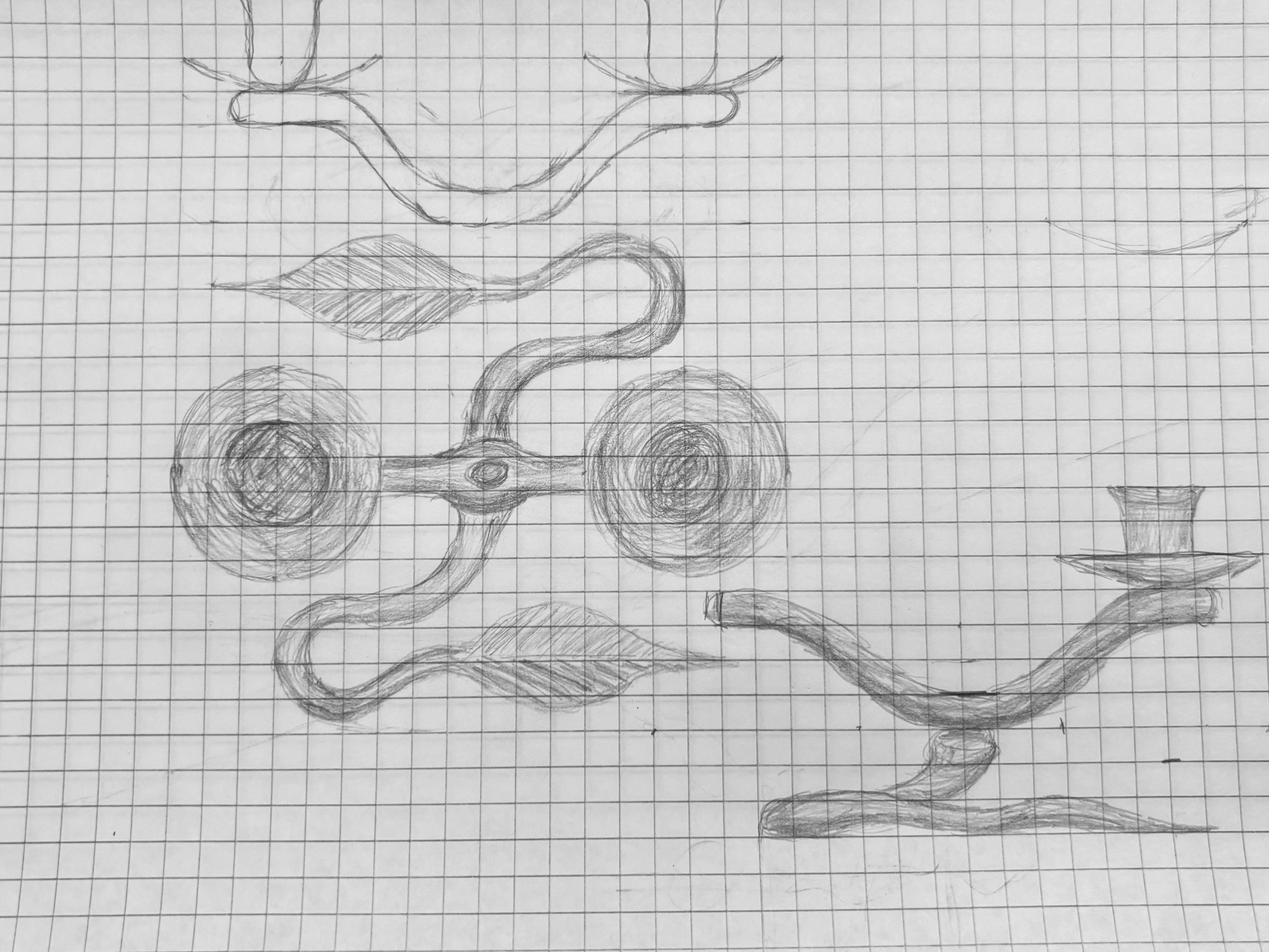

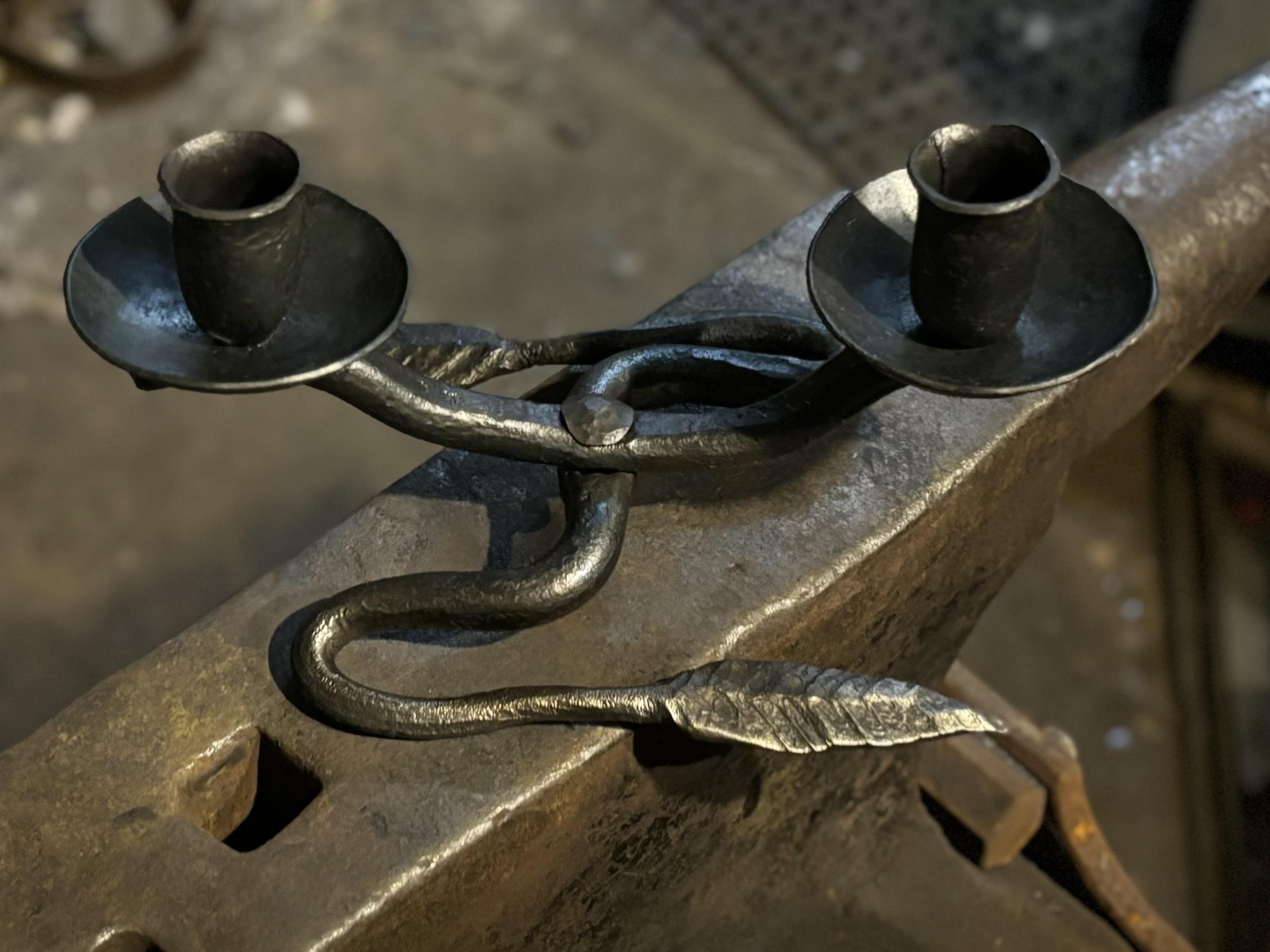

Started work on a two-branched candlestick that a friend commissioned as an iron anniversary gift for her husband.
Concept drawing:

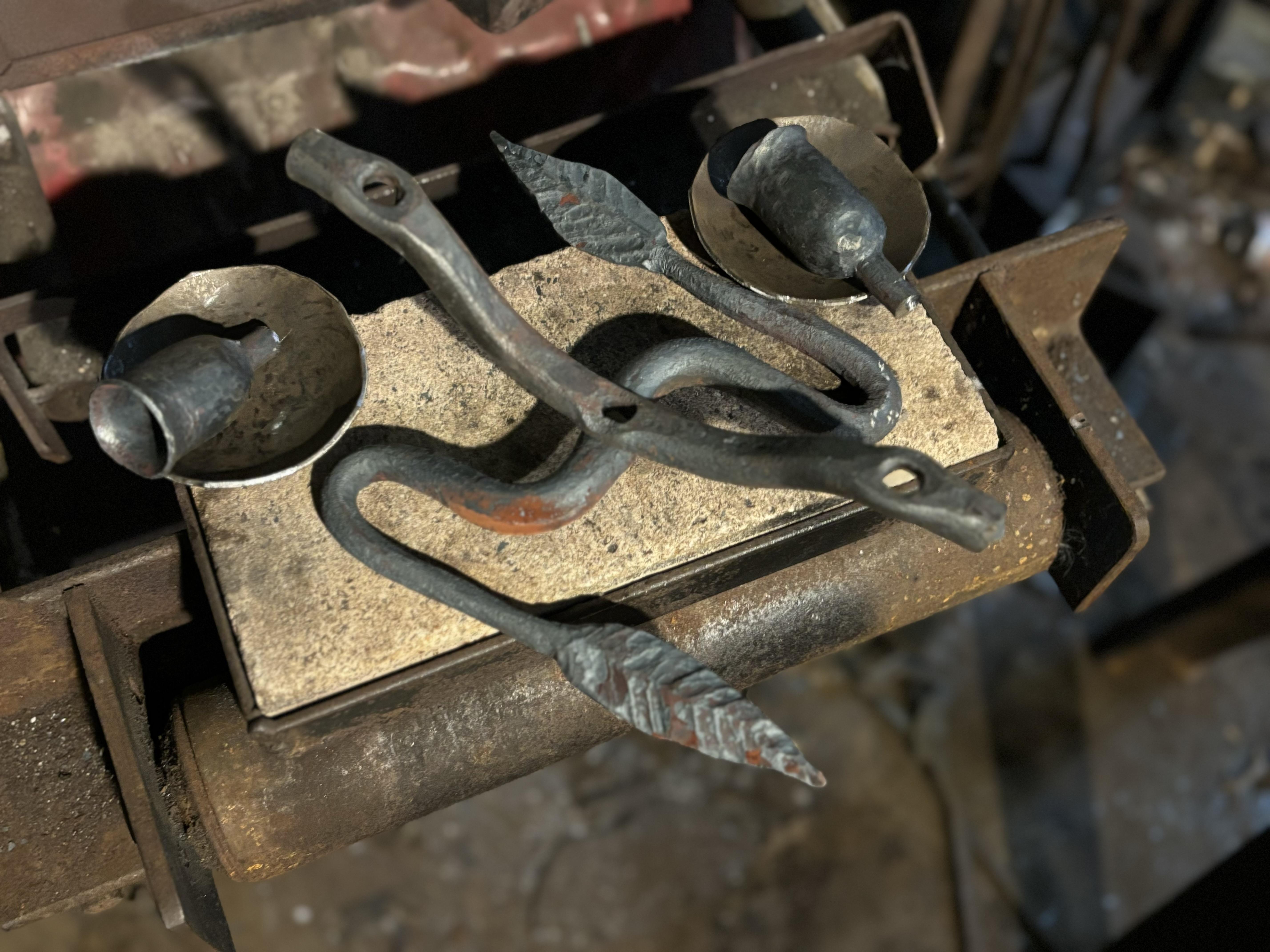

 Basic forging of the various elements:
 Next step: assembly and adjustments.

Goods, some awesome tomahawks, And I like the skillet and fork too.
JHCC,  that will be a real nice candle holder.

Assembled and adjusted (and finished):

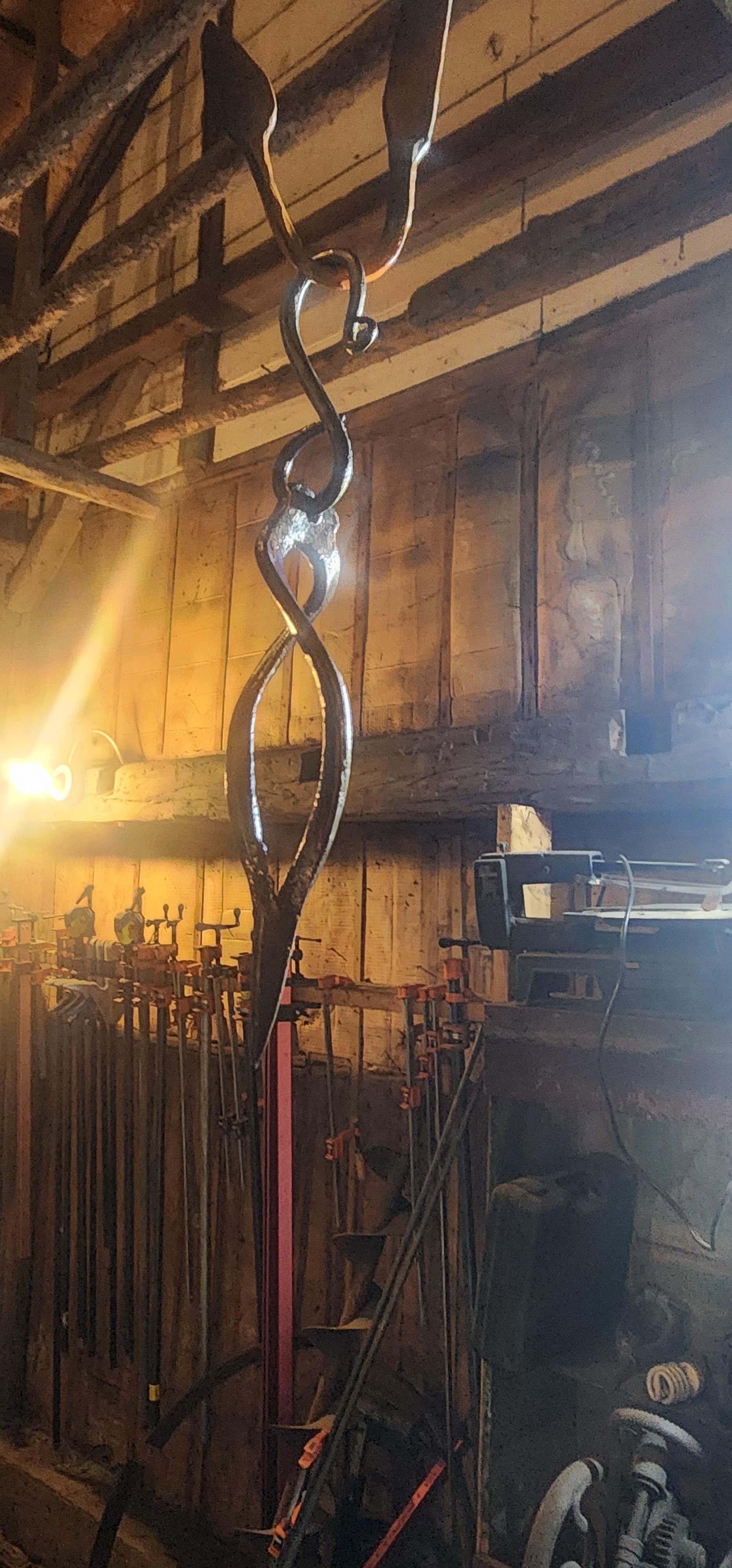

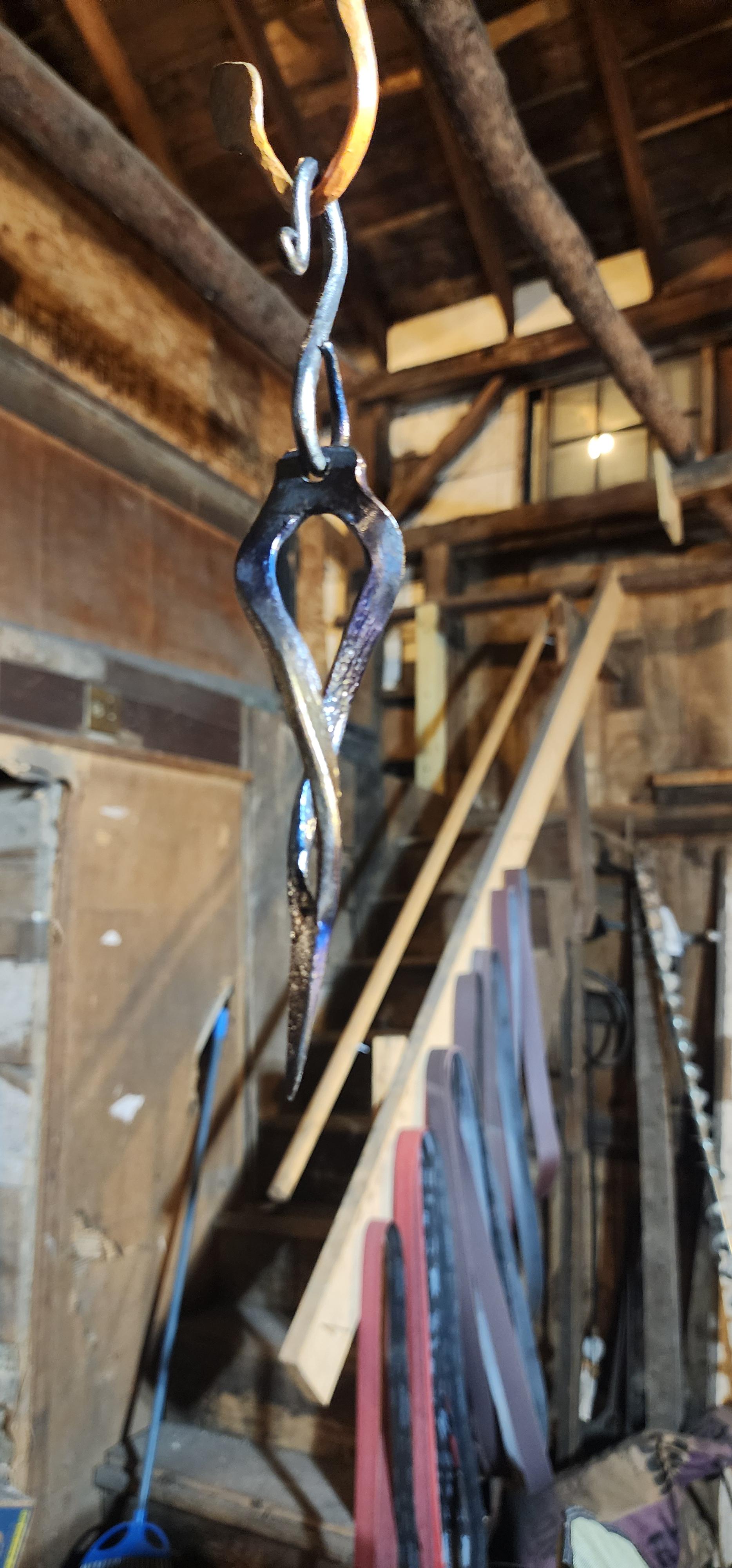

I hade started playing with Christmas ideas.   I know it's a bit late but I have a craft fair on November 2nd.  Last year I made a bunch of tapered icecicles and decided to revisit that idea in a larger size.  I decided to go for a split and twist and forged the hanger hook.  I'm rather happy with the result.   I torch colored it and have several layers of clear on it to protect those colors.  I think I'll be playing around with this more.

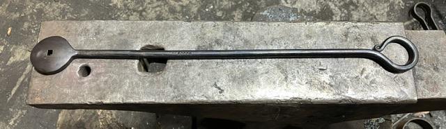

For a while I’ve wanted to be able to forge nails for demonstrations. Last night I finally got around to making a nail header:
Made from half of a Rr clip.

John, a very nice design and execution, the couple will treasure your candle holder!

Chad, very nice icicles...you're giving me ideas!
David, I appreciate the extra effort to make a tool handsome as well as functional!
--Larry
Larry, I’m doing this as a hobby and I don’t have to worry about making a living from the time input. For me every time I light the forge my goal is to make something better than the last. (That doesn’t always work out…) I’m not fast with anything, but I’m usually happy with the results. I really need to work on keeping the forge finish nicer. That will save time filling/grinding. The header only took a little, but that’s not the norm for me yet.

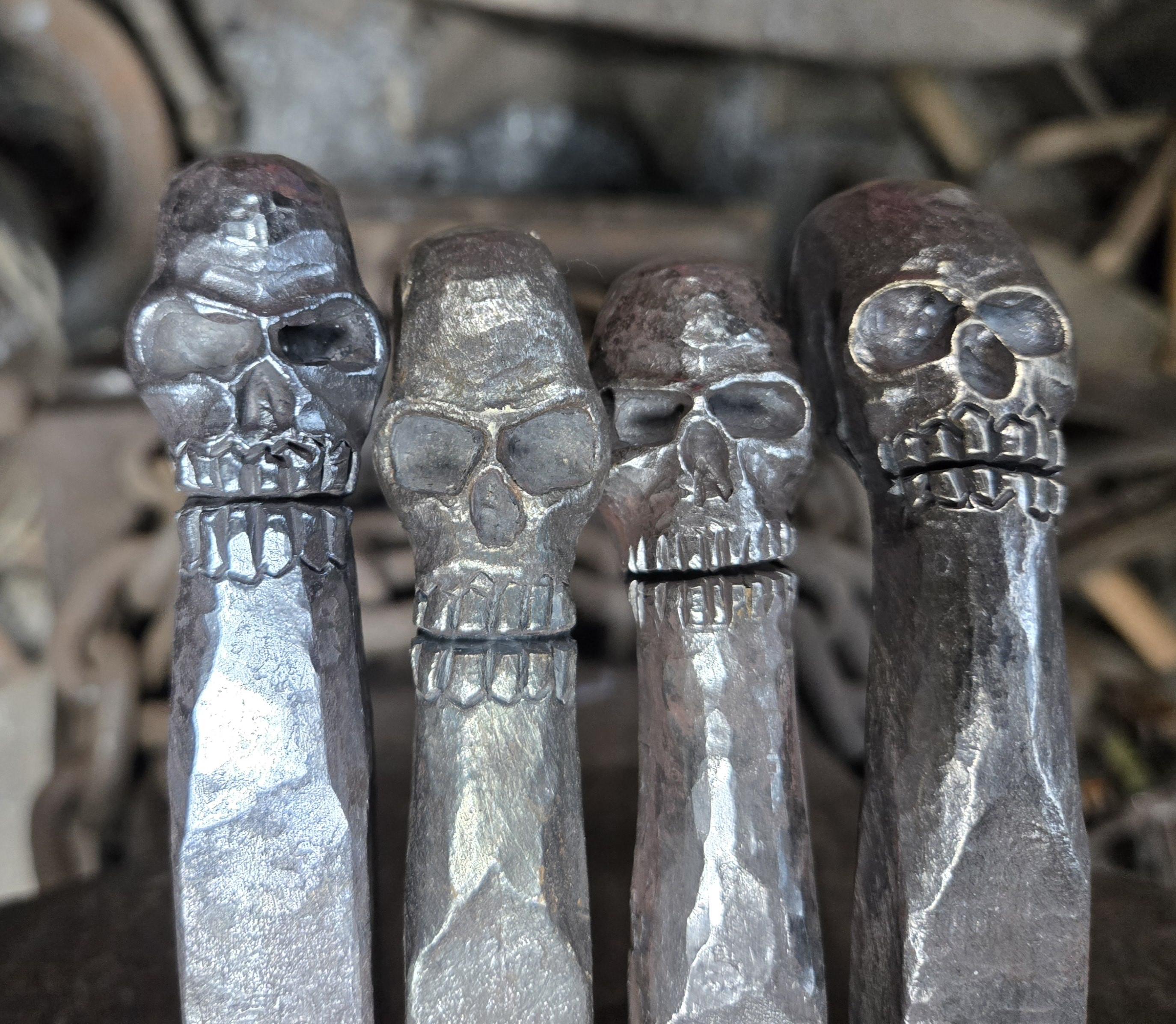

Practice makes perfec.... eh it makes more of a thing sometimes. Not trying to bore anyone with the same thing but I do need to practice I think. Funny when I just bust something out randomly it seems to look better to me. Maybe trying too hard.
The demo will probably go fine with coffee instead of beer.

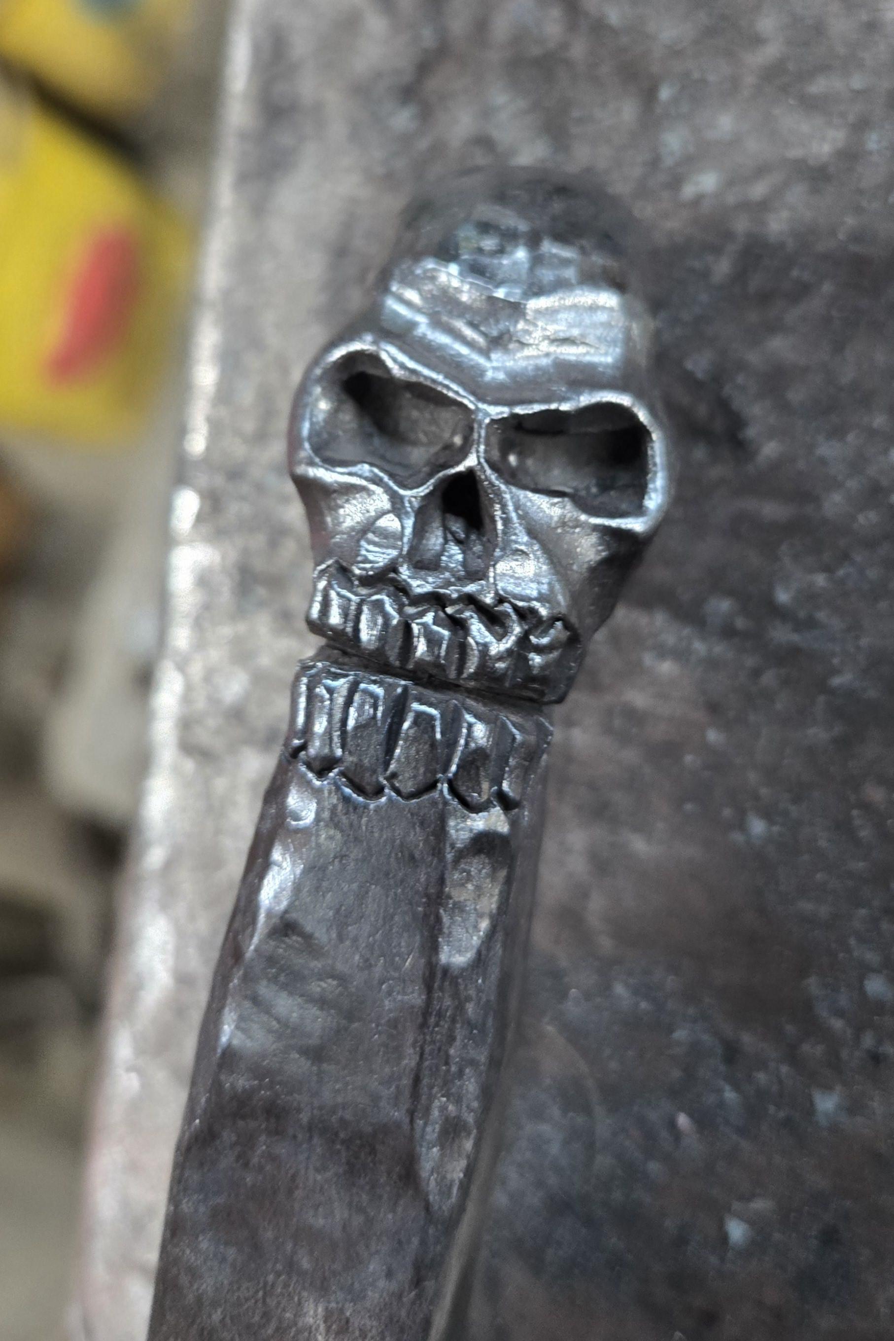

Tried out a new nose punch. Not impressed. Needs some work.
Still dig any of them.
Getting this kind of thing right kind of gets ahold of you doesn't it? Das. One of the things I like about them are the differences. Skulls never look just alike anyway.
Have you tried pushing the eye sockets out and forward by punching the cheeks and temples?
I found punching the temples and cheeks really defined the eyes and nose forging wizard heads. I ran into trouble getting a good ball punch made for the eyeballs. It really got a hold on me though, I must've beaten half a dozen RR spikes into the rem bucket. Good times. B)
We are always our own worst critic, Das! I love the look of all of your skulls. There are variations, but that is part and parcel of handmade.
E.G. the one on the right in your last picture is very Homer Simpson. Does that make it worse than any others? No! I think it makes it better! But, others may prefer others of your variations.
Cheers,
Jono.
Frosty, yeah it does get a hold of me. Mainly because I want to get it into muscle memory.
I had thought about working the sides and cheeks as well, I just havnt tried it yet. That will be an experiment for another time. The temples could improve it too. Good thinking.
Thanks Hefty.
That one does look like Homer Simpson since you mentioned it lol.
There aren't any I don't like. One of my problems is doing them mainly at night when I'm already tired from work and kids. I kind of just push through it when maybe I should be taking my time more. This last one the teeth were a bit rushed and it shows. Plus the nose punch needs some work.
But yeah, our own worse critic haha. I do still like them all.

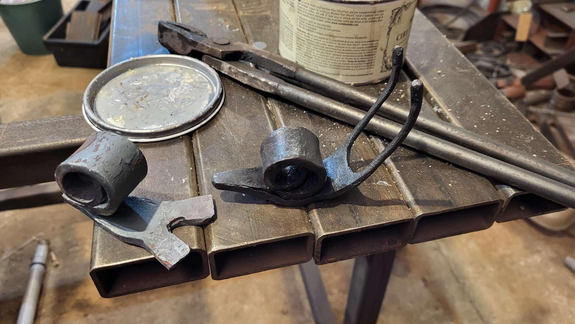

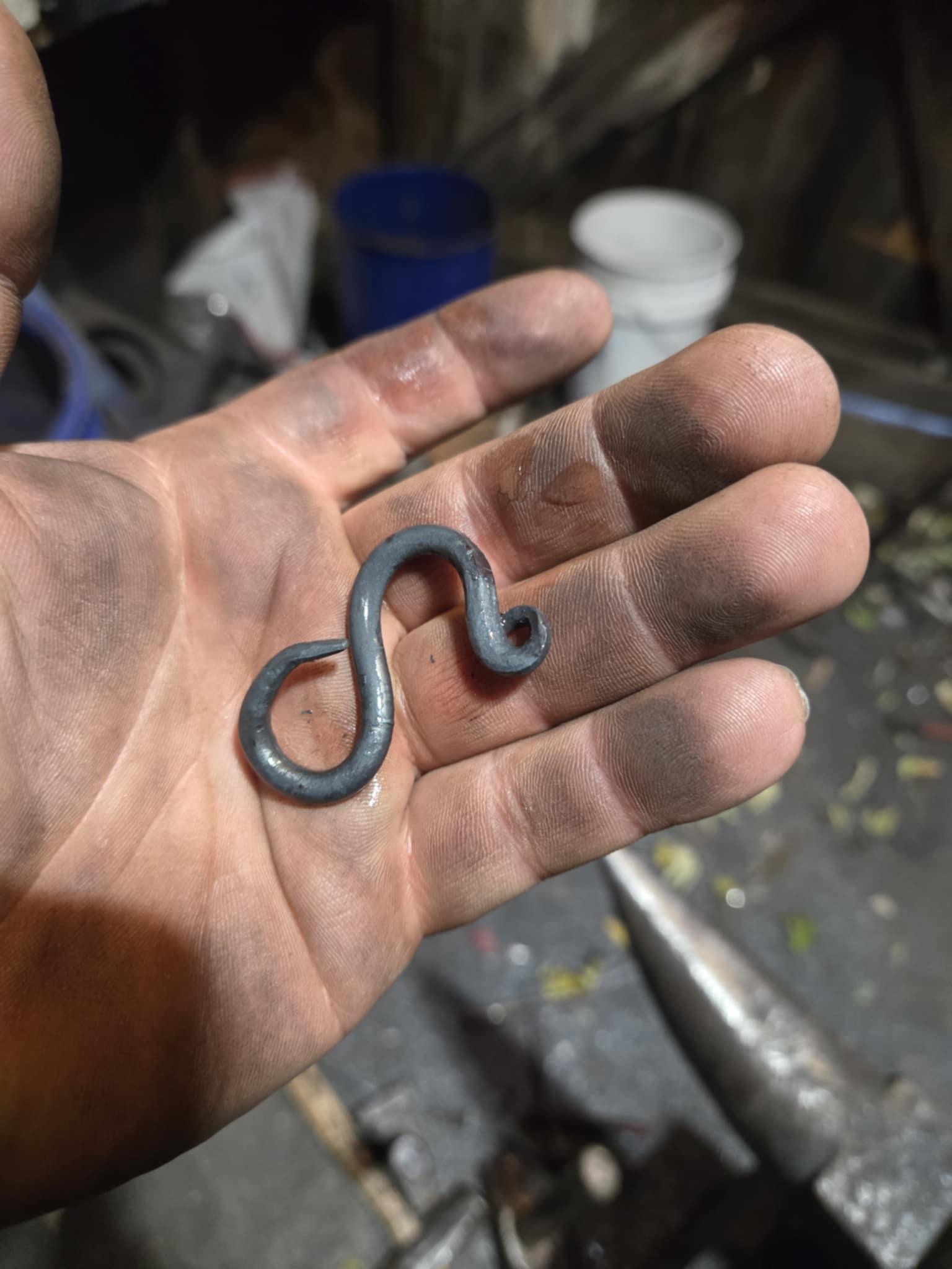

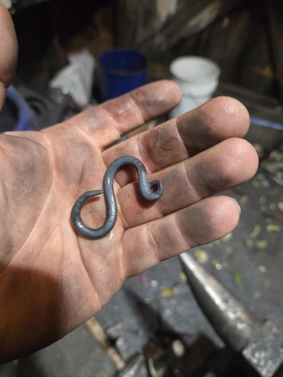

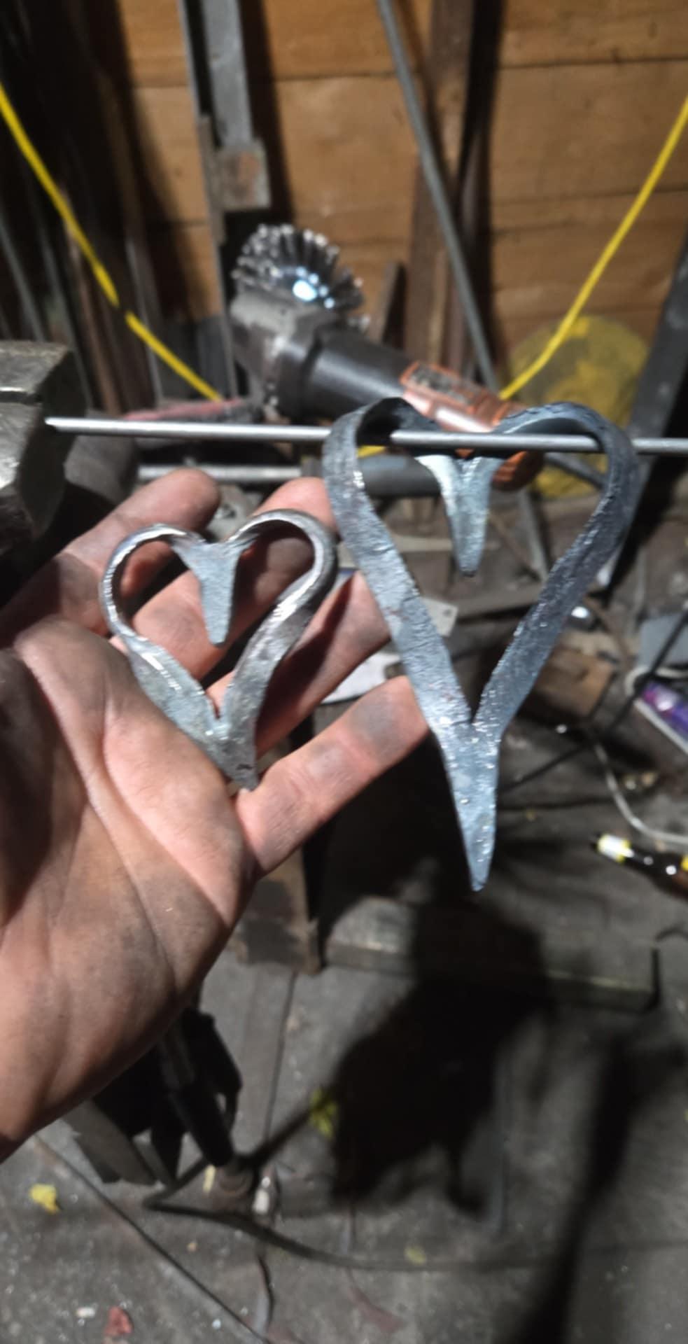

I spent the evening trying to see that darn meteor and making Christmas items.   Specifically small ornament hooks.   Figure why not, some people get silly about their decorations.  Also tried to turn the split ornament I did the other day into a heat shape.   I split and drifted the piece before folding the top back over itself.   These are my first 2 attempts.  I like the second attempt.
A little tweaking and some practice and the heart hooks will make nice gifts. You have the ornament hook in the first pic down nicely.

Also thanks for the comments,  I think I may carefully try and split the tip of the heart a bit more to get an even taper or cheat and grind it down.  Either way I'm making a few more of those and the split icicles tonight
