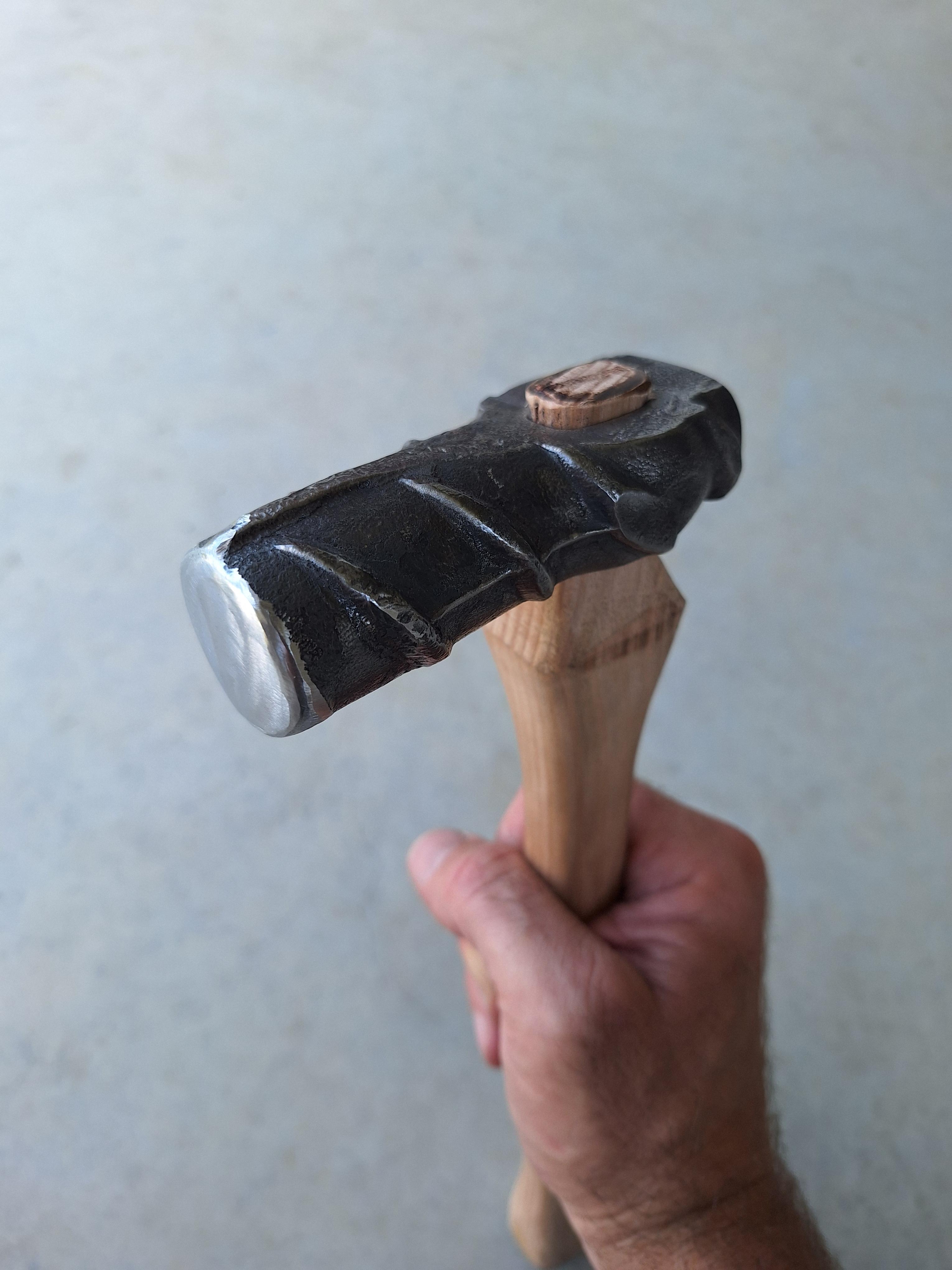

Finished today, but I've been working on it for a while:
20241102_140747.thumb.jpg.e15aca5c124addee78e8483a60ca77ec.jpg20241102_140754.thumb.jpg.f182bc47d193ab4f5db2f38a99eb768b.jpg20241102_140831.thumb.jpg.8d1af91aed679492dae72163b4e68c96.jpg
A dog's head hammer out of 38mm (1 1/2") reo (rebar).
Forgot to weigh the head by itself, but with the handle the total weight is 930g (2lb1oz).
Like a RR spike knife, it's mostly for the "Hey, look! That hammer's made out of reo!", but I really like how it came out. I'm keen to put it through its paces, but if I do another I'm going to draw out the cheeks because I think the shallower eye on this one might mean less support and less spreading of impact through the handle.
Thanks for looking!
Jono.

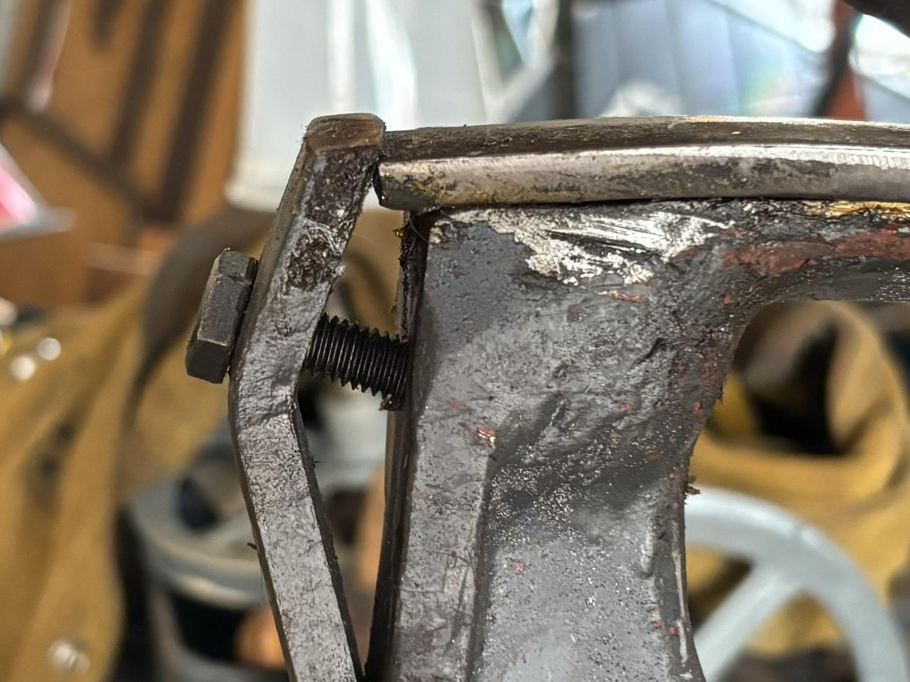

(4) the clamp that holds the bottom blade down is too long and sticks up above where it should, getting in the way of the workpiece.
Fixed it.

That is a strikingly attractive hammer Jono, I like it and will be interested in how it works for you.
That is a hefty piece of rebar you started from.
Cool piece.
The clamp looks solid but I don't have a clear idea of how the lower blade connects so I can't say much, John.
May we have a few more pics of this part of the machine, please? Or heck link me if you already showed us and it slipped my mind?
Frosty
I’d have to take it apart to get a proper picture. For now, suffice it to say that the far end of the blade is steeply beveled, and there’s a matching bevel in the cast iron base. As the clamp pushes the near end of the blade down and in, the bevels at the far end interlock and hold that end down. Does that make sense?

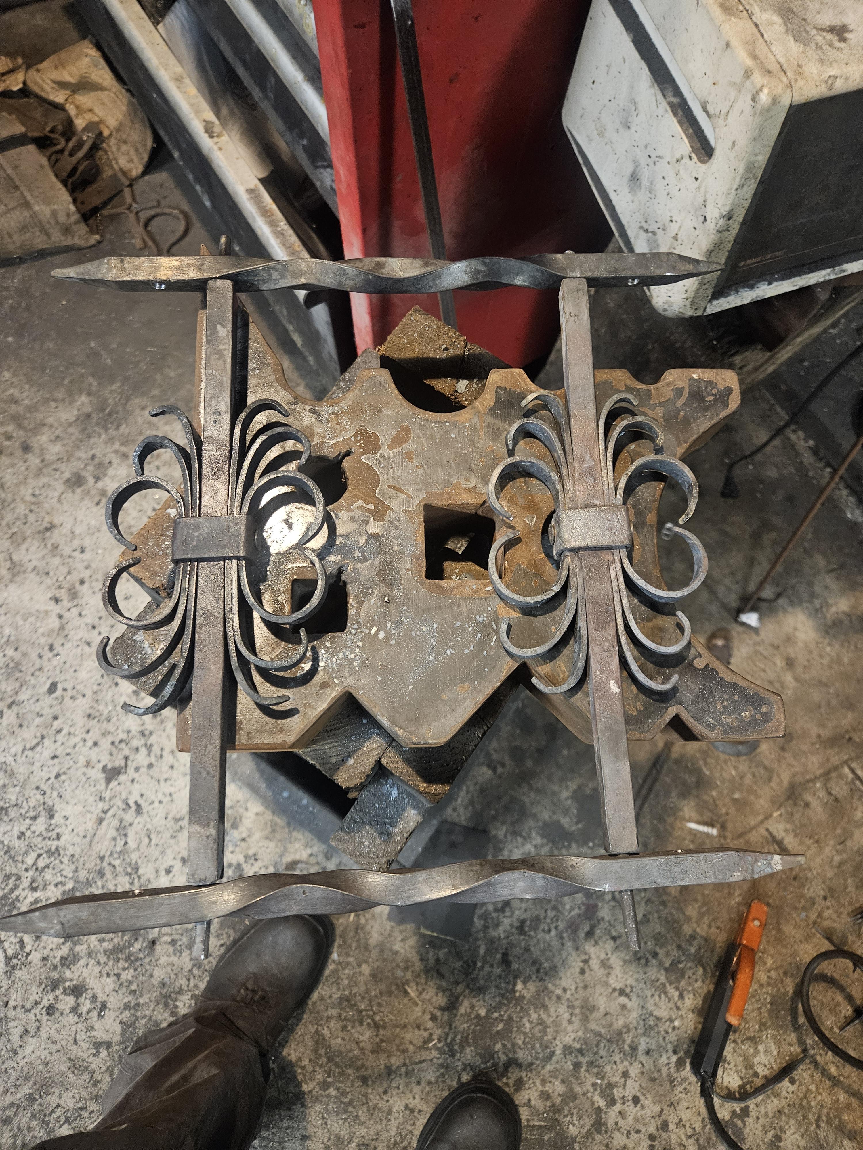

Got about half done that i was planning, par for course i guess.
One of the end brackets to a shelf/cabinet thing i am making. Would have got both spindles done but i ended up burning the scrolls while welding them on. So i backed up and decided that a collar and rivet, rivet is most aesthetic, would work and most likely be quicker than welding them on then putting on a collar.
There will be 3 shelves on this one side. This is the end support for the middle one. I actually miss measured and cut the spindle 3" short, so i will put 2 pieces of 1/2" square, one on top and one on bottom with a 1" spacer between. Those 2 will also be just about 4" longer as well.

Hefty, that hammer will definitely be a conversation starter! I've never seen rebar that big. Looks like it'll do just fine.

Got the other spindle and bottom bar done. Still need the 2 spacers and the other 2 bars. I was going to forge out tennons on the spacers but have since decided to take a piece of stock to work with me today and drill holes through them for rivets. I can do that a lot more accurate on the mill than my drill press.

Your spindles are really coming along well, Billy!

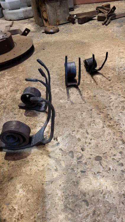

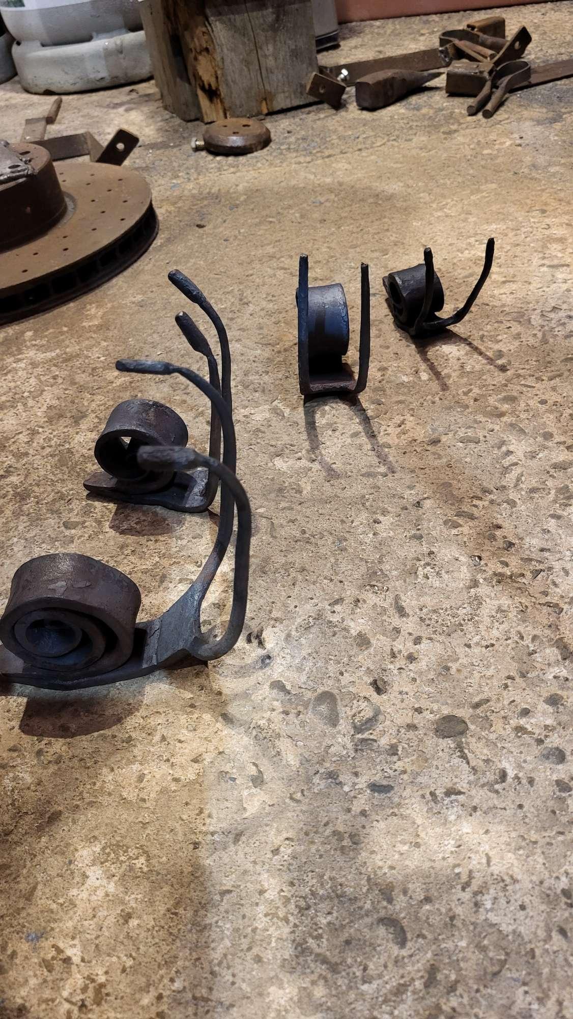

Autum, lots of snails in the workshed
Just missing holes, descaling and a waxcoating to put to usefull use of holding the gardentools up
Kevin, looks like it might have been cast iron. It will do that kind of stuff. Ive been there too in trying to make something into something else to have it all crumble.
Gewoon, love the snails.
