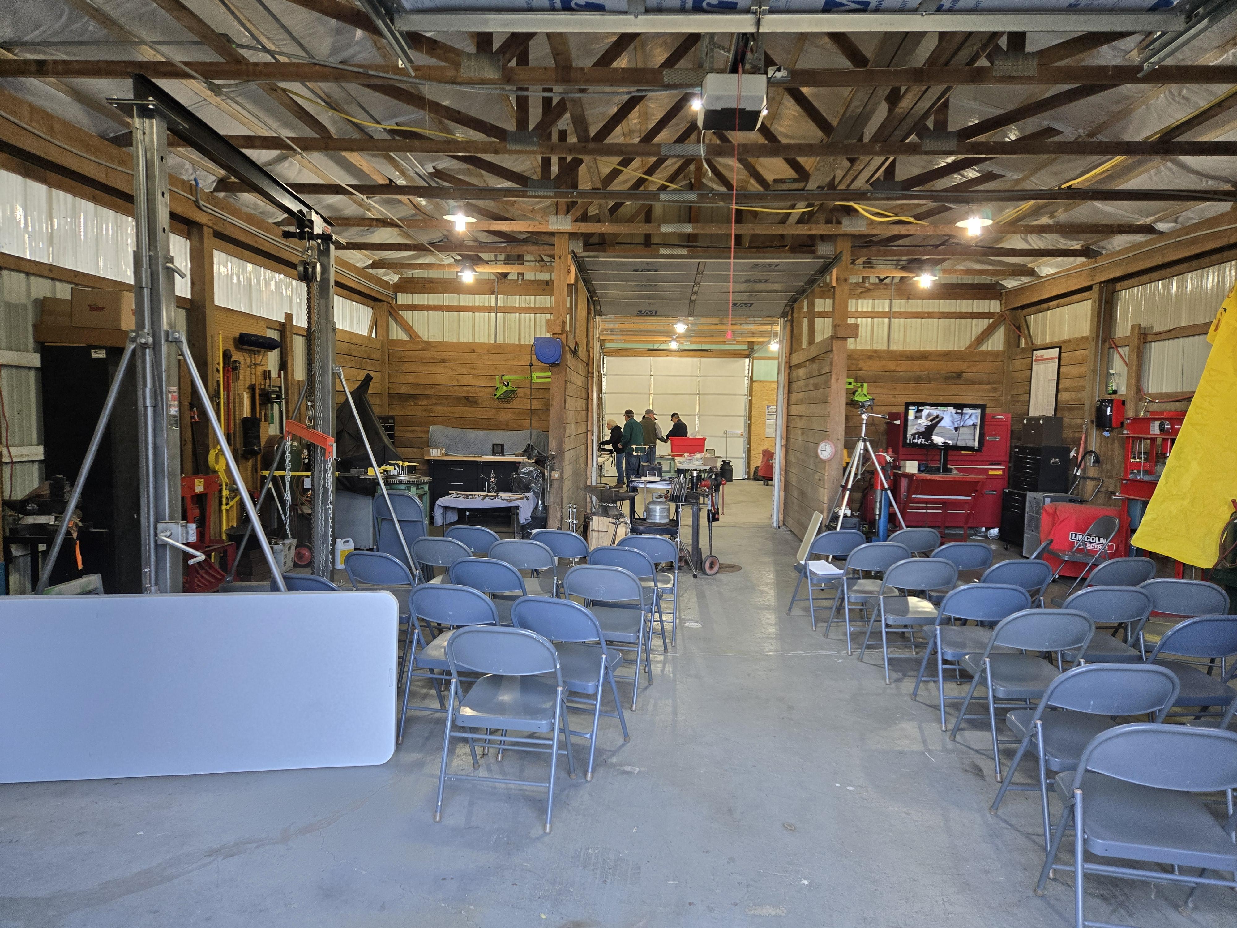

Finished up demonstrating at the PAABA meeting today. The demonstration of making a skull from 3/4" square stock went great and filled the first hour perfectly. After a little break I demonstrated my horse shoe horse head heart. That went well too but a bit too quick, so I filled in the time showing some basic techniques to forging a horned critter. I was thinking I wanted to do a dragon head but timewise I only had time to rough out a long horned bull.
Everyone seemed to enjoy the demo and there were lots of good questions to answer. I was deffinately outside of my comfort zone being in front of 30 people and needing to explain what I was doing more than some random people passing by asking what I'm making. I have explained some processes before.
Anyway, it seemed very well recieved so I hope some people try the projects and make some new punches and a vise perch for punching. As usual with working I didn't get but one picture.
It was a leaning curve using someone else's gas forge and anvil. I'm very glad I brought my demo vise.

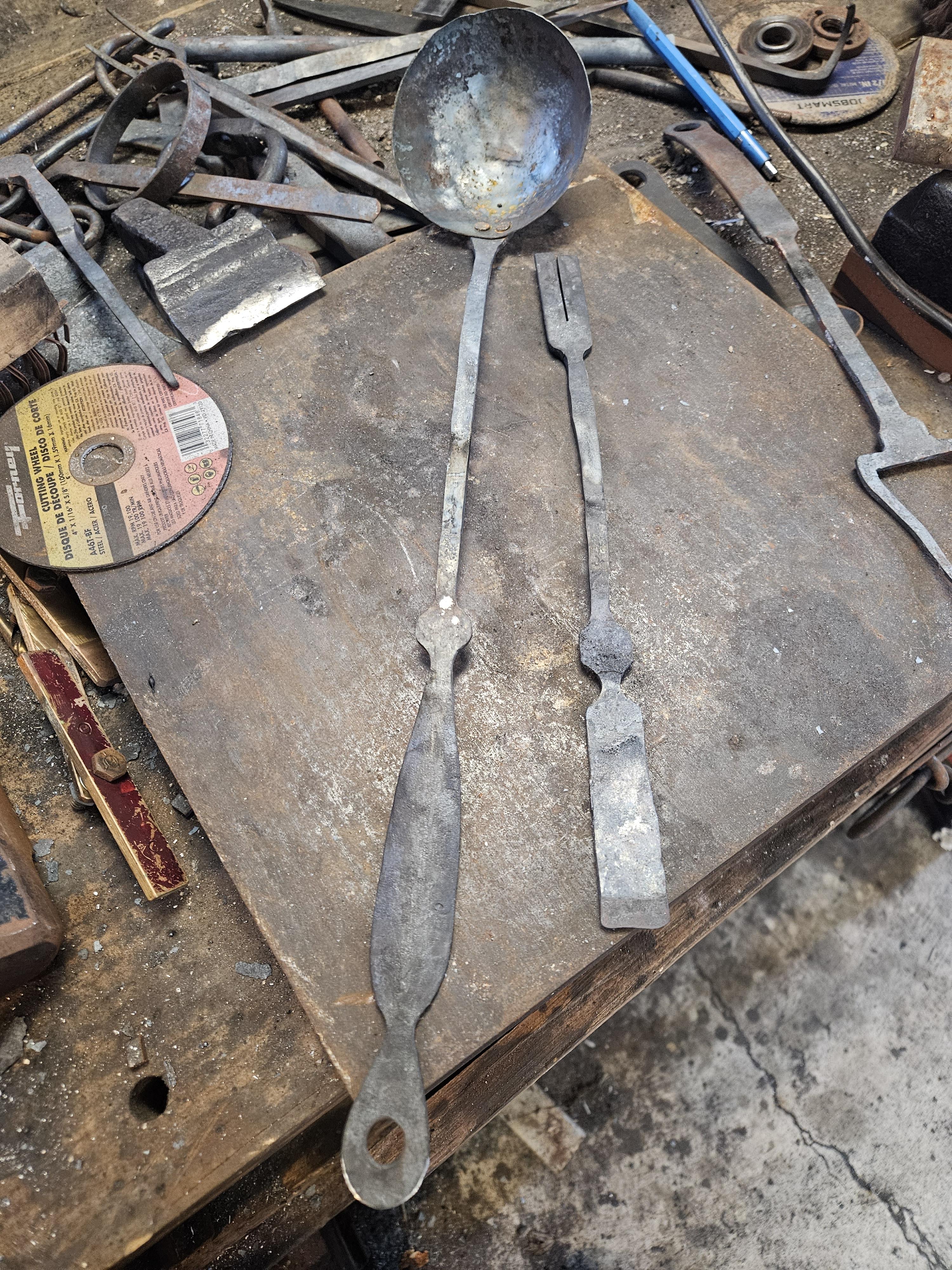

So it is getting closer to the Holidays so i started making my traditional serving fork. This will be 7 years in a row of doing 1 every year. This year i decided to add a ladle to the mix. All would have went well except i forgot that forks have tines where ladles do not, in short i cut my stock to short. So being that it is in my ability rather than scrap it and start over, weld on a bit more material. All went good, weld nice, but one little scarf just not blened. No problem, just heat it up and take care of it. Well, i started day dreaming while cranking my blower and got a sparkling mess. So i cut off and salvaged as much as i could, got a new piece ready to weld on. By that time my fire had died down, huge clinker had formed, i was tired, hungry, and my back was hurting, so i will com back to it hopefully to day if i can get my shackle mounts replaced on my truck in enough time. If not i am off work tomorrow.
I may do another bow for the ladle, i am not pleasd with that one. The sheet is kind of thin and want to move in wonky directions in my swage. It is also crooked when i made the holes in it i got it just a little off.

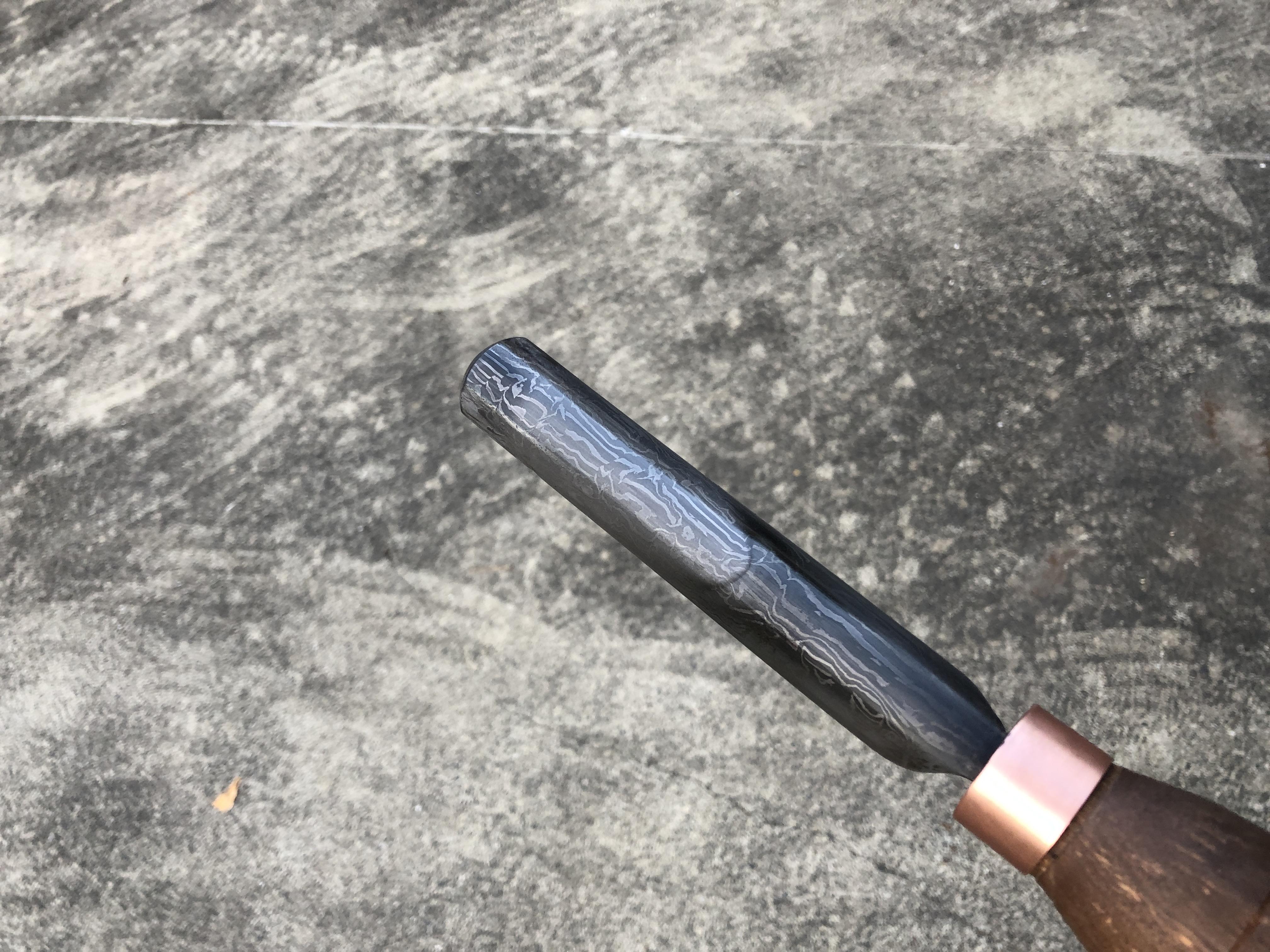

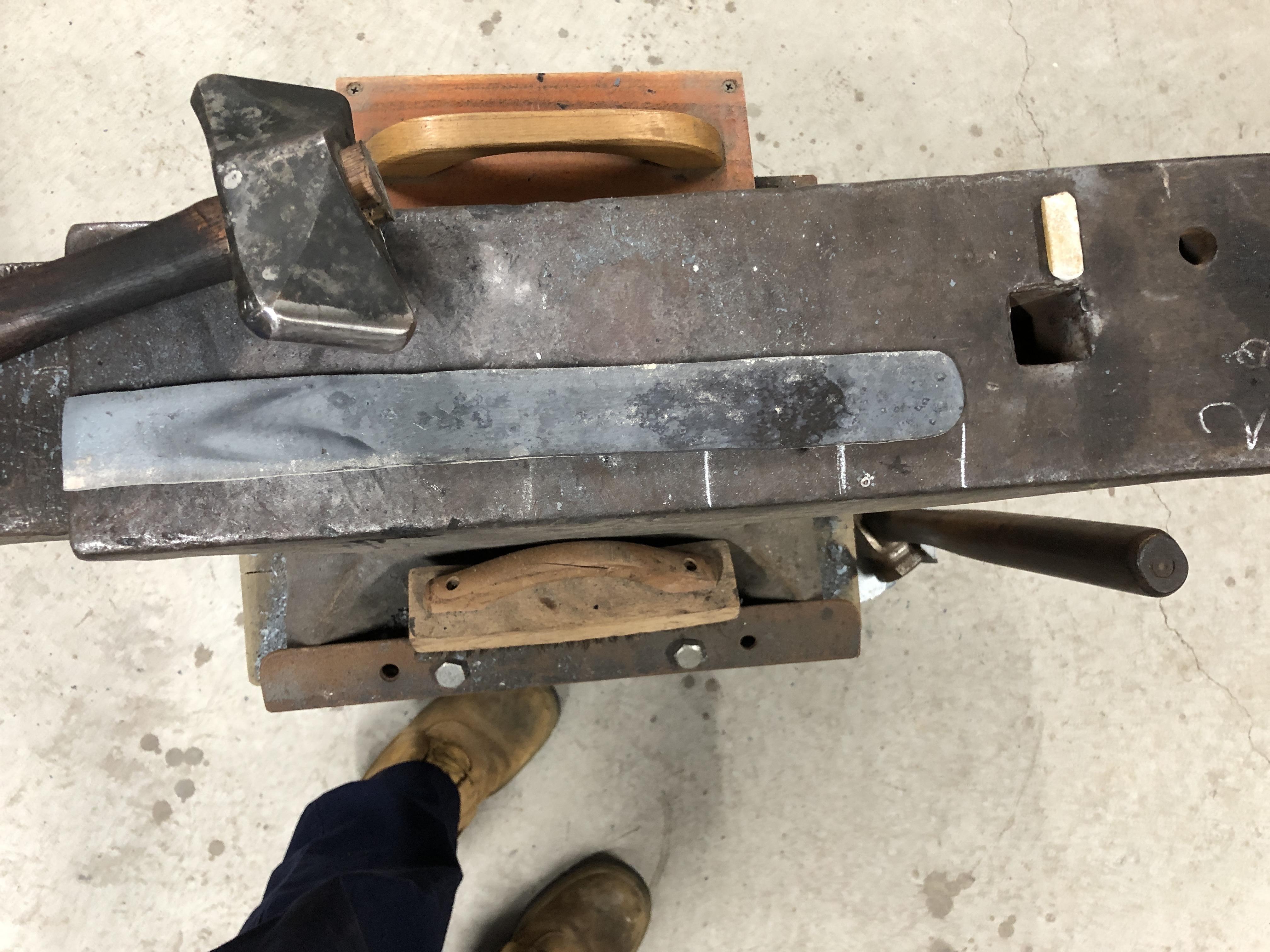

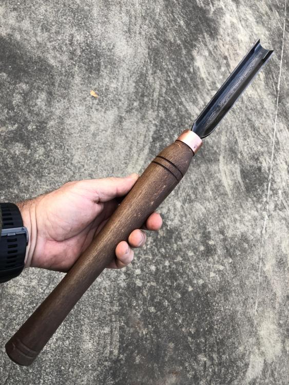

I finished off this first attempt at a roughing gouge over the weekend using a section of the unfinished raindrop pattern billet on the right in the first pic. I hadn’t finished the billet initially because I could see that the pattern wouldn’t quite have the impact that I was hoping for but figured it was good enough for a first try at a chisel.
As it turned out I am actually pretty happy with it.
Interestingly (and annoyingly) by doing an isolated heat treatment for the chisel edge it seems to have had an effect on the etch. Not one of any consequence though as the heat treatment turned out as good as I could have hoped for so I don’t plan on chancing my luck by messing with it again.
Larks, that gouge is something to be proud of, it turns out fantastic.

Billy, I'm right there with you on trying to get something done when I'd be better to set it down and wait till the next time when I'm more fresh. Maybe that ladle is a left handed ladle.

Nice gouge Larks.

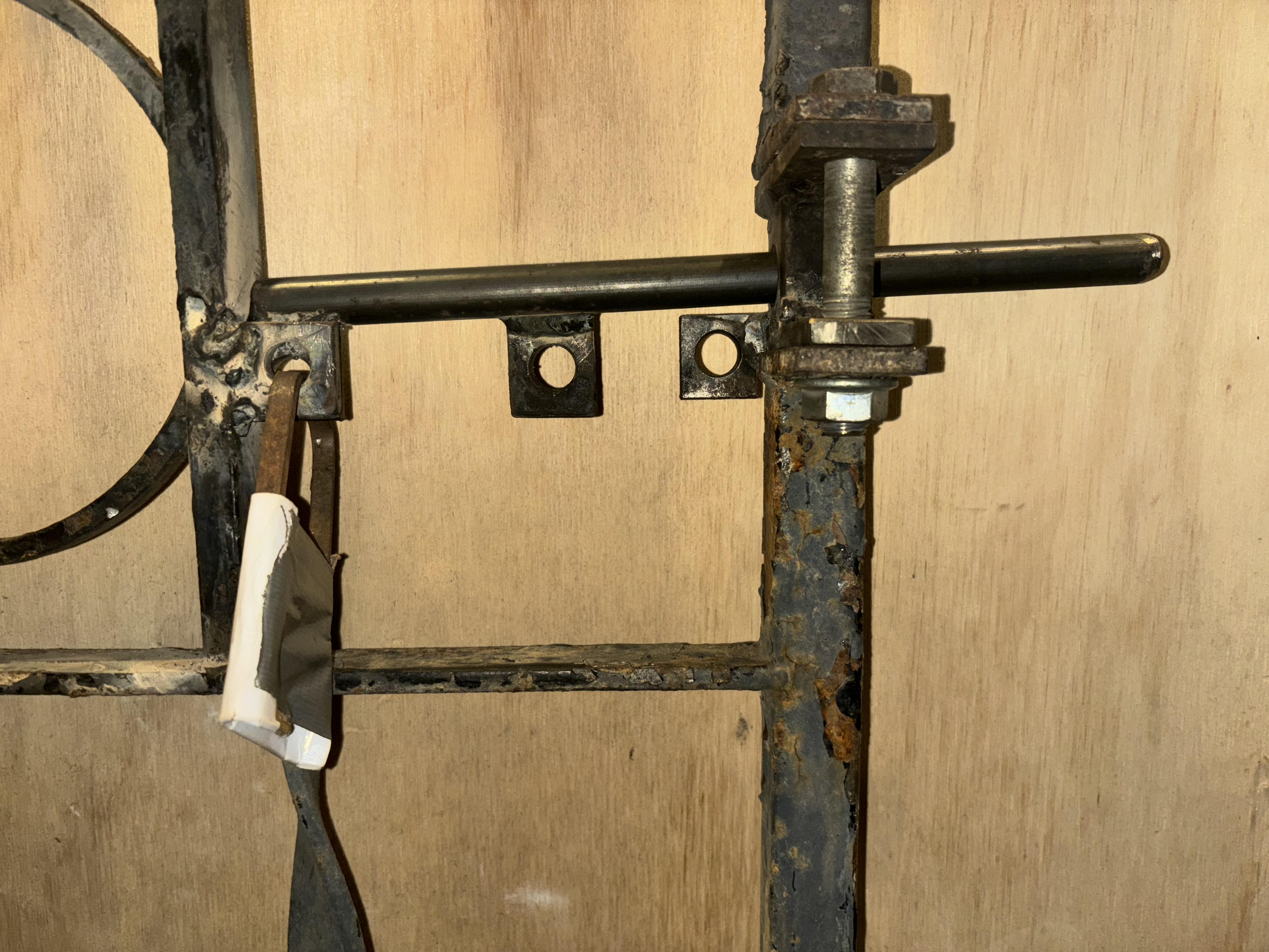

Finished up a quick fabrication job for the brewpub. Apparently, federal brewery regulations require a lockable closure between brewing operations and anywhere the general public might be. So, in the interest of making something comparatively inexpensive yet functional, I cut apart and welded back together again pieces of a couple of stair and porch railings, together with some simple hinges and a bolt that can be padlocked either extended or retracted.
Still needs cleanup and paint, but you get the idea.
JHCC, yes very cool reuse. I do think i would have made 4 more of those "C" scrolls for the otherside, kind of balance it out. But regardless nice work.
Larks, that gouge is truly top notch. I have made a few but nothing like that. Until i started making them i never realized just how long one is.
