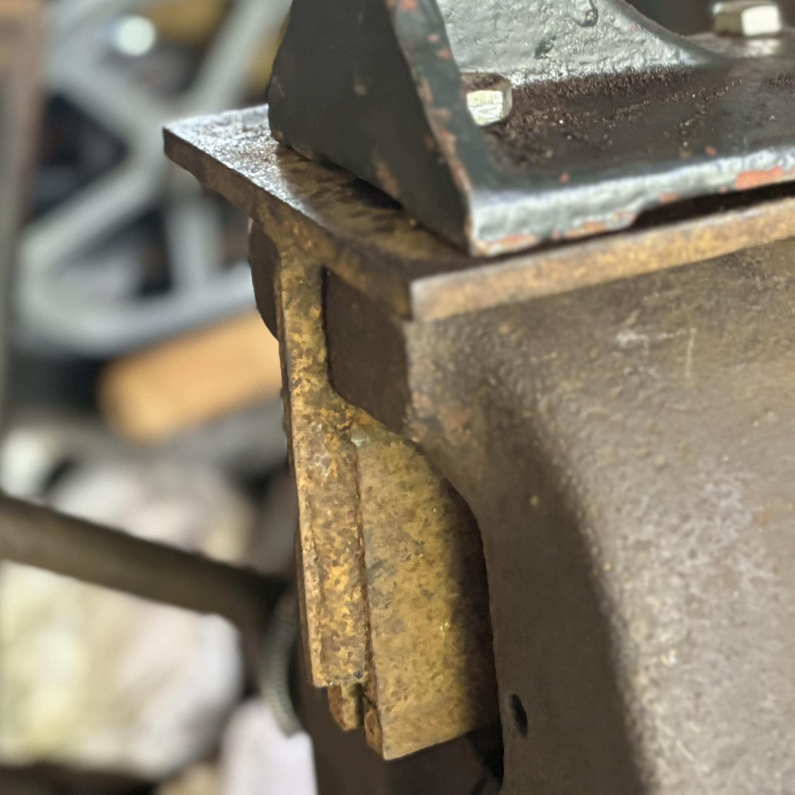

Good idea on the shear.
The scrap of I-beam I used for the bracket is actually uniquely suited to the task, having some extra plates welded onto the vertical member about 1-1/4” below the top.
Because the jaws are trapped between the top edges of these plates and the underside of the top, there’s tremendous resistance to them twisting, which makes the whole thing much more solid and controllable.

Having the mount it lock into the vise beats just relying on squeeze. Good one John!

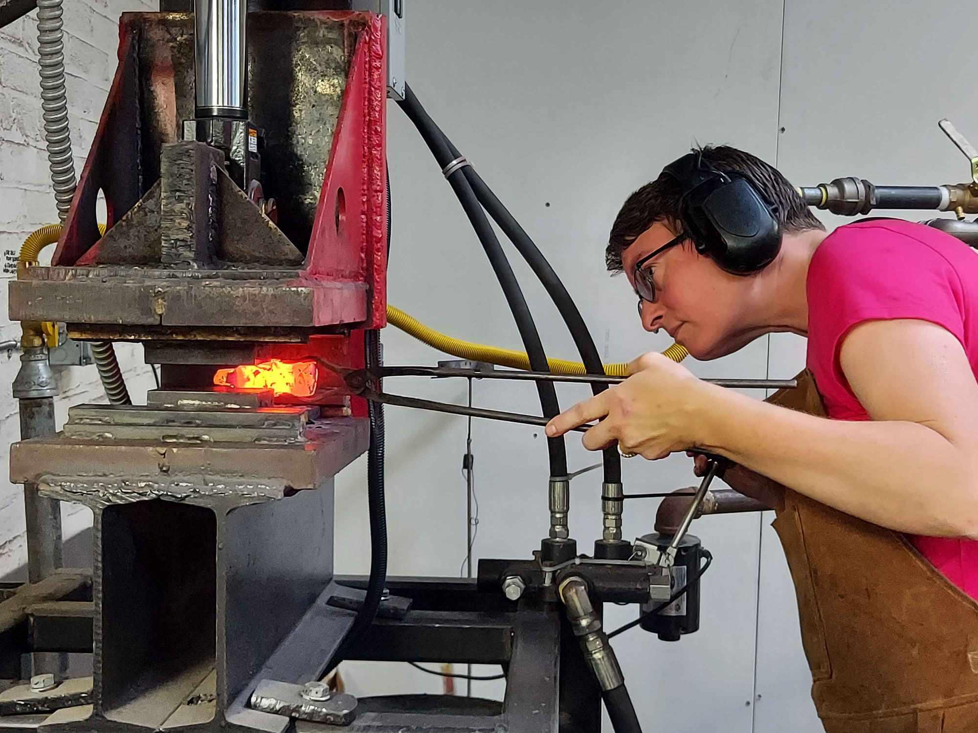

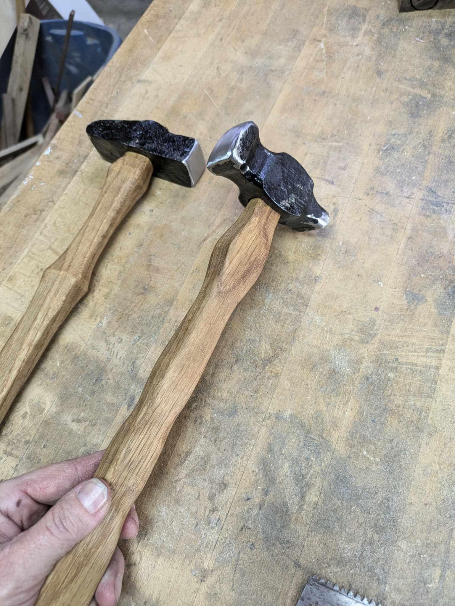

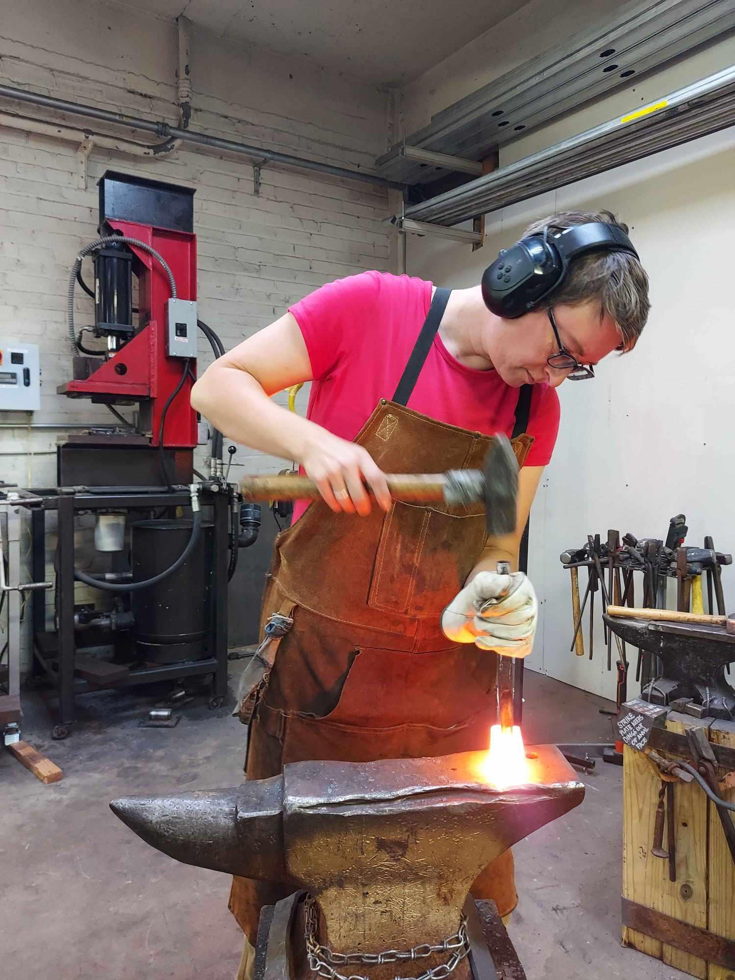

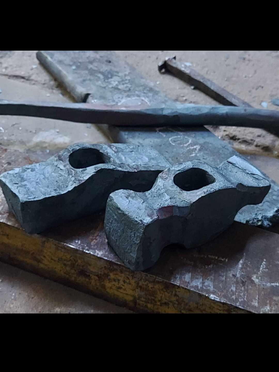

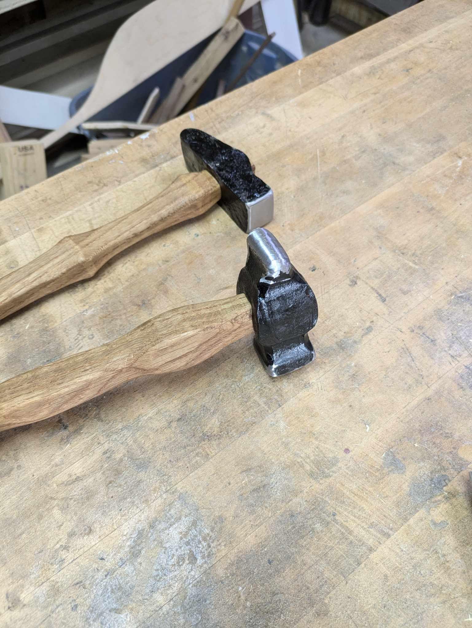

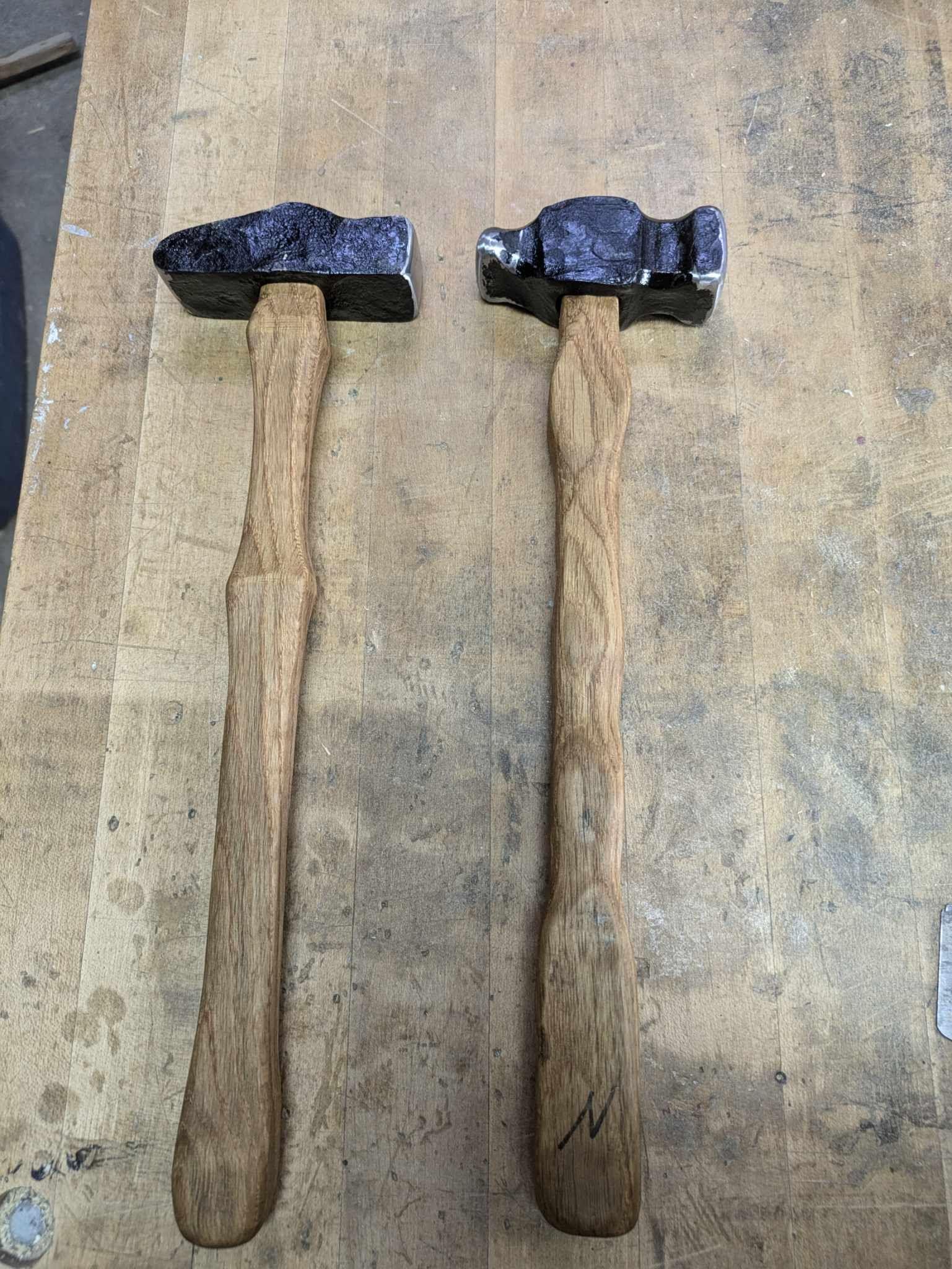

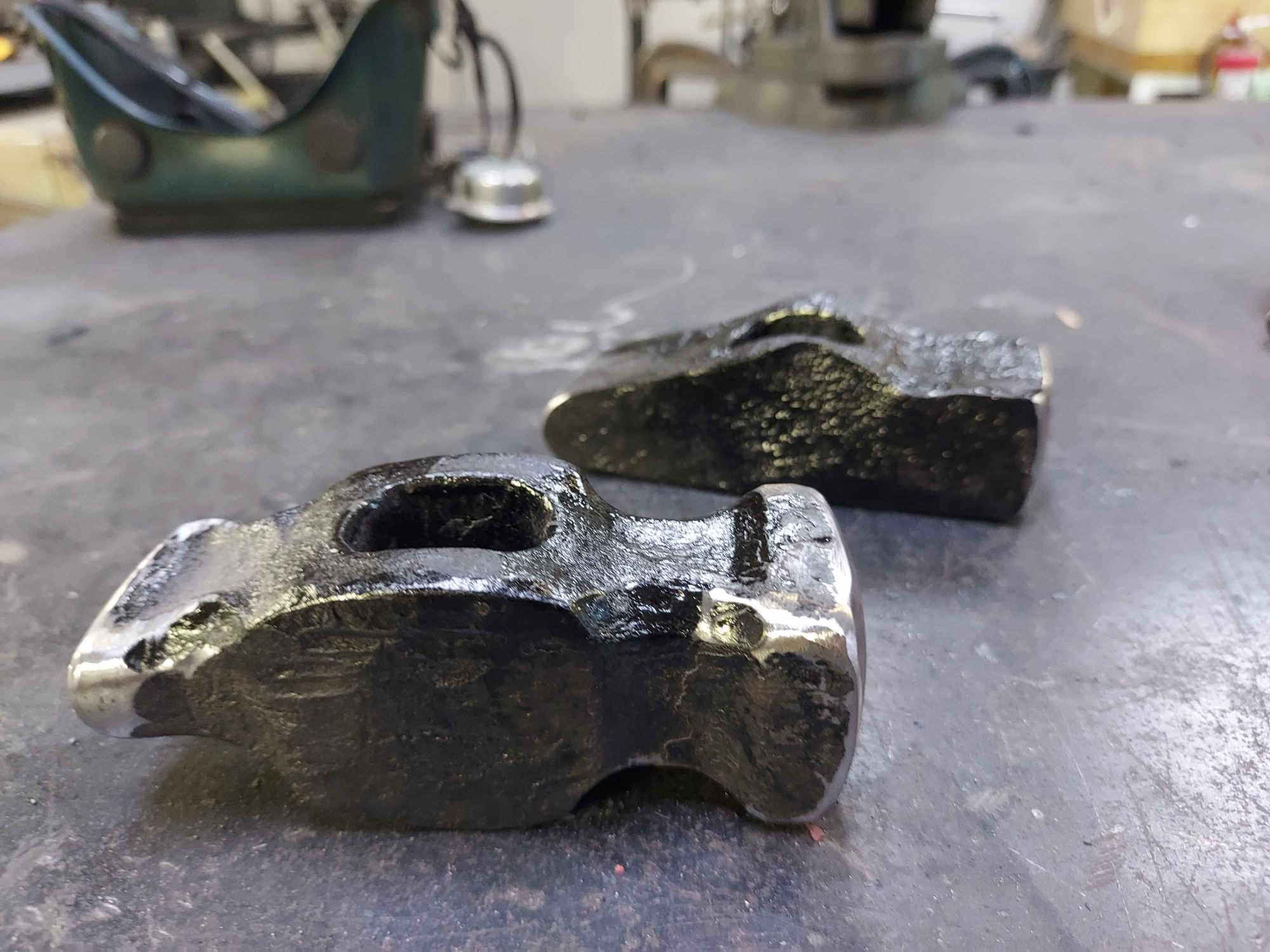

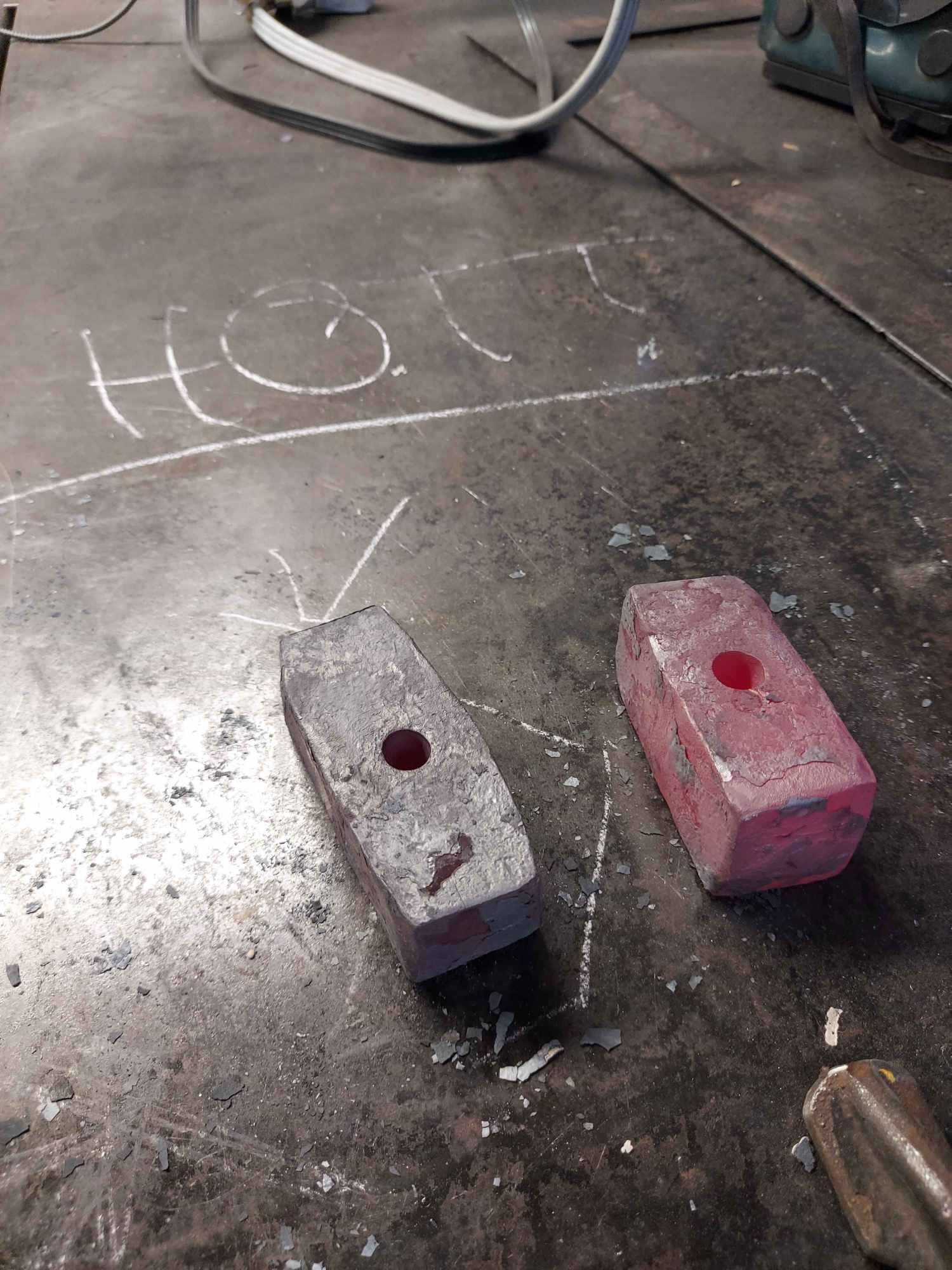

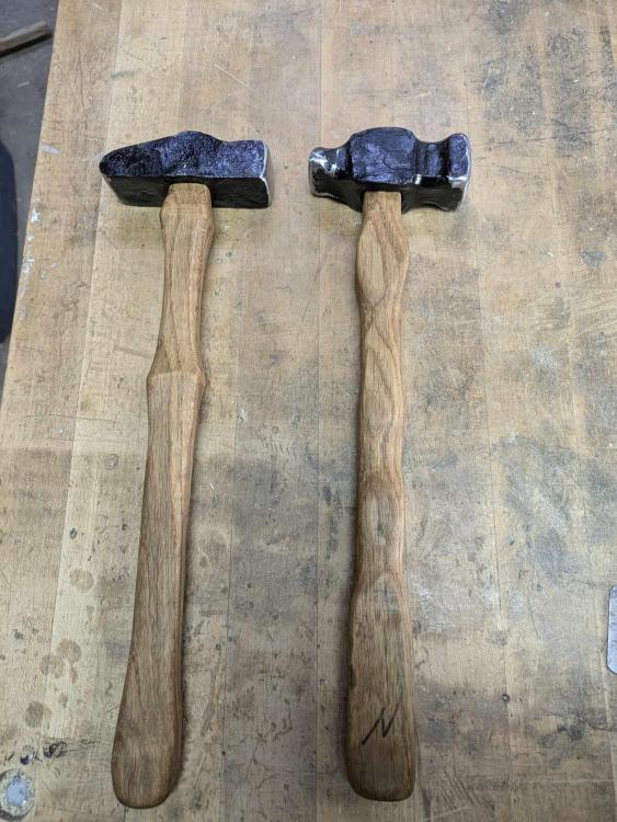

I won a hammer class from a fundraiser auction I bid in back in July for the St Louis maker space Arch Reactor. It was in St Louis which is a little over 3 hours drive so my wife and I decided to make a mini vacation if it. Apparently, the money I donated funded a portion of the hydraulic press they added to the blacksmithing shop. I'm very grateful for that since we definitely used it to our advantage during the class!

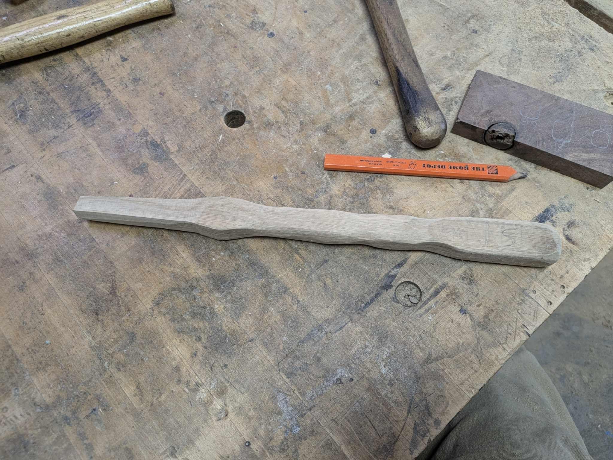

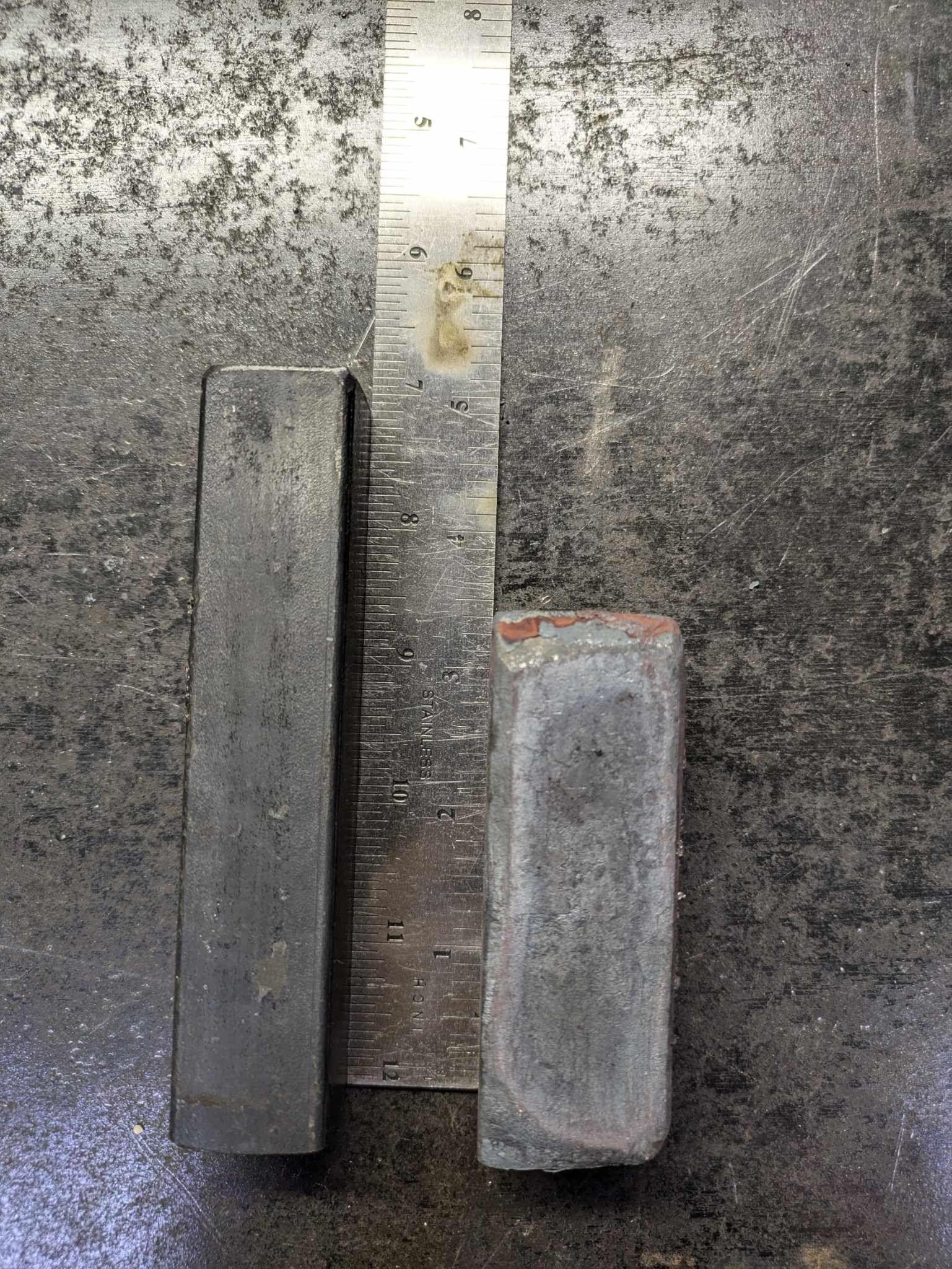

Day one was punching and drifting the eye then forging to shape. We started with about 5-1/2" of 1" square 4140 and used the press to upset it to about 4". Day two was rough grinding, heat treating, finish grinding, making the handle and mounting the handle. Day two was harder than day one. But now that I have the concepts, I can play around with making handles from scrap wood at home and when I feel like I've got a good grasp of the skill then I'll make some new handles for my other hammers.
Mine is the curvy one in the pics. The other one is the instructor's (Gideon Reese).
Wow, lovely job and it looks like a very handy size, what did it end up weighing in it!! If you don’t have one already you now need your own stamp if you’re going to make more:)
I haven't weighed it yet and now it's in my car, lol. I'll try to remember to get it weighed tomorrow but it'll have to be a guess because it'll include the handle weight.
I don't have my own stamp yet. I keep trying to make it and failing, lol! I'm getting closer though. I also got a quote from a company to make it for me - but that's money I'd rather spend on something else so I haven't gone that route yet either.
Nice job Shaina! I like the pein, it has a radius wide enough to move metal without putting sharp divots in it. I've become fond of longer whippy handles, yeah, been hanging around farriers I know. A whippy handle lets me hit harder with a lighter hammer by cracking it like a whip. Accuracy is more important but it works out well for me.
I guess what I'm saying is I think I'd like to use your hammer as a regular.
Thanks, Frosty - and I agree, when I want to move metal - usually stuff larger than 1/2" - I've come to prefer the 2lb ball peen I have with the longer handle and whipping it. When I need more accuracy, I grip closer to the center/top and lose the whipping motion. I haven't compared yet but I think this handle might even be longer than the ball peen I prefer. I'm probably going to cut off the bottom portion about where the 'N' is. Then shape that back to a rounded bottom. But I'll try it for a few sessions as-is first.
Gideon also gave me some instruction on striking - even though we ultimately didn't go that route. I feel like I have a good grasp of the concept - but not enough confidence to join a striking circle. I'm going to see if I can convince Ashley to hold a bar for me while I practice striking. First though, I need to either get a new sledge or try my luck at handling the one I have because the handle broke on it during the move back in June. Obviously hasn't been high on my priority list, lol

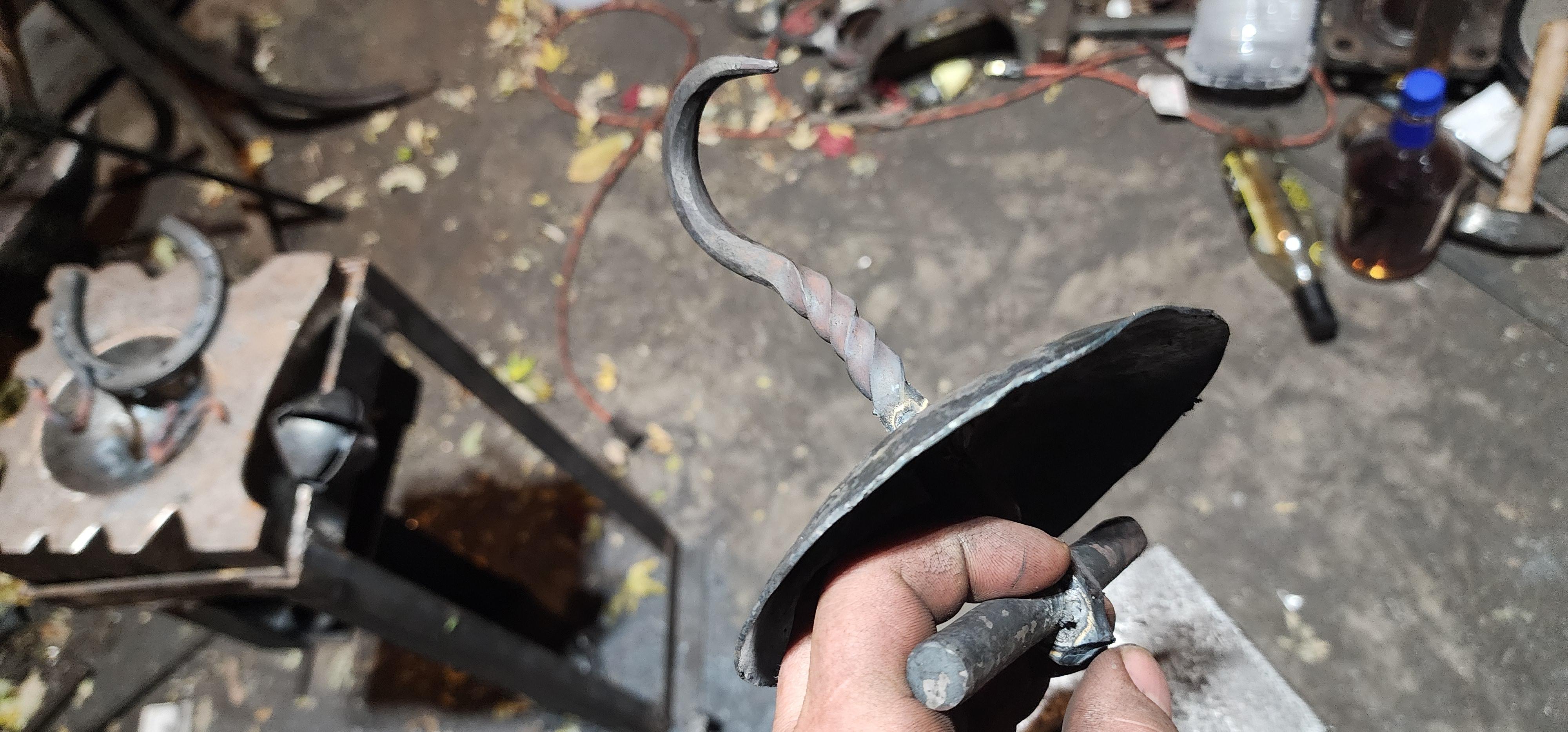

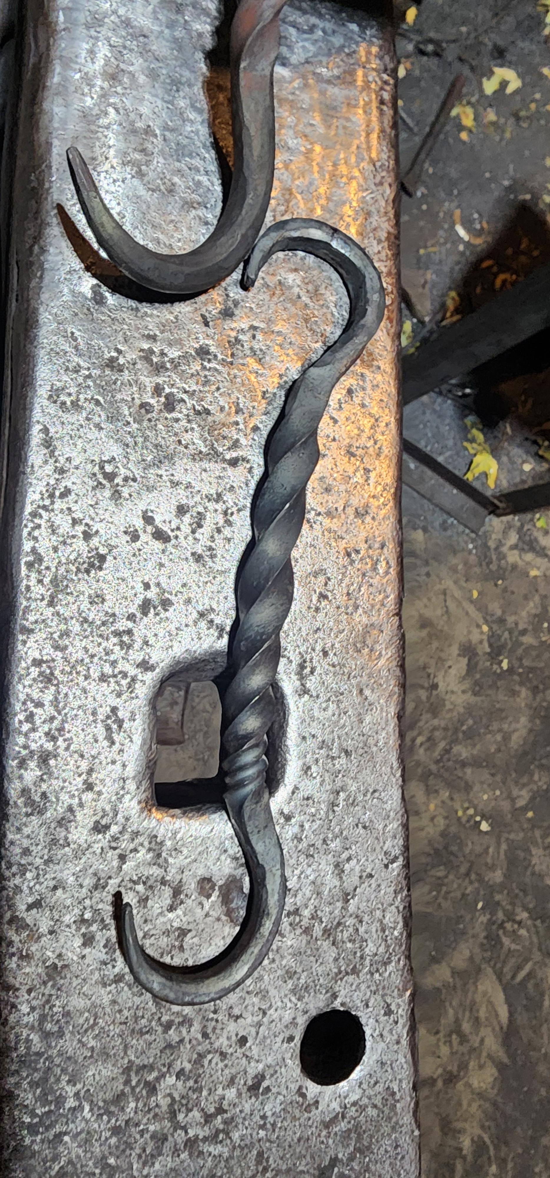

Anyway, tonight I did some nautical themed stuff,  sailmakers hook and a fake hook hand.   They both turned out great and I completely forgot to take pictures of them.   Maybe I'll run out in a minute and take one.

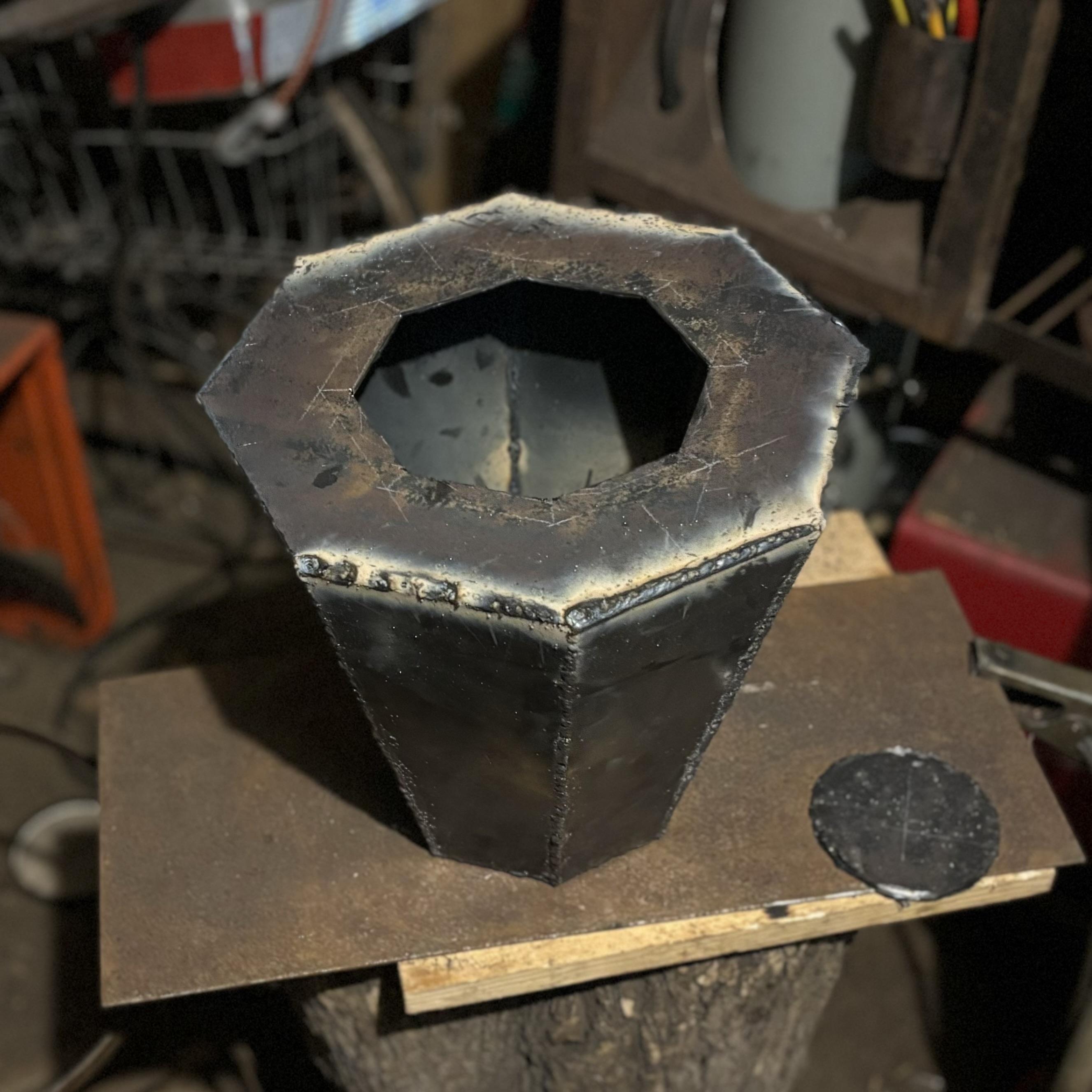

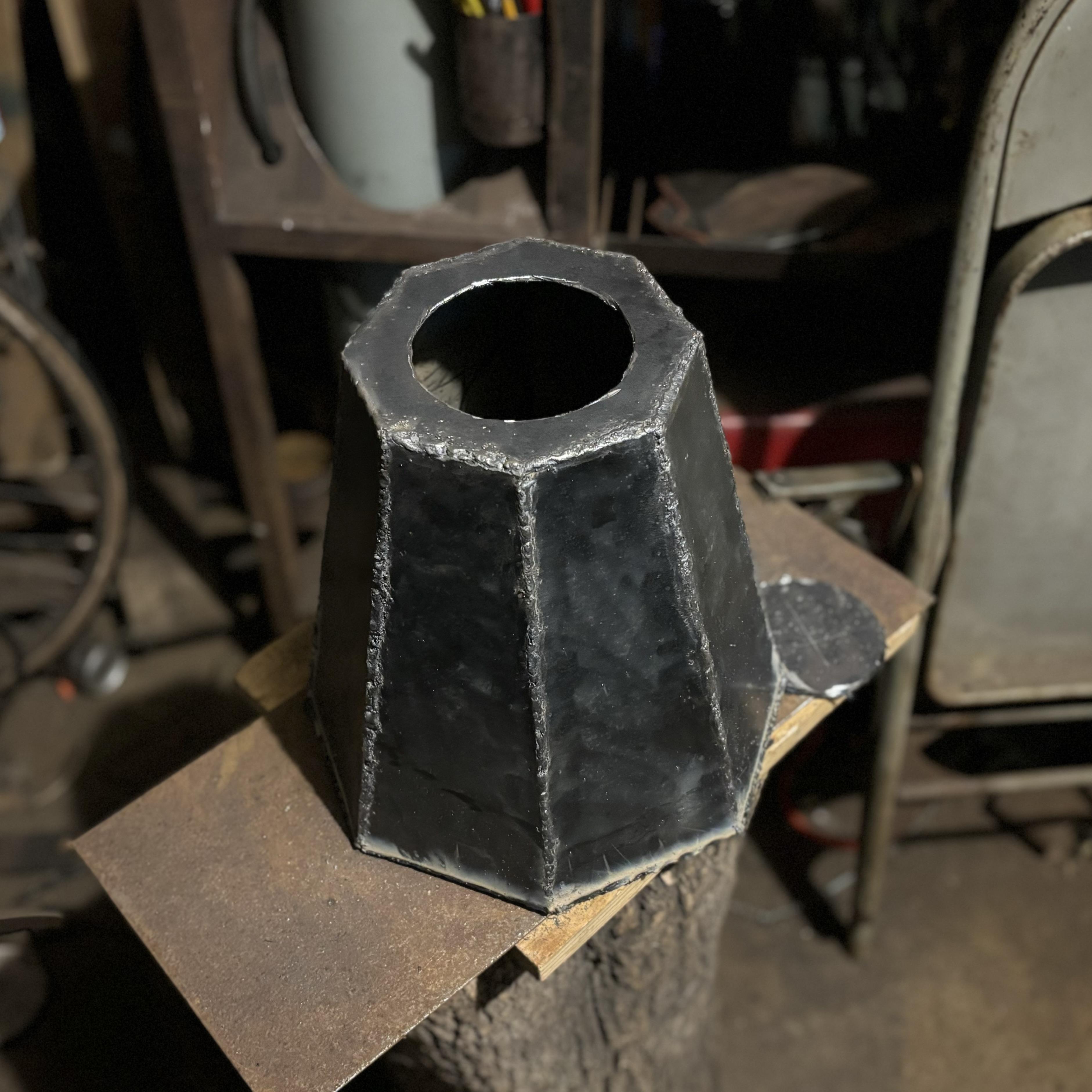

Getting back to shop work, I started fabricating the shell for an Eric Thing-style armor forge. 6” across the top, 11” across the bottom, about 10-1/4” tall. This will get lined with 2” of ceramic wool and 1/2” of Kastolite and will be powered with a NARB running a 1/2” Frosty T-burner.
More to come….
(For those not familiar with Eric Thing’s armor forge, there’s a page about it on Anvilfire. I plan to use it for forging bowls.)
By the way, in cutting up the 16ga. sheet for the shell, I discovered a few problems with the shear: (1) the blades are a little too wide, so you can’t adjust the gap between them, (2) the upper blade has a broken screw, so it moves around a little during cutting, (3) the bottom blade doesn’t sit down solidly on its bed, and (4) the clamp that holds the bottom blade down is too long and sticks up above where it should, getting in the way of the workpiece. I think I should be able to fix all of those, though.
Those sound like maintenance issues and probably why it got shelved until hubby's shop got cleared out and you rescued it.
