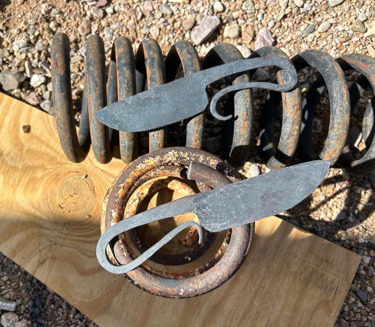

1/2” and 3/4”, going to heat treat today if possible.

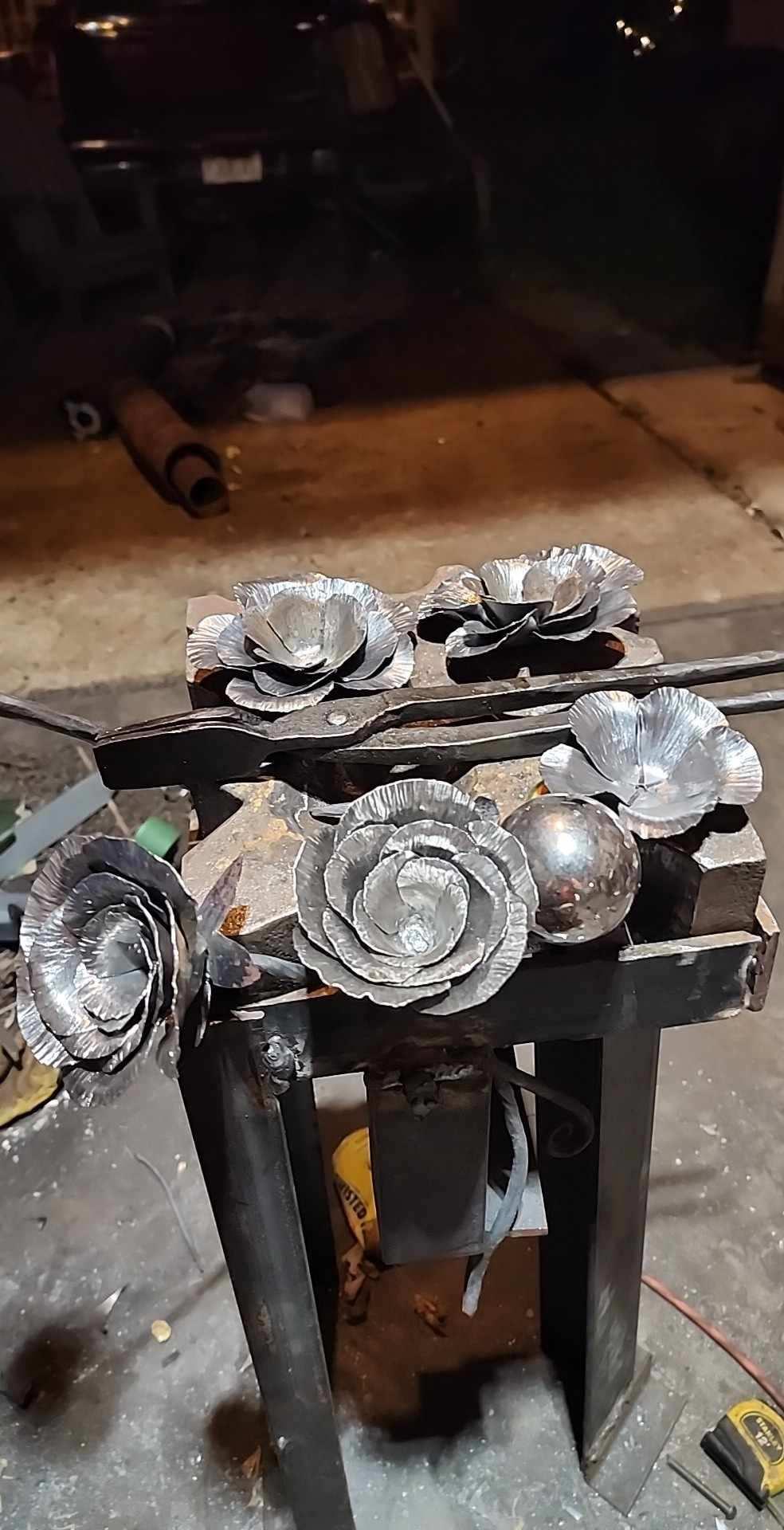

I'm having to build more roses,  sold out at the show on Saturday.  Only had three but still, didn't expect them all to go.
Very nice Chad, you're getting good at roses!
What's going on is, it's looking like John needs an intervention. Join Das and I giving John a group cyberhug!
Nice work Chad. One of the best compliments to your work is people willing to pay you to own it.

Thanks guys!  John, let me know when the tappers are on and where.  I'll go on a road trip to support that kind of stuff.
Your roses are looking great. I bet if you had one to spare it would look terrific in the bouquet Steve is trying to put together for Glenn's memorial.

I agree those roses are fantastic!

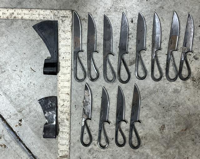

I’ve been working on trying to get inventory together for an upcoming demo/festival and haven’t posted many pictures of my progress. So, here’s what I’ve been doing in the forge for the past couple sessions:
12 blacksmith knives from 52100, (bottom 4 still need to have the rough edge sharpened), and two tomahawks. Top hawk is ready for and edge. The bottom one is ready for the bit weld (then the real work of overall refinement).
Lots more to go!
Keep it fun,
David
Chad, if you don't mind my asking, how much did you charge for them?
G
Don't mind at all.   I was charging 110 each.  I'm considering raising that a bit more the way they are leaving my tables right now.
When I was working in the furniture business, my boss liked to price things just high enough that the last one would sell right before the next batch became available.
Lovely knives, Chad.
John, I like that twisted up C channel. I'll have to keep it in mind next time I do another sea sculpture because I think it captures the element of seaweed wonderfully!
When we had our business going and at craft fairs etc. We would always price our goods higher than what we thought they were worth because of haggling. Sometimes items would sell for the listed price, even though we had a sign that said Haggling accepted. Most folks love to haggle at those venues.

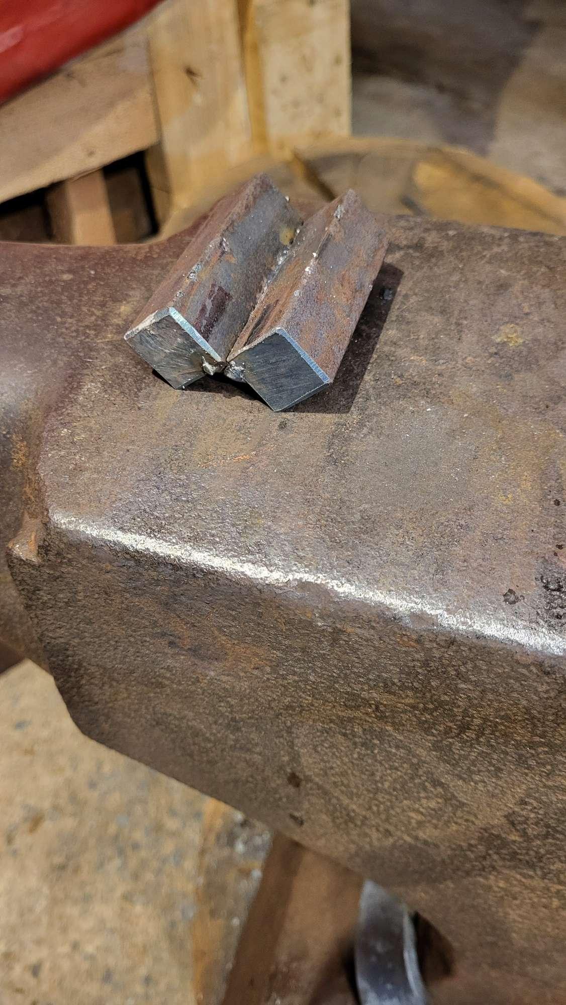

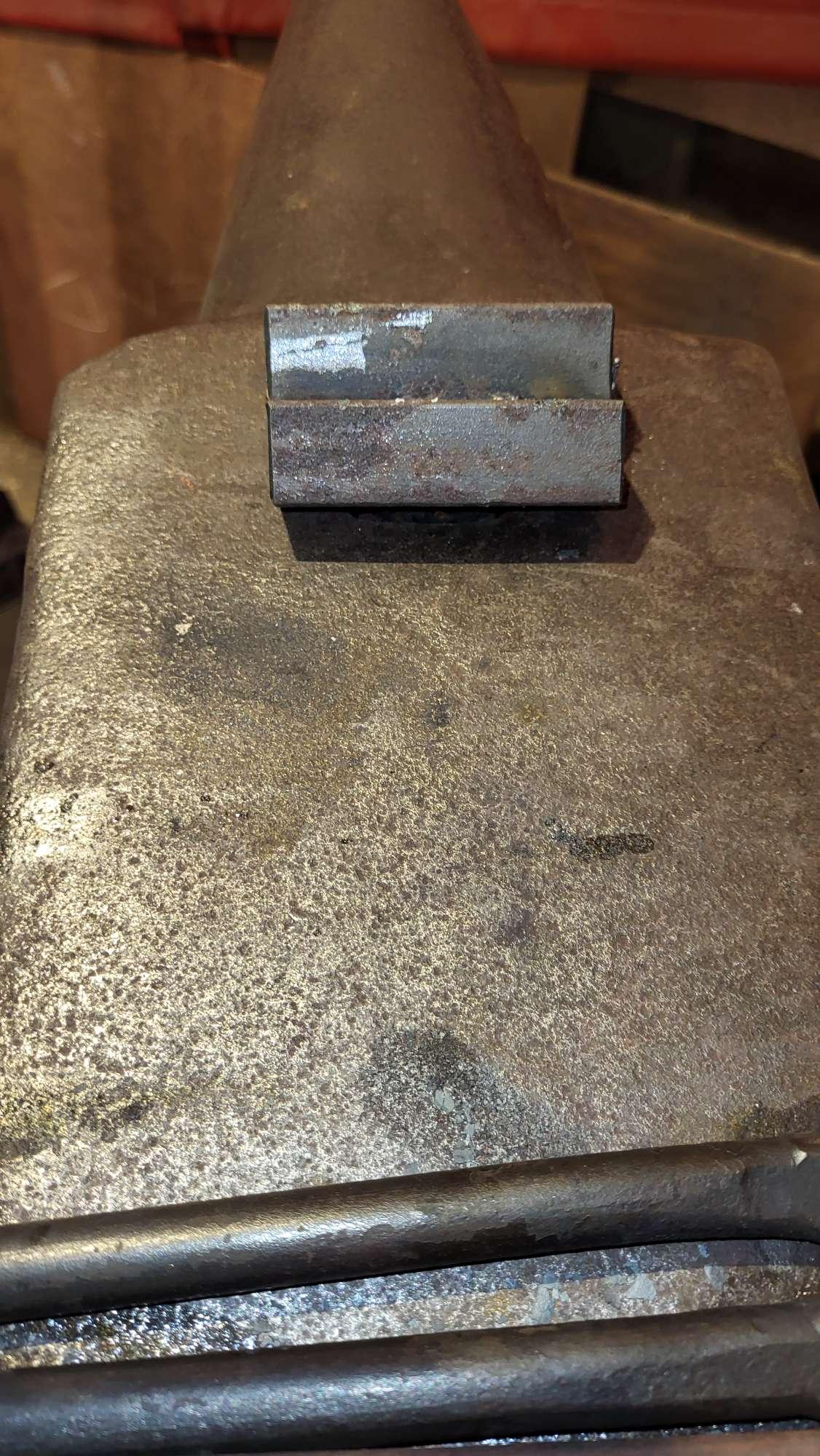

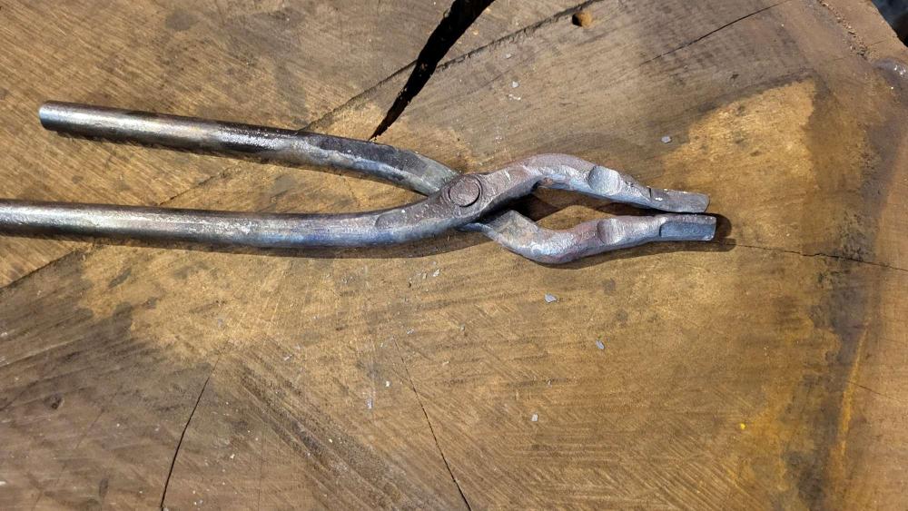

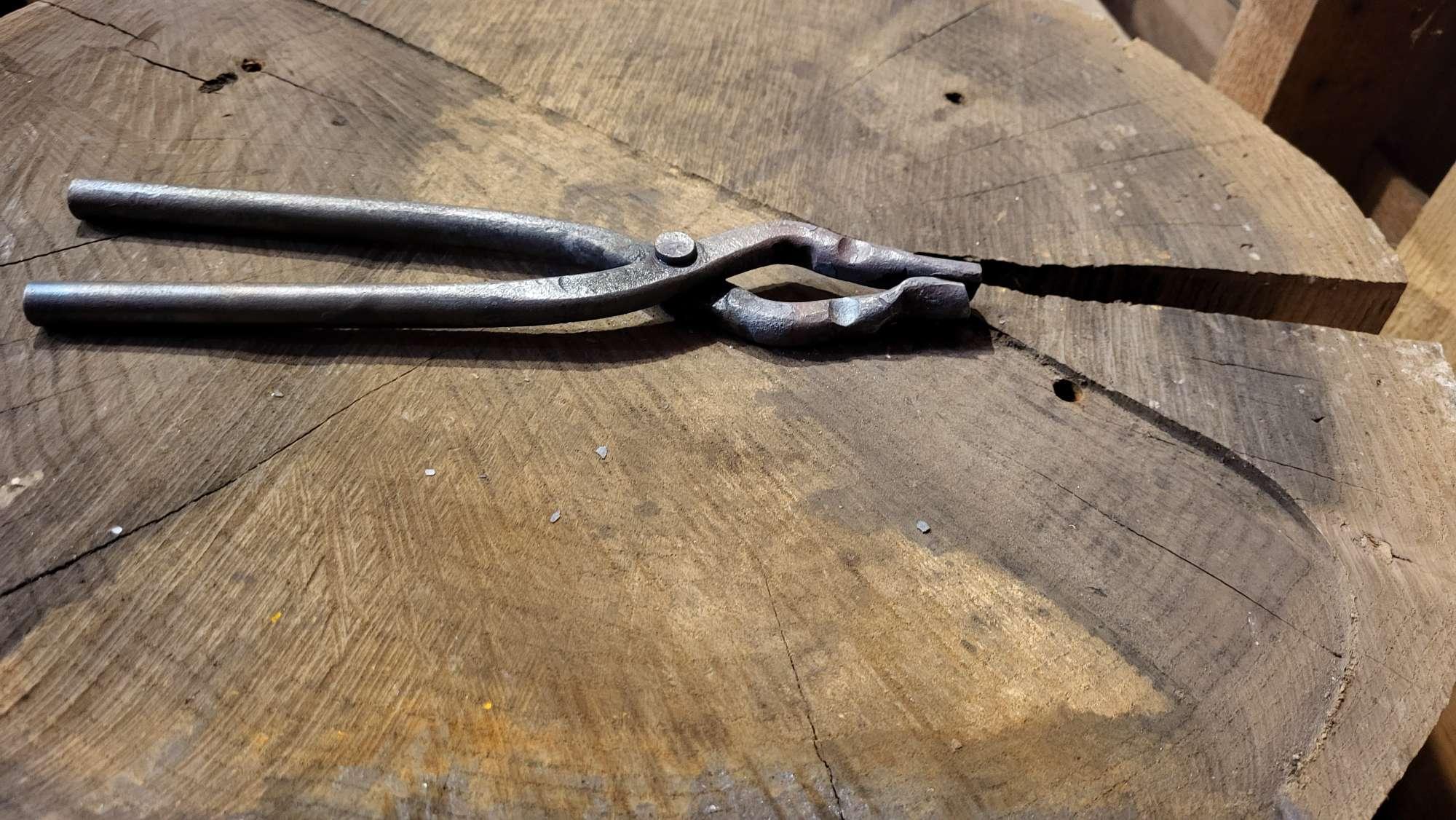

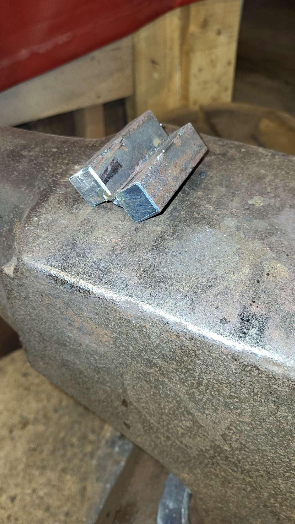

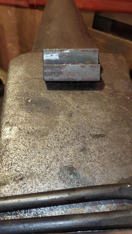

Some bits and boba I needed.
A V-blok quick and easy from square 20mm

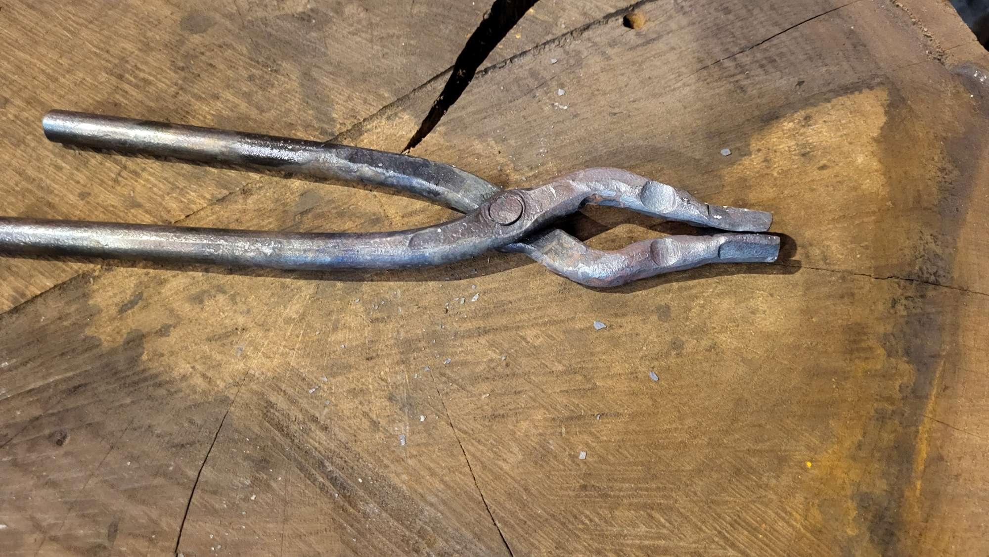

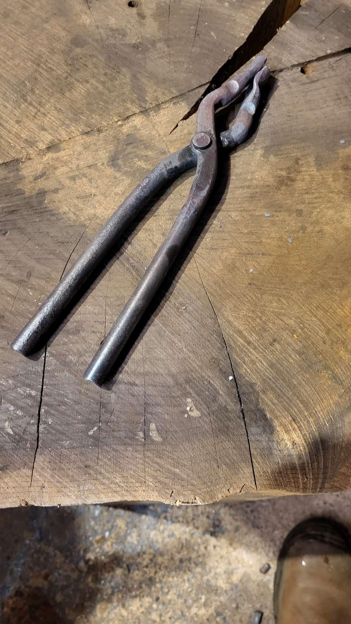

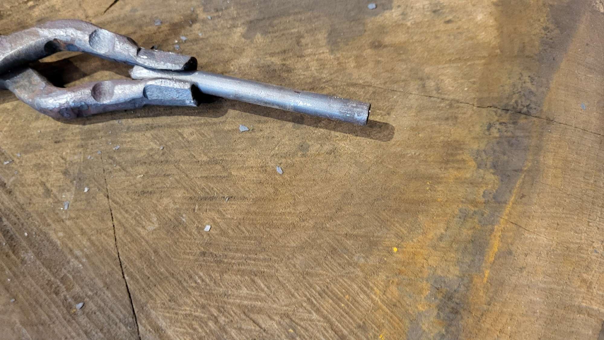

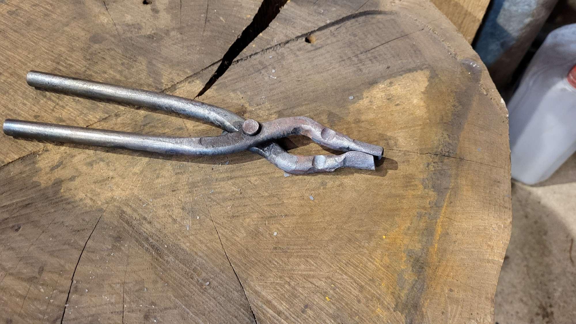

Amd a small tong GS-tong style for small stock, will hold 5mm round safe, max 8mm. Perfect for small leafs and hooks and stuf like that. Made them short, but bit to shory I think. Will see in use, i can always draw out the reigns.
Nice job, Gewoon.  What style forge do you use?  I can see this not causing a warm hand with a coal forge but some style of gas forges... My small pieces always seem to migrate to the very back of the forge.   Yes, I did put a back door on it for that reason...
Gasforge.
Made them from 250mm long bar. But underestimated the length needed for the jaws.
We see, it is mild steel and winter is coming
