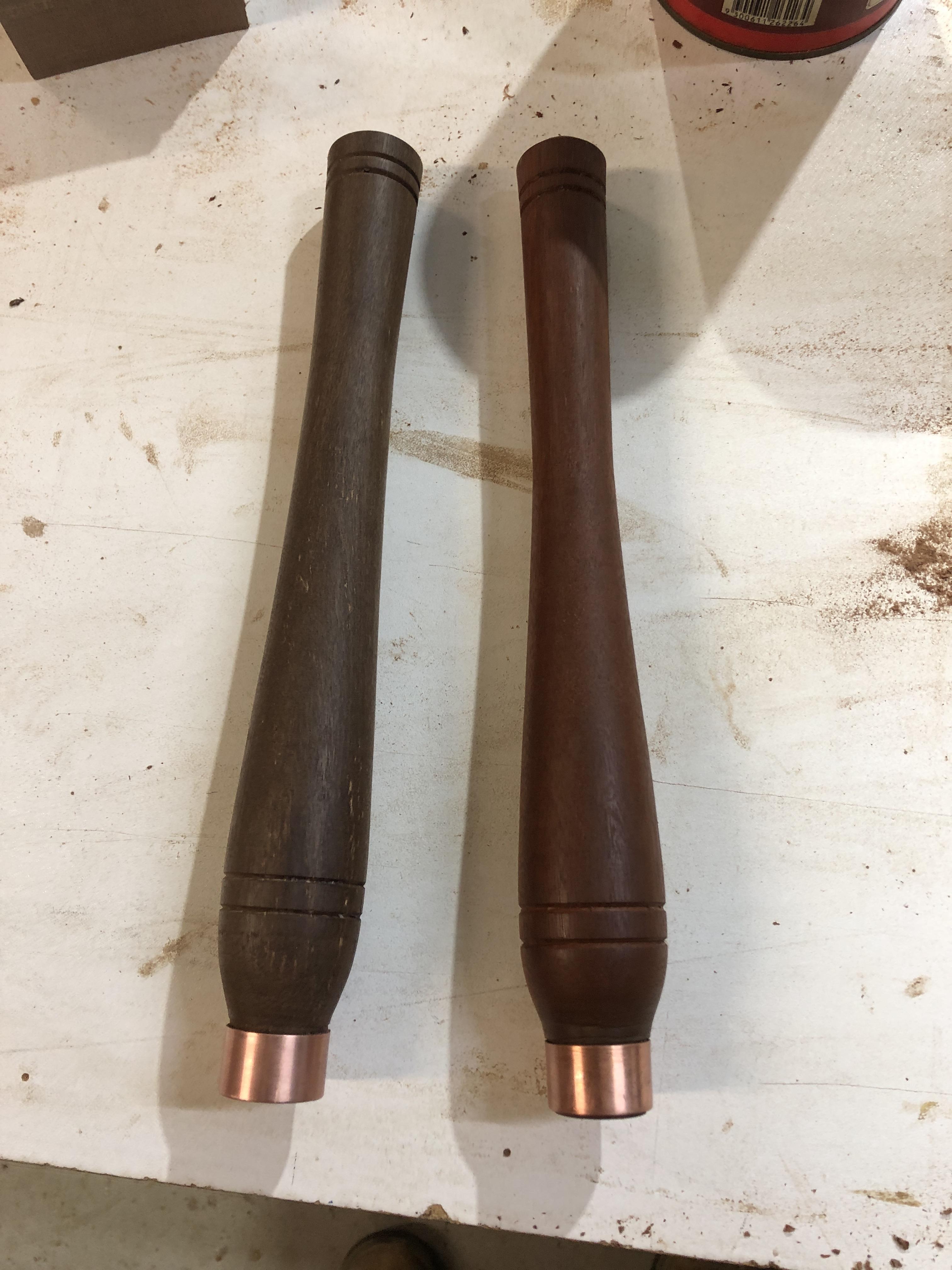

Larks, that's a beautiful gouge. Did you make the handle as well?
  • Replies 30.4k
  • Views 2.8m
Thanks for the comments on the roughing gouge guys.
Shainarue I’m very much a beginner on the lathe but I turned the handle from a local timber called Blackbean or Moreton Bay Chestnut and copied the size and shape from a Robert Sorry chisel. I had made a second from Scented Rosewood, which is a delight to work with and really smells of roses when you work it but preferred the Blackbean one.

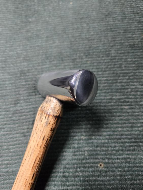

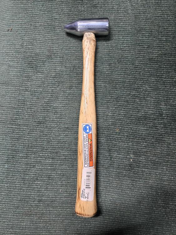

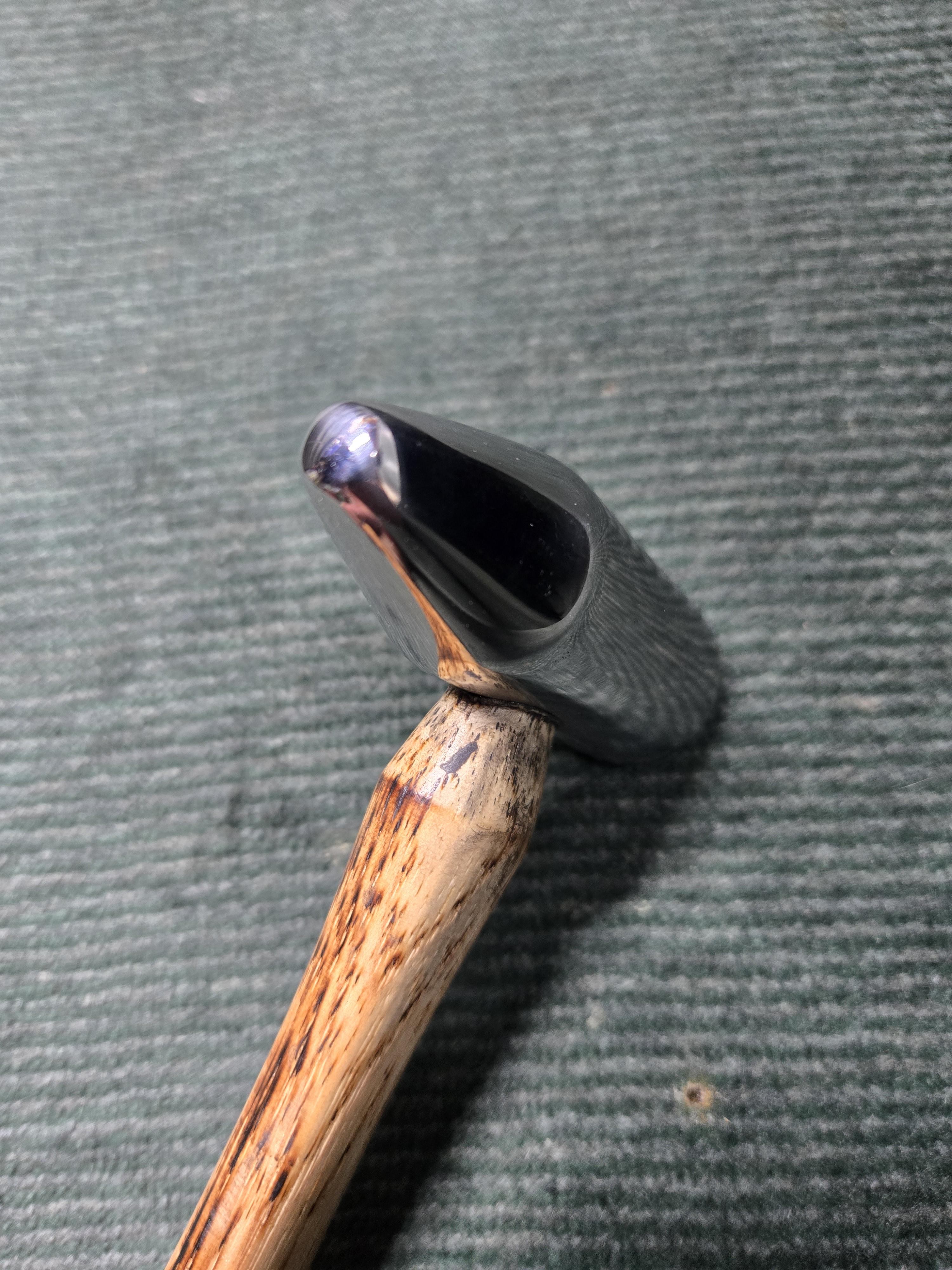

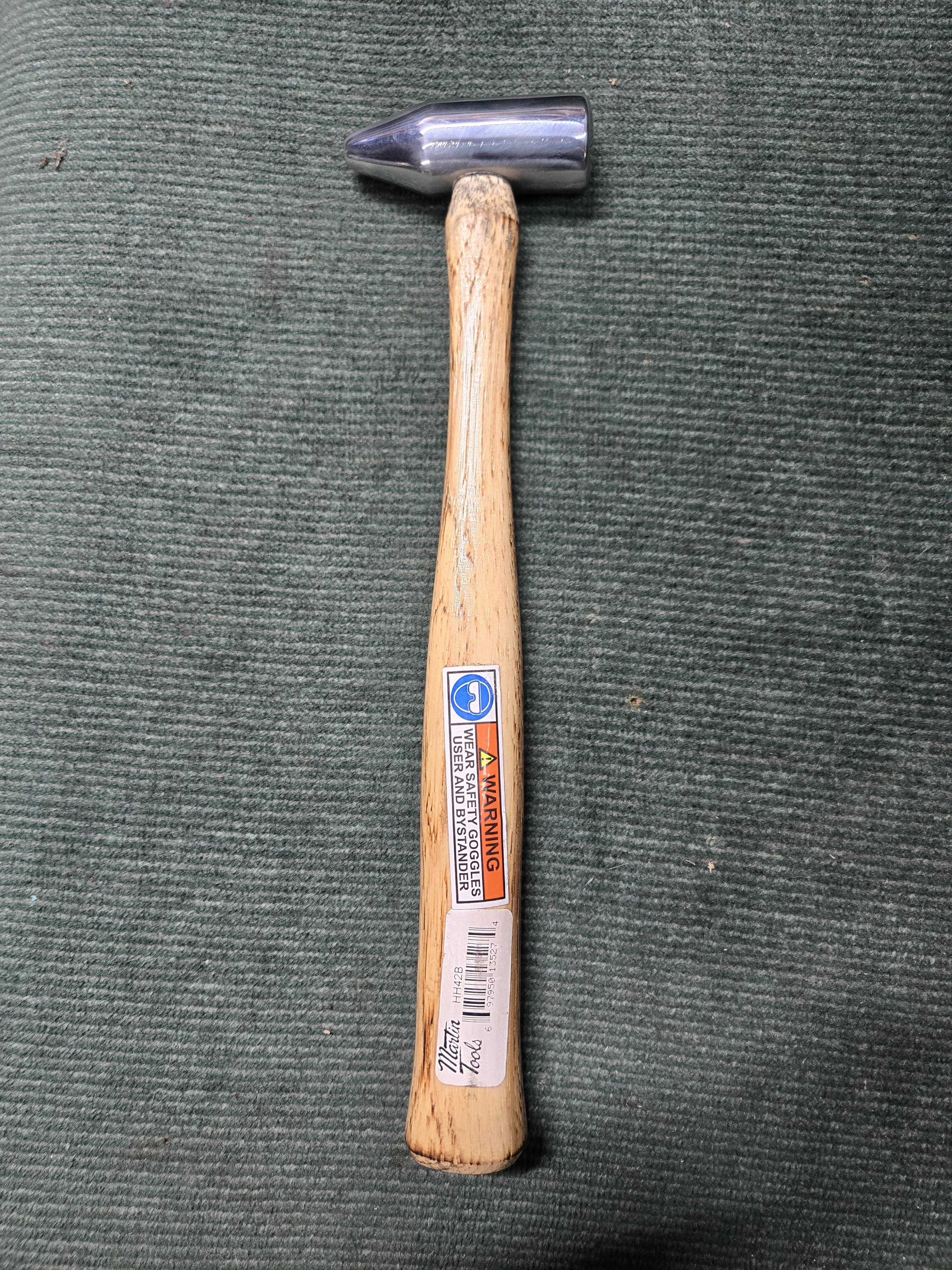

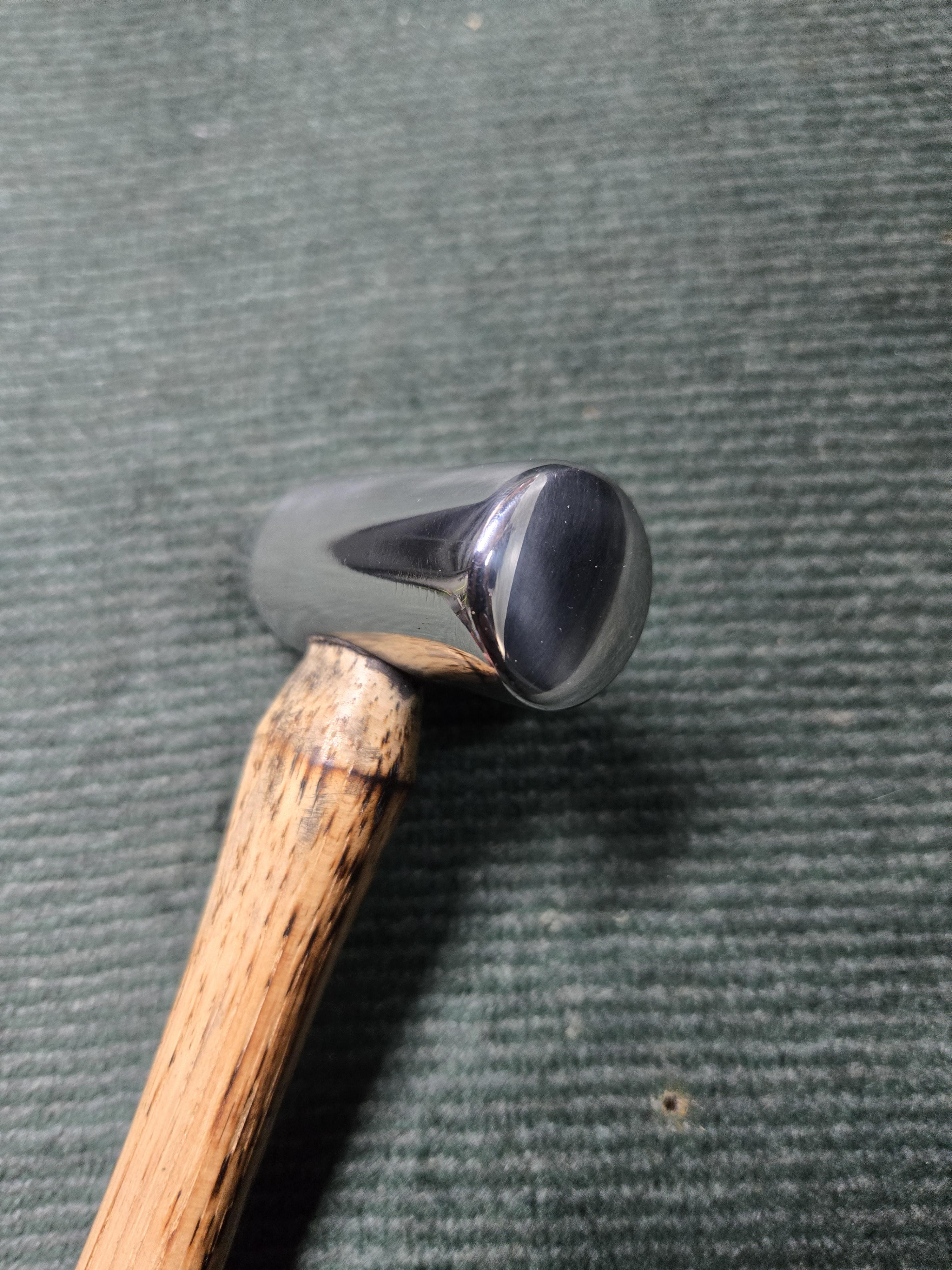

I made an autobody hammer this evening. Big face dia. is just under 1". And length of the head is 2 3/4". Handle is a Martin that I bought a few of. Head is made from random round bar stock, shaped, ground and polished.
Very nice Daswulf. Have you bothered heat treating it or is it for light enough work that it won’t need it? I often wonder about how to heat treat the “random” bits of stock that I collect along the way without knowing their origin or composition.
I didn't heat treat it. It is lower carbon, and it is for light work.
Before you put a lot of work into mystery metal, If you want to know if unknown steel will be hardenable first do a spark test to get an idea if it will work for the intended purpose. Second take a piece of that stock and forge it to a general thickness of what you are making then heat treat it to see if you get the results you are looking for.
There are some good threads on that somewhere here.
Thanks Rojo. Ihave a bunch of reassembling at the moment but as soon as I get to some repairs, I'll put it through the paces and see if it does the job.
Nice looking body hammer Das. Of course you haven't heard of the wood Larks made his gouge handles from, Australia grows things found nowhere else on Earth. It's like an alien planet landed there. :rolleyes:

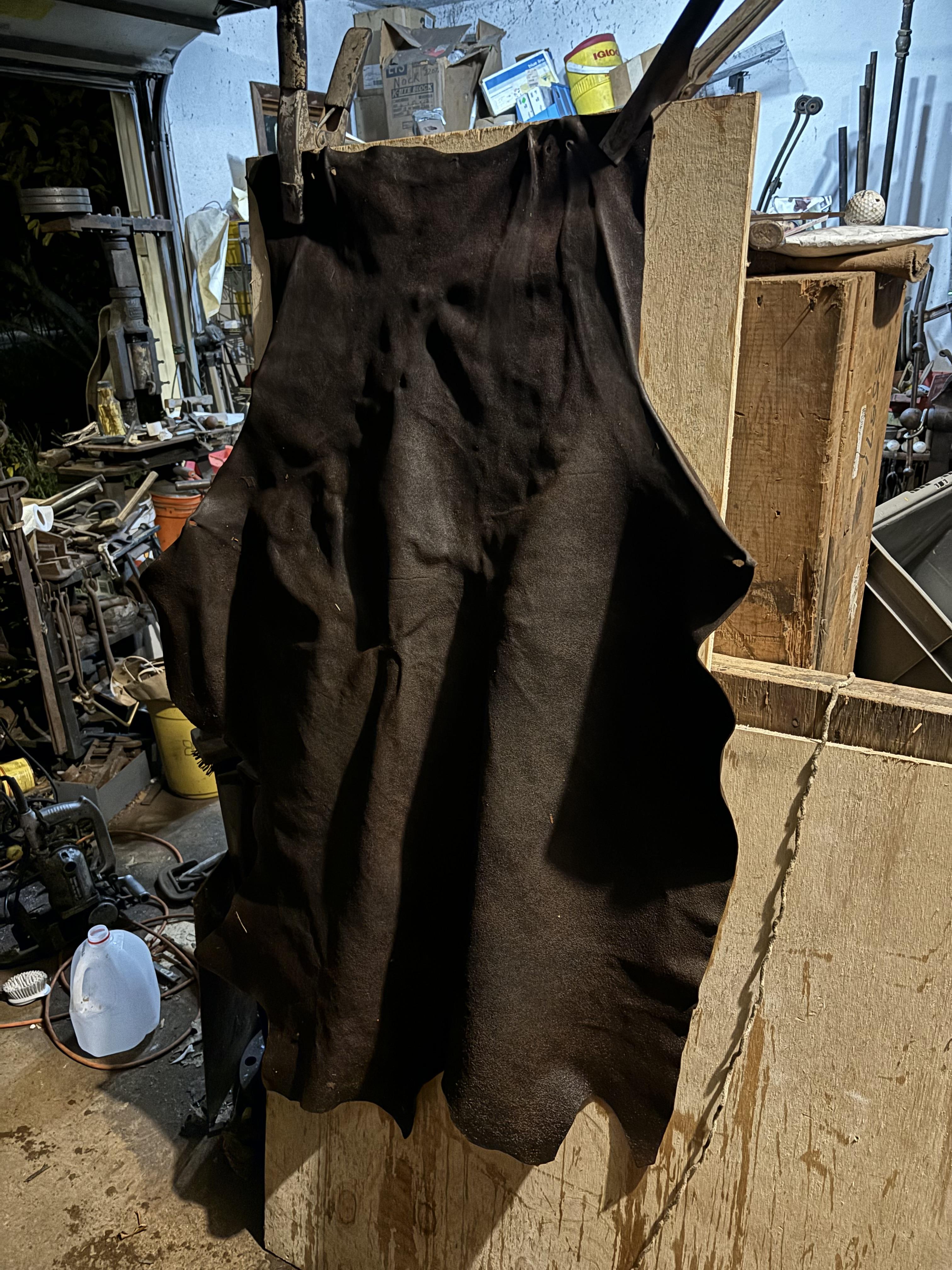

After not wearing it much lately, I discovered that my apron had become rather moldy. So, I scrubbed it down on both sides with a dilute bleach solution and hung it up to dry.
I was planning to make new straps anyway.
It'll want an application of saddle soap to clean and bring supple.
Rather than saddle soap I would use some neatsfoot oil since he has already cleaned it.  Moldy leather is not something we have to deal with in the semi-arid climate here.
G
JHCC, if you can get tea-tree or tea-tree oil solution it seems to be kinder to leather and leaves an anti fungal residue
We get a lot of mould here in Queensland and the tea-tree oil is what I use on my apron and leather furniture
It cleans the leather, kills the mould and leaves a nice smell.
When i worked in a tattoo/piercing shop we suggested tea tree oil on piercings.

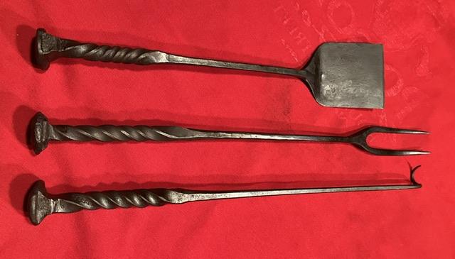

I cleaned up a couple pieces to go in a fundraiser auction (wood badge support for those involved in scouting):

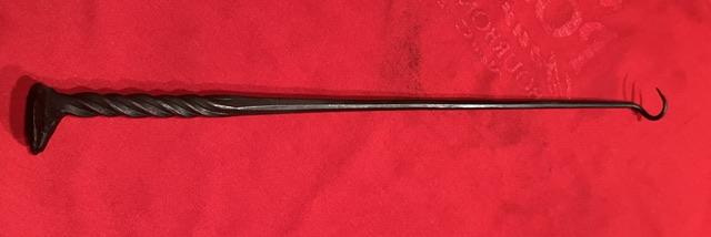

I also forge out about a dozen nails and an additional steak flipper:
No pictures of the nails. Not very pretty or interesting, this was the first time I’ve forge nails and it to a few to get the feel for it…
Keep it fun,
David

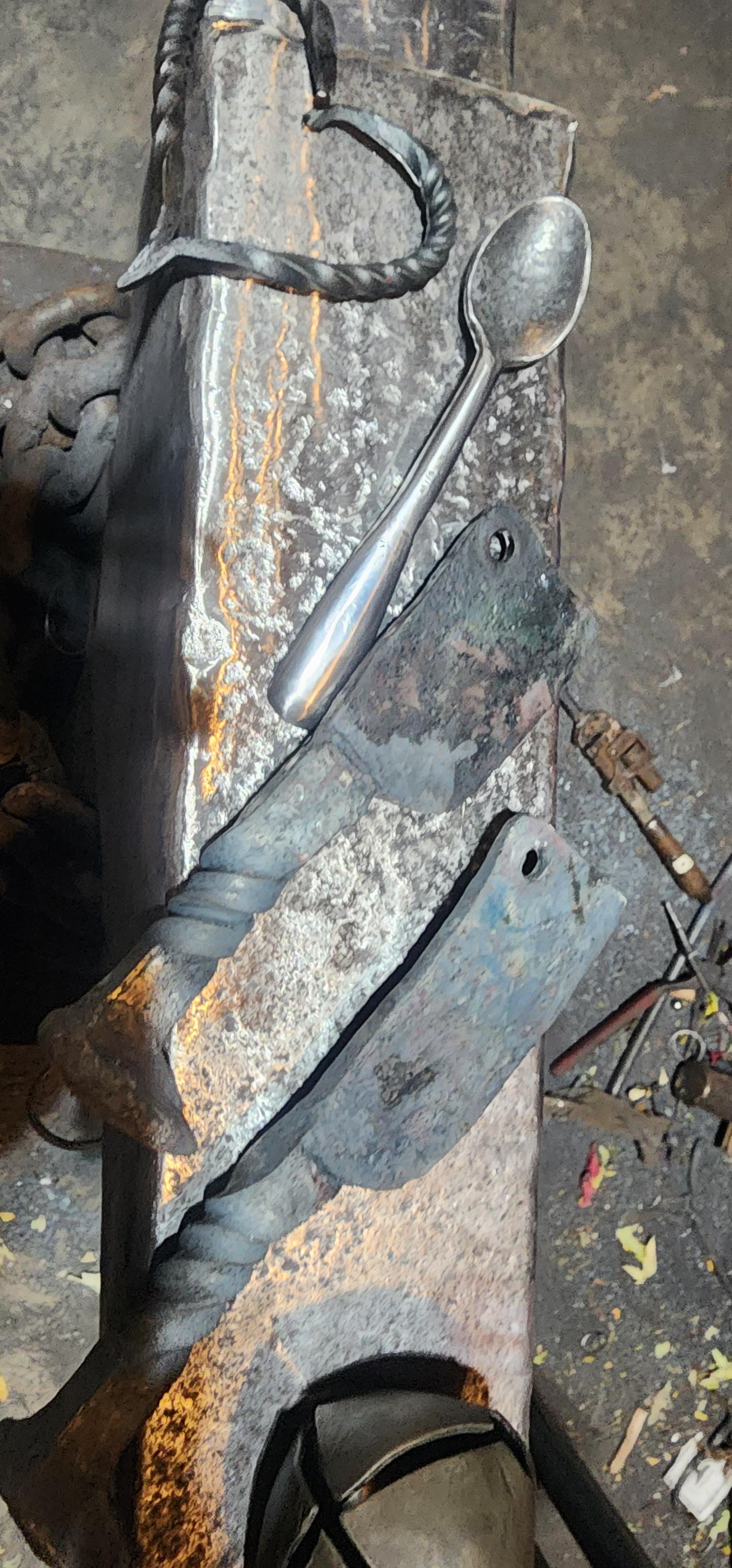

Fired up the new coal forge today.  Worked great but the coal I had was garbage.   Anyway made a couple of spike cleavers and I'm finally getting the hang of spoons.

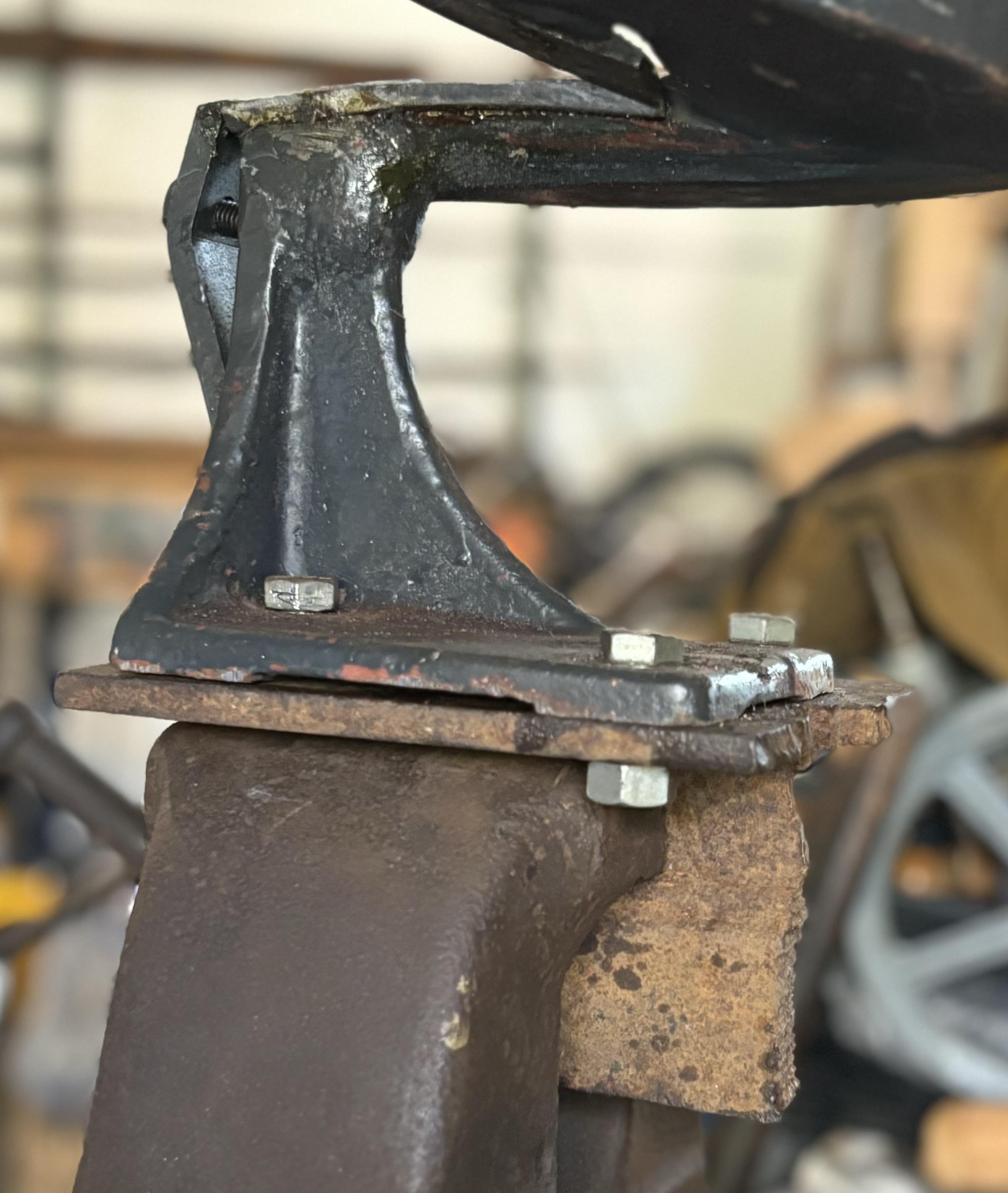

 Also made a bracket to hold the throatless shear in the vise:

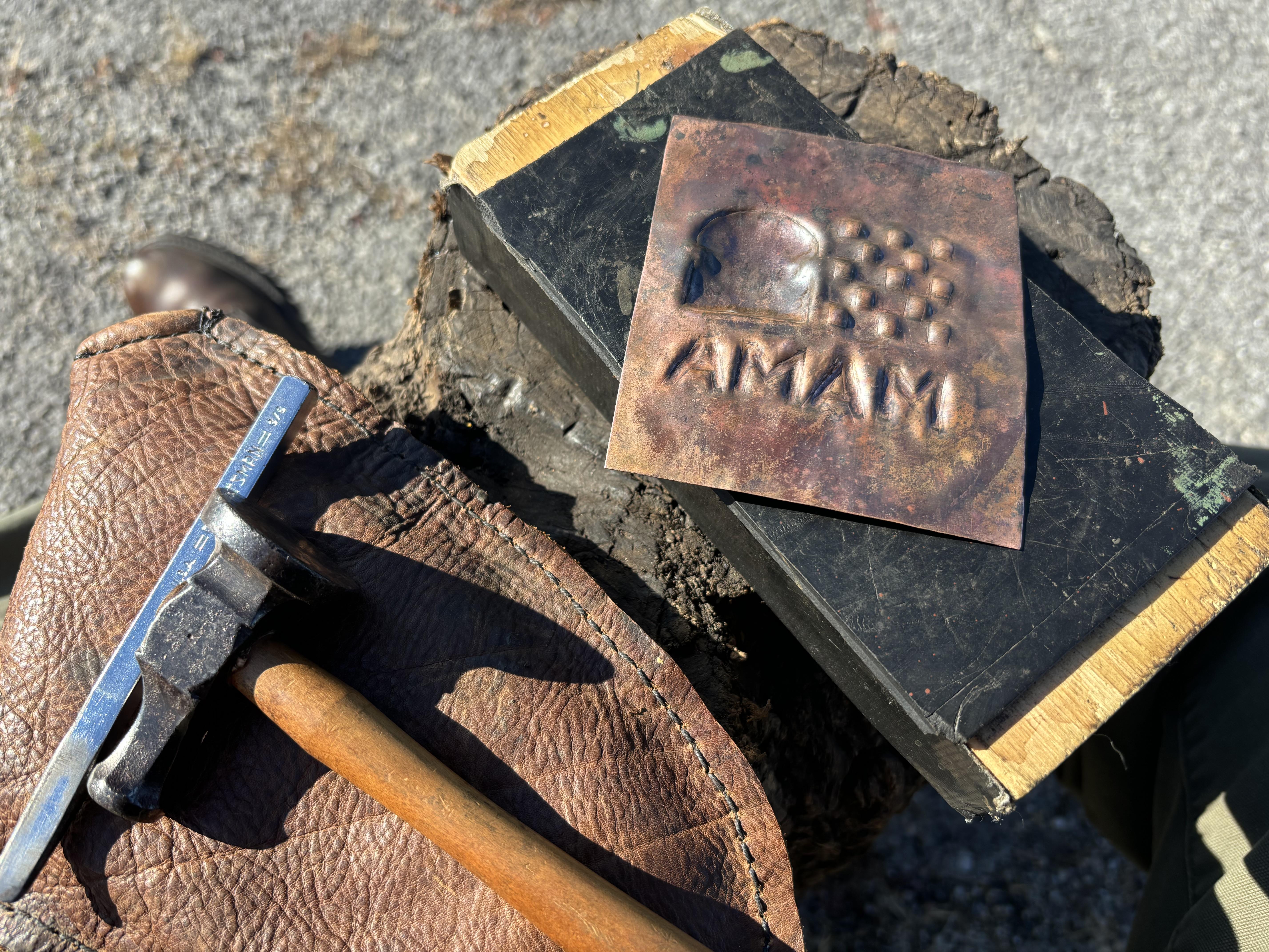

And started a small repoussé project:
