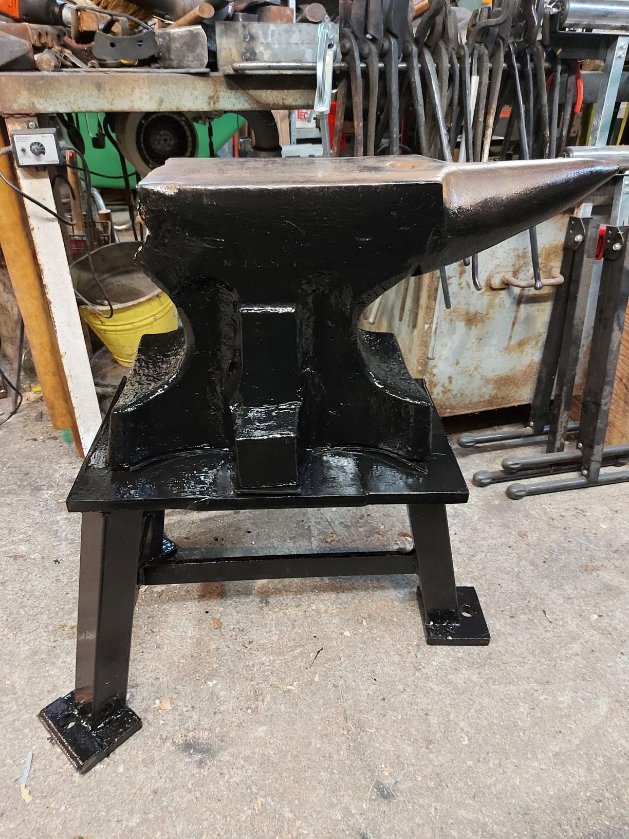

Jaegers Forge and Foundry Posted March 18, 2021 Share Posted March 18, 2021 I recently made this anvil stand today I'm going to add a hammer rack and fill the legs with sand as well as supports on the legs The only issue is it's a bit to short So i figured I'm going to add wood boards to add height to it but I don't want to deaden the weight if I add boards under the anvil or under the stand its self with it deaden the hammer blows? Quote Link to comment Share on other sites More sharing options...
JHCC Posted March 18, 2021 Share Posted March 18, 2021 How much height are you thinking of adding? Quote Link to comment Share on other sites More sharing options...
BartW Posted March 18, 2021 Share Posted March 18, 2021 Nice stand. What I would do with that stand is this : 1. fill the feet with stuff. I use Ash & mineral oil to prevent inside rusting. 2. reinforce the plate, it looks somewhat thin and bendy. Like weld plate or angle iron to in from below. 3. weld a T close to the ground to prevent the feet from splitting apart. You can also make a table from this to store stuff. 4. If it's too low; I'd add feet under the square tubing of sufficient height. I wouldn't use wooden board directly under the anvil; you want the anvil & foot to work together as one object, not as 2 seperate objects. For this reason you should also clamp the anvil down as strong as you can. but that's just me. Quote Link to comment Share on other sites More sharing options...
ThomasPowers Posted March 18, 2021 Share Posted March 18, 2021 How much do you need to raise it? Thick feet and a thicker plate on top could get you 1-2" easy. More than that and you may want to think about making one the correct height to start with. Quote Link to comment Share on other sites More sharing options...
