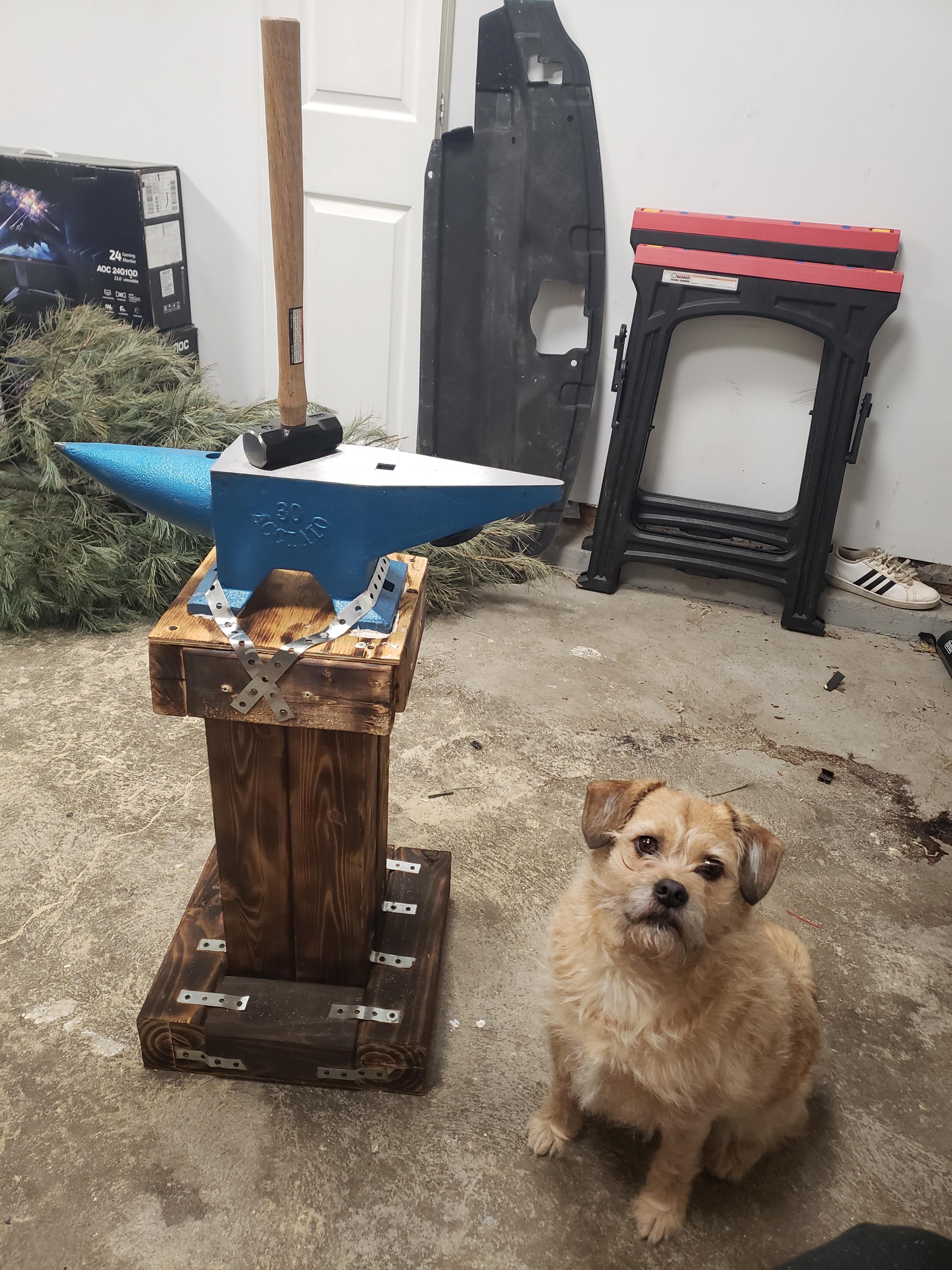

  1. My anvil came in last week, it's the 66lb vevor cast steel anvil. Just got the stand for it finished! Can't wait to forge my first project and try this thing out.
  2. Any suggestions for an anvil stand? I ordered the Vevor 66lb cast steel anvil. I have seen some people using stumps, but I am having trouble finding the right size locally. I would get a welded stand but I don't have the tools for that and I don't know anyone here who does. I am looking for something easy to make and affordable.
