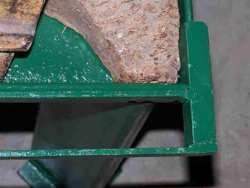

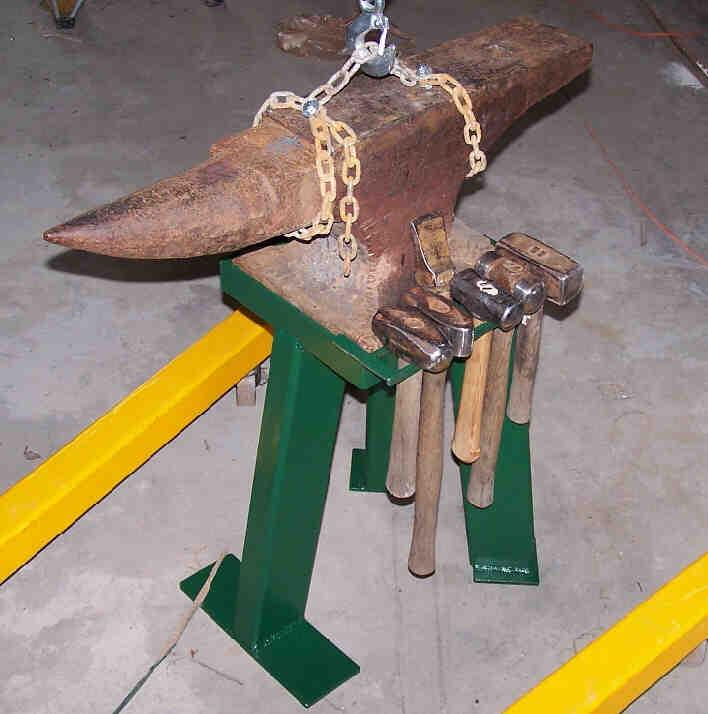

Below is the one under my Trenton when it was fresh paint new. The second pic is a detail of a hammer rack, driven into the stand between the anvil's foot and the rim of the stand. The hammer/ton racks wedge the anvil tight enough I can lift anvil and stand together with my engine hoist. Hence the chain in the first pic.
As mentioned above the rectangular and angle iron the racks are made of tend to scar up hammer handles.
