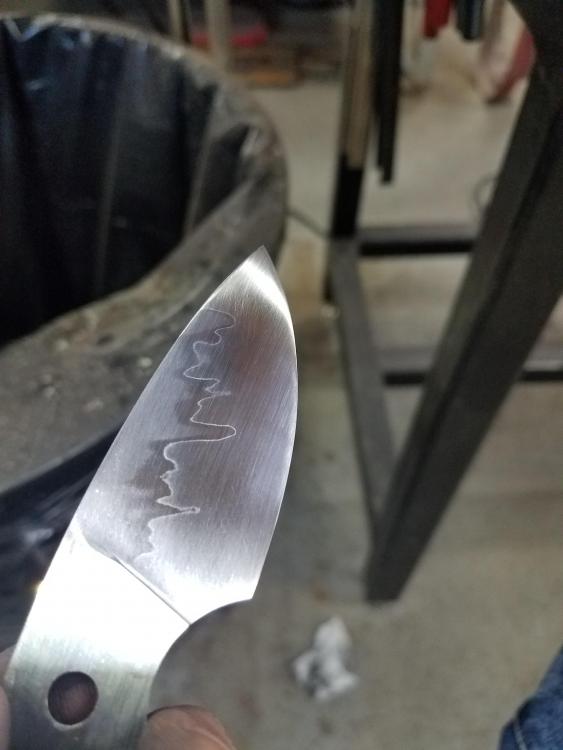

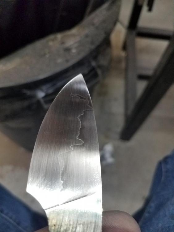

  2. Thanks all! I really have to turn my notifications on so I know when there is a reply. I will start by answering ThomasPowers. You are correct, I forged the billet and then profiled the billet that I had made. The make up is 1095 sandwiched between two pieces of 410SS. I am planning on forging the bevels in once I get myself a little more consistent on making the billets as my second attempt tonight to make another billet of the same make up above, I found a spot where one side of the stainless did not weld to the high carbon. I started to grind it out and it got to the point that I needed to come in for the evening, a little disappointed. It is a fully hardened blade, however I did an edge quench, to ensure that I did not split the billet. I have seen a good bit of cases where when the whole entire blade is quenched and the stainless actually rips the high carbon apart right down the middle. After I finished grinding out the unwelded portion on the current billet I made this afternoon, I may end up cutting in a preform and then forging bevels into a finished knife profile. All depends on how much more I have to grind out of the billet, as the majority was welded. Bob Brandi, as long as you thermocycle the blade properly, there is really no need to rush it off to tempering after quench. I do however do that immediately after for any knife that I make. I have blades that were quenched and not put in into temper until a few days later, and there has been no ill effect.

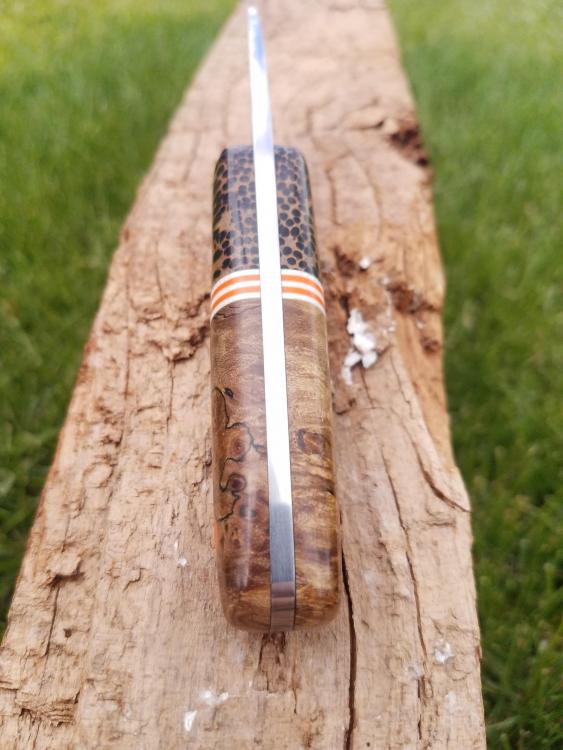

  3. I started a journey into learning how to forge, and decided it was time I give forging a knife a try. I have done many stock removal knives, but want to take my knife making business to the next level and start learning more. As usual, I jump feet first into things and thought to myself, I want to do a stainless san mai. I dont know if I got lucky, or all the steps of the initial prep work led to have a first successful forge welding experience, let alone stainless to high carbon. Once I had the billet finished I cut out and ground the profile, and finished the knife, and made a leather sheath to go along with it. 410 Stainless and 1095 HC Maple burl and black palm scales with orange and white G10 liners and orange G10 pins. 8-9oz leather sheath made in house as well. Let me know what you all think.

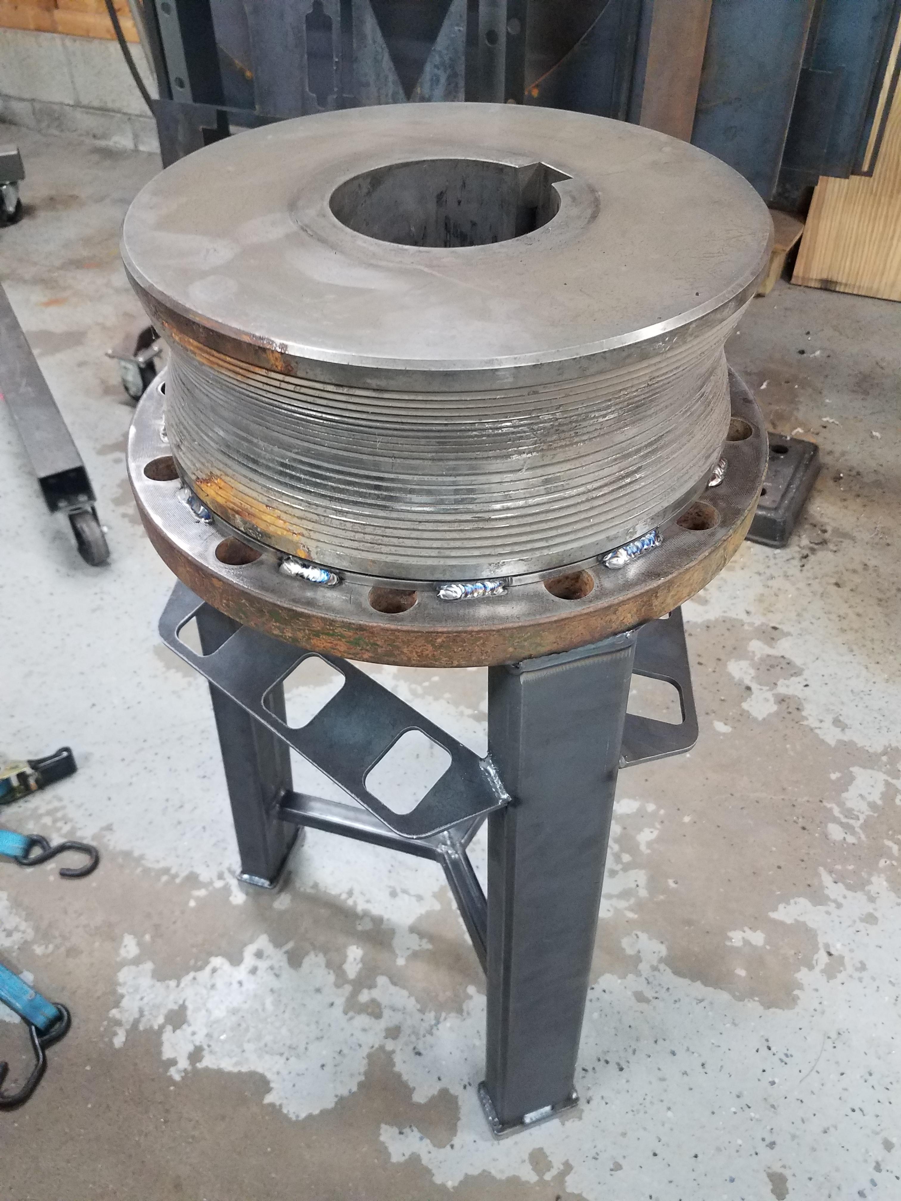

  7. This is my improvised anvil that I just recently started forging with. Built a steel stand with hammer and tong holders built into it. It is a large roll for a turning machine from a job I had previously had that they were tossing because it had a crack in it at the corner of the keyway slot. It is hardened 4140.
  8. I'll look that one up and post it up there. It sure is heavy and has great rebound without any ring.

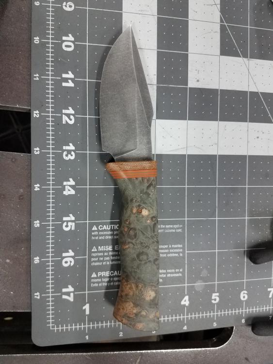

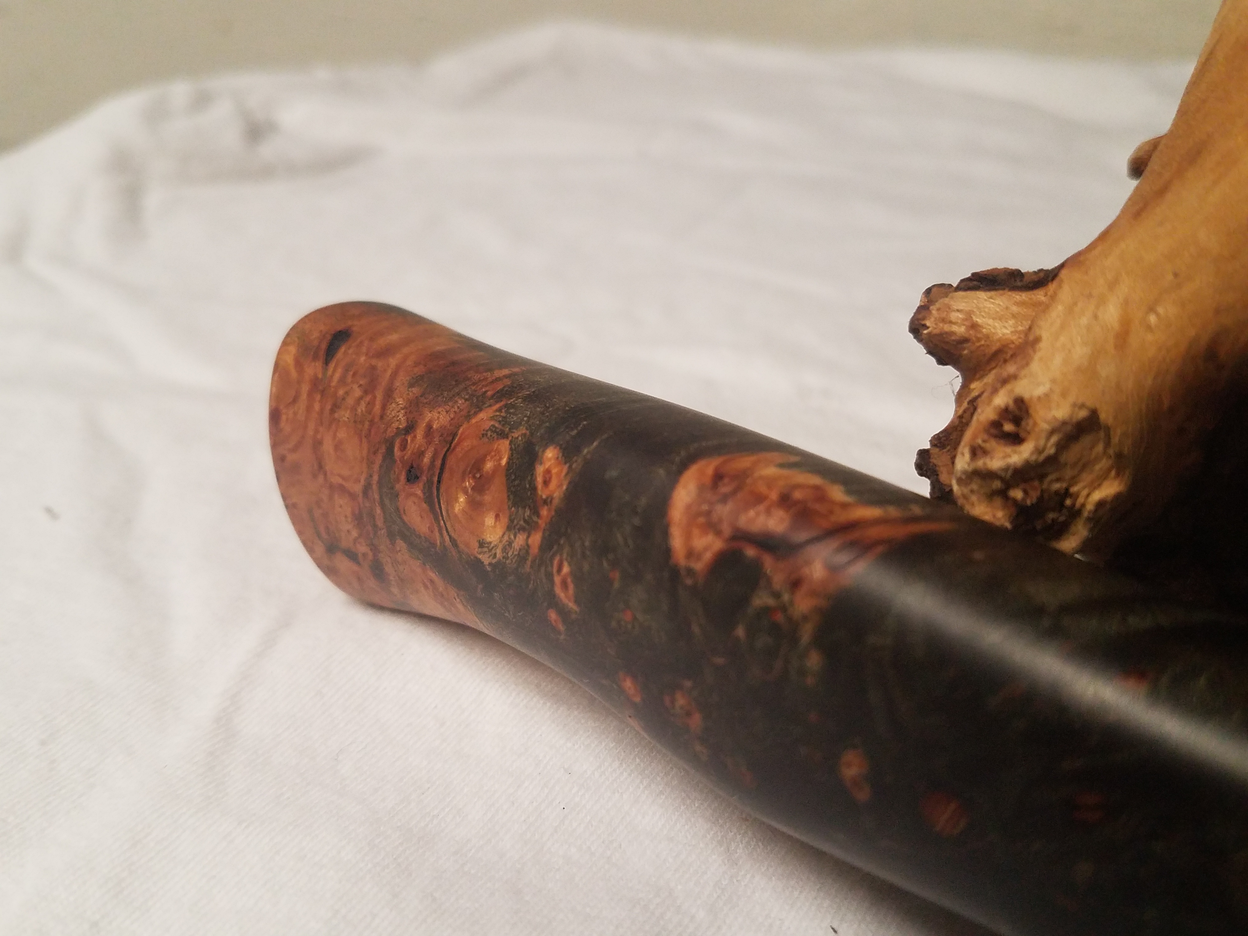

  10. Red, heres a couple pictures of the knife once oiled up. Pictures arent the best, tlmy wife excels on the camera.
  11. SLAG and Thomas The handle is dyed and stabilized maple burl wood. My absolute favorite handle material with so many curls and eyes everywhere. I know exactly what you mean about the torment of lost souls, it is not the first time I have heard someone say something similar. The blade material is 1095. Thanks Daswulf. Gotta get over to my shop to check it out and try out my ASO and the newly acquired free Fisher anvil. Feel like I need to watch you forge some more so I can learn. Red, I appreciate the kind words. I have been doing this for about 2 years, maybe a little bit longer, sold maybe 20 blades total, given away alot. This knife here was stock removal, not forged. Still working on perfecting my forge of knives, first few looked like complete trash, but I will definately post the first forge one up once Im happy. Ill get some pictures up possible later this evening as I just oiled it up earlier, I have to get my wife to get the pictures taken for our business page on facebook. She takes much better photos than I do.

    That is a feed roll for a turning machine that turned 4" diameter titanium. Think the reverse of a lathe, bar was fed into machine with a rotating head that removed the material. Its hardened 4140, 5" thick and 13.5" diameter. The place I worked at before I got laid off due to the pandemic was tossing it due to a crack at the keyway slot. I asked if I could have it and they said yes. It sat on my floor for about a year, and when I couldnt find a decent anvil, I got the bright idea to use it as my anvil. Works quite well, has crazy rebound and doesnt ring.
