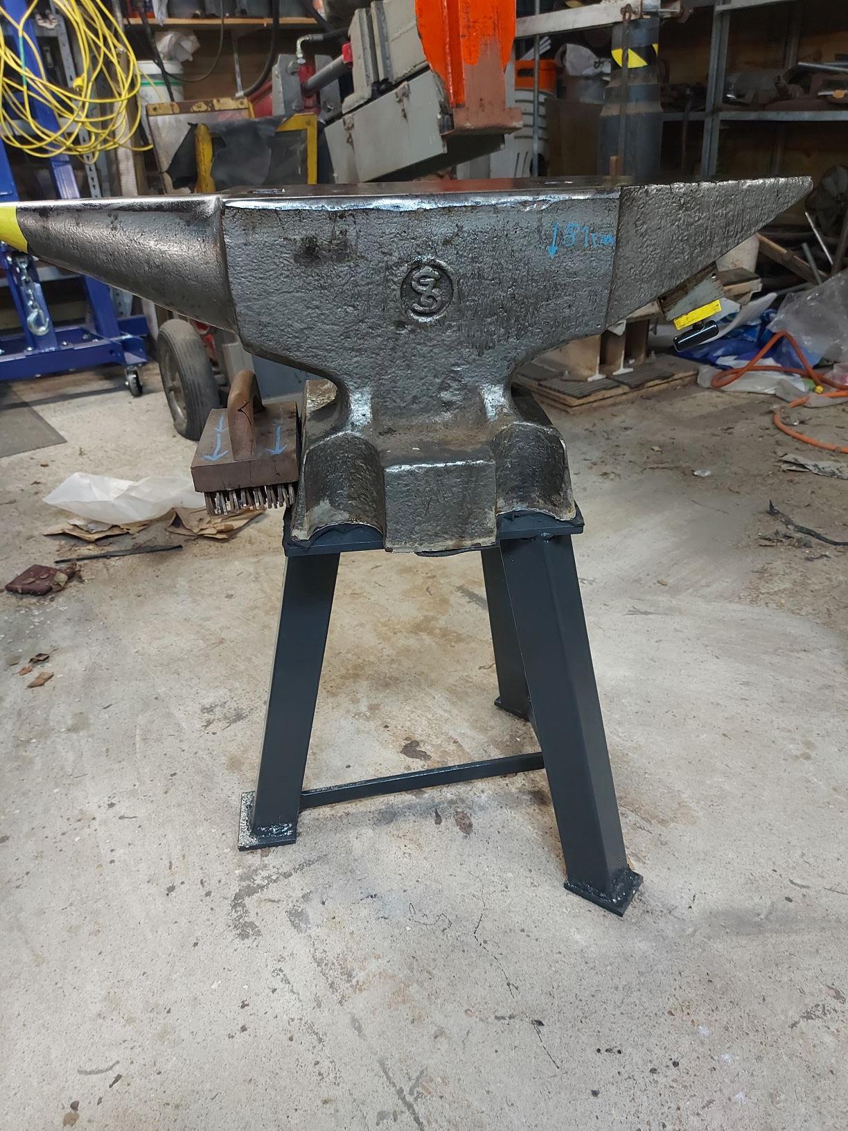

BartW Posted April 6, 2021 Share Posted April 6, 2021 Welded steel tripod for the 150 kilo/ 330 pound skoda. Half inch baseplate out of steel; 2.5 inch thick wall square tube legs at 14° angle, filled with dry sand and ash. I reinforced the baseplate; and the anvil is screwed down with 4 M16 bolts. there's a leather liner inbetween the stand and the anvil. it's more quiet than the original wooden stand. I love it. The picture is strange, it looks like the legs too straight down, but the wooden base was narrower. Quote Link to comment Share on other sites More sharing options...

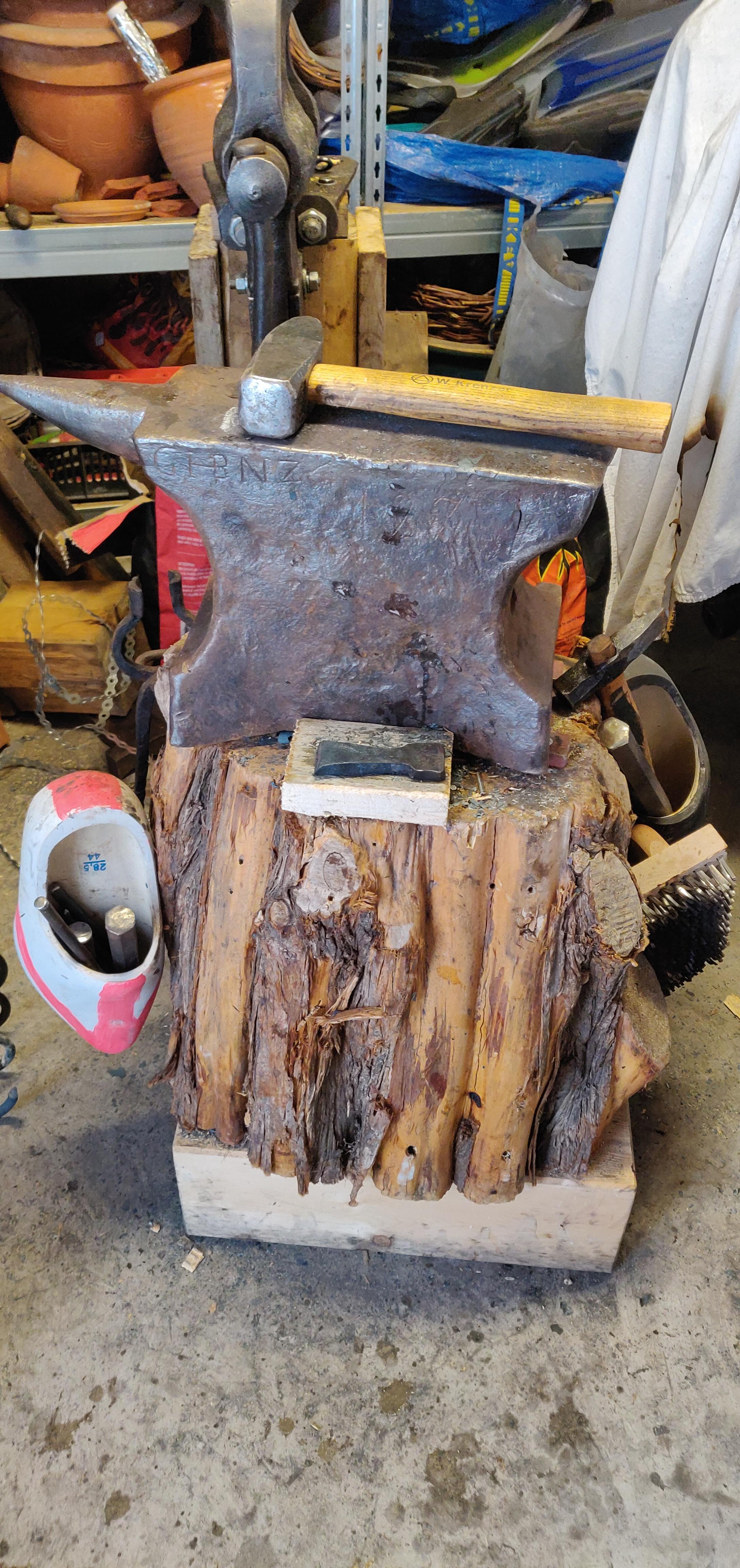

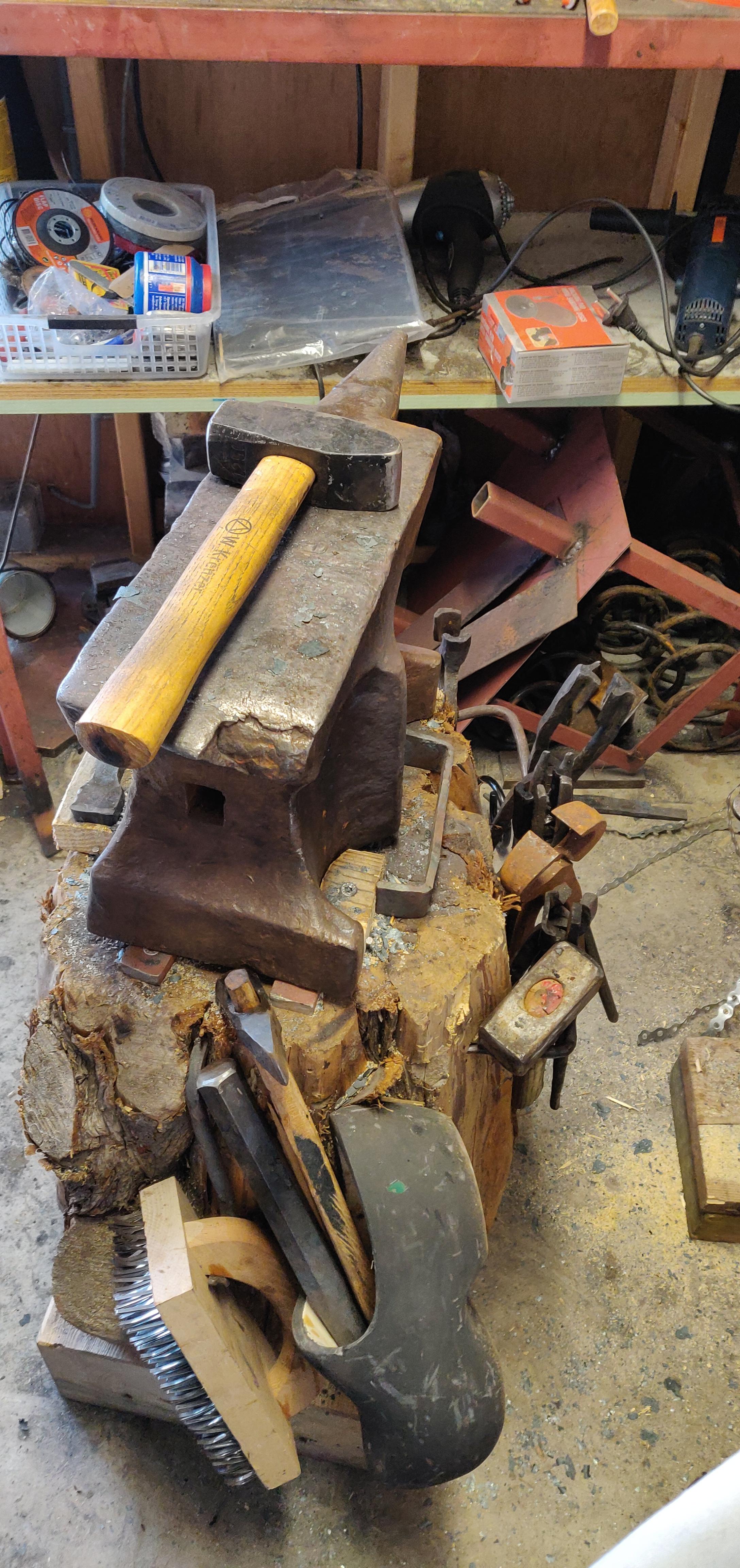

Jobtiel1 Posted April 12, 2021 Share Posted April 12, 2021 This is my anvil stand in my small shop, on the left side I have a wooden shoe full of punches and drifts, and to the left I have a wooden shoe with currently my handheld hot cut and hammer eye drift, but those are going to get different places as soon as I have the stock again to make a second rack. Also a hook for the block brush. On the back I have a ring rack, as well as a small mild steel cutting plate so I don't damage my anvil. ~Jobtiel Quote Link to comment Share on other sites More sharing options...
JHCC Posted April 12, 2021 Share Posted April 12, 2021 And today's prize for "Most Dutch Anvil Stand" goes to.... Quote Link to comment Share on other sites More sharing options...
Jobtiel1 Posted April 12, 2021 Share Posted April 12, 2021 JHCC Thanks! It's not even my idea, I picked up the wooden shoes idea from other Dutch blacksmiths, so it might be our national gimmick in terms of blacksmithing. Quote Link to comment Share on other sites More sharing options...
ThomasPowers Posted April 12, 2021 Share Posted April 12, 2021 Can you send videos of picking up the stump and anvil and holding them upside down and shacking them to get the scale out of the shoes? (Or is that only the Frisians?) Quote Link to comment Share on other sites More sharing options...
Jobtiel1 Posted April 12, 2021 Share Posted April 12, 2021 Thomas, I don't think that'll be necessary (luckily), the wooden shoes are quite easy to get off the stump. Would be hilarious to have some friends try doing that when they come over to be my minions. Quote Link to comment Share on other sites More sharing options...
ThomasPowers Posted April 12, 2021 Share Posted April 12, 2021 Always good to have some "minion tasks" on hand for when they visit... Quote Link to comment Share on other sites More sharing options...
Frosty Posted April 13, 2021 Share Posted April 13, 2021 I like your wooden shoeL holders but isn't tempting the gods to have your tools to grow feet and walk off? Frosty The Lucky. Quote Link to comment Share on other sites More sharing options...
Jobtiel1 Posted April 13, 2021 Share Posted April 13, 2021 Hi Frosty, I guess it is, the tools don't always come back home, especially drifts get lost sometimes. Quote Link to comment Share on other sites More sharing options...
JHCC Posted April 13, 2021 Share Posted April 13, 2021 Old punches never get lost. They only drift away.... Quote Link to comment Share on other sites More sharing options...

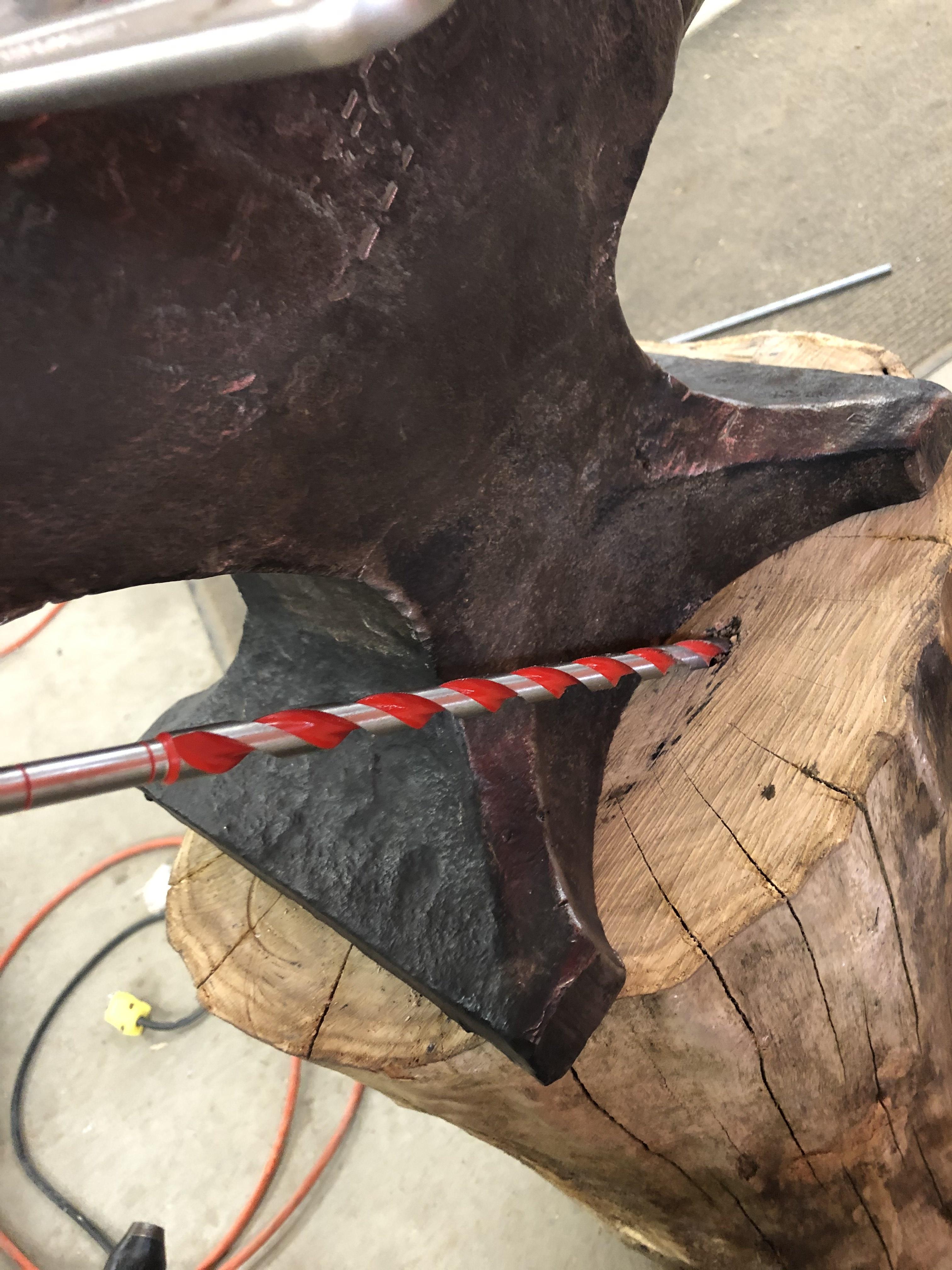

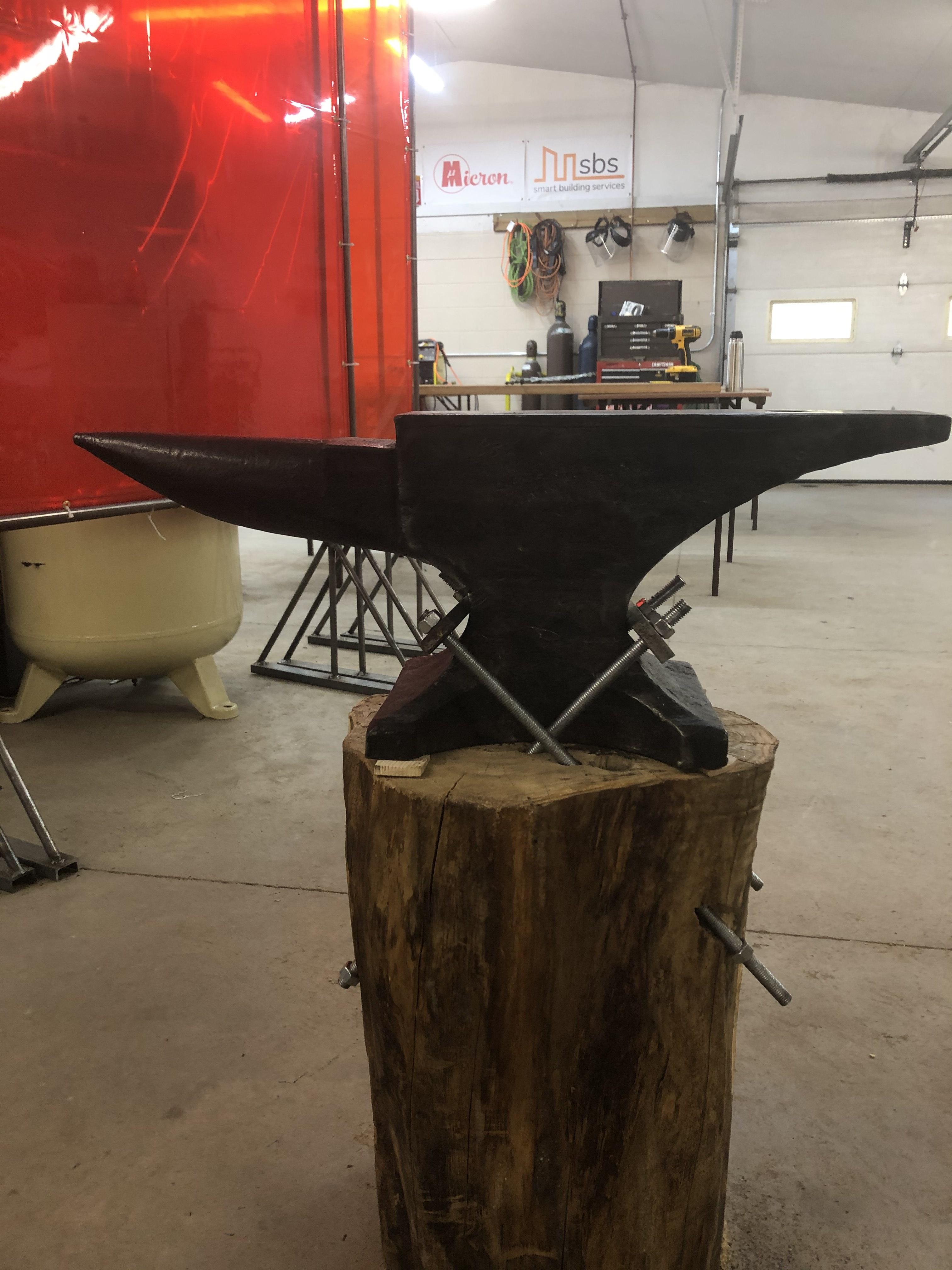

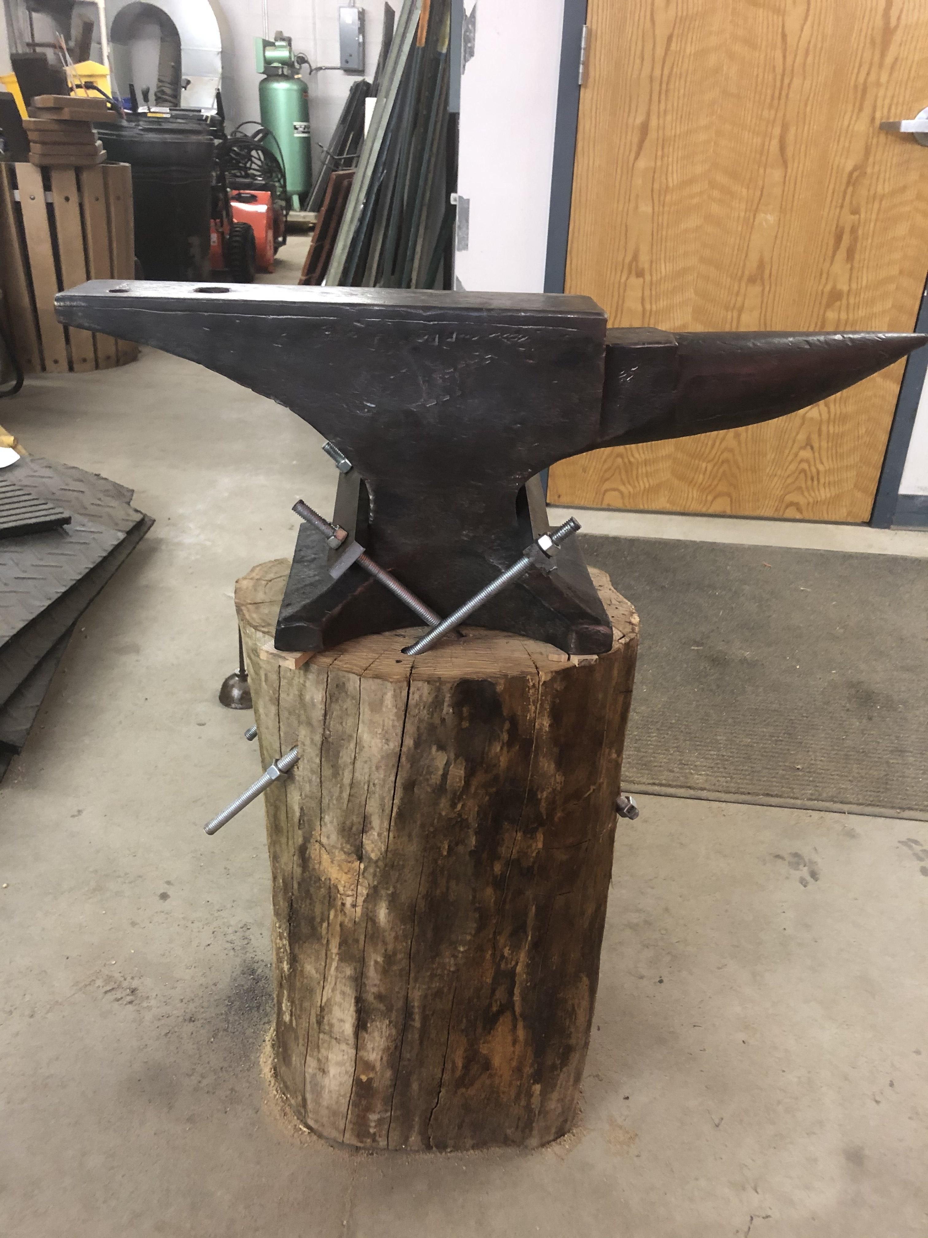

Will Brouwers Posted April 20, 2021 Share Posted April 20, 2021 After reading almost every post and getting so many different ideas on an anvil stand, I decided to go with a style copied from Essential Craftsman on YouTube, (and maybe some of you as well). I drilled four 1/2 in holes, took 1/2 in threaded rod, and two pieces of flat stock and bolted it all together. The stump is a little small, and I am also a little worried about it splitting, but I think it should work for my hobbying purposes. I am also planning on cutting the excess threaded rod. One more thing, just to make you guys laugh, but I got the auger stuck two times. I had to take a crescent wrench and wiggle it back and forth for an hour on one side, and had to drill holes to loosen the bit on the other side where I got it stuck. Nothing is ever easy... Quote Link to comment Share on other sites More sharing options...
Chris Williams Posted April 20, 2021 Share Posted April 20, 2021 I see that the nuts aren't tightened down on the lower ends yet. Save yourself the effort now and put some thick washers between the nut and the wood. If it were mine, I would use a forstner or spade bit to make a flat spot for the washer to sit in. It's hard to keep the spade bit centered when there is a hole already, though--you could tap a wooden plug into the hole to give the center point something to bite into, if needed. The nut by itself will dig into the stump when you tighten it down. It may work great and seat into the wood, or it may eventually be the cause of a split as you tighten it up over time as the nut keeps digging more into the stump during use. If you use a washer, the wood will compress some, but it shouldn't continue digging deeper over time. Quote Link to comment Share on other sites More sharing options...
Frosty Posted April 20, 2021 Share Posted April 20, 2021 That'll hold her down Will. I highly suggest you counter sink the shin barkers so they're completely inside the block. That's a long way to drill with an auger, you need to advance it an inch or so and pull it back to clear the cuttings. It's a driller thing. Looking good, a wider block will show up and I like wood screws for that type anchor. Frosty The Lucky. Quote Link to comment Share on other sites More sharing options...
BartW Posted April 20, 2021 Share Posted April 20, 2021 or make angled thick washers to distribute the pressure. Now all pressure will be pointed upwards and attempt to shear / split the wood. Like a knife trying to cut a piece wood off. But this will hold an anvil down fairly effecient. Quote Link to comment Share on other sites More sharing options...
