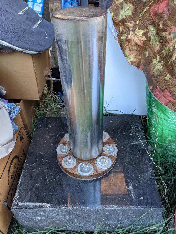

Roughly 400 lb black granite block under my post anvil makes the whole thing over 500 lbs. It's bolted together using 1/2" concrete anchors drilled into the stone. I did it this way so I could separate the anvil from it's base because otherwise its a beast to move. This deadened the ring and the anvil feels more solid and lively. This is my go to anvil when I am using a striker.

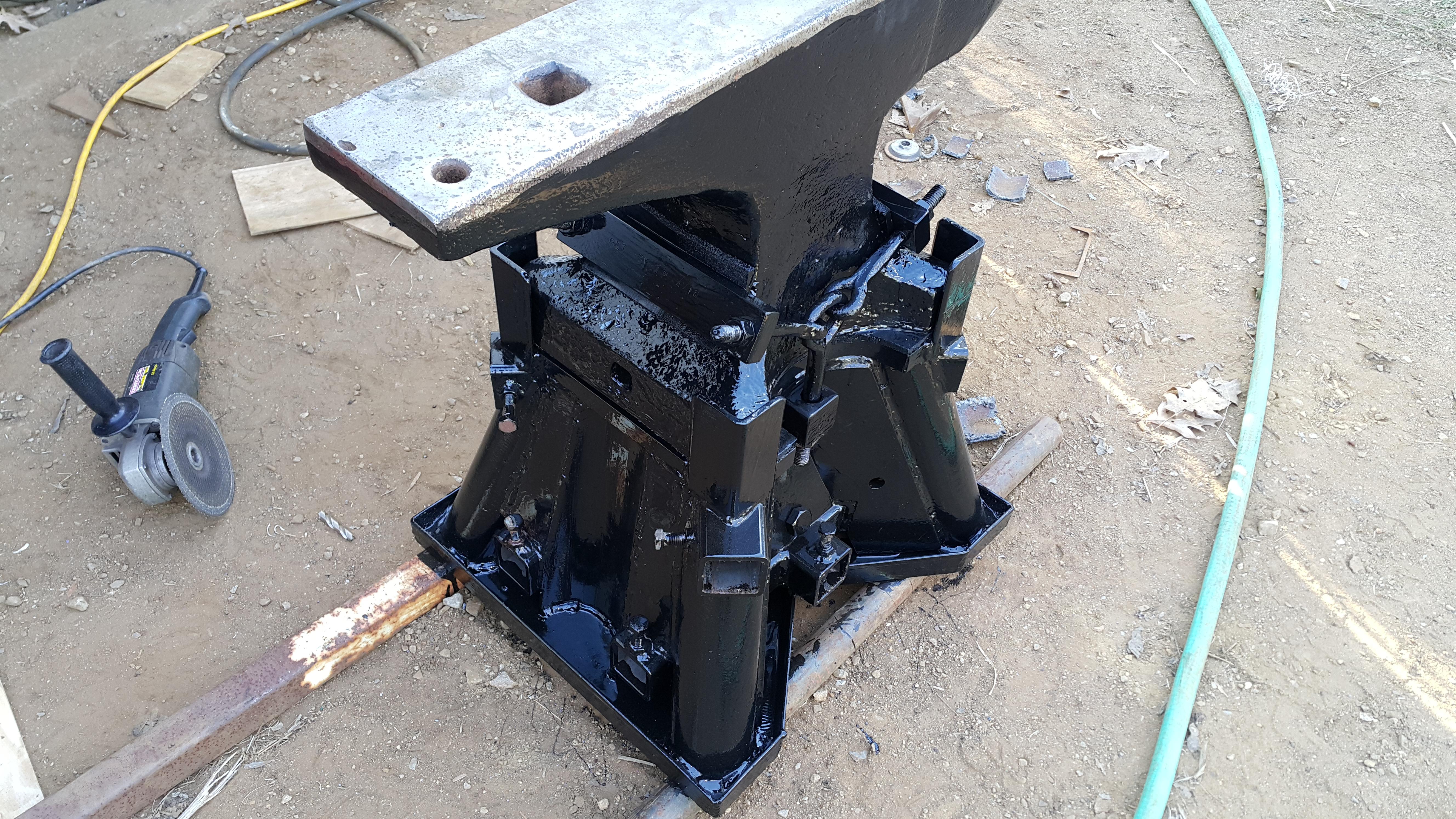

Upgraded to a steel stand from a wooden block. I still have to add some tool holders to it, but I want to use it first. I used JLP's anvil mounting system which works extremely well! Thank you for the idea.
The stand weighs about 180#. Hopefully I won't be chasing my 150# anvil around like I was with my wooden stand. I thought about filling the legs with sand, but I think that might be unnecessary. We will see. Everything is bolted together in case I decide to change things in the future.

Frazer..  That is a great, heavy stand..  Very nice..     Some serious forge work on those links too..  Job well done.
I ended up simplifying the design a lot on regular based anvils and it speeded up the process but is not nearly as intriguing as what you did..  :)  I love it..  the story is spectacular.
On the anvils with the upsetting blocks the tie rod can't go over the block..
This design really sped up the process though.
Looking forwards to feed back on how you think about the Wood vs steel stand in use.
Will you put the moving shelves on it too?

I have a Soderfors with 85-90% rebound and I can honestly say (based on 2 days of use) the steel stand is not only more lively, it's also quieter than the wooden block. I took the chain off the waist and the magnets off the anvil and it's still quieter than before. I'm guessing it's just held down much better.
So far I love it. I did add another piece of 1.25x0.5" flat stock between the 2 legs facing the camera in the last picture (and the opposing two legs facing away from the camera). I also put another piece of 5mm soft plywood under the feet to protect the concrete floor a bit.
