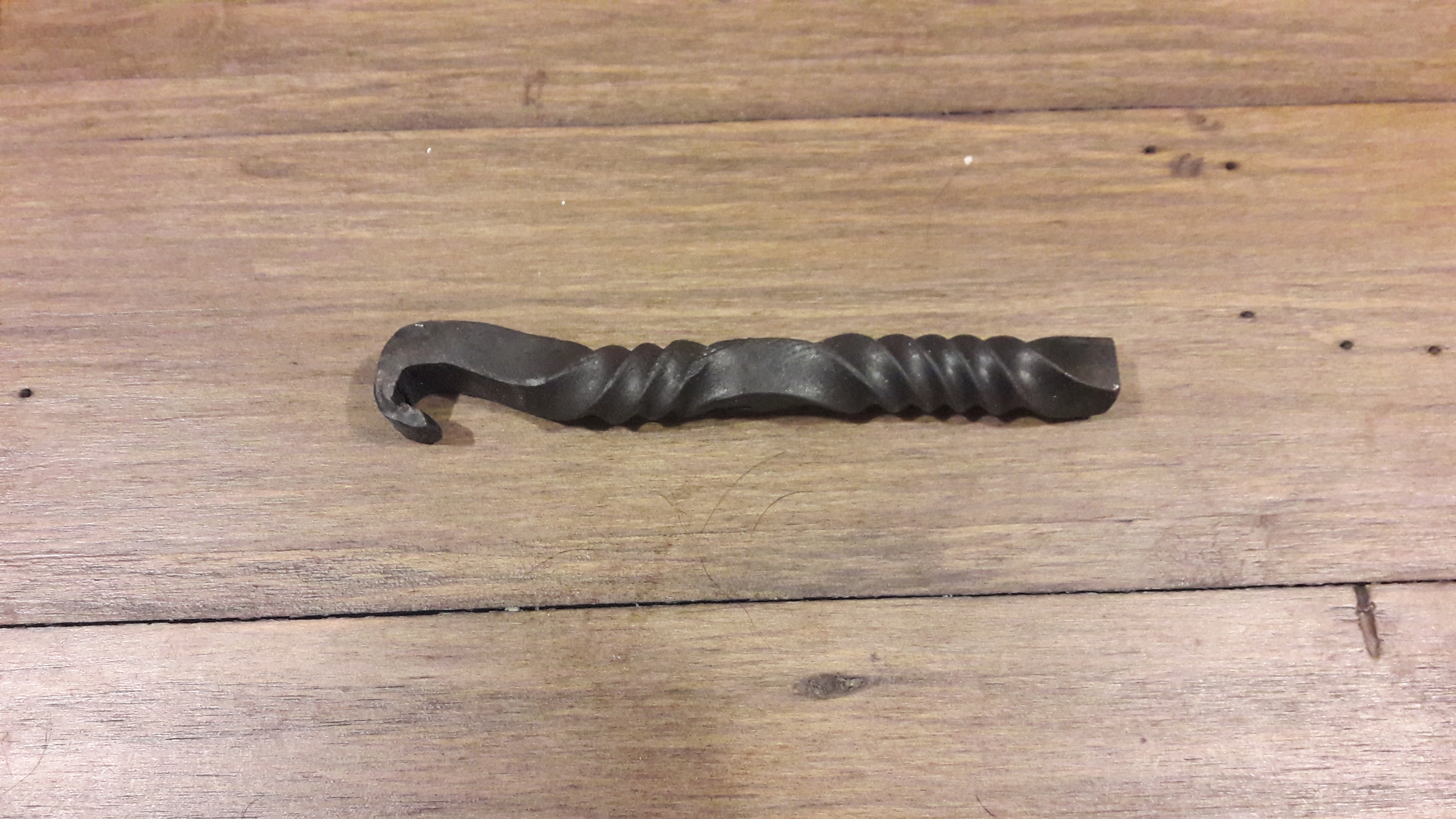

I made this reverse twist bottle opener,it is made from 12mm square.
I did a single twist at the top and then two twists.

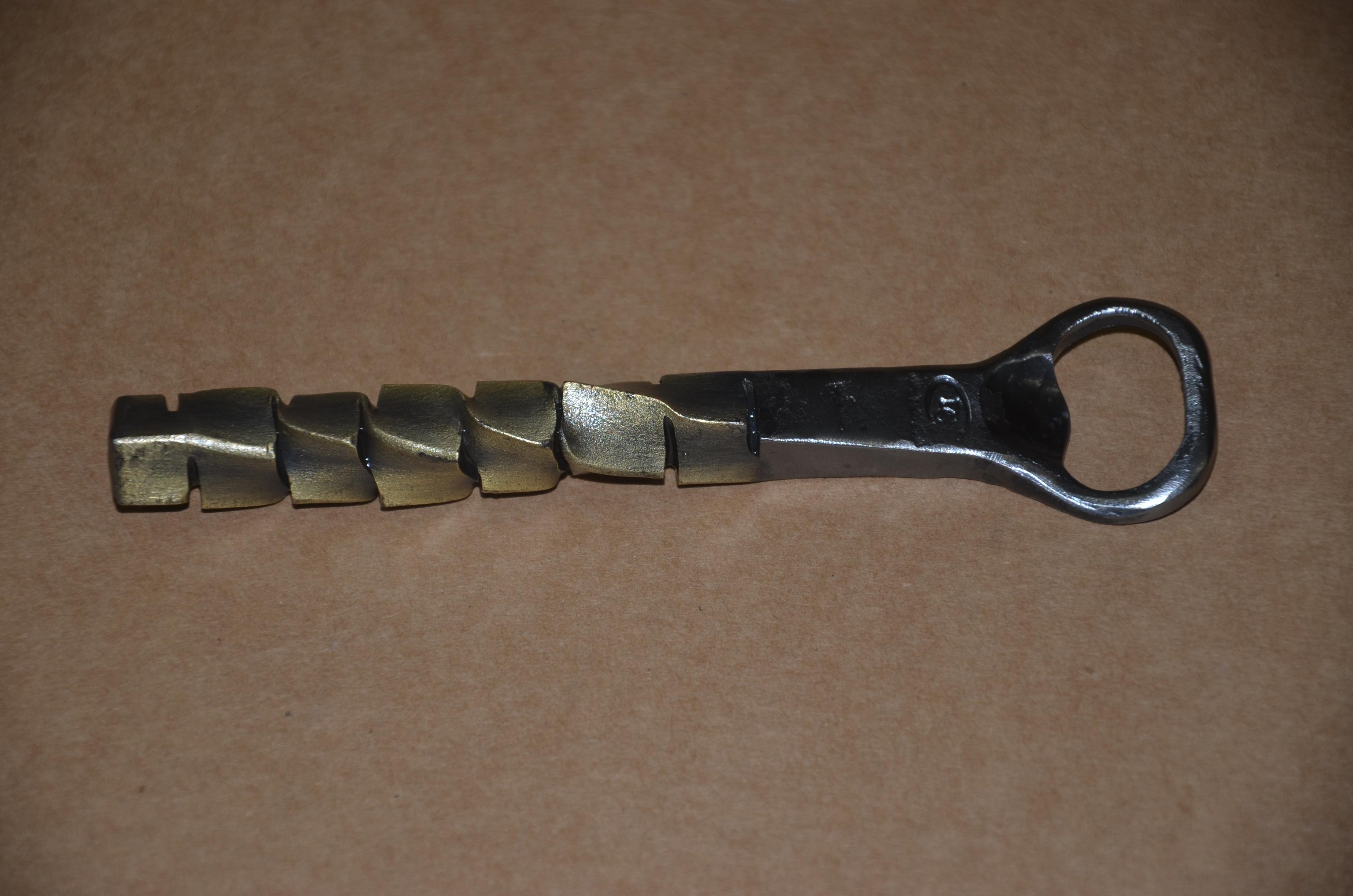

Don't really know what I was trying to do here. I like to experiment a bit with different twists. This 12mm bar had small saw cuts on the  opposite corners, alternating along the bar. Didn't know what to expect. Bit like a cube twist with the concave faces.  It's not very even, but worth another try I think:
