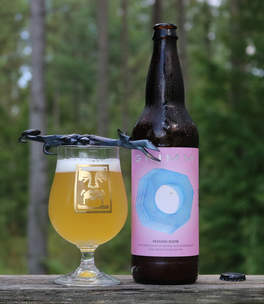

Hotmetal Posted August 24, 2017 Share Posted August 24, 2017 8 minutes ago, Frosty said: I guess bottle openers ARE your thing Hotmetal! Beautiful work on all counts, not just very cool bottle openers but the techniques you use show real skills. thanks for giving us a peak. You have MORE pics . . . Yes? John in Oly, please don't make us tell you to bolt the bottle opener to the cabinet, wall, etc. so you don't have to handle it. <SHEESH!> Frosty The Lucky. Thank you, sir. I love my job if you could call it that. I'm just having fun. I also make tap handles. These are in a brewery tap room in North Carolina. Hambrabe RR spike opener. Quote Link to comment Share on other sites More sharing options...

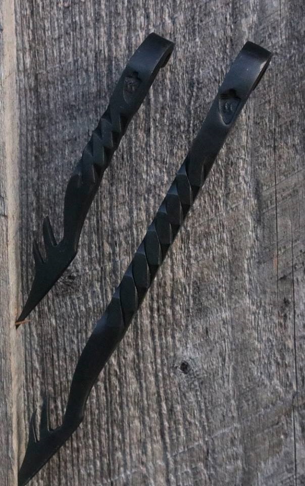

Irondragon Forge ClayWorks Posted September 15, 2017 Share Posted September 15, 2017 Just tinkering with an old horseshoe, came out as a Wyvrn Dragon bottle opener. Don't know what happened to the photo. Try again. Quote Link to comment Share on other sites More sharing options...

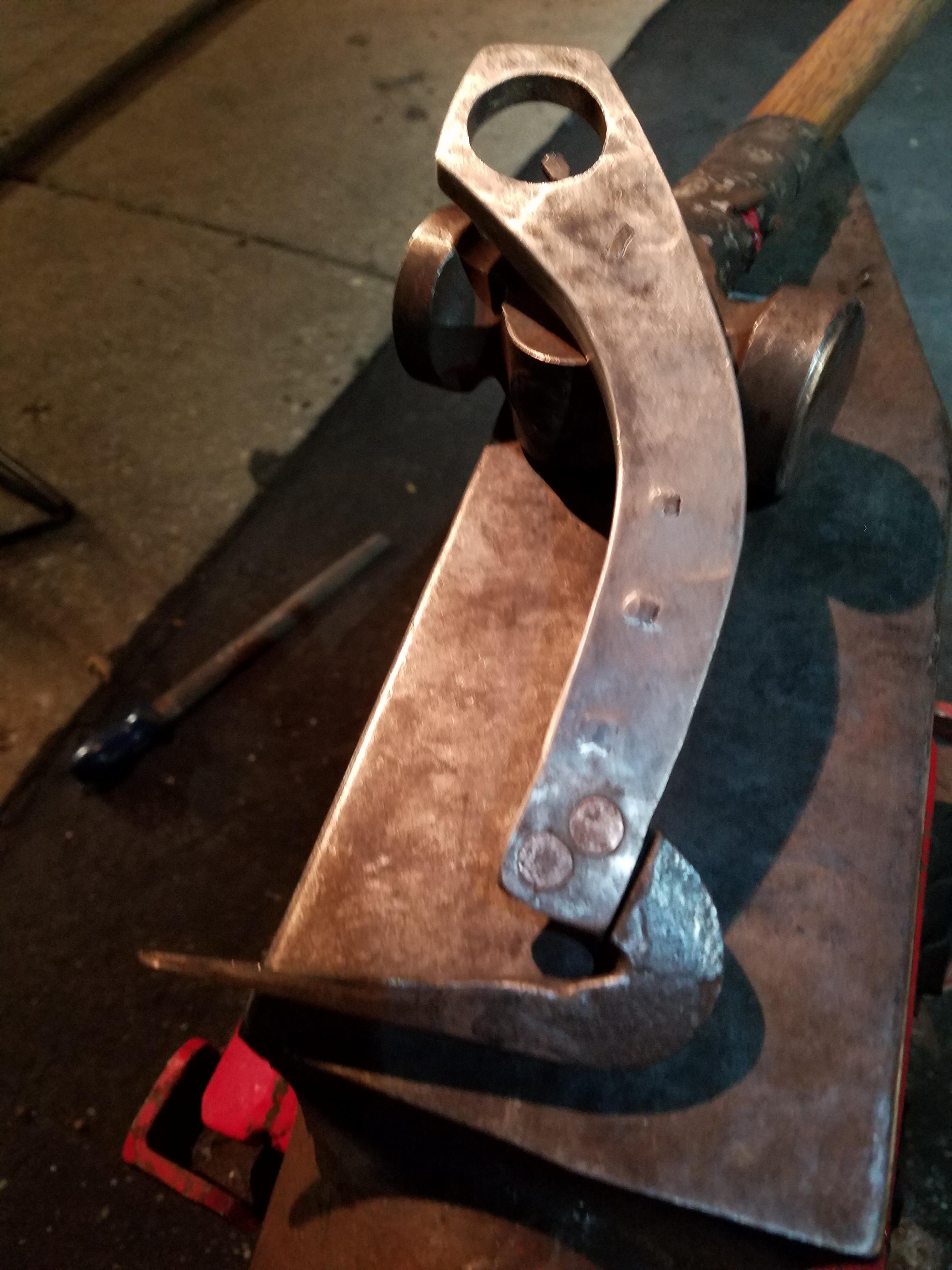

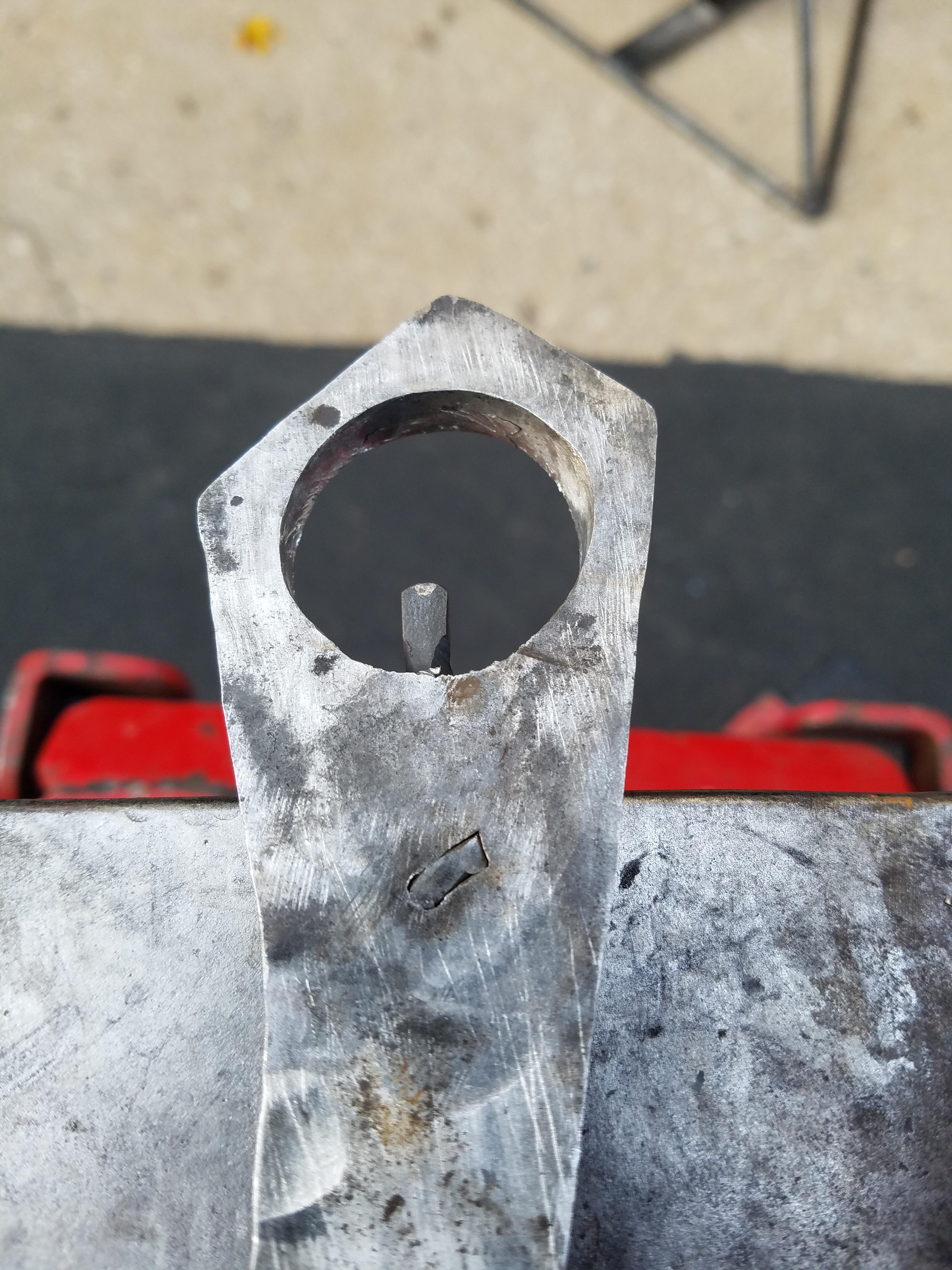

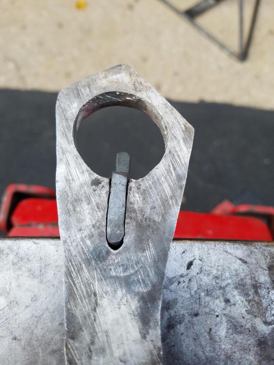

Hotshoein4 (Mark) Posted September 19, 2017 Share Posted September 19, 2017 This was a fun project using 3 different metals. I started with 3/8x7/8 aluminum. I bumped the end up to have meat in there for the opener hole. Made the hole, then made half a shoe. Then tapered and made the good pick part. I used copper nails as rivets, a farrier thing, and attached the steel pick to the aluminum shoe. Then made the little cap opener and inserted it through and riveted it. Wish that was cleaner, but it works great. Aluminum can be tricky, but fun! Quote Link to comment Share on other sites More sharing options...
