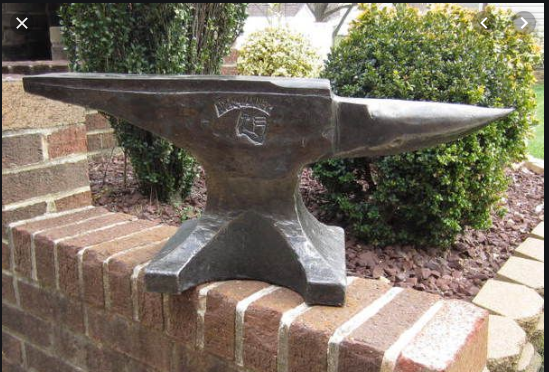

  15. The section of the face that you say is rounded over is the radius ground in at the factory when new. Most later A&H's and Tretons have this, it is quite common for both makes. Here's another example from that vintage of A&H:
  16. Even though your serial is rather unreadable, I can tell you that your logo stamp style is the last one used in U.S. Production. That stamp was used from 1939 to the end of CF&I's run in the 1950's.
  17. Mid-to-upper 52xxx range from what I have documented.
  18. With a serial number like that, it would not be A&H. Most likely Trenton. Take a closeup pic of the serial number. different companies used different character styles for their number stamps.
  19. Scrub the front foot under the horn for a serial number.
  20. No serial # on Soderfors, all cast steel, top notch anvil and one of the best. I don't know the dates for Soderfors making them for Belknap, but I'm guessing early 1900's. There may be a year date on the Soderfors somwhere, many times they stamped it
  21. Incorrect, Belknap was made by several anvil makers, A&H being the main one. (several incorrect items in AIA...) Yours is a Soderfors, made in Sweden. You can see the casting line going up the center of the anvil below the horn and heel.
