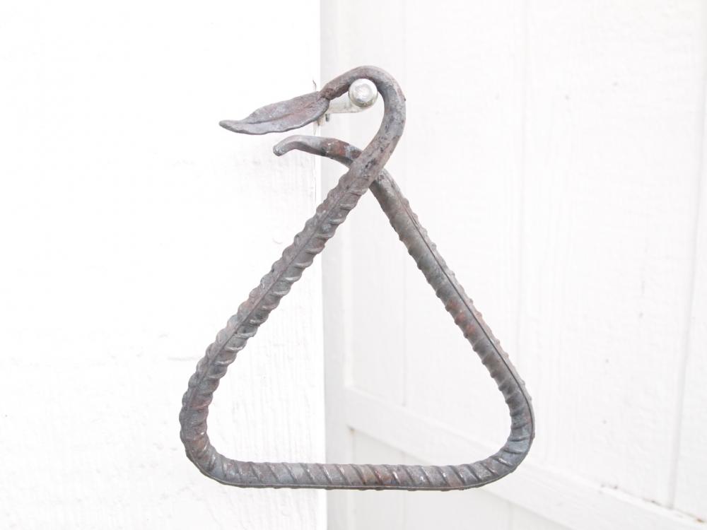

  11. Made a leaf triangle bell. First time creating a leaf, thought it went pretty well. Did not finish creating the rod used to ring the bell and a wall hook to hang it by, as I ran out of fuel, and I got tired of it raining on me every 45 minutes.
