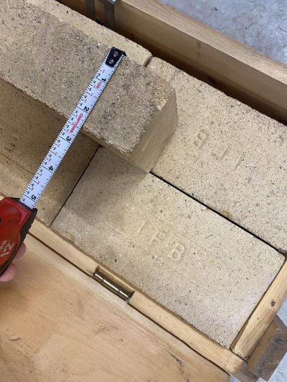

  2. Cool, thanks. And appreciate the tip in the @
  3. Great tip, I looked them up - thanks! Do you know if there is any way to tell exactly which model of brick I have though, so I know what their temp limits are?

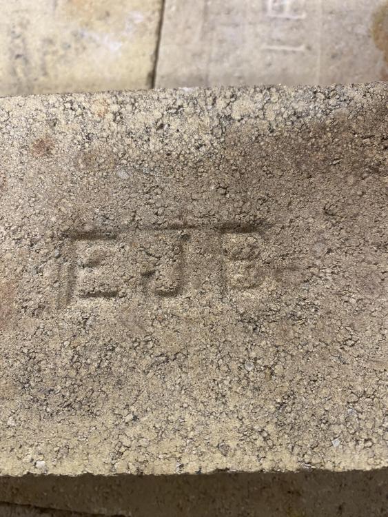

  4. I recently got a great deal on a bundle of these IFBs (38 of them for $40). They are not like the lightweight white IFBs I am used to. They are much more like regular hard (non-insulating) fire bricks, but they are clearly marked IFB. They measure 2.5”x4.5”x9 and I did not weigh them, but they weigh about as much as a brick should - not lightweight like the white ones. Can someone help me identify what type of brick (high alumina?) and maybe a max temp associated with the type? TIA Bonus question: there are two in the bunch that are slightly smaller and are marked EJB. Identification on those?

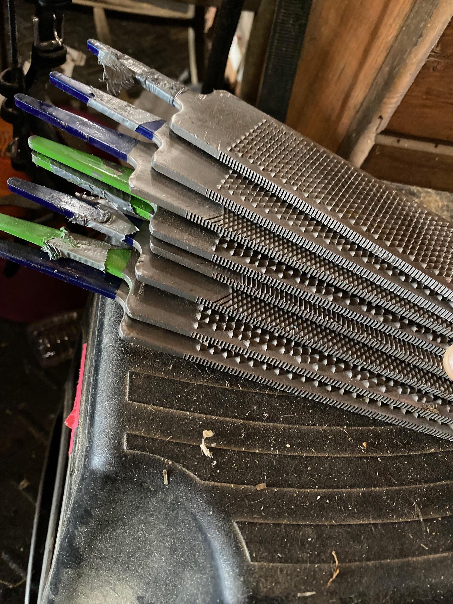

  12. Another stack of rasps from my local farrier. I've been doing a series of knives and rasp hawks with them. And yes, I always confirm they are good steel, since many are case-hardened. But the two farriers I get them from always buy high end rasps, usually Heller blue and green tang. I know some have said that they have come across case hardened Hellers, but every one I have gotten from my sources has tested out very good. They run $30+ each for the farrier, versus less expensive for the case-hardened. My test, which I do on every rasp before I use it (unless it is from the same lot number as a previously tested one) is to cut off the tang, heat it to orange, quench in water, put in a vise and whack it with a hammer (using eye pro). If they snap cleanly they are good to go. For knives I make from them I had been using Parks AAA, but have moved to Parks 50 for slightly better hardening.

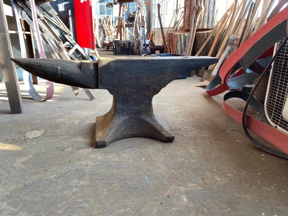

  18. So I have to clean it up still (just a little wire brush), but here is the Trenton I picked up last week. Based on its size, I thought it was heavier, but it weighed in at 190 even. It is 30.5 inches long! Nice edges and excellent condition. I haven't found the serial number yet because I haven't cleaned it, so I can't date it (I don't have AiA anyway).
