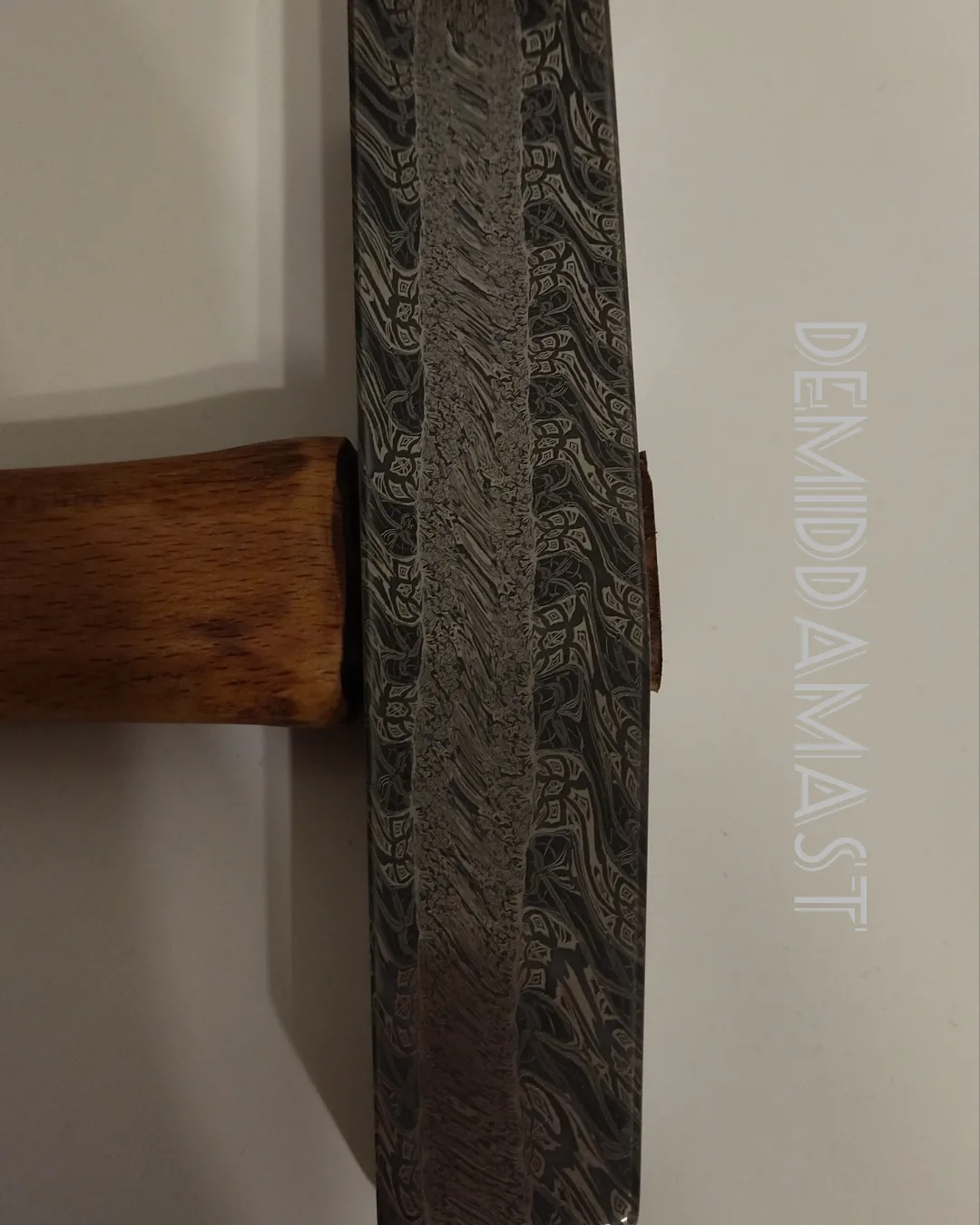

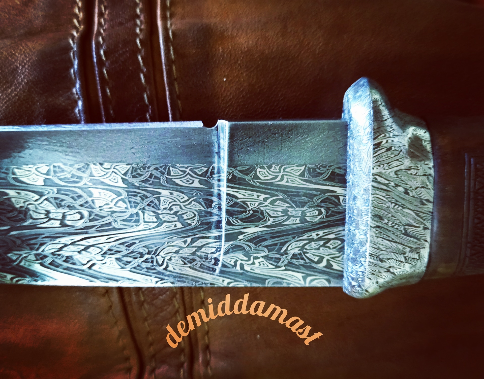

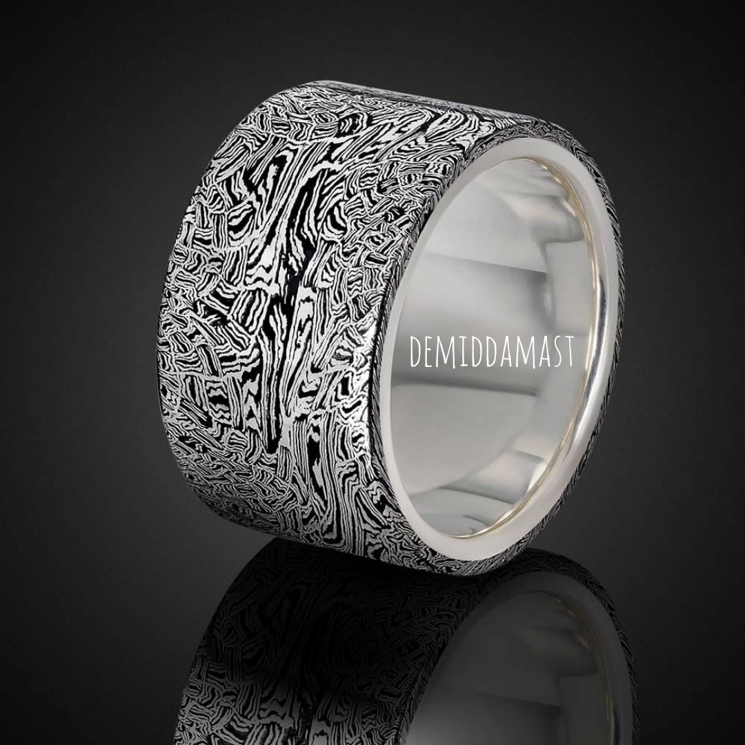

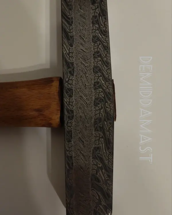

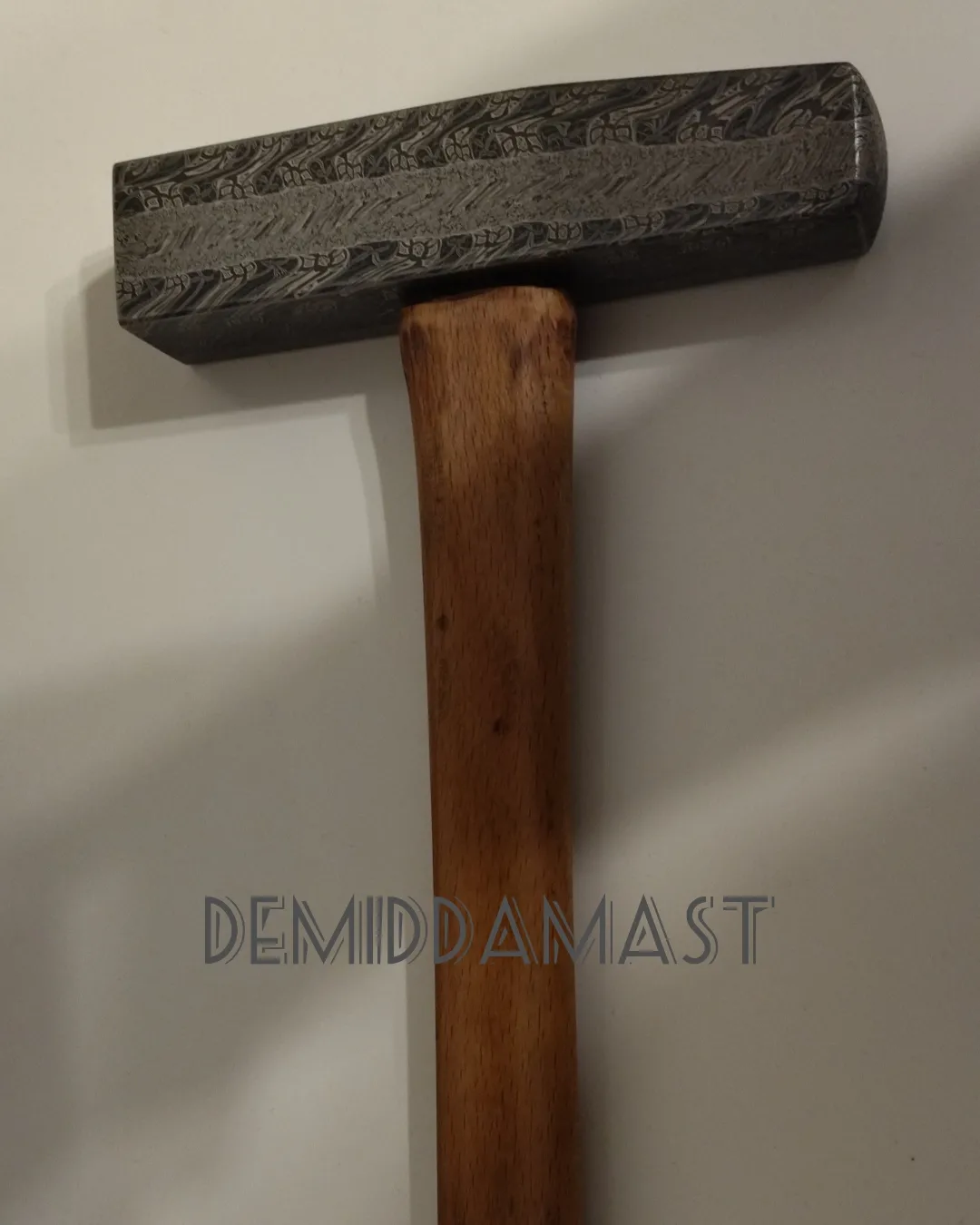

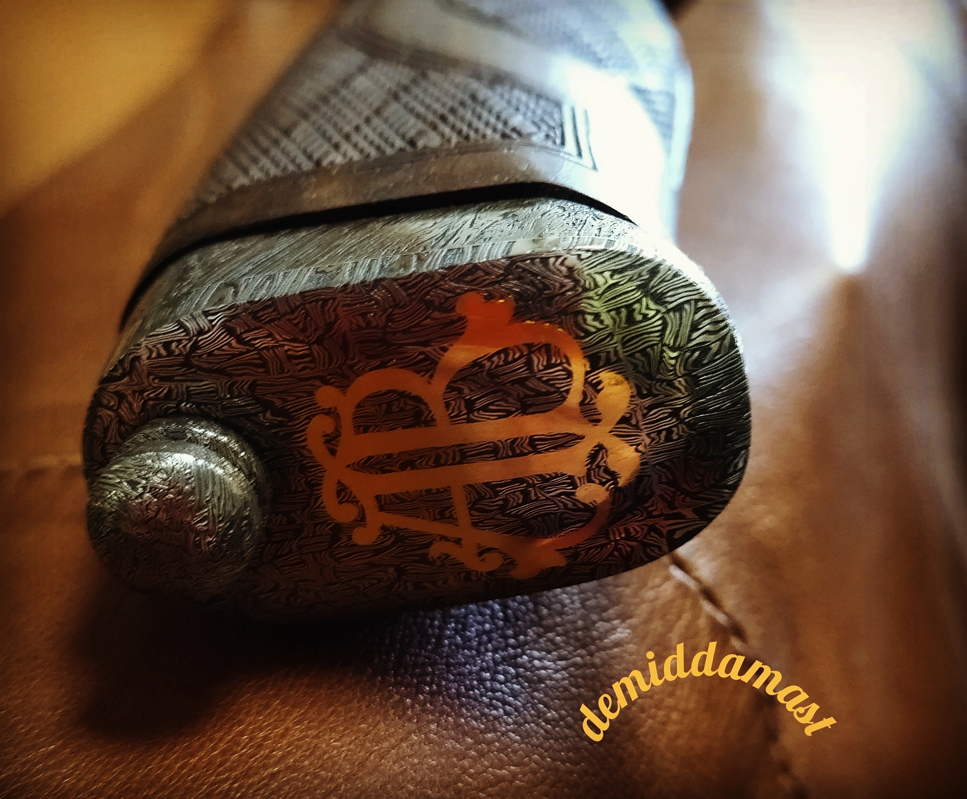

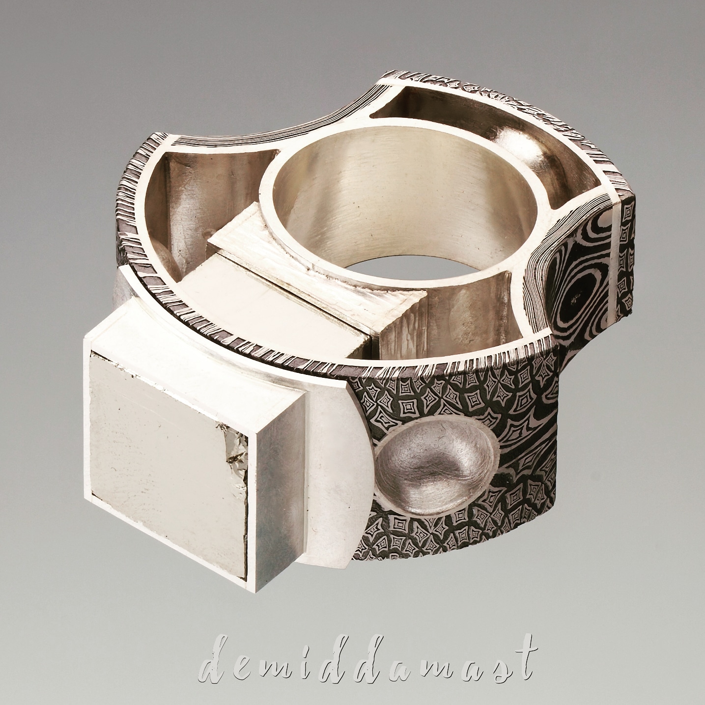

VoldemarDemid Posted January 12, 2023 Share Posted January 12, 2023 Good day everyone! A few photos of my knives and Damascus steel patterns. Quote Link to comment Share on other sites More sharing options...
Rojo Pedro Posted January 12, 2023 Share Posted January 12, 2023 Wow! Stunning work. Love the jewelry design. Quote Link to comment Share on other sites More sharing options...
VoldemarDemid Posted January 13, 2023 Share Posted January 13, 2023 Thank you for your opinion. Quote Link to comment Share on other sites More sharing options...

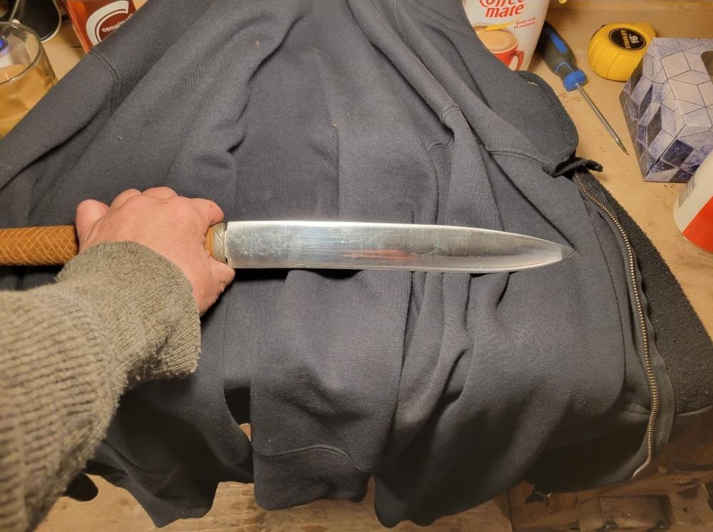

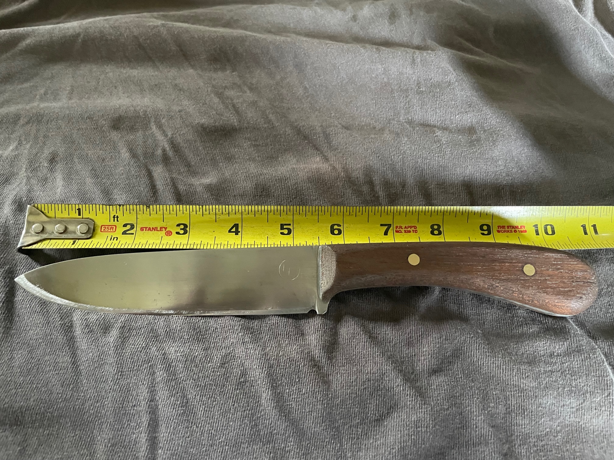

Les L Posted January 31, 2023 Share Posted January 31, 2023 Gavin, that's a great looking knife. I plan on making one in the future and I hope it comes out half as nice as yours. I finished my first knife yesterday. Started with a piece of 5/8 coil spring, all hand forged and hand filed to finish. It was a fun project, and a learning experience, but I don't think I will be doing another one before I get a belt grinder. Quote Link to comment Share on other sites More sharing options...

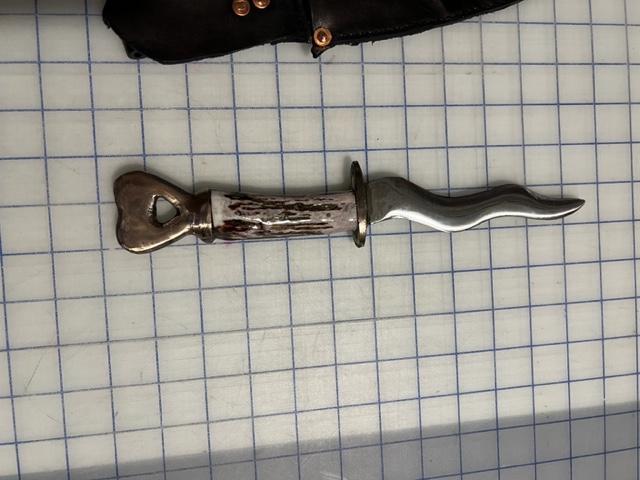

Purple Bullet Posted February 3, 2023 Share Posted February 3, 2023 I'm recovering from carpal tunnel and trigger thumb release surgery on my right hand so I haven't done much in the shop, but just before the surgery I gave up on improving the knife I made for my grand daughter. I'm not entirely happy with it. Instead of casting silver guard and bolster, I brazed on brass and copper respectively. Then I tinned it all with silver solder. Then, realizing she probably wouldn't want to polish it every week or so, I gave everything but the blade a few coats of UV resistant epoxy. I wish I hadn't buried the heart scrolls on the pommel in silver solder but once I got to tinning it was hard to stop. Like many knives, I think the goal is to be so menacing that it will never have to be used. That is my hope anyway. But if needed it WILL CUT! Quote Link to comment Share on other sites More sharing options...
Les L Posted February 4, 2023 Share Posted February 4, 2023 PB, that's a mean looking knife, if she has to pull it she'll probably not find out if it cuts because just seeing it will scare them off. Wishing you a speedy recovery and hope to see you at the next meeting Quote Link to comment Share on other sites More sharing options...

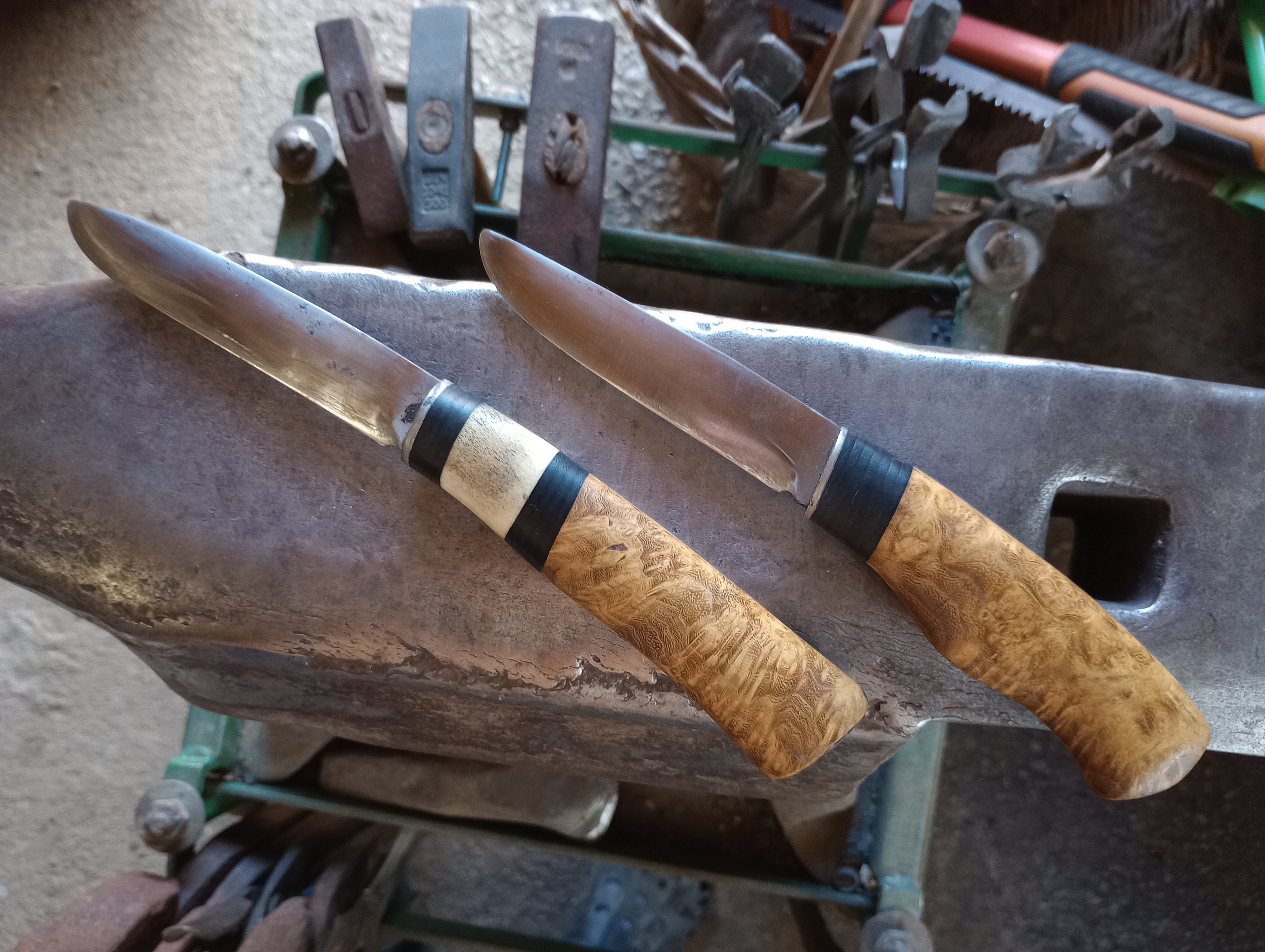

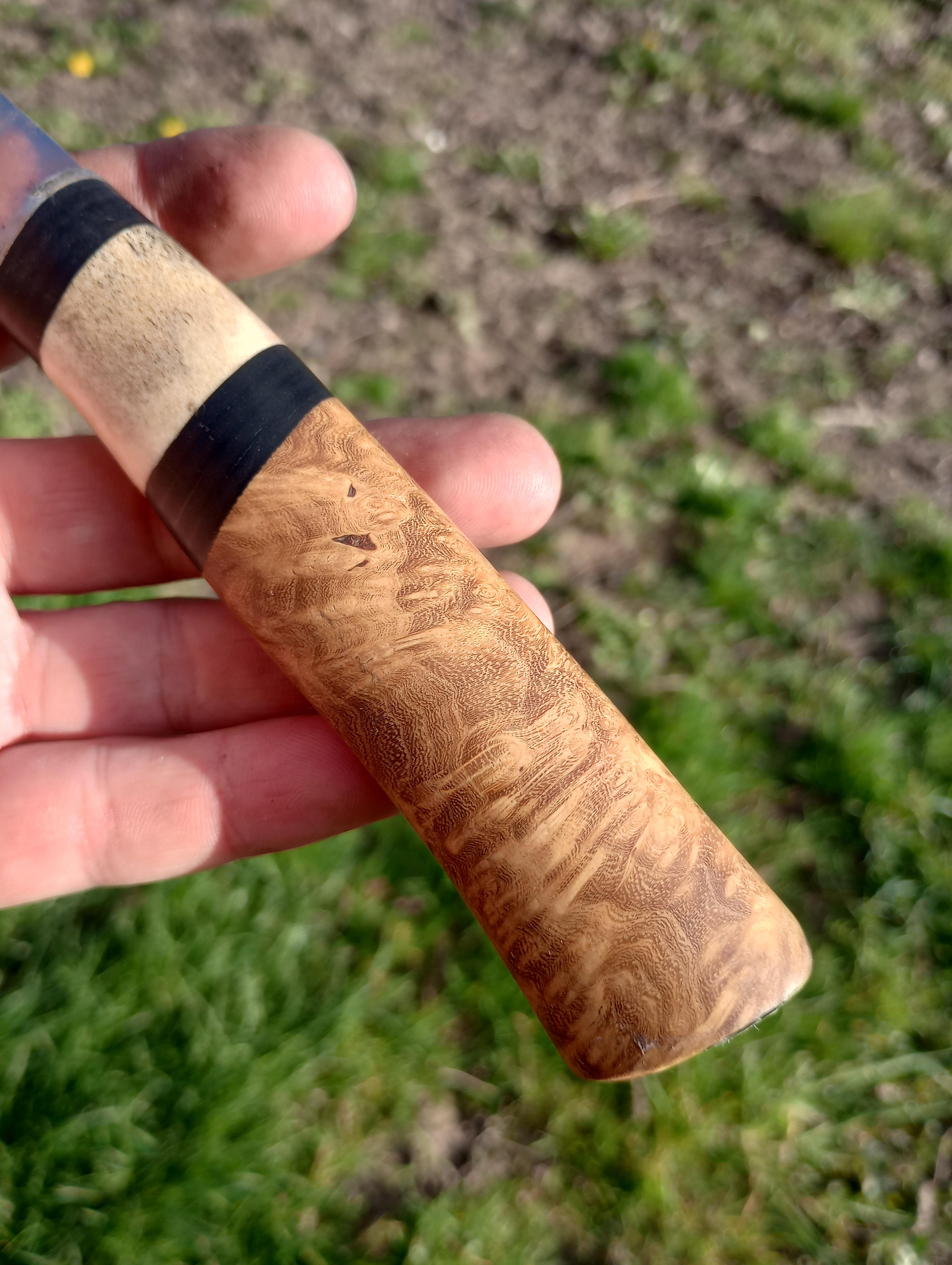

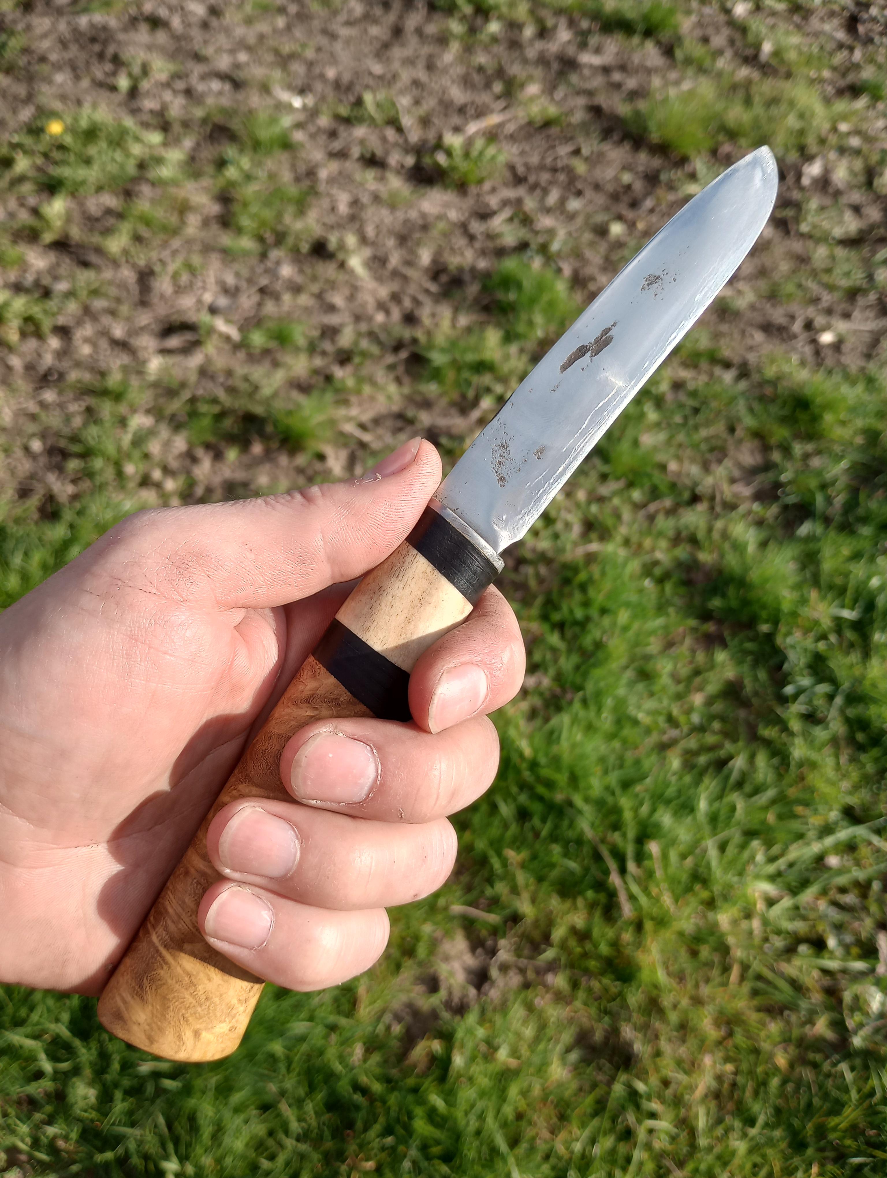

Davor Posted March 21, 2023 Share Posted March 21, 2023 Two more, leather and beech wood handles, from a knot on a tree. The longer handle has piece of antler. Blades from a coil spring. Quote Link to comment Share on other sites More sharing options...
M.J.Lampert Posted March 22, 2023 Share Posted March 22, 2023 look beautiful, love the contrast Quote Link to comment Share on other sites More sharing options...
Simian Posted March 22, 2023 Share Posted March 22, 2023 That wood is beautiful. Nice work. Quote Link to comment Share on other sites More sharing options...
seb leney Posted April 10, 2023 Share Posted April 10, 2023 love the handle on those knives. keep up the good work Quote Link to comment Share on other sites More sharing options...

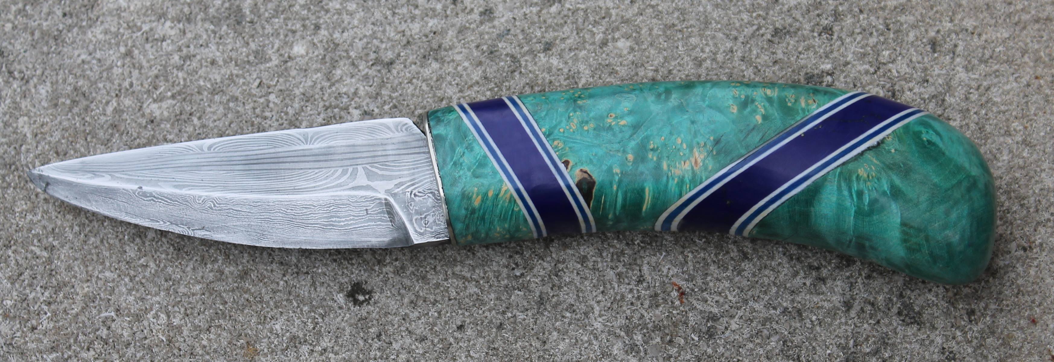

Steve Sells Posted April 10, 2023 Share Posted April 10, 2023 cant remember if I posted this one or not, 1084/L6 serpentine 3.25 inch blade cutting edge of WI/1095 box elder burl handle 7.75 inch over all Quote Link to comment Share on other sites More sharing options...
Latticino Posted April 10, 2023 Share Posted April 10, 2023 That's a cutie Steve. I like the multibar pattern. Quote Link to comment Share on other sites More sharing options...

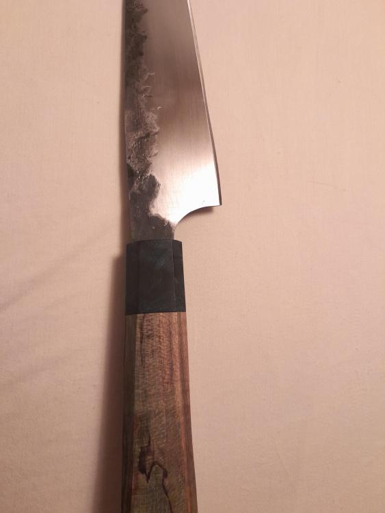

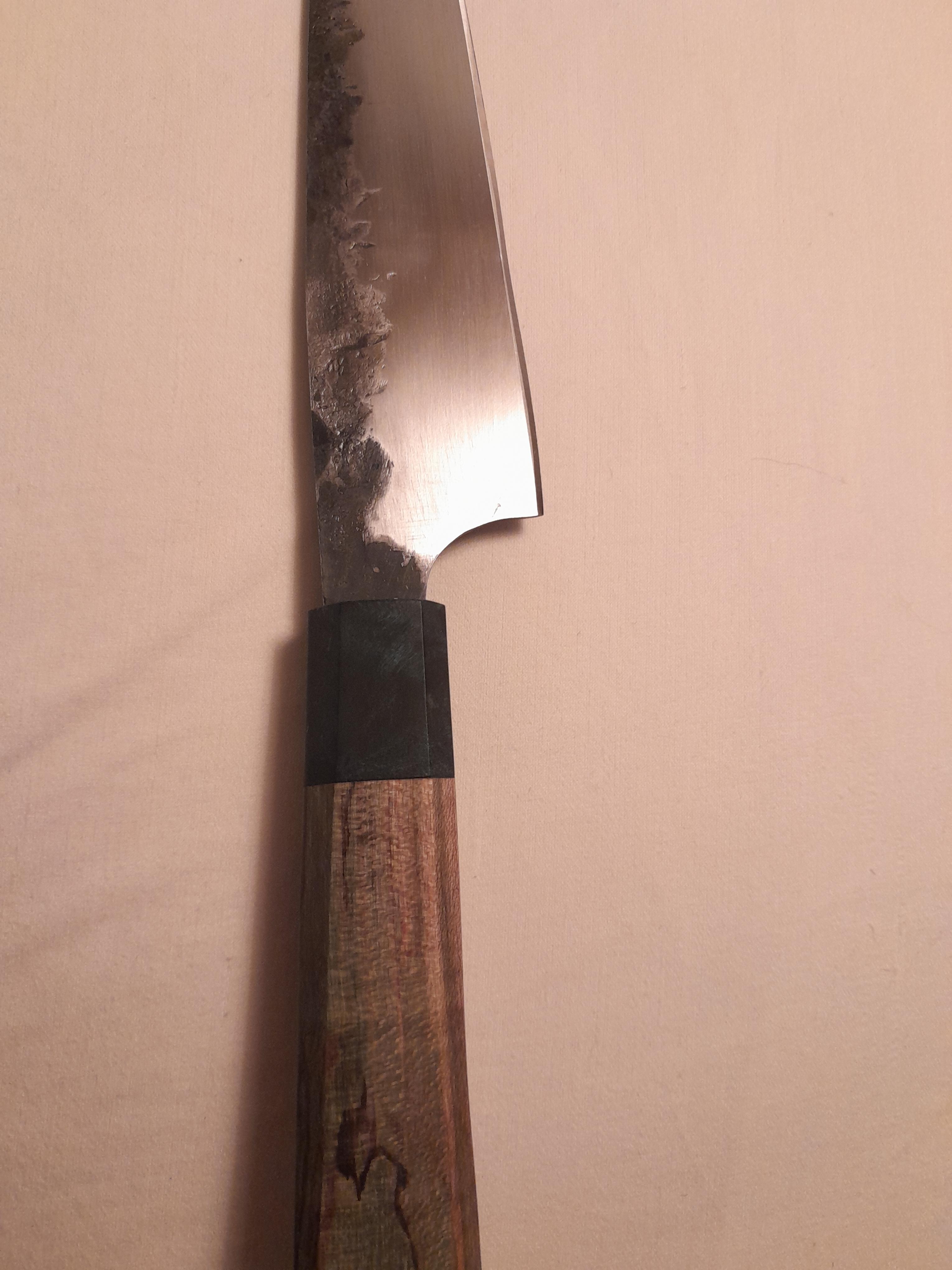

White Fox Forge Posted May 2, 2023 Share Posted May 2, 2023 This is my latest blade. It is my first Japanese kitchen knife with a wa style handle. The blade is forged from a recycled saw blade (8670) and the handle is buckeye burl and triple dyed oak. Both are stabilized. Quote Link to comment Share on other sites More sharing options...
Irondragon Forge ClayWorks Posted May 3, 2023 Share Posted May 3, 2023 Certainly is a good looking knife. Should be a pleasure to use it in the kitchen. I can't control the wind, all I can do is adjust my sails. ~ Semper Paratus Quote Link to comment Share on other sites More sharing options...
White Fox Forge Posted May 3, 2023 Share Posted May 3, 2023 Thank you, Irondragon. The blade edge ended up being a little thicker than I wanted. I am nervous grinding a thin edge post H.T. It still is sharp but not as refined as I would like. Quote Link to comment Share on other sites More sharing options...
