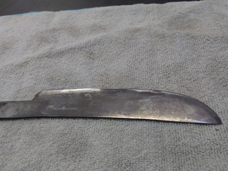

bluerooster Posted February 6, 2021 Share Posted February 6, 2021 After seeing the blades posted here I'm embarrassed to show mine. But I would like some input, so here goes: The pattern is evident, being 1095 and 10(low carbon =/<30) But The "Ol Lady" sez it just looks dirty. I agree. Mabe more layers? (only 12 here). Other than that I'm happy that it's smooth, and no flaking, of layers. (I assume good weld) I would like to find some known 23xx to bring better contrast. Quote Link to comment Share on other sites More sharing options...
