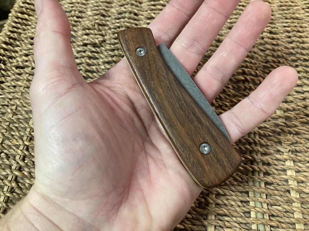

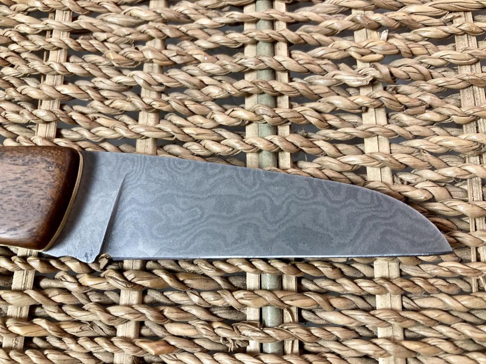

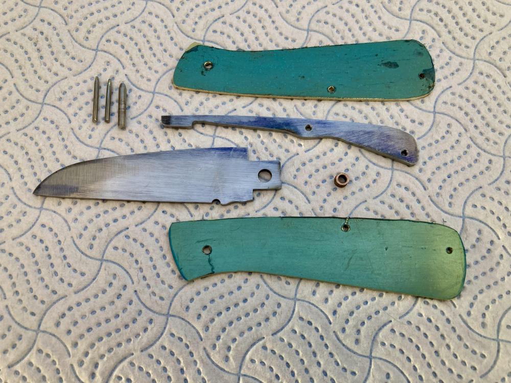

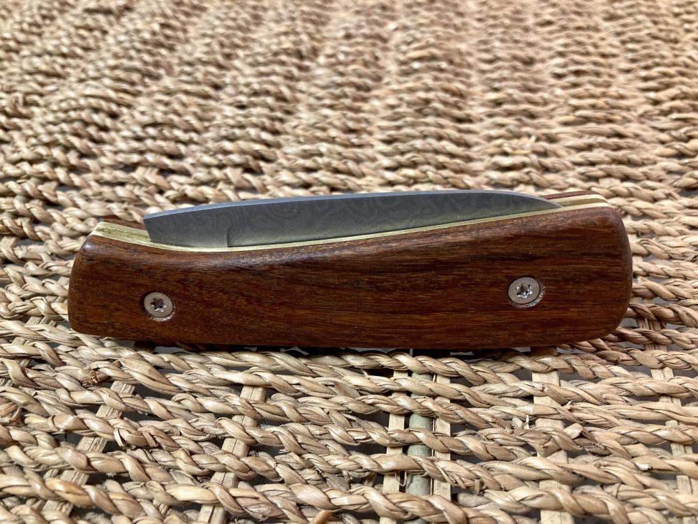

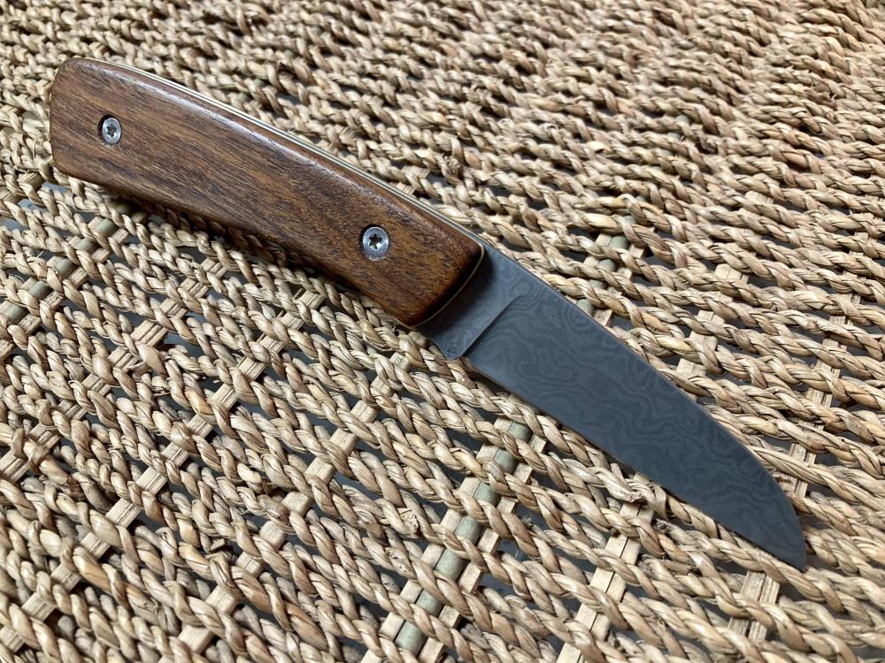

Hey All. I envy you guys in the states - if we want to carry a knife in the UK it has to be under 3" and non-locking. But, it gives me the want to try making one! So this is my first attempt at a slip joint, and it's a 80th birthday present for my Dad. From this; Some of my own damascus (80 layer!) for the blade and spring (old handsaws and 1095), 1.6mm brass liners and stainless pins (with a bushing). To this, with Rosewood scales & Stainless bolts. (another nod to the future owner - My Mum's name is Rose); It's not perfect. I did my best to get the steel flat without a surface grinder, but the liners ended up a tiny bit out of parallel so it *just* bites as it closes and doesn't snap shut The walk and talk from halfway to fully open is good, but I also fudged the closed position, so the spring is a fraction below the liners (flush at open and half). I learned a lot, and number two should be a vast improvement. Critique welcome.

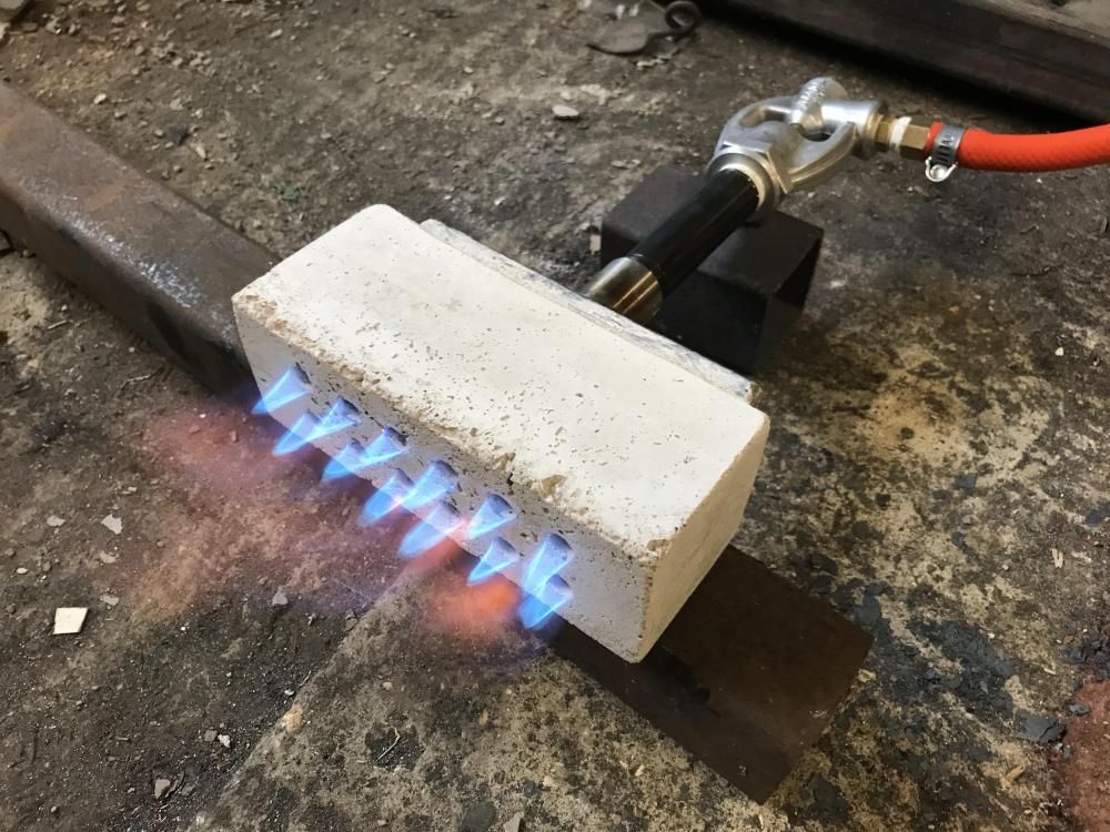

See the 1/2" Amal on the ribbon burner above, Mr. Frosty. once it's up and running I'll tune the 1/2" frosty burner on it, leaving the Amal free for other duties.

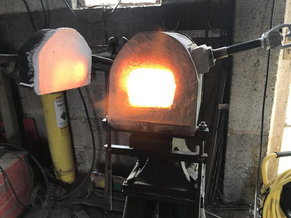

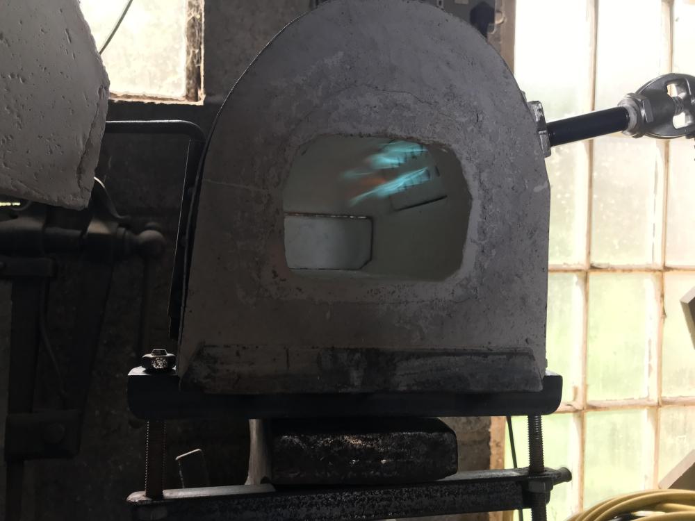

Cheeky! And impatient It's a 1600C (2900F) 40% alumina castable recommended by some other smiths in the UK. Water setting, same as Kastolite. Close to 1/4" over most of it, 1/2" for the floor and around the openings. Somewhere around 150 Cu in.
C'mon, do your worst. How badly have I messed this up? Huge hole on side is for the ribbon burner, rear hole will get plugged unless needed... I just need to wrap it in Kaowool and steel. For scale, the main former was a 2 litre soda bottle.
Thanks Mikey, Message received! I think I'm confusing too many factors - I'll break it down a bit and work through them one by one. I have the best High alumina castable I can find in the UK (recommended by other smiths). I've read a lot on here to suggest that a 1/2" floor, and 1/4" layer of castable 'shell' is ample, and I'll use 2 layers of 1" Kaowool. I can make a steel case for it. Is there any major downside to the image on the left, as opposed to the image on the right. (sorry for the awful drawing). Buzzkill has pointed out one - making the one on the left with no gapping. I believe the image on the left will be much easier to build - that's all. Am I overthinking this? I have a habit of doing so!

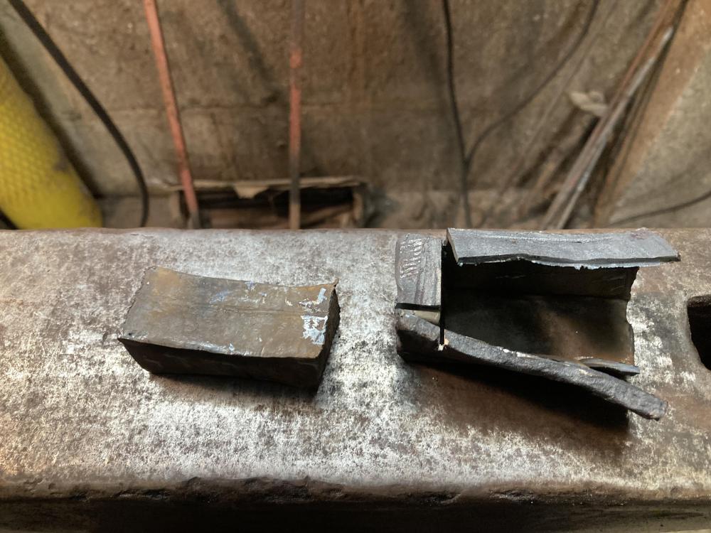

Me again, Asking more questions (sorry) I'm building a small forge - some where around 150 cu in (2.5 Litres). I'm struggling to line it with castable as the entrance is really small - I can barely get my hand in. Is there any major disadvantage to casting a large flat 1/2" thick floor (over 2" of Kaowool) for an upper shell to sit on? This would make it a D shaped forge, easily replaceable floor, and I'd be able to cast the upper easily. I'll draw an awful picture if that doesn't make sense
