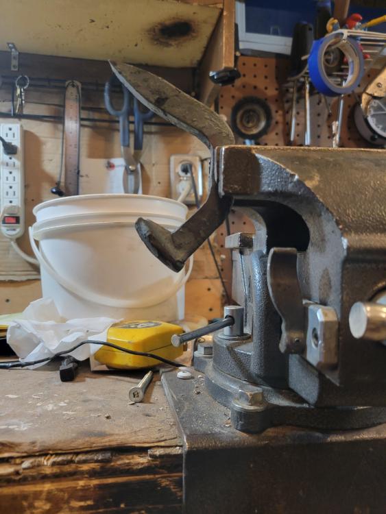

Made steel plate for my old Rock Island vice i have and bolted him down to the new work bench. Now i can finally use it... uh that is till i noticed i did not take into account the damage already done to the cast iron when i measured the hole placement. I did try flipping it but for some reason flipping not only made it smaller but also crooked. I can still use it some till i fix but just kind of disappointing.

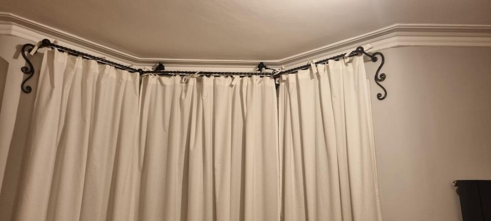

Finished another project. A customer from London sent a photo of curtain rods. Before that, I made a chandelier and a frame for a mirror.
