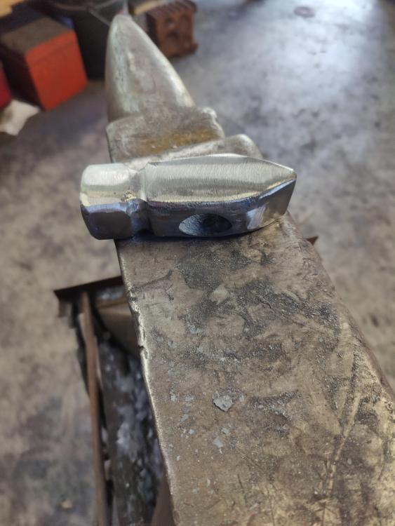

A nice session of trying out ideas and finishing up a couple of half-done projects. Hardened and handled the set hammer I forged yesterday and converted a diagonal-peen hammer to straight-peen:

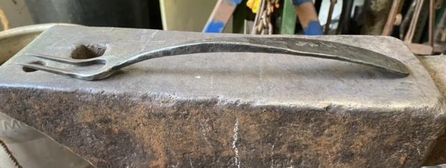

Finished a fork and tried out an idea for a pair of scrolling/bending tongs (would have liked the reins of the latter to be a bit beefier, but we’ll see how well they perform):
JHCC looks like a good day! I like that set hammer!
Thank you!
 On a side note, the diagonal-peen started life as a ball-peen; I forged the diagonal a few years back to see how I liked it. I didn’t. However, I have been making good use of a heavier straight-peen, so this reforging gives me a lighter one that I’m more likely to put to use.
I could tell by that profile! I have a ball peen that im going to convert also at some point.

Nice tongs John, how's the flatter work for you? How far did you draw the temper down on the struck end?
Pretty hammer Billy I'm looking forward to hearing how it works for you.
I haven't put the set hammer to use yet, so I can't speak to its utility. Regarding hardness, I only quenched the working face during hardening; for tempering, I put the struck end in the forge and watched the face until the color ran to purple. I am guessing, therefore, that the struck end is still pretty soft.
Purple should be good. Did you chamfer the struck end? A strong chamfer mitigates mushrooming nicely.
