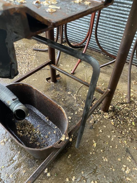

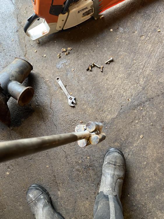

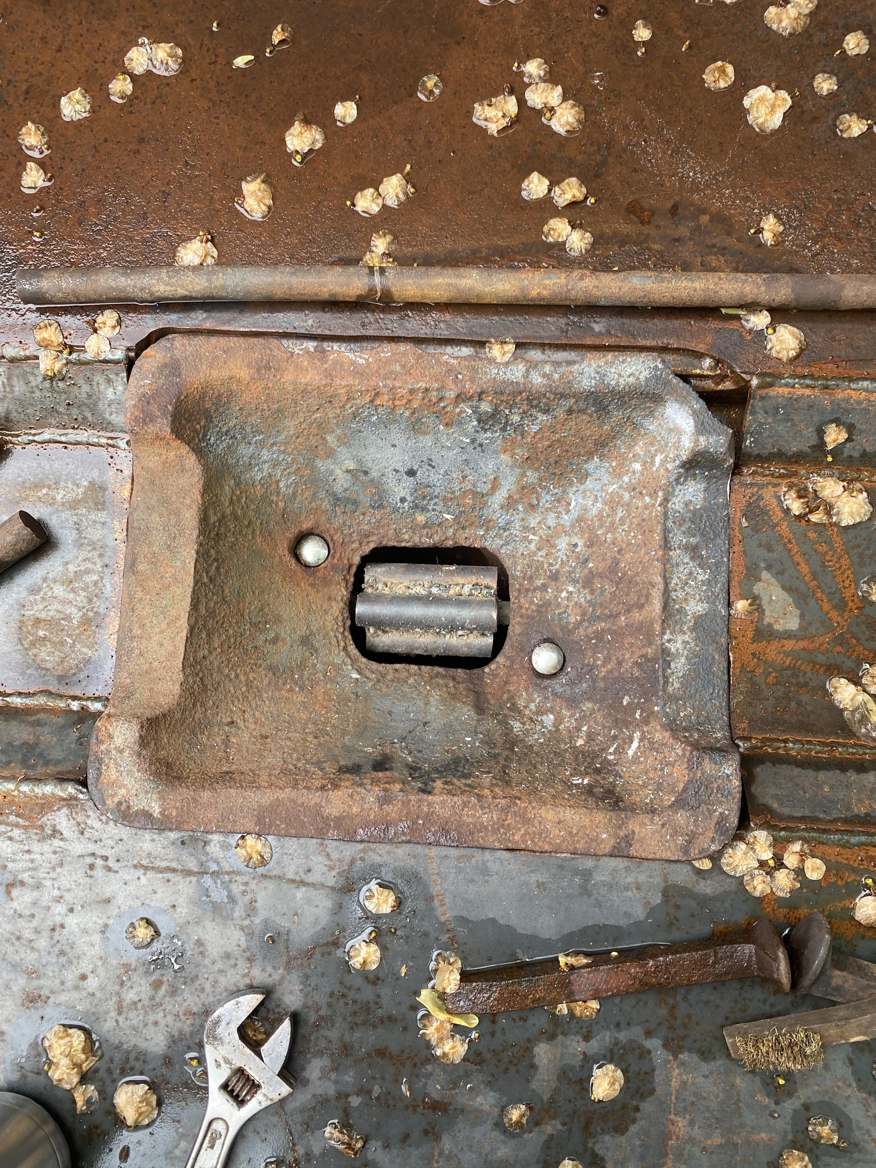

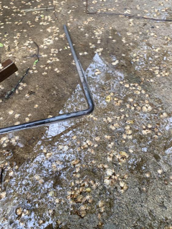

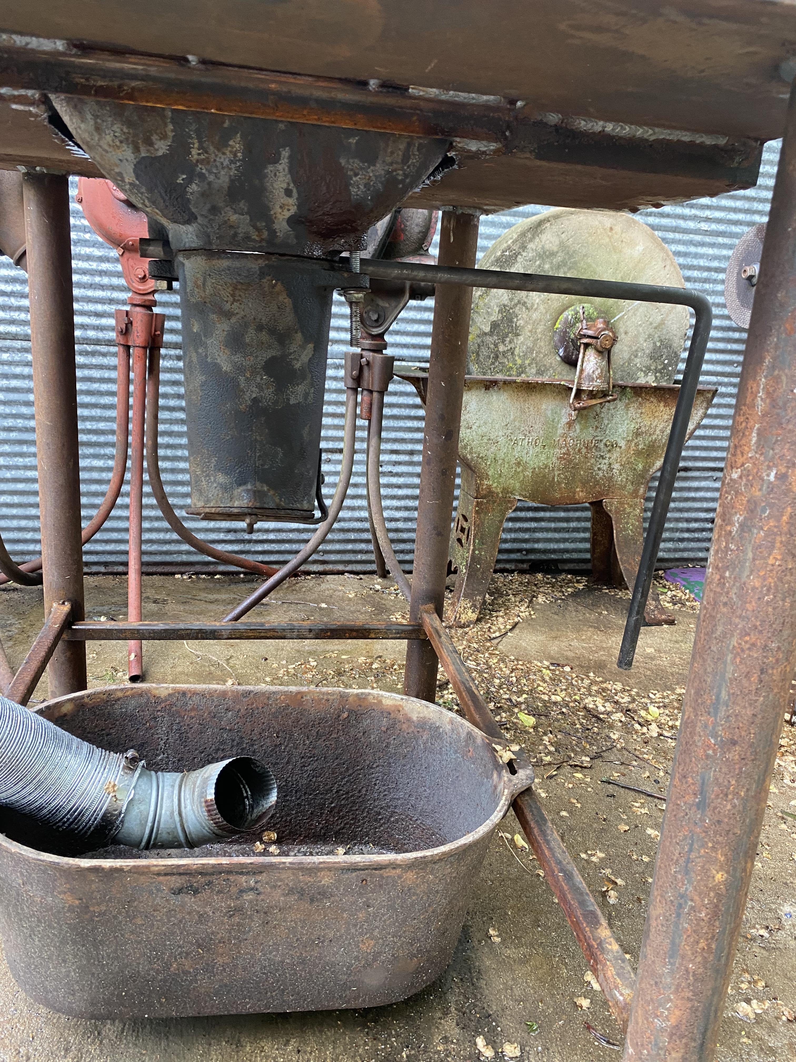

TWISTEDWILLOW Posted May 2, 2022 Share Posted May 2, 2022 Today I finally got around to tearing down an old firepot I found awhile back, bolts twisted off an had to be drilled an drove out with punches, Ive been wantin to build a clinker breaker for it an found some 5/8” round for the shaft, I originally wanted to go with the stacked triangle breaker idea, JHCC posted last summer but I didn’t have any 3” flat bar stock to work with, But I do have piles of sucker rod! so that’s what I used lol, here it is… the super duper, high speed, low drag, sucker rod clinker breaker! Complete with a manual shift and 4x4 clinker breaking abilities! made with the toughest material an cheapest welder available in peavine Oklahoma! Lol it’s been storming all day so I wasn’t able to fire up a forge, out in the smithy so I did the next best thing an lit a fire in the shop stove, an heated up the 5/8” so I could bend it, an quenched it in a rain puddle lol I precision cut four pieces of 7/8” sucker rod to 3-1/2” long by eyeing it with an angle grinder, and welded them to the 5/8” shaft! every thing turns smoothly completely around with no catching, I hooked up a champion midway spiral blower I’ve been wanting to test out, an it seems to be getting more than enough air flow, so when it dries up out in the smithy I’ll fire it up an see how it works, It will give me an excuse to forge a tool rack to weld on that new forge, Quote Link to comment Share on other sites More sharing options...

Purple Bullet Posted May 3, 2022 Share Posted May 3, 2022 I like the way it fits the shape of the tuyere opening. However, I would think that three lobes on your breaker would allow more air through. If you block off too much of your opening you have to use higher velocity to get the same air flow, which is not always a good thing IMHO. My blower is hand cranked and I love to crank hard for a while to get everything really hot, then open the flow (I can somewhat retract my breaker) and maintain with a slow, easy crank. Quote Link to comment Share on other sites More sharing options...
TWISTEDWILLOW Posted May 3, 2022 Share Posted May 3, 2022 10 hours ago, JHCC said: Looks good, TW Thank you John! I agree Randy! that’s why I make so much stuff outta sucker rod lol PB, thanks, ive got various forges around here with different setups for clinker breakers or grates, I’ve seen 3 sided triangle, round shaped, disk shaped, square shaped, an cup shaped breakers before, it’s hard to tell from the pictures but this firepot has a very large inlet into the fire pot like 4-1/2”x3-1/2”, one of my other forges I’ve built only has a 1-1/2” diameter inlet/outlet and ive forge welded using it, the breaker is actually recessed down in the tuyere, and there’s around inch clearance all the way around it, Just testing, it feels like it’s getting plenty of air at a slow crank with one of my 12” blowers, but I won’t know for sure till I fire it up! if it don’t work we’ll always think it should’ve! also if it don’t work, it’s only two nuts to pull the tuyere off and throw a different one In There! lol Quote Link to comment Share on other sites More sharing options...
