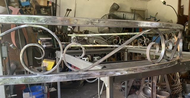

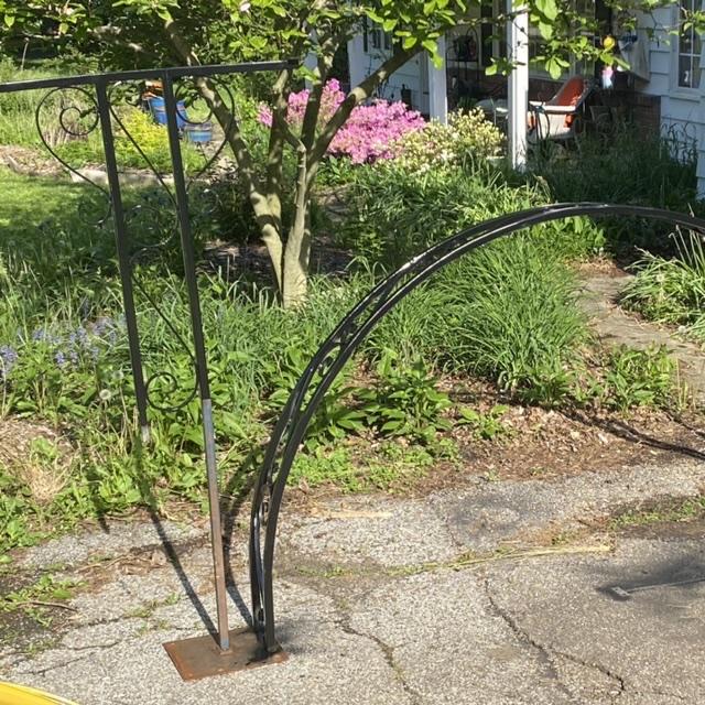

Much grinding of welds. Ready for wirebrushing and paint.

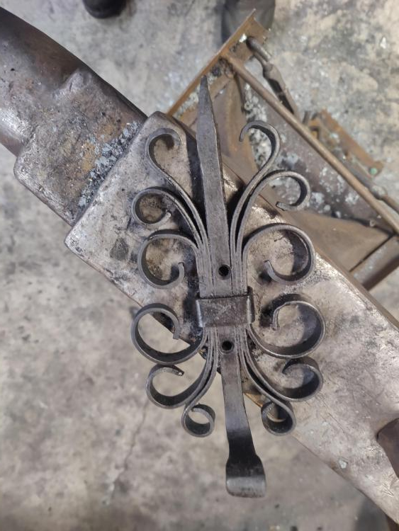

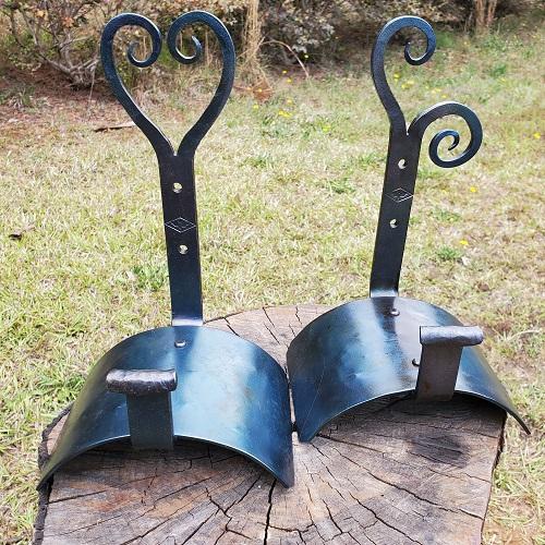

Made the wife a hook for her bath robe, or what ever. Think it turned out pretty cool.
Today I cleaned, assembled, and finished two hose/cable/cord hooks, based on John Switzer's video. I had a week off work, so I put some work over the last several days and turned out a few key racks and a couple fireplace tool sets as well. I'm trying to build up some inventory for my first vendor event.

Billy, very cool and pretty.  I am assuming that the center piece at the top of the photo loops back toward the viewer to make the hanging hook.  Correct?

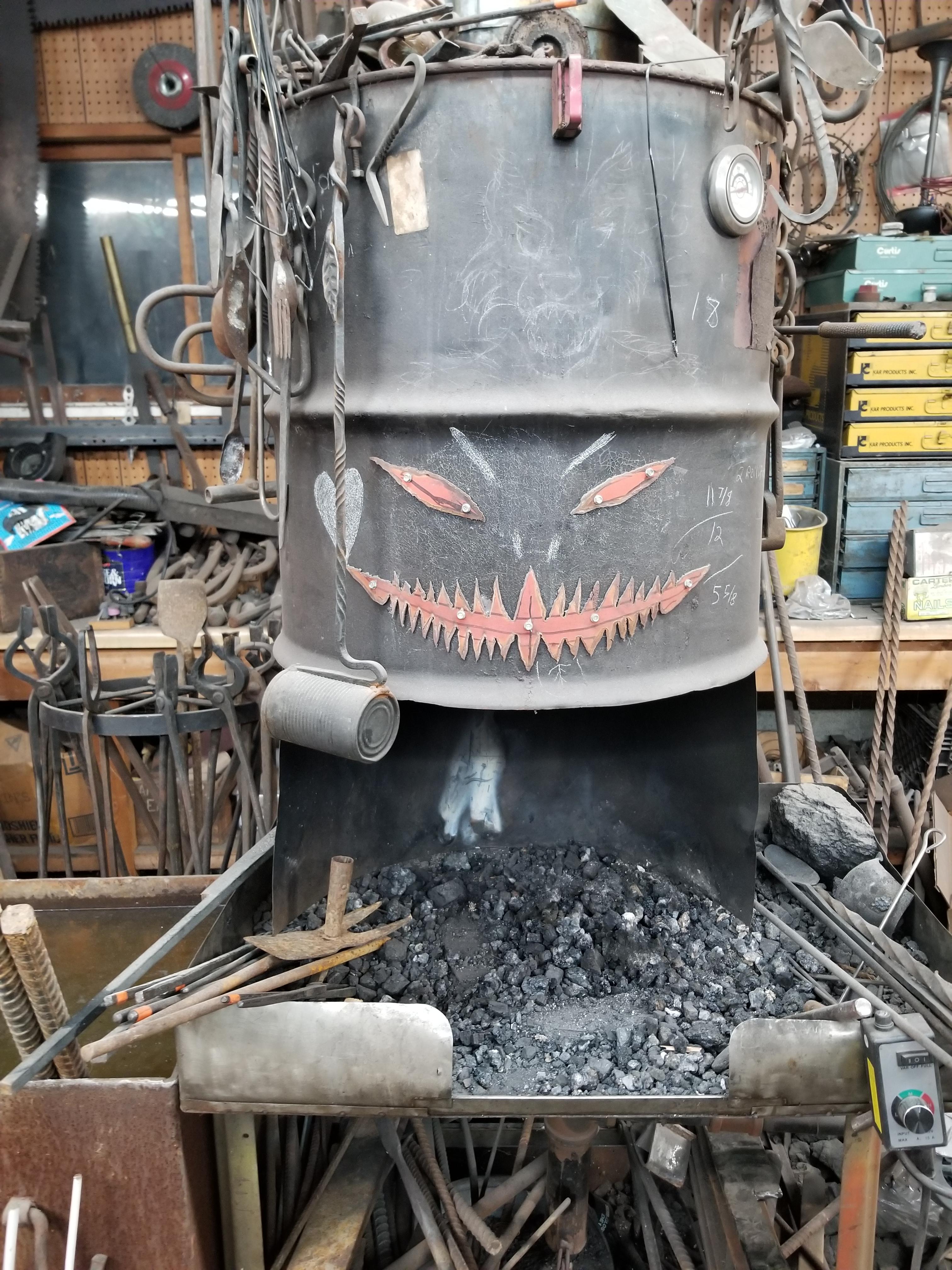

I put the finishing touches on my forge setup. It is now useable! I am sure there will be tweaks needed, but I can at least start hammerin' some steel!281898366_1396944124062041_2412194057416040410_n.thumb.jpg.da3256d5e7e5173344720639ae624e45.jpg

One thing on chimney efficacy: measure the size of the pipe as compared to the size of the area it draws from.

Billy, she should love it.

Wandering rogue, I ended up using two thirds of a barrel as my forge hood. It did not draw enough until it was hot. Advise given was to make an insert of sheet metal curved around in the barrel to narrow the space of the opening. It has worked great for around 8 years. I can lift it up and into the barrel hood with a friction fit when heated up and working longer stock. I keep it down for small work.

DASWULF: Seems like a simple solution to the problem! Unfortunately, I only had access to the half barrel, and the original intent was to have it sitting right down over the fire pot, hence it being cut this way.... Unfortunately I ran out of stove pipe. I will need to pick up some more and then I can lower it down a bit closer to the table top.

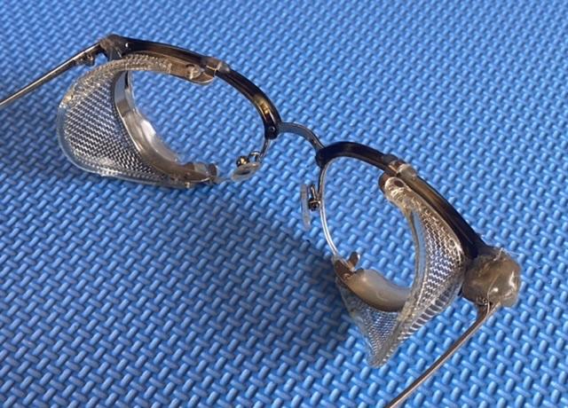

An additional little project for the shop (if not actually in the shop): I recently got some new glasses to replace a pair with a broken frame. I realized last night that I could turn the old pair into shop glasses by adding a pair of removable side shields (picked up at the flea market for 50 cents) and reattaching the earpiece. A good bit of hot glue later, et voilá!

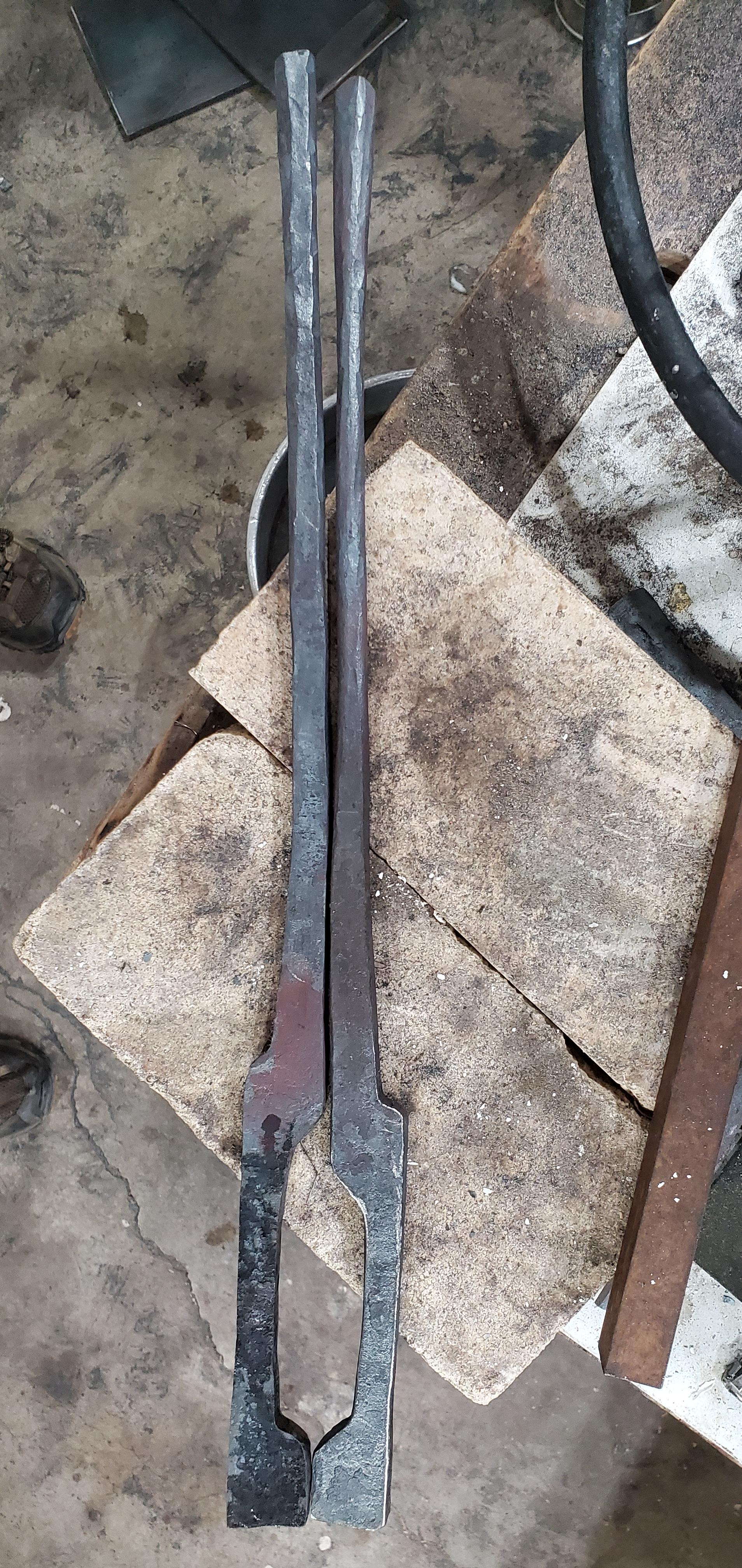

Here's the next set of tongs I'm working on. Little problem, unfortunately, as you can see. I marked these out exactly the same, but the jaw portion on the left is about 3/4 of an inch longer. When I was drawing it out and setting up the boss with half-faced blows, I screwed up and struck a blow that indented the material a bit past where I had started to establish the boss, maybe a 1/16th.
I couldn't see how to fix that without causign a cold shut,  so I decided to just use the new indentation as the start of the boss, knowing that the jaw would be a bit longer. The stock I'm using is pretty meaty, 1 by 1/5, so it drew out a fair bit longer than I expected. I'm not sure at this point if I should just continue wiht this set and have the bend in the jaw be asymetric or if I should make two new sides, one to match each of the existing ones. I hadn't planned on making another set of bolt tongs right away after making this one, but I guess it wouldn't hurt to have on set for 3/8 as well as for 3/4, which is what I intended for this one.

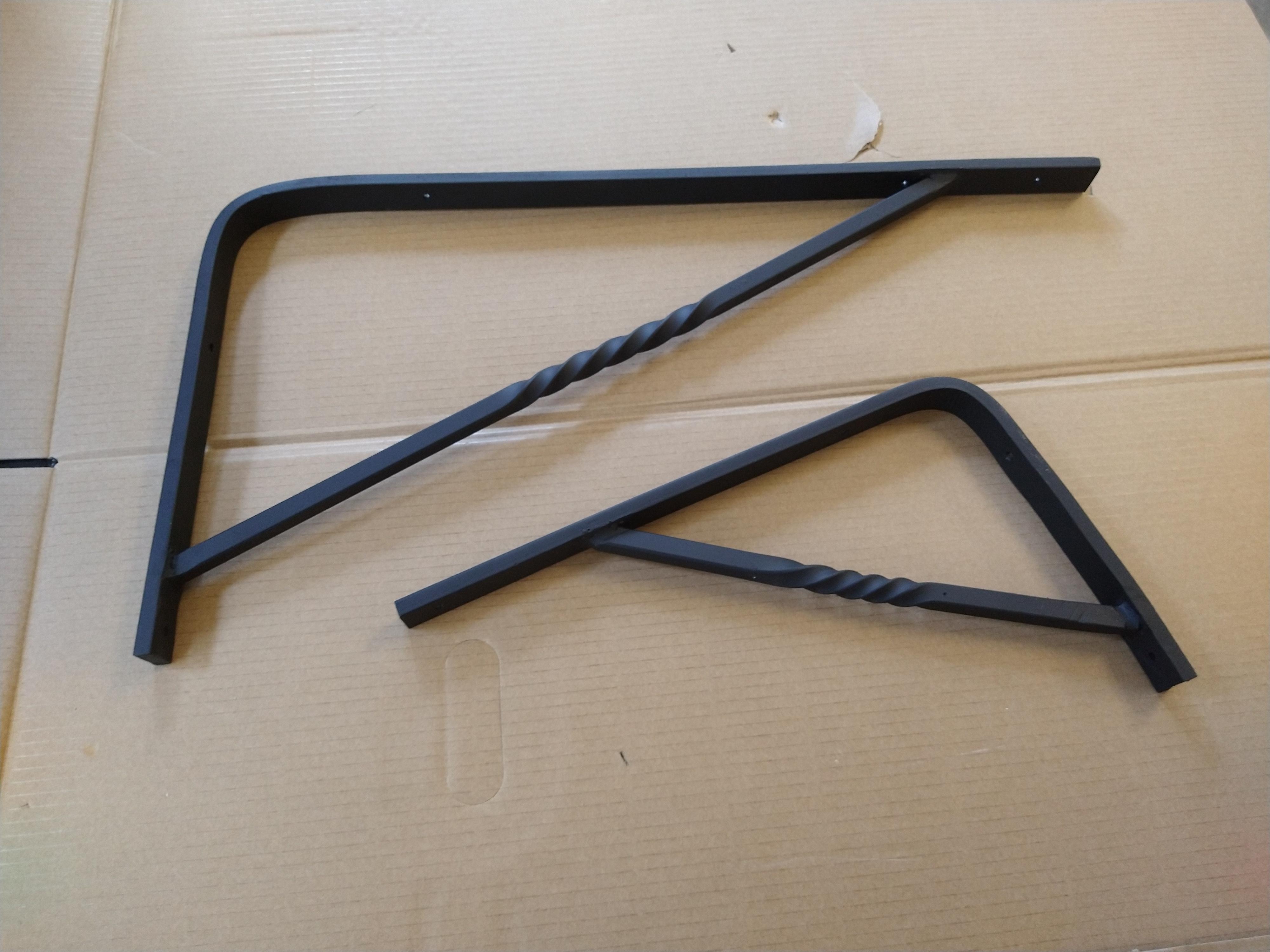

Got back to some metal work yesterday and this a.m.  forge is figured out and running great now.   The are two brackets I made yesterday to hold my wife's families spinning wheel up on our wall.  There will be some runners that extend our on top to hold each set of legs, this way a shelf was not needed.   Going to wait a few days to mount the runners as they were stained.and want to let the smell fade.  Also working on a wall hanging bracket for an oxen yolk.
Smaller one has a bend in it that I tried to straighten out, tried to do the 90 on the anvil instead of the vise.  Learning in progress.IMG_20220522_110846621.thumb.jpg.8c0e4492f887aaeda5fe1f7d96766609.jpg
Cleaning and painting.
(Although I did run out of paint halfway through.)
