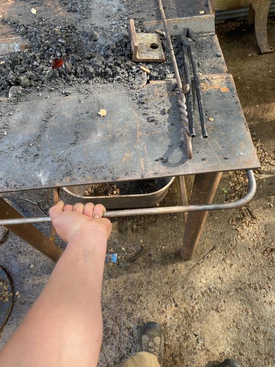

Pro tip: If you build a nice big new work bench make sure you have space for it. Had to rearrange the whole shop. Moved the forge, anvil, another work bench tool boxes, etc. I did find a bunch of stuff i have been missing though. Also i ended up having to clean off everything to move it all.

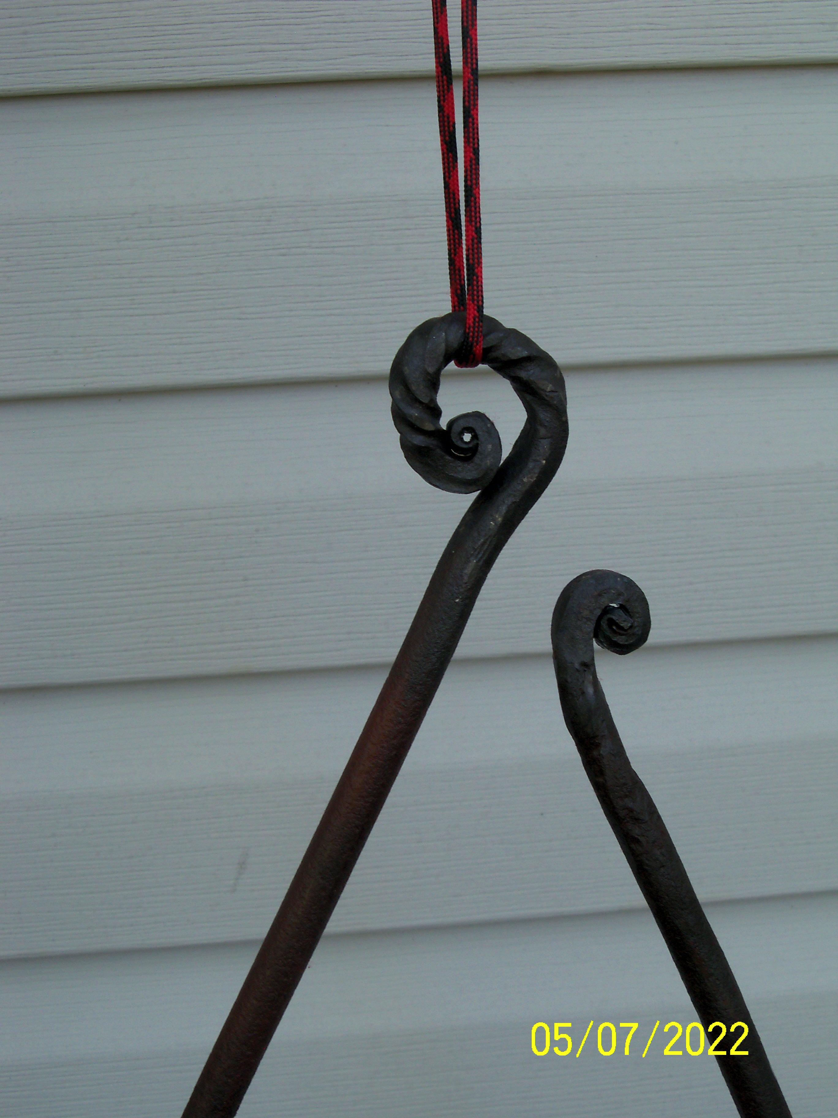

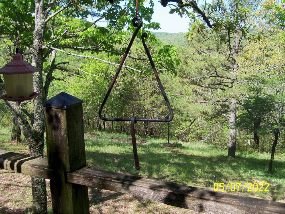

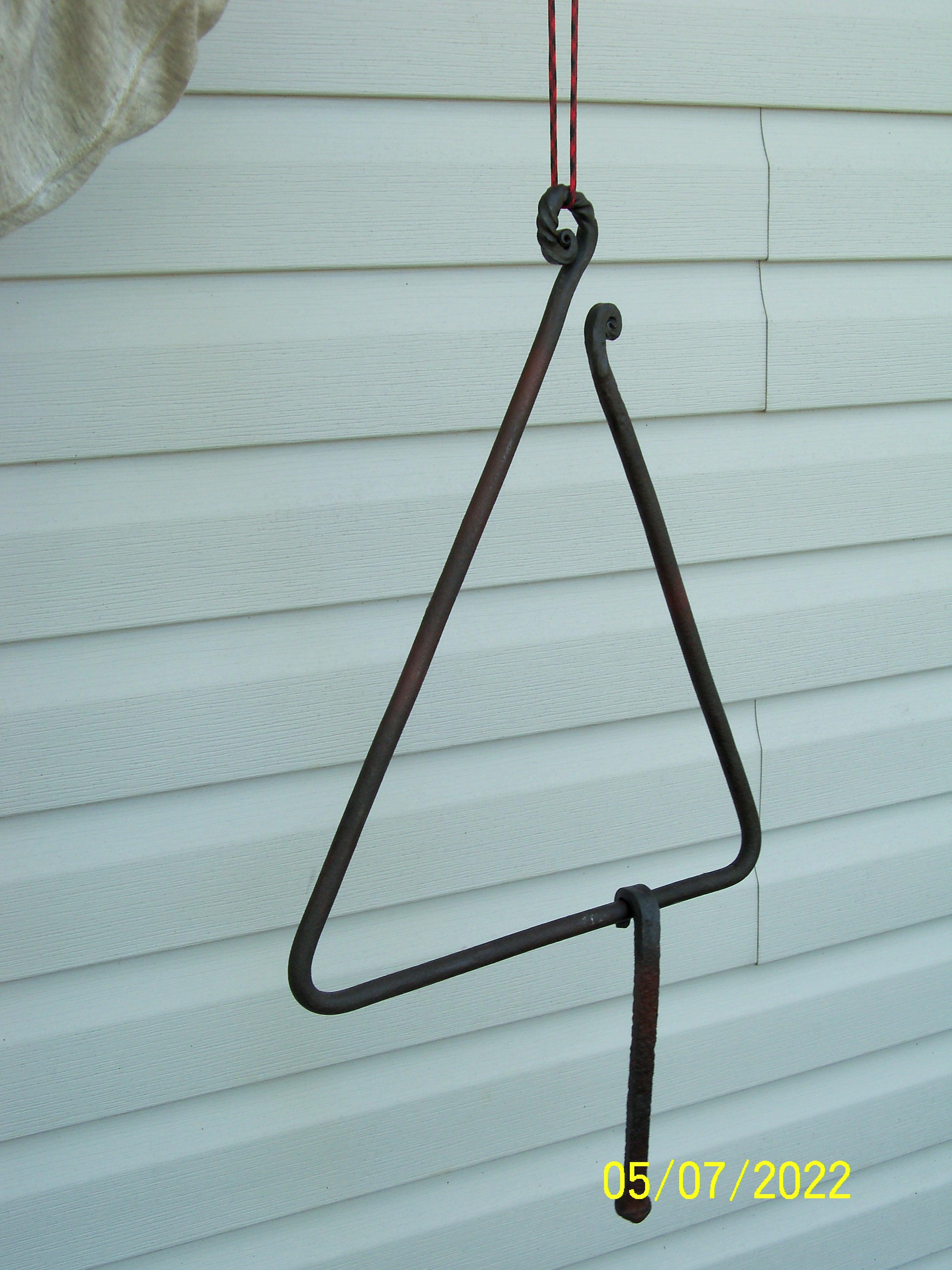

Here are some pictures of the dinner triangle. It is made from an old horse drawn hay rake tine and the striker is an old wrought iron (I think) spike. It's loud and Debi likes it. I left some of the rust (patina) when oiling so it looks old.
HC steel should have a better ring to it so hay rake tine is a great choice.  Did you quench the corners, (and temper them a bit as HRT is HC!)
I didn't quench but did wait and used my water can to cool the straight sections at black heat to be able to hold them without tongs. I made the sections a different length, the section with the hanger is 15 in, the bottom is 14 in, and the last open 13 in. It sort of makes a cord when struck in a circular motion.

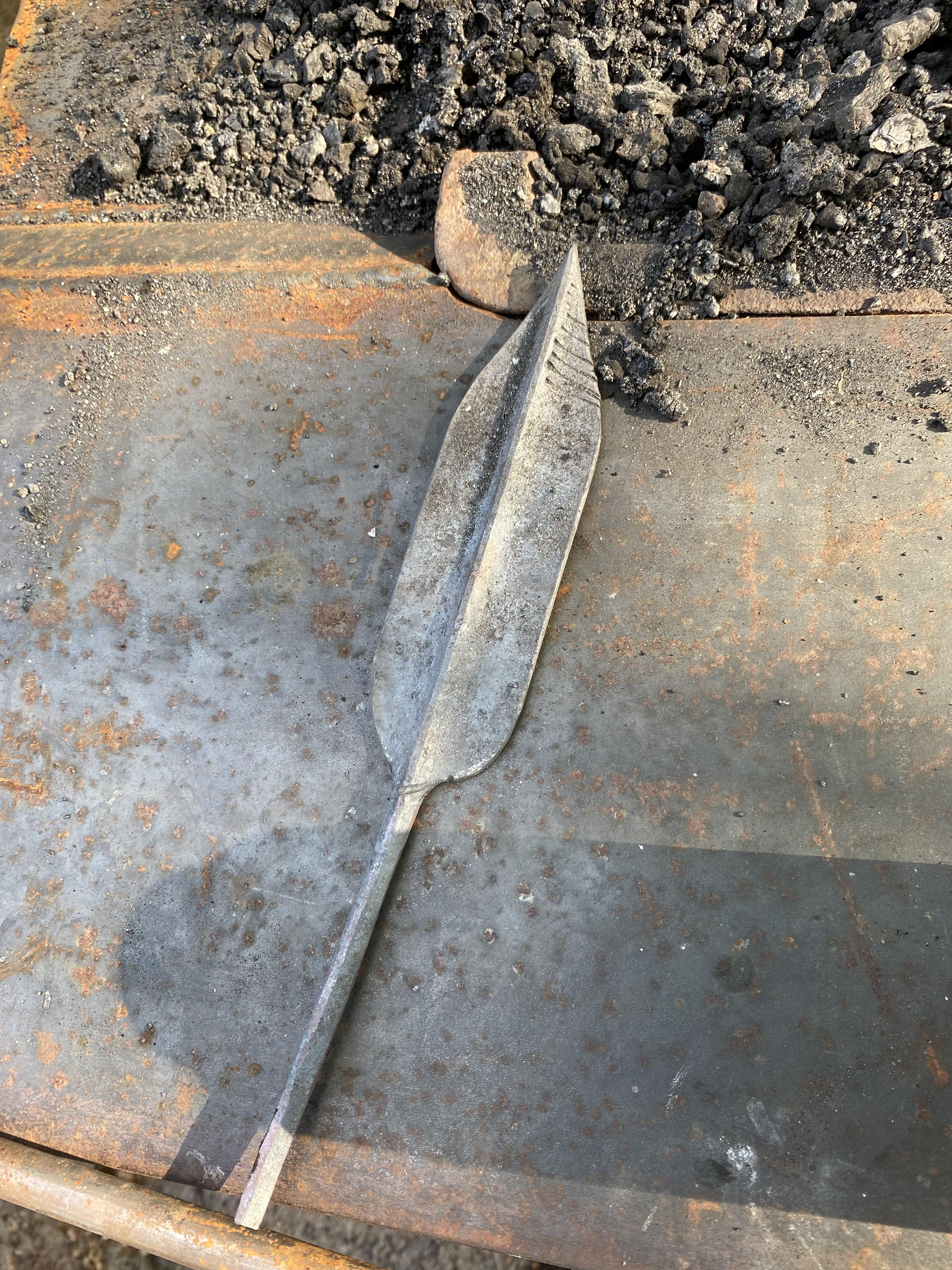

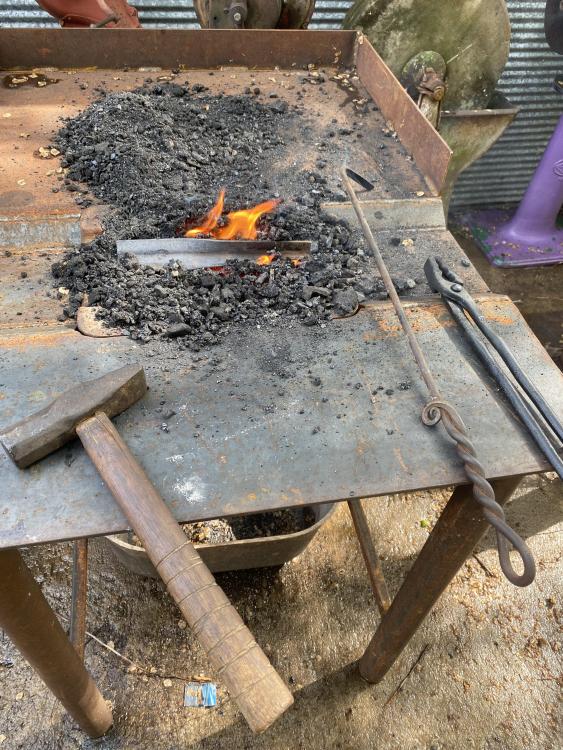

Rain finally let up, a couple days ago and got a chance to fire up the new forge for a test run, heated an bent some 1/2” round to make a tool hanger, and started on making a feather,DFDA78A5-129C-4AA3-BBA6-49DF7F16D62D.thumb.jpeg.321b687b2be5837891d0b0cd50c9f907.jpegF46C9ACD-83E7-465E-94EF-B3C0952D758B.thumb.jpeg.6516ad8a8501810ebb6f421be0a0b28c.jpegE6E4C9A4-BAF6-4630-AD80-C73E2A43C870.thumb.jpeg.33a4012bed550a5510bf9d4307751d38.jpegC36FA894-8CB0-4ABD-B8F6-27F0C8C7556A.thumb.jpeg.6cf5006fc807e0ad4a78dba3409f1fe8.jpeg

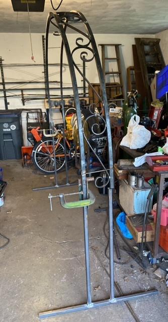

I think I mentioned that I’d cut the last major frame elements for the arch; yesterday, I welded them up and did the first full-size test assembly.

I made a hook from a piece of 3/8” square, a bottle opener from half a RR spike and an anvil hold down from a piece of sucker rod,  works real good.
lots of fun and thanks for looking70AF5E08-2433-47A2-AE4B-0EC3AD1FB942.thumb.jpeg.8489b045b810a22cc70f4ee7a786d265.jpeg
Spent 2 days moving everything around the shop. Got everything where i thought i wanted it only to discover i did not like it. Also where i moved the forge to did not seem to draft as well. Centered my anvil in the shop so i can now get to all sides easily. Also re-orientated it. Moved the horn from hammer side to tong side. I also changed where i stand in relation to the anvil. I am now standing at the heel with the horn in a NW orientation to my body rather than side to side. This makes it much easier for me to get a good 90* angle with my work to the anvil face. Also with the horn on my tong hand side it feels more natural to get the same 90* with the angle of the horn. I think i may have discovered the reason that people say that the horn goes to the tong side. So i made a hasp and started a skillet and pot hanger for the wife. So far i like this set up much more than previous. Need to figure out location for my hammer and hardy tool rack, and where to set things while working. My guillotines are also now backward but that is just a minor inconvenience.
