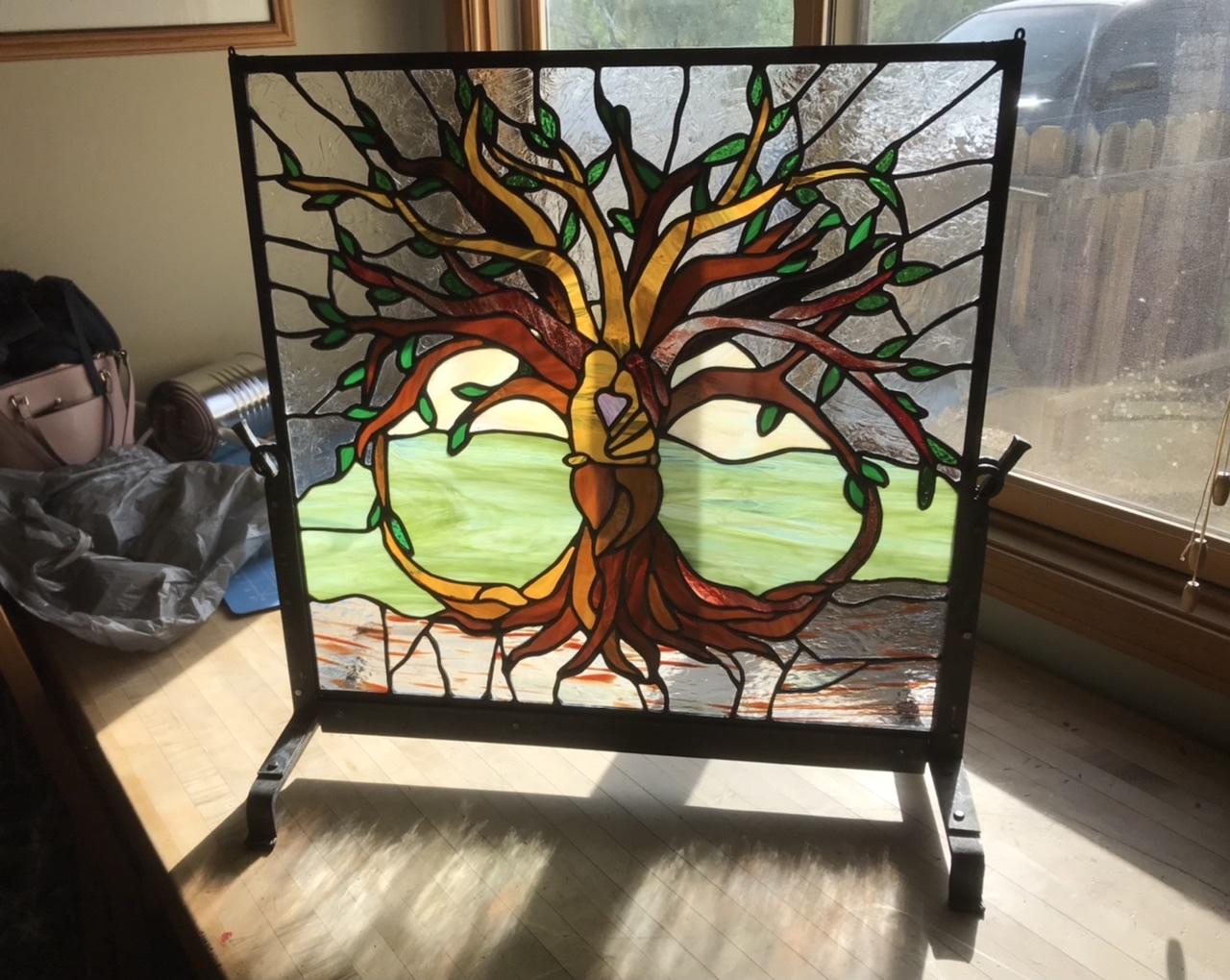

Rojo Pedro Posted May 1, 2022 Share Posted May 1, 2022 My wife is a stained glass artist and made a gift for my nieces upcoming wedding so I took these… and a made a stand. I like nothing about it other than it works as intended (which I am real happy with) It was harder than I thought it would be. The stained glass is super special and a true work of art Quote Link to comment Share on other sites More sharing options...
Scott NC Posted May 1, 2022 Share Posted May 1, 2022 Fantastic, Rojo. I'm sure your niece will be very happy with it. You are both very talented. Quote Link to comment Share on other sites More sharing options...
TWISTEDWILLOW Posted May 1, 2022 Share Posted May 1, 2022 Beautiful work! Quote Link to comment Share on other sites More sharing options...
Daswulf Posted May 1, 2022 Share Posted May 1, 2022 Wow, very thoughtful and beautiful piece. Quote Link to comment Share on other sites More sharing options...
Dax Hewitt Posted May 1, 2022 Share Posted May 1, 2022 That is excellent, a real marriage between 2 top class skills. Quote Link to comment Share on other sites More sharing options...
Frosty Posted May 1, 2022 Share Posted May 1, 2022 That's beautiful Pedro, as clean a blend of media as it gets. If you'd put twists and scrolls in your part it would've competed with the glass work and diminished both. Well done, VERY! My gob is smacked! Frosty The Lucky. Quote Link to comment Share on other sites More sharing options...

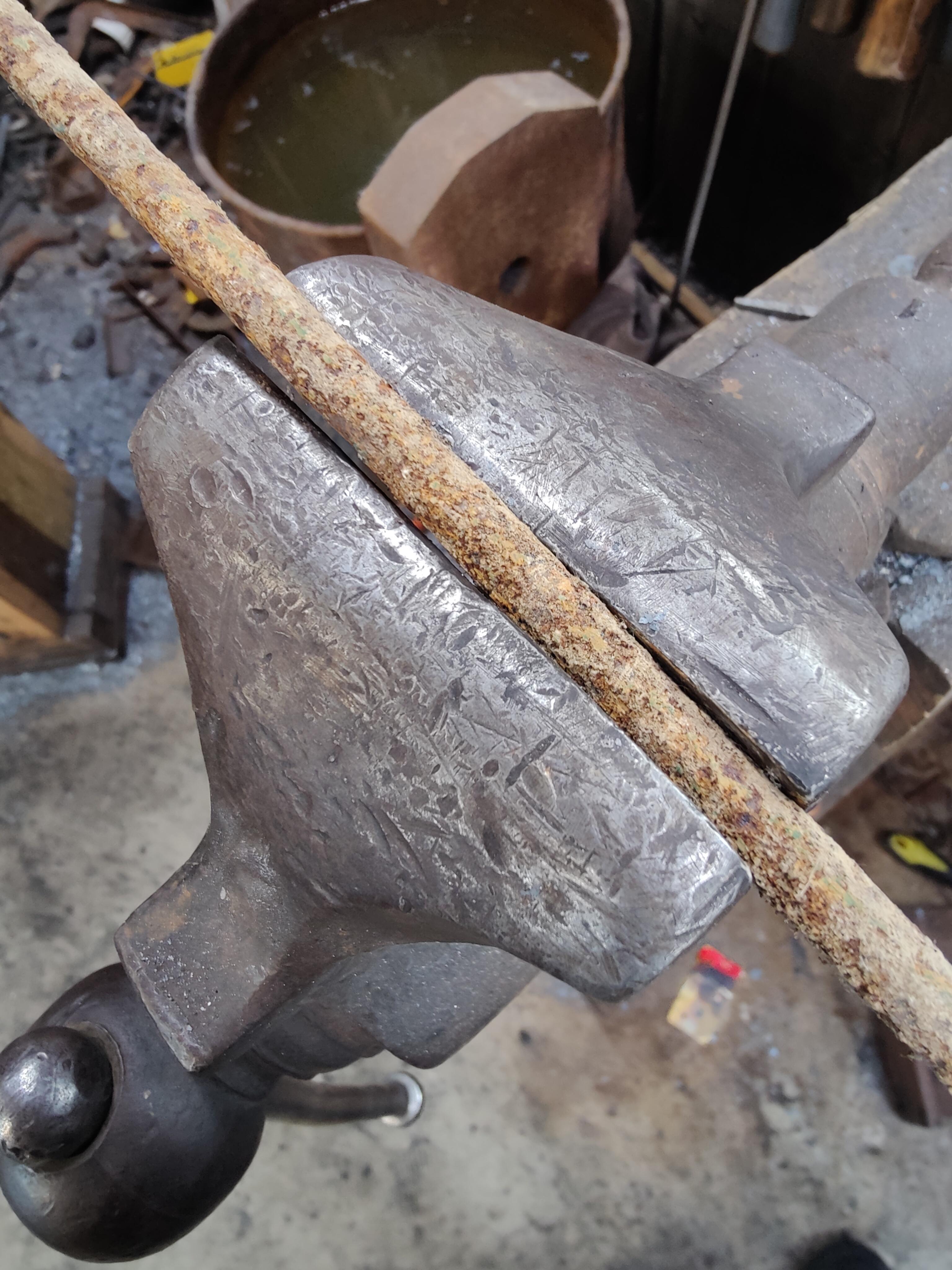

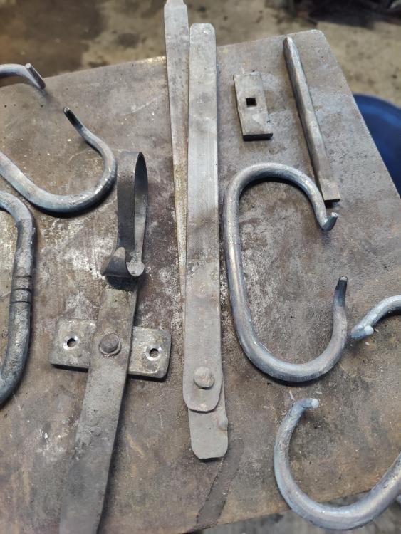

BillyBones Posted May 1, 2022 Share Posted May 1, 2022 I have a bunch of 3/8" in 20' lengths that i found in my barn when we bought the house. The problem with it is that it is all galvanized. So i spent a good portion of yesterday cutting these down into 20" sections, that was the biggest thing i could find to soak them in. Put them in my tub with a gallon of vinegar and went on to do something else only to discover a few minutes later that my tub has a hole in the bottom. No problem lifted the side with the hole and used the good corner of the tub. Sometimes "in rust we trust" is not always true, this is galvanized. So i made a few more bales for chest handles, a cabinet latch to go between 2 doors and hold shut, a hinge thingy to hold the top of a chest from falling all the way back, and a small slot punch for trying a new way to mount the bales to the back plates of the chest handles. Quote Link to comment Share on other sites More sharing options...

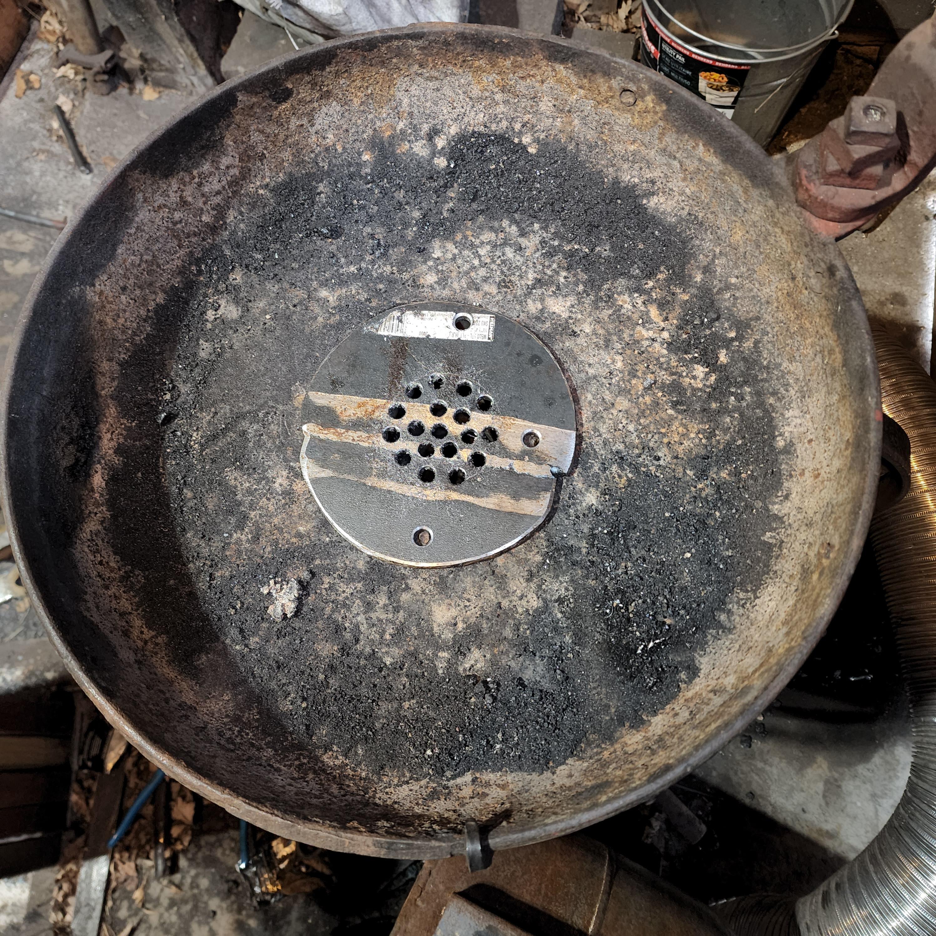

Chad J. Posted May 1, 2022 Share Posted May 1, 2022 Made a new tyre for my coal forge. The last one was cast and was falling apart. Not perfectly spaced but that'll be my next one. Also finished up the last 6 bearing bars for work. Quote Link to comment Share on other sites More sharing options...

George N. M. Posted May 1, 2022 Share Posted May 1, 2022 Chad, I'm going to jump in before Frosty makes a joke or comment about burning rubber tires as a forge fuel. The thing that introduces air into a forge or furnace is a "tuyere" (pronounced "tweer" AFAIK). A "tyre" is the British spelling of what is a "tire" for Americans. Tuyere is one of those odd French words that came into English in the late Middle Ages. BTW, your new tuyere looks almost exactly like the one I made recently for my small coal forge. The old one lasted 20 or so years. "By hammer and hand all arts do stand." Quote Link to comment Share on other sites More sharing options...

Frosty Posted May 1, 2022 Share Posted May 1, 2022 I was wondering why you were showing us the top of your forge, I was expecting to see a new wheel/tire under it. Then I was going to say he was showing a new air grate, not tuyere. I believe the tuyere is below the air grate including the ash dump and air supply on a bottom blast forge. Isn't it? I read a long time ago that tuyere is from really old (middle?)French, meaning "To Air" maybe originally pronounced To Air and later Anglicized to tweer. I no longer have access to the material so I'm relying on my dented memory so that's a maybe. Sounds good though doesn't it? Frosty The Lucky. Quote Link to comment Share on other sites More sharing options...

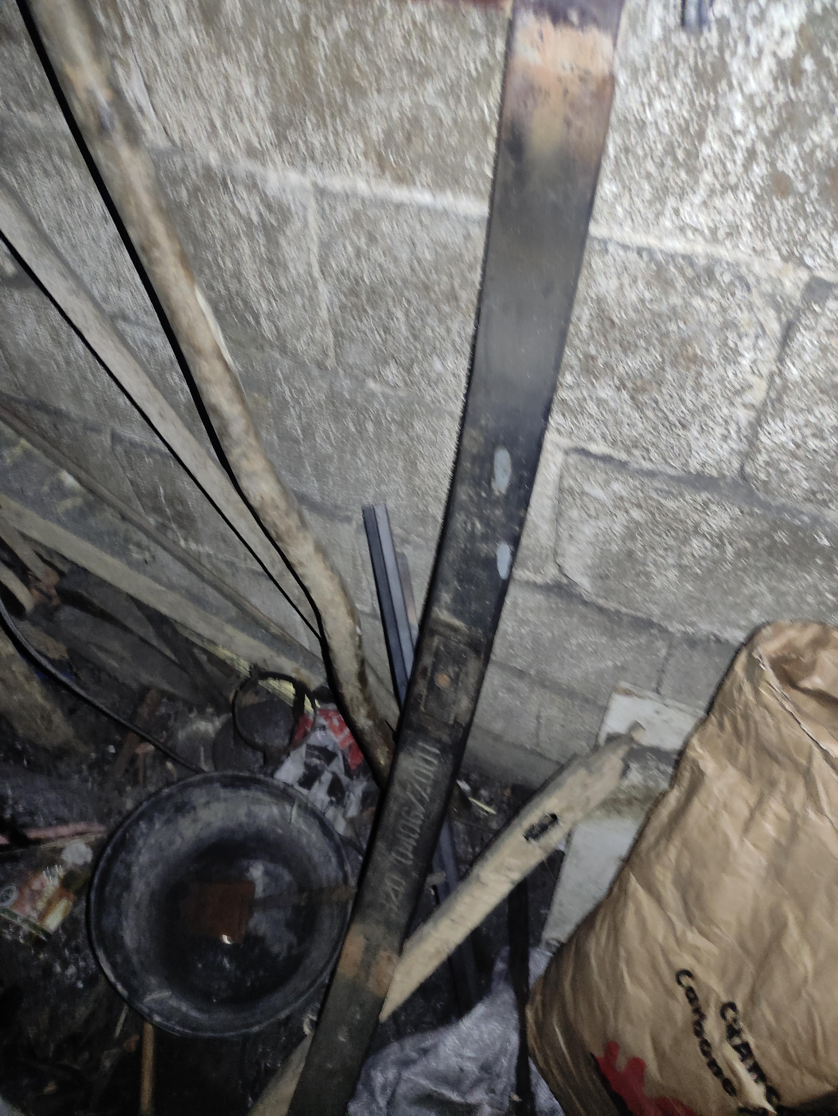

natkova Posted May 1, 2022 Share Posted May 1, 2022 Some use from leaf spring. I fixed axe today welded leaf spring to eye. Axe was like garbage now I think it can be useful tool. And days before made chisel. Have plenty of leaf spring for new projects. Quote Link to comment Share on other sites More sharing options...

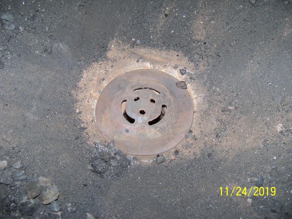

Irondragon Forge ClayWorks Posted May 1, 2022 Share Posted May 1, 2022 3 hours ago, Chad J. said: my next one Just a suggestion here. My first fire grate was like yours and I found the holes plug up with clinker rather quickly. I suggest making the air holes into slots like this commercial grate. Quote Link to comment Share on other sites More sharing options...
