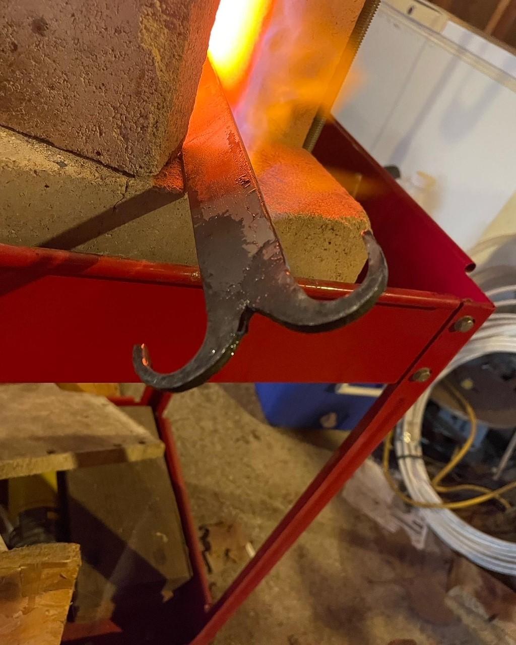

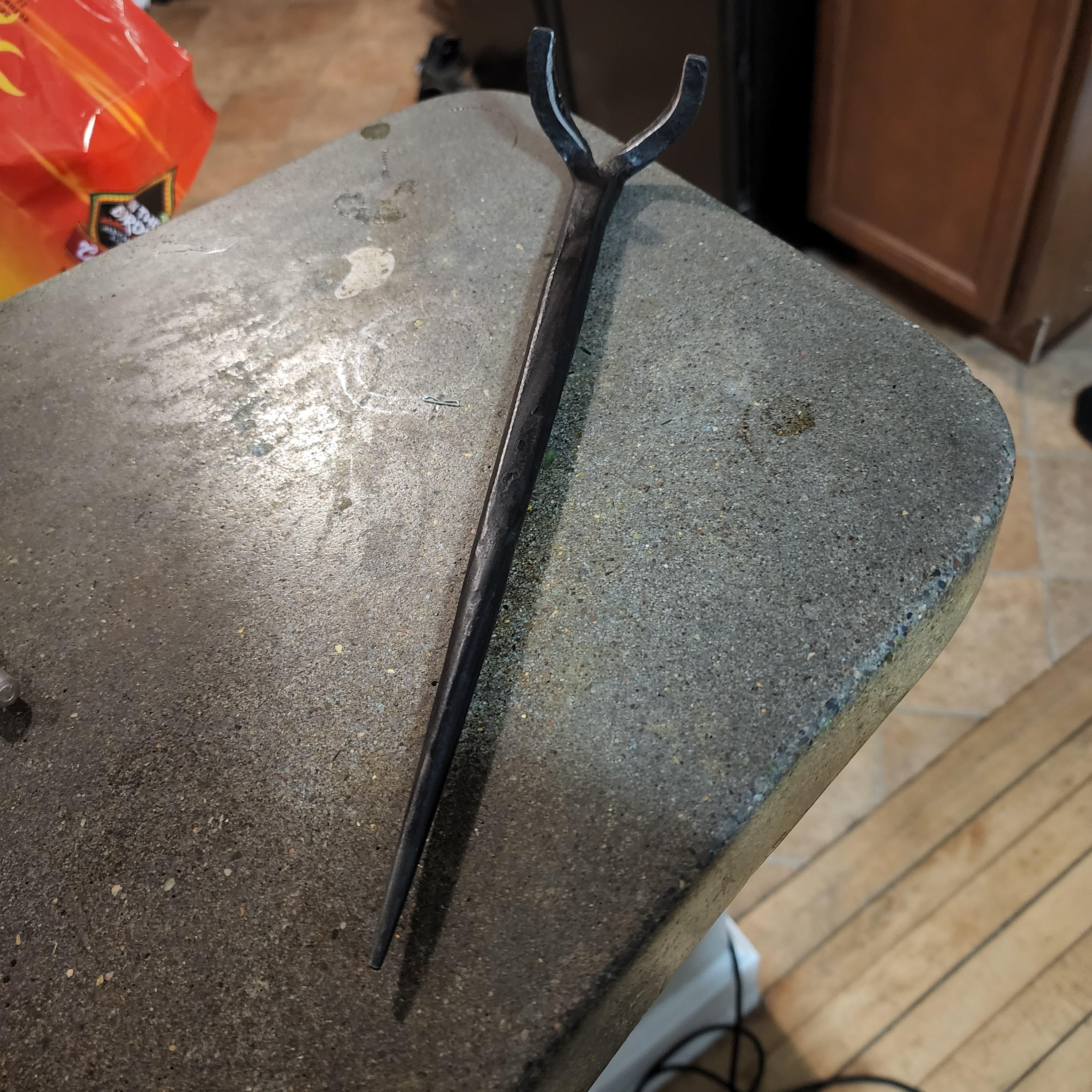

Got my first forge time in today.   Basic drawing out, a bend and a loop.   My stock was to short but I made the best of it as I'm just learning.   A basic fire poker for the fire pit out back.  Have to figure out what was up with my forge tomorrow.  One burner started whistling and the forge wasn't getting hot enough so I shut it down and took that burner out, back in business.
I know it basic and rough but I've been waiting a long time to do this.  Was worth the wait.

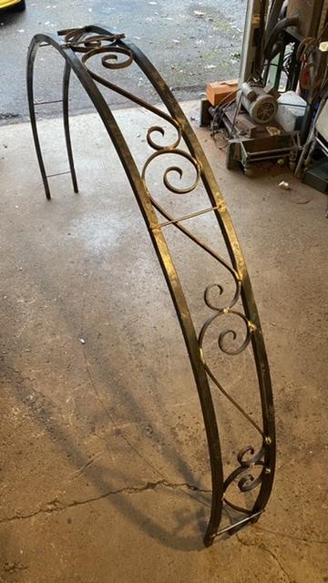

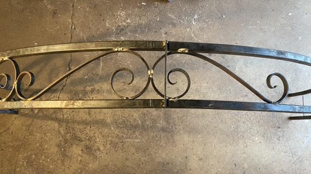

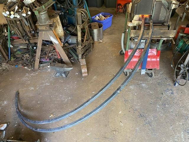

Got some work done on a long-delayed commission:
This will be fitted with legs to bring the total height to about seven feet. The 1/4” round bars are just spacers and will be removed later.

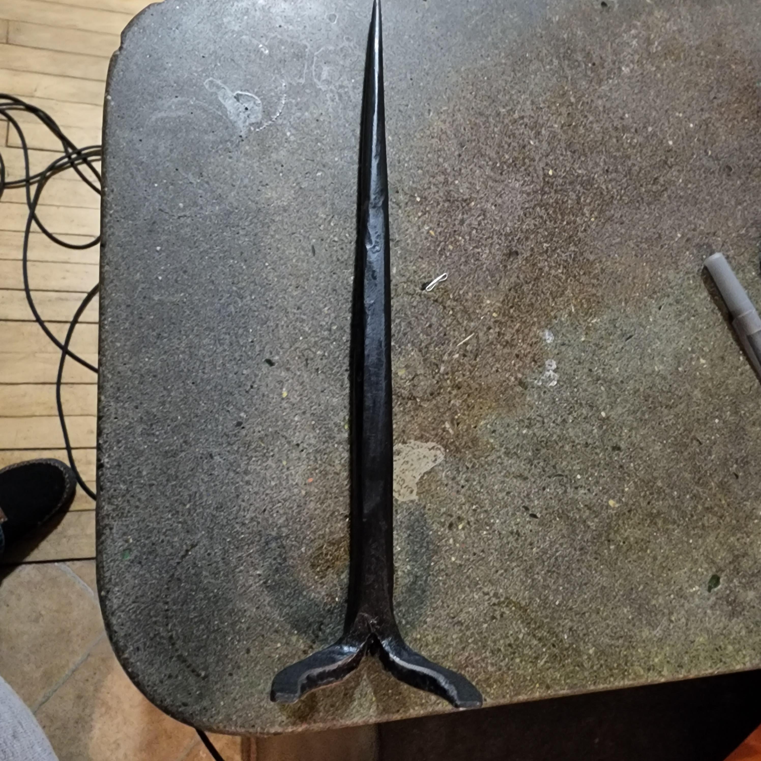

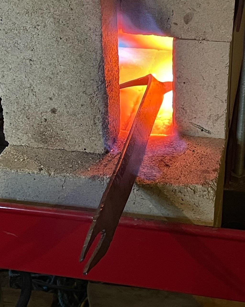

So last year I came up with a pry bar for work that I specifically designed to make it easier to get 2 bolt bearings moved away from my equipment so we could get a puller on them.   We have a problem with low quality castings breaking.   I made my original bars from rail spikes.  The guys loved them and they are getting a bit beaten up.  20210301_182834.thumb.jpg.e58278f36b7d68e439ac3c1e1143e23e.jpg
Well, I got the company to order some 5/8 inch 4140 for me and tonight I remade the first of 9.  I think there's a slight difference in wokmanship.16509392189043820209585801905065.thumb.jpg.3dc0129a99fb07fd2653504244e2ca9f.jpg

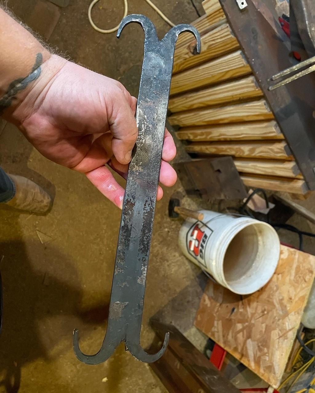

I found that I could beat out one of the larger hooks in just under 6 minutes
impressive.
It takes me two heats to make a decent hook with hot punches for the holes.
Can be done in one, but it is so much nicer to work with soft metal at heat.  And when you're doing a lot of them, I set up one side of the forge with the first heats, the opposite side is the second.  No down time and no fishing around.

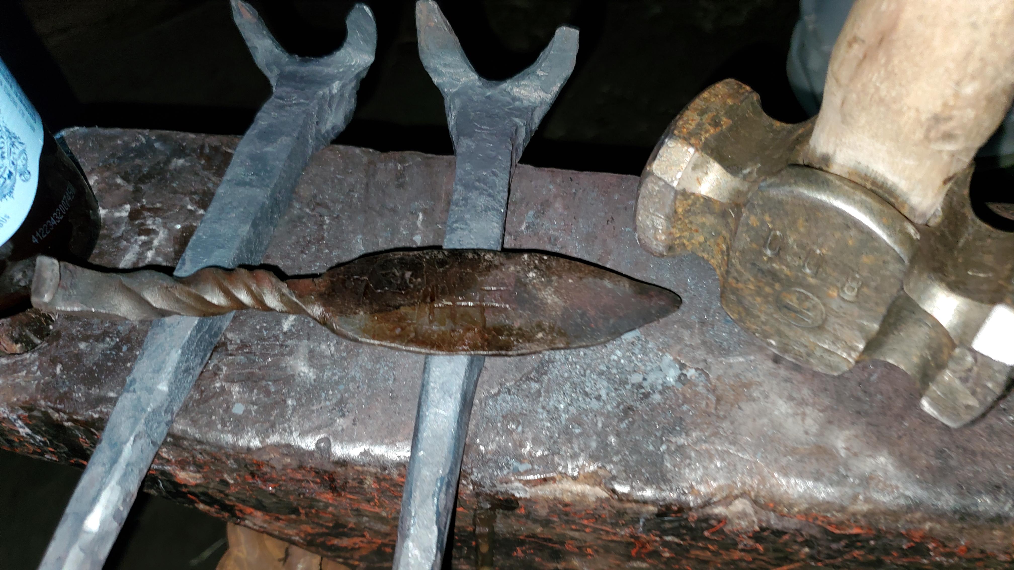

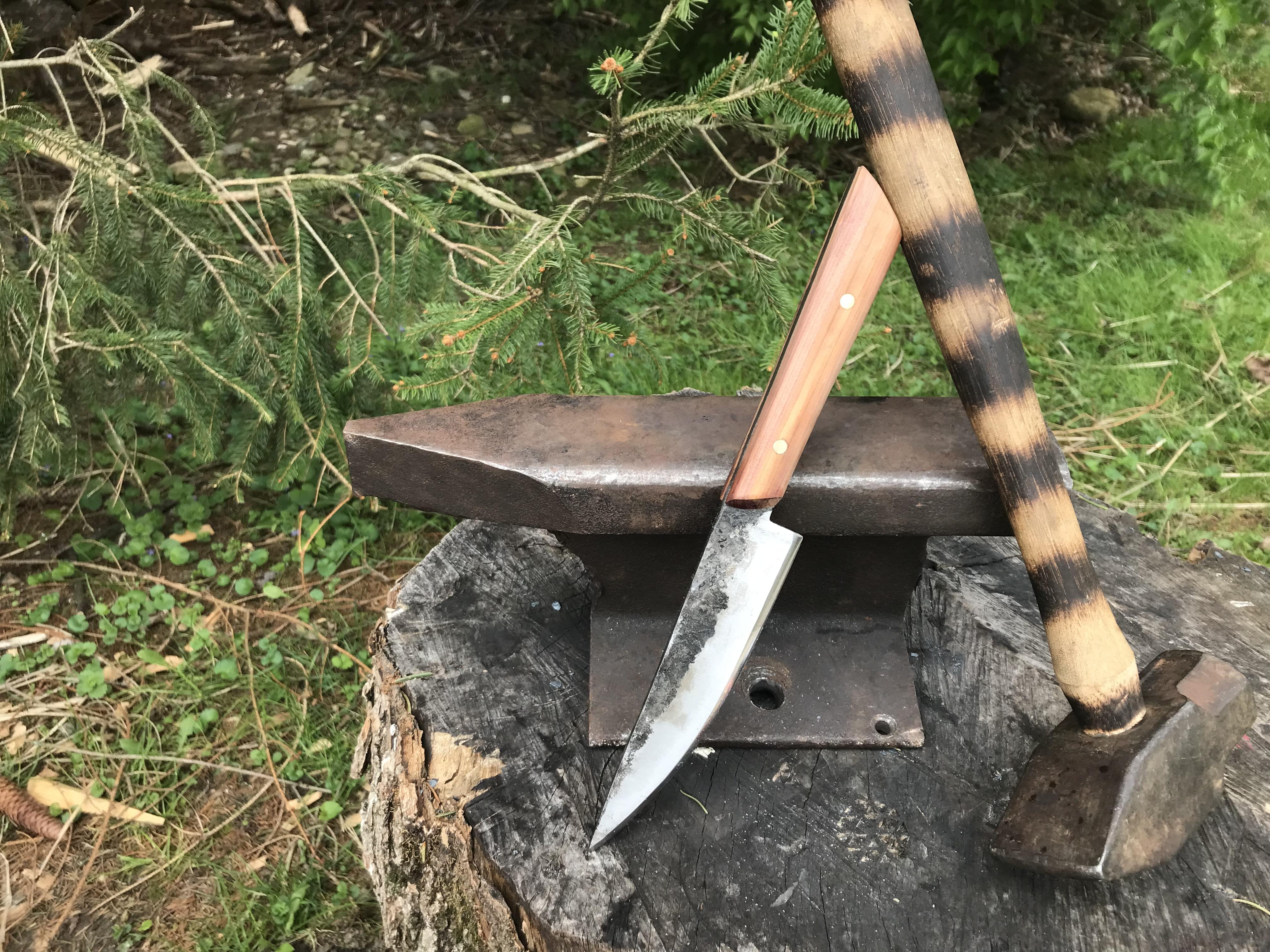

no forging, but did some grinding. Finished up my most recent knife with a cypress (or cedar. Can’t remember) handle. Unfortunately, one scale cracked but the other side is good. 01E29A5E-2CA6-4072-BD4A-0ACC6B887A4D.thumb.jpeg.946639a30df73d34e27850aae2a2101c.jpegalso remade my touch mark. Same fractal triangle design, just cleaner execution. Old on left, new on right. Do you guys harden your touch marks?E518FDA5-43D4-4419-9BF4-F31009BA1008.thumb.jpeg.9a19e201bf94a257ad24e04db1b00bbf.jpeg

Chimera, I don't harden my touchmark punch or any other hot tool because the heat of the workpiece will immediately draw the temper.  Just rely on the inherent toughness of the steel.  Hardening and tempering are for tools such as knives and chisels that will be used on colder materials.

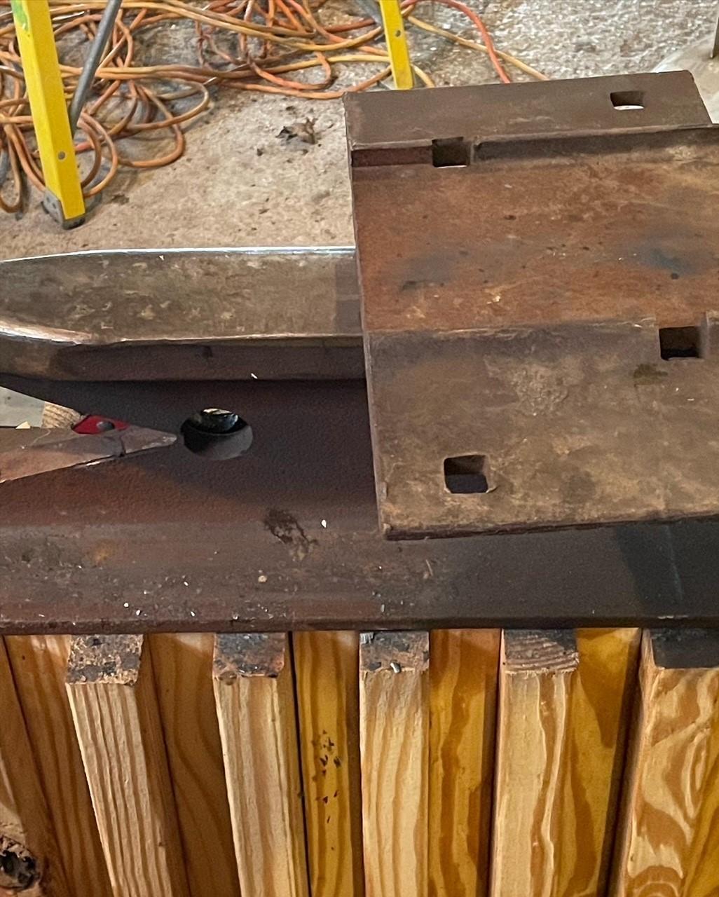

New to the forums. I'm a very beginner in blacksmithing. Last night I started a backplate for some hooks I intend to mount. First time chiseling a slit in steel and then attempt at a ram's horn scroll. (I think my scrolls should have "scrolled" more - ha). However, I am pleased with the piece so far. Now to make a few hooks and my plan is to rivet them to the plate. I'm open to any criticism or thoughts. Thanks!
You can see my "anvil" is a piece of rail. I use a plate for cutting my steel on - that way I don't damage the anvil any more than it is. I have a simple one burner homemade forge. Been working on technique and smaller projects.
George, I guess hardening and tempering your touchmark depends on the details that are there. Since Chimera's doesn't have too fine of details (that's not a critique, sometimes simple is good) I expect it would be just fine. The way I see it it doesn't hurt to harden and temper to brownish-purple.
I stamp either a Z or my initials with little 3mm letters with a bit of a script font.  I've used the B F and Z on hot steel most often by far. All of them will still stamp cold steel, which is their intended purpose. The key is to get in, get out, and cool. Don't let the punch sit there. (I know you know that, I'm just rambling...)
I'll probably make my own touchmark someday, but I haven't come up with anything that I like yet. When I do I'll probably make it out of S7 or H13.
George, that was kinda what I expected. But would it still be worth it to harden just so it lasts a little longer?

Frazer, I don't disagree with your advice to quickly stamp hot work and immediately cool the stamp but I think much of the hardness of your letter stamps is due to the alloy of which they are made than any hardening and tempering.  In fact, I would bet that heat treating is not a step in the manufacturing process except possibly to normalize the stamps.  Some steels can remain pretty hard wthout heat treating, very tough to forge but gves a long lasting tool.
Frankly, a lot of letter and touchmark stamps really don't get used that much and won't degrade many details over time.  I will bet that Templehound's bird does not get used very often since he must spend a lot of time on each of his wonderful blades.
Erosion and wear is a valid consideration in choosing a touchmark.  A simple one like Cimaera's is easily touched up or replaced while one which involves lots of detail work, not so much.

John, look forward to seeing it completed. What did you use to curve the main bars?
I made a jig to bend about 8” of bar at a time. Final adjustments were made by spot heating with the oxypropane torch and tweaking the curve to match a line drawn on the floor with an improvised beam compass.
