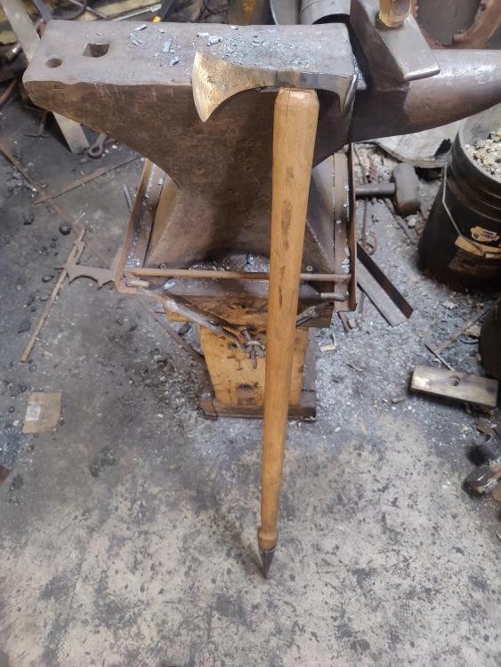

Finished a shepherds axe. Used a RR spike for the head, a sledge hammer handle for the stick and a cone for the steel but end. The cone is brazed together,  my first successful forge braze. While putting in my wedge something told  me to stop but of course i had to drive it in a bit further. You can see the results of a to long wedge after i tried it out whacking a log a few times. Bit into the log quite nicely. Eh, it is a show piece any way so i think i will just try some glue and a clamp to hide the crack and hang it on the wall.
Edit: I should have said the steel wedge, the wooden wedge went in fine.
