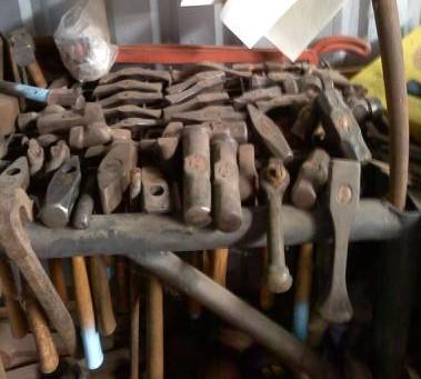

I need to make a hammer rack like that. Atleast for all my less used hammers that migrate around on benches and in boxes.
Nice work FB. No more feeding bears to that dog. Lol
John; that is a "Crescendo of hammers"; I note a boilermakers hammer and an old fender hammer in the rack.
I have mine horizontally in two rows on a sturdy steel frame I picked up as scrap and mounted plain old black pipe in parallel rows on it, no heat/welding involved. (My earlier one was an aquarium stand---made to hold a lot of weight and fairly commonly discarded in the city I lived in.)  When I moved to NM I had 100 "handled tools"  I had to reset the handles on ALL of them moving from central Ohio Moistness to the desert.  Now I have more; lots more even having traded a 5 gallon bucket of ballpeens to another smith who was making hawks from them...just in the last two visits to the scrapyard I picked up the true temper sledge head and the Woodings Verona 2.5#  crosspeen. The armor tools rack has some 1.5" sq heavy "hardware cloth" from a shale shaker on it with the tools dropped in the holes.
Looks like I have way too many; but please remember I have 8 Grandkids that I expect will need kitting out someday---I hope!  (I also teach and it's nice when new smiths don't have to share hammers...)
One of my great favorites. In the absence of a power hammer, it's tremendously useful for rapid drawing out or spreading of stock, rather like an oversized rounding hammer.
I had one when I first started out back in the eighties, lost it in my parents' divorce and the breakup of our household, and recently found this one in a bin of tools I bought from the industrial surplus place. With a new handle, it's good to go and already proving its worth.

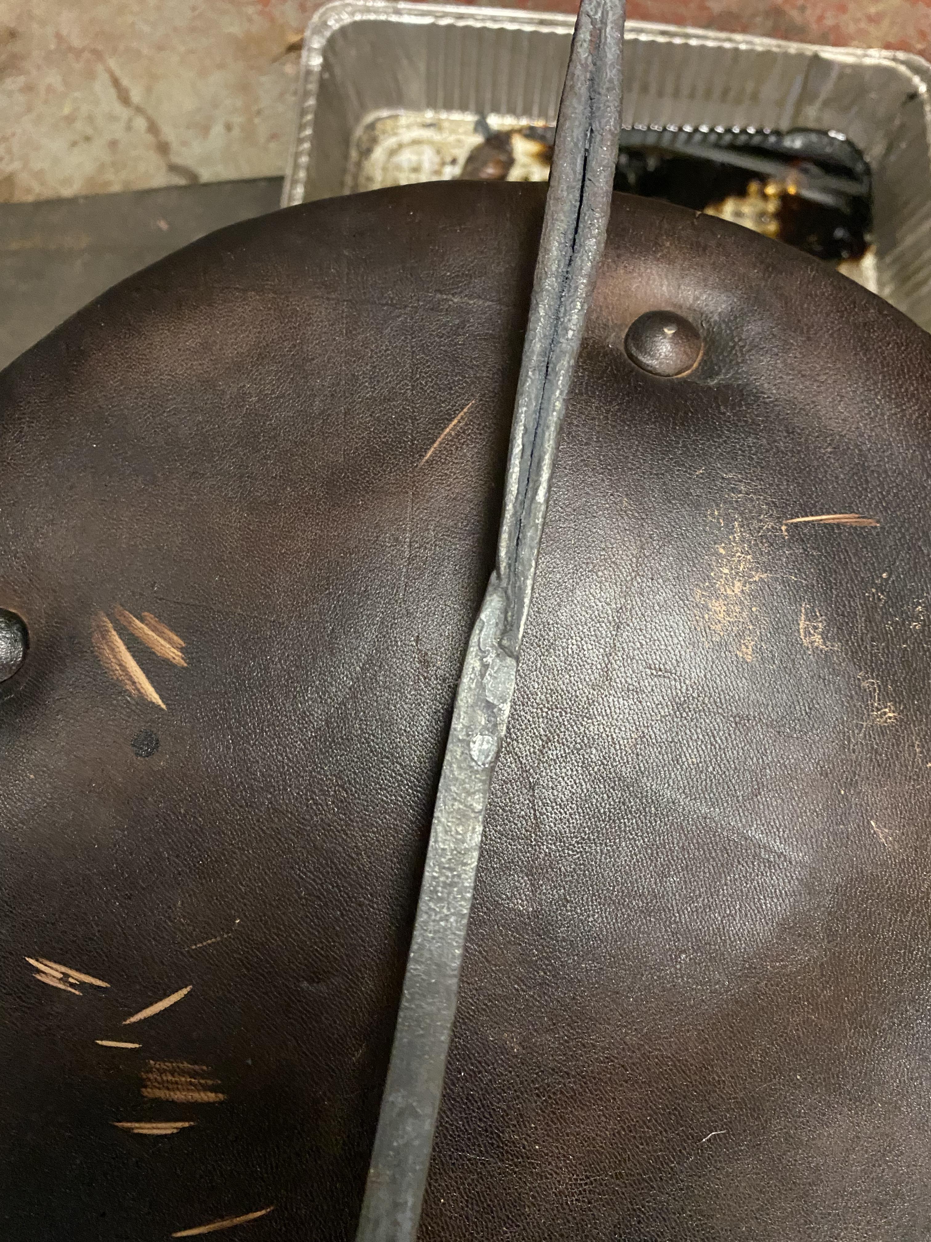

Ok guys normally I go through and read a few pages and ask questions about peoples work and compliment your stuff but please excuse for me for not doing that - I’ve had a terribly stressful last five days. So I finally got my Etsy shop going. My family crest has a knights helmet so the logo is a cool knight helmet with the M I’ve been using as a touchmark already included. It’s really cool - at least I think so. The name is MidKnightForge on Etsy in case any one wants to check it out. Anyway 2/9 was my bday and I hate bdays for personal reasons I won’t go into but I’m driving home and I get an alert that I made my first sale. What are the chances and it was like only a month after I started the shop and on that day - finally a bday I enjoyed a little. So the item bought was the basket twist fire poker. Now I wouldn’t say when I made it for my stepdad as a Christmas gift it was easy but it went pretty smooth and I think I made a really nice piece. The picture of that one will be obvious. But now I am having so much trouble getting the basket twist forge welded to the shaft. Drop the tongs weld was just not working for me so I came up with what I thought was a great idea. The forge has two sides so I put the basket twist part in from one side and the shaft in from the and when they were both up to heat I stuck them together, pulled them out for a couple lite taps to set the weld - normal forge welding procedures from there. Worked great. But by the time I had figured that out where the basket twist and shaft meet was just too thin. That’s the pics with the red x’s. So then I said ok no problem - tack welded up another set of small bars for the basket twist and tried the same thing - would not stick no matter what I did. So then I cheated and tack welded the basket bundle to the shaft and then forge welded and got most of the way there. But now again I have a section towards the meeting point that is just a tad too thin and I’m looking for a way to save it. I’d like to just weld in there and build up weld then blend with a grinder but I’m not good enough at welding to do that. I’m also thinking maybe take a piece of thinner bar and tack weld it into the thin spot that has the gap. You’ll see what I mean in the pic with the yellow circle. No red xs or yellow circles is the other side of the one with the yellow circle which I can shape to look ok with a little work. Please give me some advice here. I really really don’t want to have to refund my first customer for not being able to complete his item. Thanks.

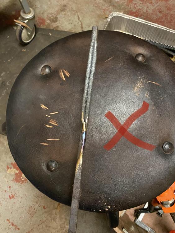

Being a professional means being able to toss it aside and doing another one *right*. Figure out how to save that one later.  Do what you contracted to do.  If you are not able to repeat items at will, don't advertise those items on spec, only sell what you have to hand.
I agree with that.
Pat, don't forget you have to upset the end of the shaft before you try to join the two parts.
What Thomas and Frazer said. Also, for small items like this, it might be worthwhile to make a whole bunch, both to build up your stock and to improve your skill.

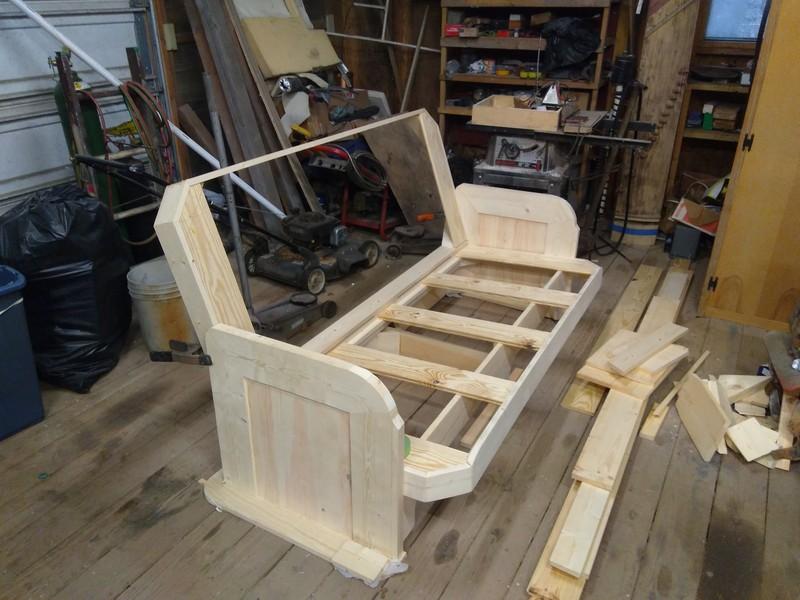

I've done nothing at the forge, but I see ya'll have been busy making nice things. Blades, pokers, hammer racks, etc.   I've been busy in the shop though.  Boss Lady wants to replace the futon in the TV room with a couch. And she expects me to build one.  So I got started on the project this weekend.  Spent all weekend working on this mess, and finally have something to show for it.  Still a long way from being done, but the progress so far.
That looks great Bluerooster

Yeah - agreed guys. Will start over.
also learned a few things yesterday. 1. Was using way too much flux. 2. Only needed any flux at all about half of the times I used it. 3. I made swages a while back that were two square bars - a v swage I guess you’d call it. Made two different sizes - one with 3/8 and one with 1/2” and although I did pull off quite a few forge welds using them to make little basket twist Christmas ornaments they were definitely hindering me. Found it much easier to just square off the end and weld each side little by little on the flat of of the anvil. I imagine a round swage would work better.
I did upset the end before trying to weld and I know I also don’t yet know how to make scarfs that compliment each other when trying to weld. I just don’t understand why getting them to stick inside the forge worked so well the first and then just not at all the second time. Had I tried that earlier with the first attempt I would’ve been good. Probably going to take off work tomorrow to try to get this done. I’ve been totally upfront with the customer and he seems very understanding and said he’d be patient but I really don’t want my first sale to be late. Tonight I got myself set up to start up over early in the morning so hopefully things will go my way.
And just realized it’s supposed to rain tomorrow. It just keeps getting better.
All the best on it Pat. Go slow and methodical on it and don't stress. The weld fairies know when you stress and rush it and give you bad vibes. Go easy and with confidence. like dealing with a larger possibly dangerous animal. Lol you just have to clear your mind and get into it....
You got this! :)
