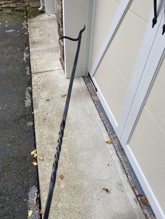

I’ve got a question - does anyone know how much twisting square bar will shorten it? I mean, it does shorten it right lol? But the twist in the middle of this fire poker for example? Any educated guesses on how much it shortened? Overall length of the whole poker is about 34”. Thanks in advance for any answers.
Pat, that has been discussed before. There is a formula that will figure the answer but a lot of variables to plug in. If i recall the answer came out to "not enough to worry about."
Ok. Thanks Billy. That’s kind of what I was hoping considering I gave an approximate length in the add for the this product anyway but figured it was at least worth asking.

Ok guys wish me luck. Poker has to ship today or it will be considered late. I’ve got the four piece basket bundle finally welded to the shaft. There is a spot that’s thinner than I wouldve liked but it is ok. Going to follow John Switzers steps from Black Bear Forge on you tube for the rest.
Draw out the other end of the bundle to a taper so it ready to be made into the hook      .then do the twist with the twisting wrench on that taper for the hook
make the hook
selectively cool the hook and do the untwist from that end
Get all of that mostly in line and cooled then pray to god I cut it to the correct size so that when I do the forge weld for the poking end I end up with the around the right length
then put the twist in the middle with John didn’t do but that’s fine I really like that part and it’s relatively low risk
How much twisting square bar will shorten it would depend on the size of the square bar and the amount and type of twisting you are applying to the bar.
A coil formed by winding wire around a uniform tube to form a helix would certainly be different from say a pineapple twist or a just a plain twist.
Yeah I though I stated the dimensions before but I could definitely be wrong. It’s 3/8” with about a 6” twist
But the pitch of the twist, how many, over that 6 inches will also matter.
