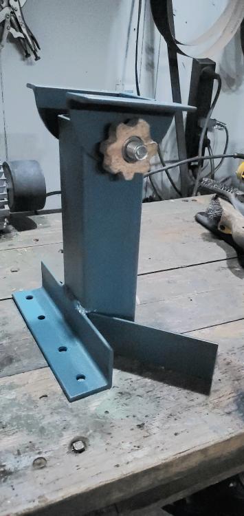

  3. Great point. There is a postive stop in the vertical postion already. It's just barely visible in the picture on the right side between the two pivoting mount brackets. I plan on building a horizontal stop on the new table that will support the middle of the frame.
  4. Yeah, at least $300 worth satisfaction. That's definitely the point of why I picked up blacksmithing, something interesting and creative to do. The part in question is a nut, set in a wooden, not brass star. I had it laying around from another project I started and nevr finished. The purpose is indeade so I can hand tighten the pivot. I think it needs to be a bit bigger, so I may redesign it or weld an arm onto the bolt head on the other side to make it a lever.
  5. As part of my shop reorganition, I need to move the old workbench in my woodshop that my grinders currently sit on out to the smithy. Before I build a new workbench for the 2x72, which is staying inside, I figured it was time to build a tilting stand so I can run it either vertical or horizontal. I could have bought one from the manufacturer for about $300, but I had some angle iron and square tubing hanging around and thought this was a great opportunity to work on my fabricating skills. My welding sure isn't anything to brag about and I really do need to spend more time designing things before I start building, instead of seeing something in my head and just charging ahead. All that said, it came out decent looking when painted and should be nice and functional. Now I need to get some mounting bolts and top material for the table.
