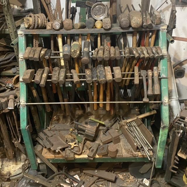

JHCC Posted February 20, 2022 Share Posted February 20, 2022 Nice work, everyone! I spent some time reconfiguring my hammer rack, both expanding its capacity and improving access to the tools. Still more to be done, but a good step forward Quote Link to comment Share on other sites More sharing options...

Dax Hewitt Posted February 20, 2022 Share Posted February 20, 2022 How do you manage with so few hammers? Quote Link to comment Share on other sites More sharing options...
TWISTEDWILLOW Posted February 20, 2022 Share Posted February 20, 2022 Mothman that broom is stellar!!! JHCC, I like your hammer rack, I need to build something similar for my smithy Quote Link to comment Share on other sites More sharing options...
Scott NC Posted February 20, 2022 Share Posted February 20, 2022 I love that broom too. Looks very high quality to me. Billy, maybe you could make a heavey duty hammer rack out of leftover sucker rod? Quote Link to comment Share on other sites More sharing options...
JHCC Posted February 20, 2022 Share Posted February 20, 2022 7 hours ago, Dax Hewitt said: How do you manage with so few hammers? That’s why I’m building a larger capacity rack: one’s hammer supply will expand to fill the space available. Quote Link to comment Share on other sites More sharing options...

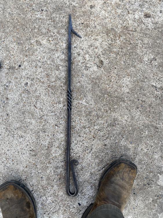

TWISTEDWILLOW Posted February 20, 2022 Share Posted February 20, 2022 Just finished up a poker, half inch square stock, forge welded end I wanted to try out this new mystery coal I drug home a few weeks ago forge welding and it did pretty good, It got it hot enough I shot molten metal and flux everywhere, burned my hand, shouted language the clergy don’t know and dropped the hammer in the middle of welding it…so I guess it will work out good! lol it is taking me some getting used to it doesn’t burn like my other stuff, produces ash and more clinker, and it’s not sticky when it starts to coke, it won’t make a volcano/cave, but it gets hot an will weld! Quote Link to comment Share on other sites More sharing options...
JHCC Posted February 20, 2022 Share Posted February 20, 2022 5 minutes ago, TWISTEDWILLOW said: shouted language the clergy don’t know Oh, they know it — they just don’t use it (or they don’t use it in public). 5 minutes ago, TWISTEDWILLOW said: dropped the hammer in the middle of welding It’s called a “drop the tongs” weld! Looks good. The challenge on a poker like this is not over-thinning the unwelded section just above the weld, and it looks like you did a decent job with that. Very nice twist, too Quote Link to comment Share on other sites More sharing options...
TWISTEDWILLOW Posted February 20, 2022 Share Posted February 20, 2022 Lol, but what if ya ain’t using tongs? Quote Link to comment Share on other sites More sharing options...

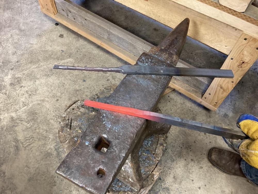

JHCC Posted February 20, 2022 Share Posted February 20, 2022 Fair point. My student Eva came over and finished the forging on her first knife. And I made a spatula from some 1/2” round stainless: Apart from a little touch-up of the edges, this is as-forged. Quote Link to comment Share on other sites More sharing options...
TWISTEDWILLOW Posted February 20, 2022 Share Posted February 20, 2022 You must be a pretty good teacher JHCC! That spatula looks pretty slick to me! Quote Link to comment Share on other sites More sharing options...
FatBadger Posted February 20, 2022 Share Posted February 20, 2022 Thank you all for the positive feedback. We got started fairly early for Sunday. Then we moved to some San Mia. But we used a cutoff from a box of junk from (Vegas Forge) 5 lb. box for our core. We need to fold next weekend and stack with 15N20 in the middle for a little pop. (left the cutoff - right at San Mia 1095 mix) And tongs and fat shop dogs. Wow that's an Awesome spatula. Quote Link to comment Share on other sites More sharing options...
TWISTEDWILLOW Posted February 20, 2022 Share Posted February 20, 2022 Fat shop dog?!?! That looks like a killer ferocious bear hunting dog!!! Lol Knife looks good to me! Quote Link to comment Share on other sites More sharing options...
FatBadger Posted February 21, 2022 Share Posted February 21, 2022 Beware of the man with 47 hammers, cause he probably knows how to use them. Quote Link to comment Share on other sites More sharing options...
TWISTEDWILLOW Posted February 21, 2022 Share Posted February 21, 2022 Or in my case can’t turn down a bargain lol Quote Link to comment Share on other sites More sharing options...
JHCC Posted February 21, 2022 Share Posted February 21, 2022 Oh, also finished redoing the hammer rack: Quote Link to comment Share on other sites More sharing options...
