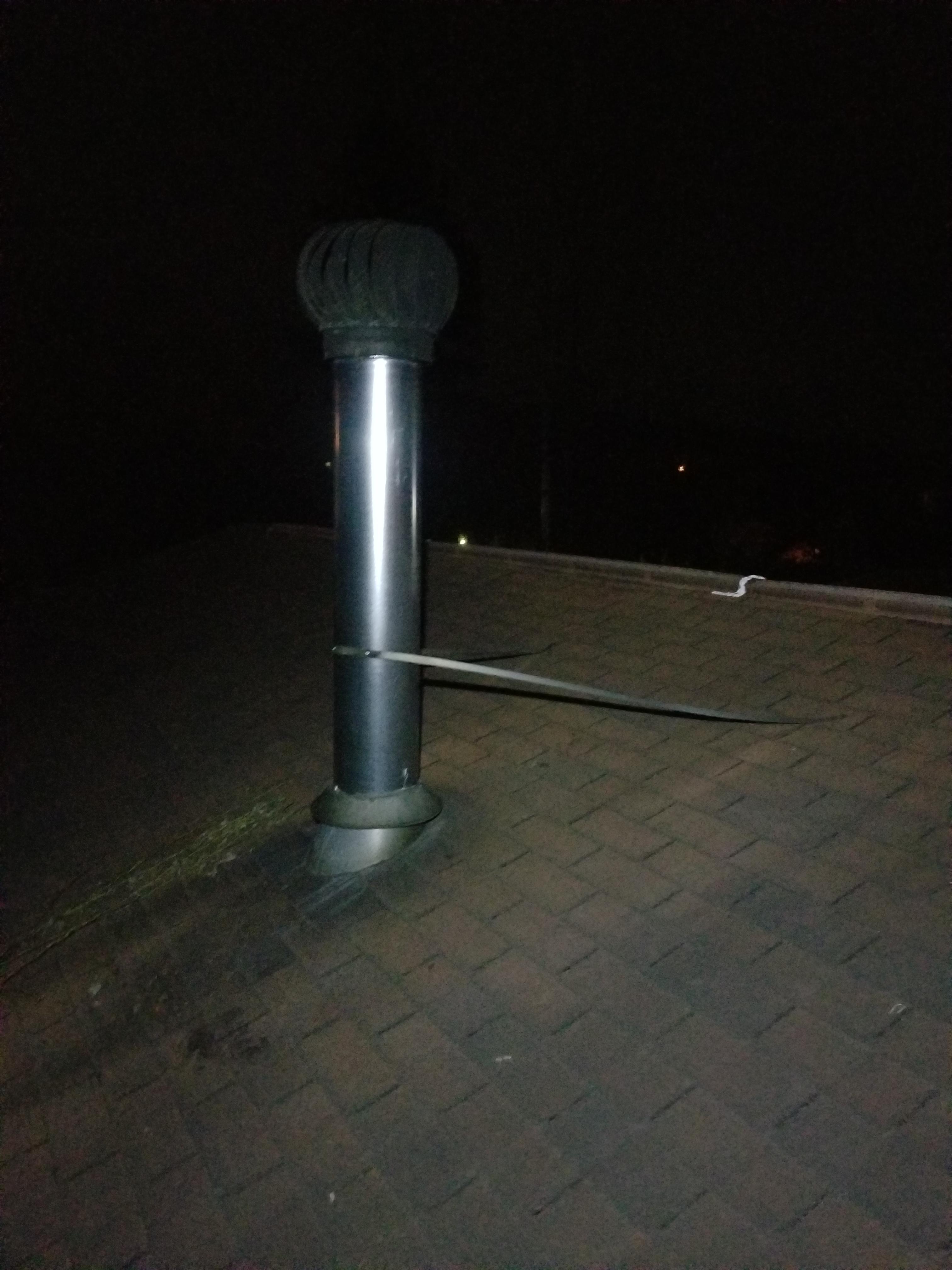

Daswulf Posted January 5, 2022 Share Posted January 5, 2022 Went to lowes today to get a new storm door closer shock. Thought while I was there I would look for a switch plate for a light switch as they were out of the matching one last time I looked. Low and behold they moved the duct pipe into that isle. And they had 10"x5' sections of round. So I went and grabbed a shopping cart and got the 3 sections that I thought I needed. I looked and they had a joining section, but I fugured mine was ok on the barrel so I passed on that. At home I clipped the two together and went up on the roof, pulled the old floppy one out not even paying attention and installed the two sections in. Turns out my joining piece on top of the barrel hood is a bit rotted. Good enough to function for a bit tho. Then i clipped together the third piece of 10" and took it up on the roof. I was trying to install it when it hit me that the stack was way taller than it needed to be. Guess at $19. each, I'll be returning one since I only had 10' of pipe before and that is sufficient. They were still out of the matching light switch plate. And new forge chimney stack is done. Quote Link to comment Share on other sites More sharing options...

Daswulf Posted January 5, 2022 Share Posted January 5, 2022 Glenn, you know when the lady of the house wants a certain thing, nothing else will do. I don't Need a switch plate, she Wants a matching Allen Roth satin nickel switch plate. Lol. I Could make something similar. We even Have other switch plates and are using an existing switch plate on that switch. It is just about them matching. And being the last one she wants and that we need in the whole house, Ill just find it for $6.98 or close to whatever it costs. On a side note I fired up the forge and the new stack draws great. Quote Link to comment Share on other sites More sharing options...

BillyBones Posted January 5, 2022 Share Posted January 5, 2022 Das, i do not know how long your chimney lasted but you may want to stash that extra pipe away somewhere for future use. She went with the satin nickel aye? Mine went with the antique bronze stuff. Quote Link to comment Share on other sites More sharing options...
Daswulf Posted January 5, 2022 Share Posted January 5, 2022 They have the style in antique bronze. Lol. My last stack lasted 7 years. This one may last a little longer. Hey, couldn't hurt really with inflation and all. But I Am going to be more on the lookout for something in stainless steel for when the next time comes. 7 years ain't half bad for some cheap box store tin. Quote Link to comment Share on other sites More sharing options...

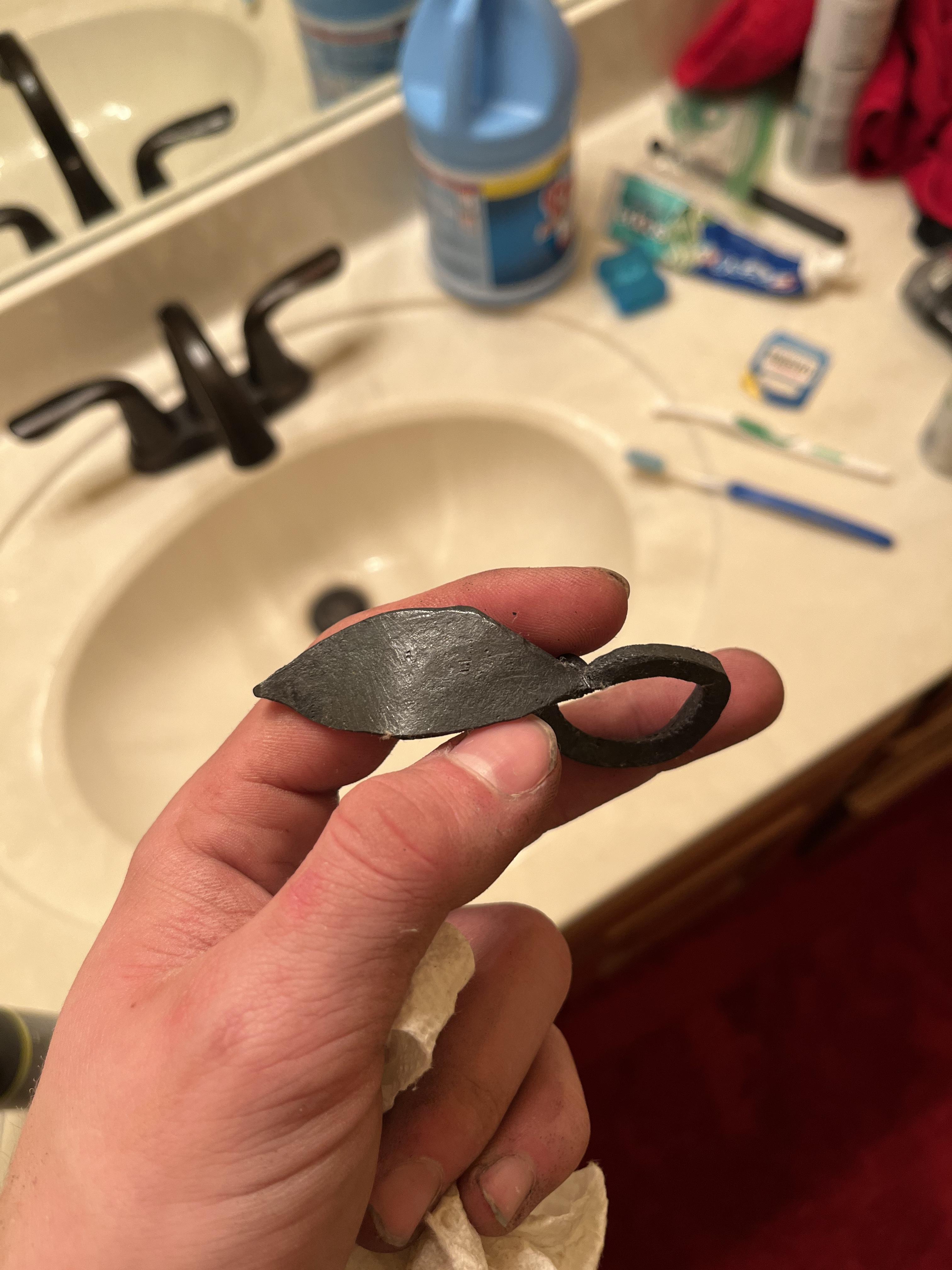

Nathan Kraft Posted January 5, 2022 Share Posted January 5, 2022 Just realized I forgot to post a picture of my key ring. Here it is! Quote Link to comment Share on other sites More sharing options...
Daswulf Posted January 5, 2022 Share Posted January 5, 2022 Hey Nathan, glad you are getting back at it. If you have some coil spring or something to make a veining chisel out of it will really make your leaves stand out. Quote Link to comment Share on other sites More sharing options...

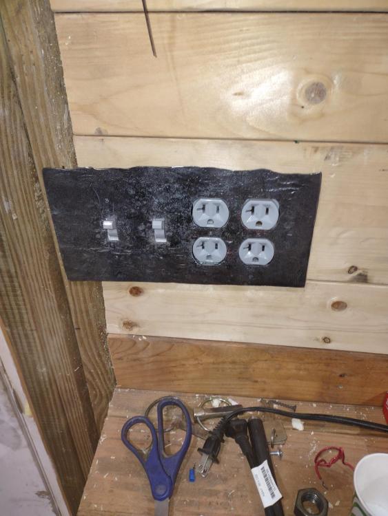

TBinKC Posted January 6, 2022 Share Posted January 6, 2022 Finished a wall plate . Couldn't find one in the store so it just made sense.. Hammers and chisels. Quote Link to comment Share on other sites More sharing options...
Daswulf Posted January 6, 2022 Share Posted January 6, 2022 Now TB, That is a great job! I've never seen a switch plate in that configuration. That is the perfect application of skill and design. Very aesthetically pleasing too. Well done. Quote Link to comment Share on other sites More sharing options...

TWISTEDWILLOW Posted January 7, 2022 Share Posted January 7, 2022 X2 on the plate! It looks pretty good to me! Quote Link to comment Share on other sites More sharing options...

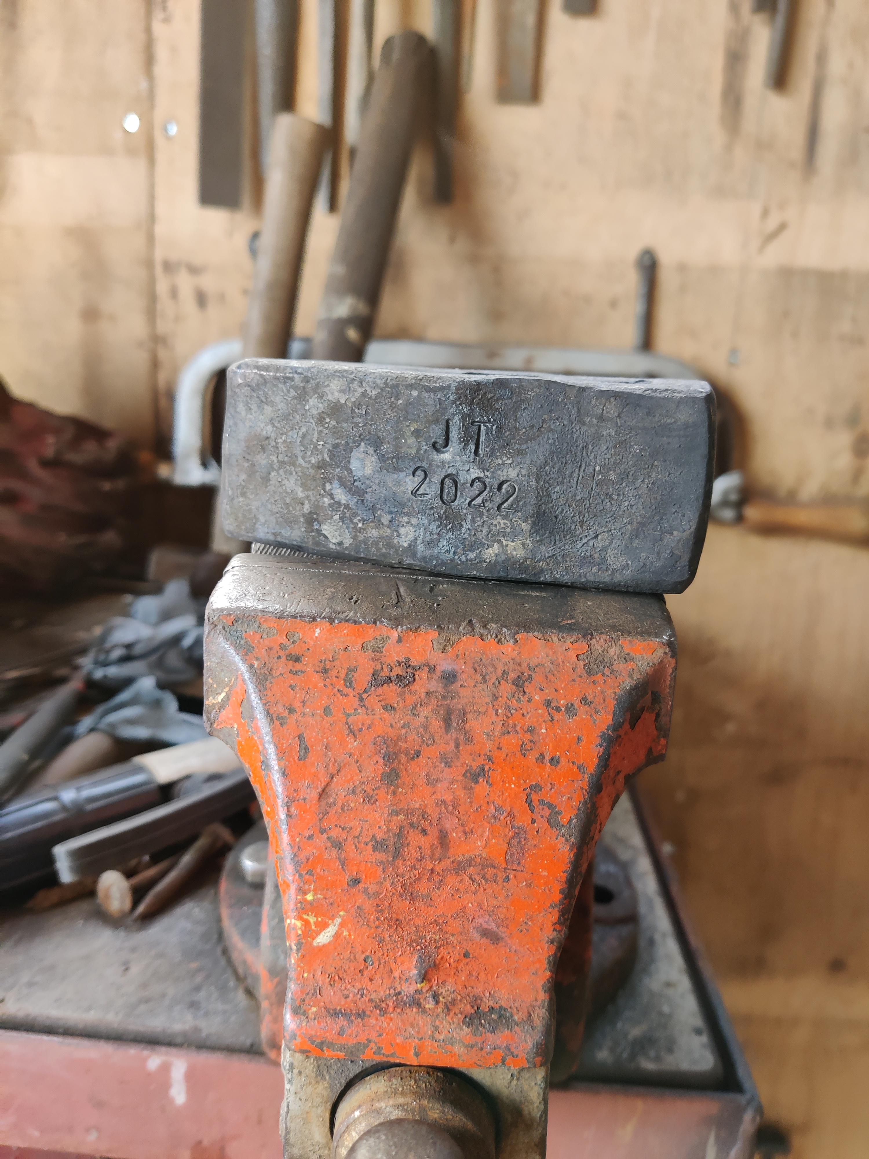

Jobtiel1 Posted January 7, 2022 Share Posted January 7, 2022 I finished the forging and hardening and tempering of my first hammer today! A 1kg straight peen. Mystery steel from a hammer blank from a thrift shop, it even had the eye punched and drifted already! Now to wire brush it and grind the face and peen a bit more. Then stick a handle on it! I've been busy with a whole lot of other things, including finishing the inside smithy, only the chimney hood left now! I also got a wood lathe and I've been practicing with that a bit. The chisels the guy gave with them are made of poor steel, so soon I'm going to have to forge my own ones. ~Jobtiel Quote Link to comment Share on other sites More sharing options...

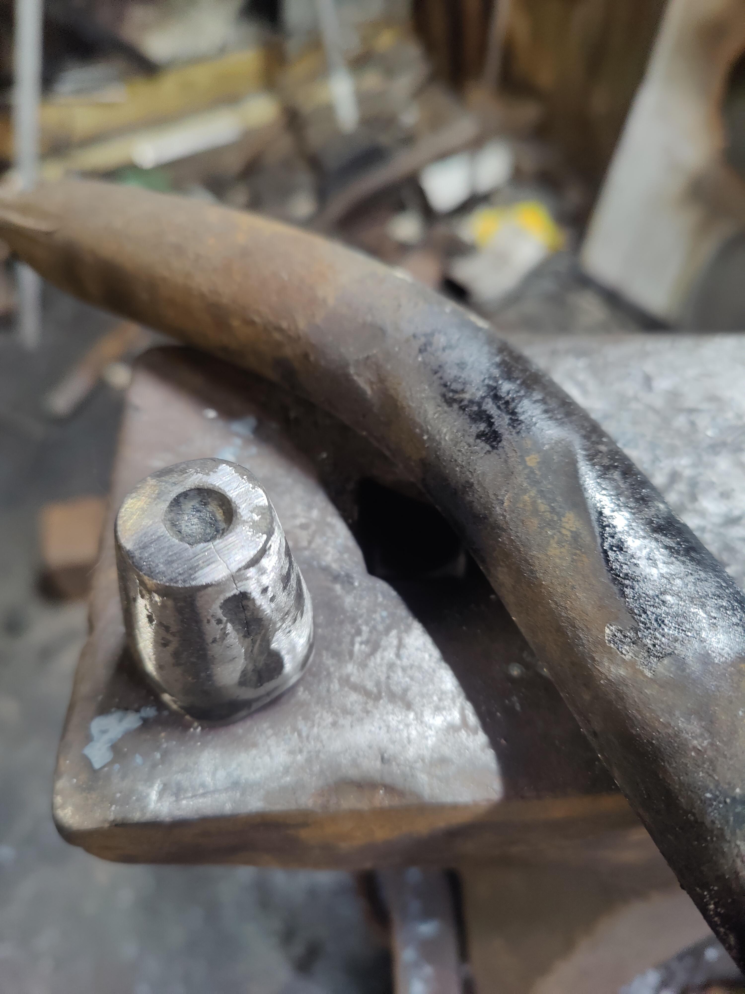

BillyBones Posted January 7, 2022 Share Posted January 7, 2022 After i finally got a drop tong weld and some belly fillin made me a rivet bottom tool. made from the piece of sway bar next to it. Was going good and then i noticed the crack... probably still work but after working down that much material kind of a bummer. Quote Link to comment Share on other sites More sharing options...
Daswulf Posted January 7, 2022 Share Posted January 7, 2022 Probably be fine Billy. Quote Link to comment Share on other sites More sharing options...
ThomasPowers Posted January 7, 2022 Share Posted January 7, 2022 Any contact chilling? Winter can be a hard time to keep HC stuff from accidentally getting quenched in various ways. Quote Link to comment Share on other sites More sharing options...

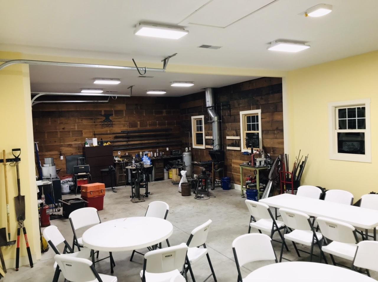

Goods Posted January 8, 2022 Share Posted January 8, 2022 Spent time setting up the shop for our hammer-in tomorrow. I think I’m ready?! Keep it fun, David Quote Link to comment Share on other sites More sharing options...
Daswulf Posted January 8, 2022 Share Posted January 8, 2022 Wow David, good job and what a great space. You are ready if you have fuel for the fire. The rest can be figured out on the fly. Quote Link to comment Share on other sites More sharing options...
