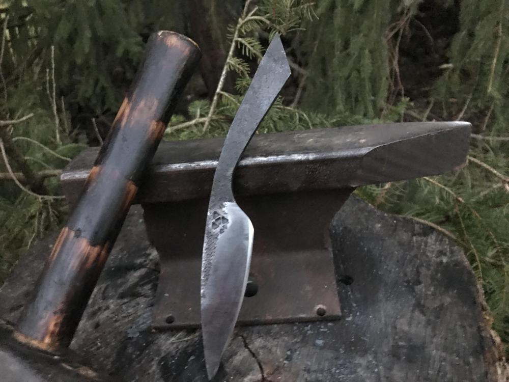

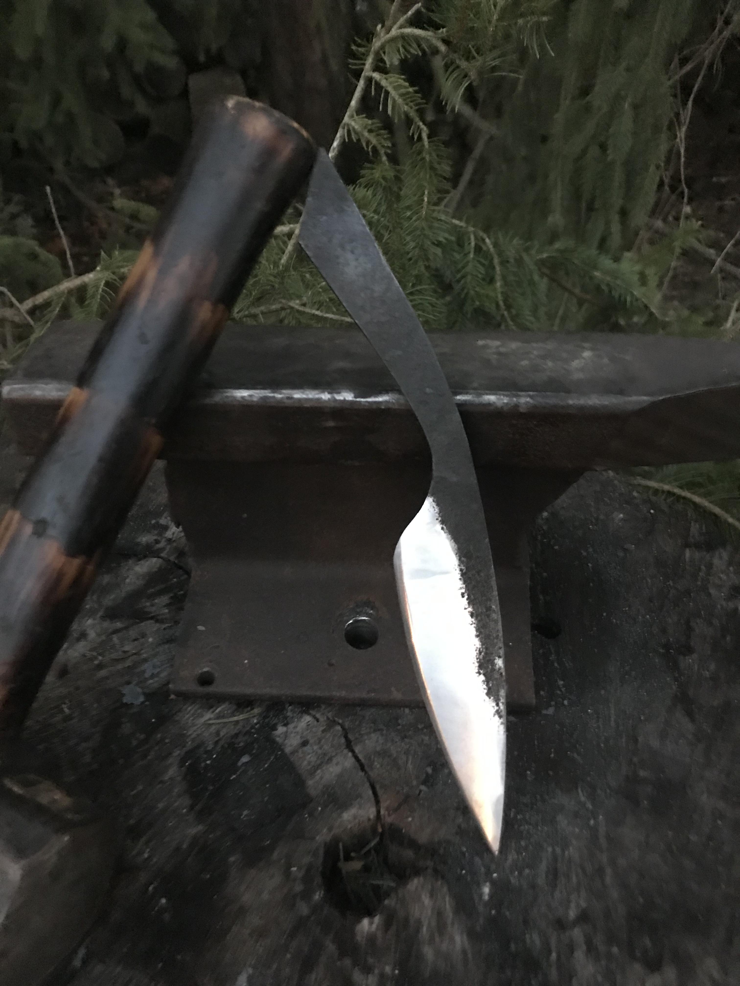

Chimaera Posted January 2, 2022 Share Posted January 2, 2022 Knocked out this little drop point for someone who got his Eagle Scout award. I think it might be my best yet- clean grinding, smooth lines, I remembered to use my touch mark, wonderful heat treat - I really like it. I think I’m going to do an upswept skinner with the same style handle soon. I just need to keep working on my grinding, and I need to make better things. Quote Link to comment Share on other sites More sharing options...

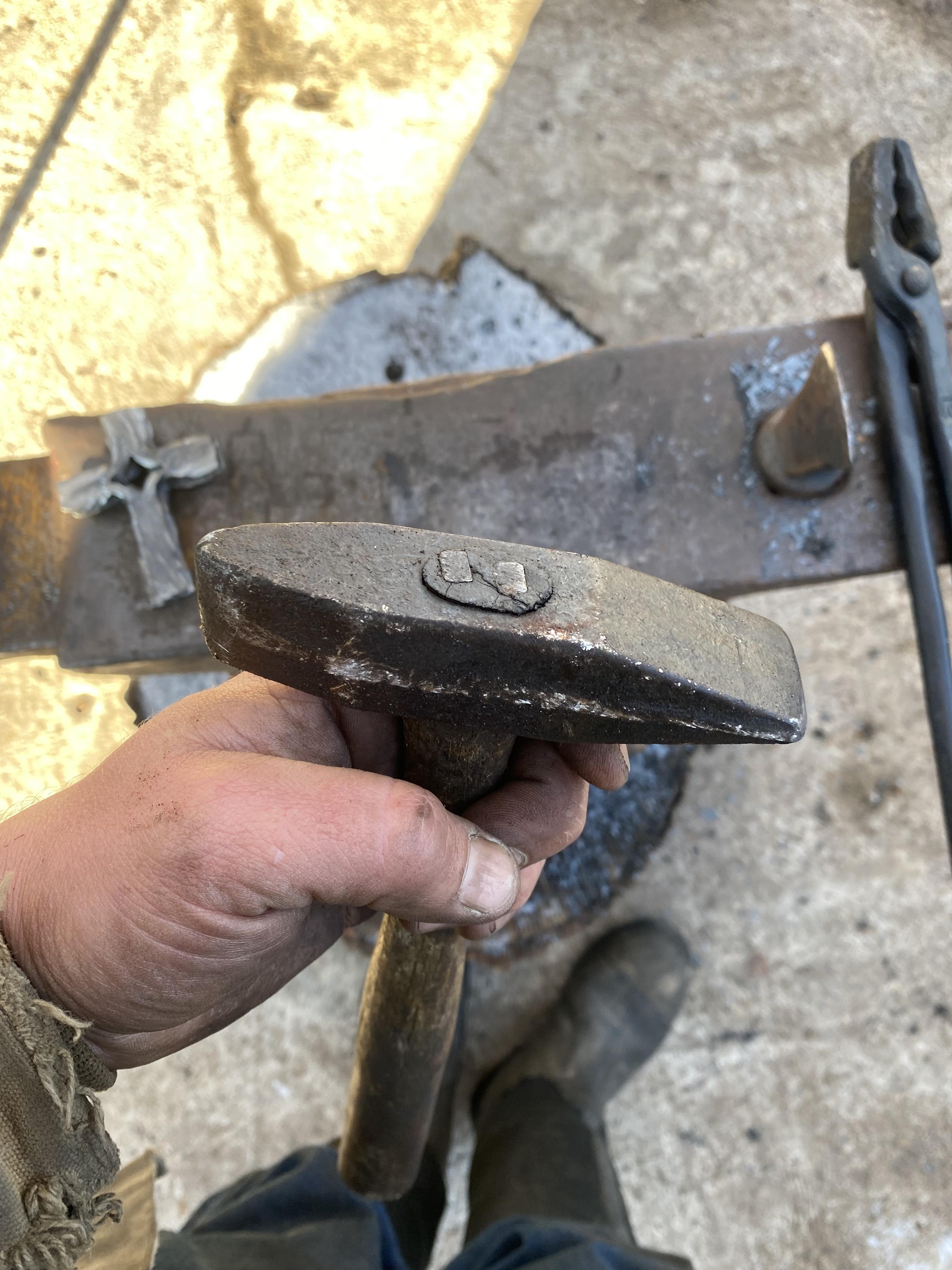

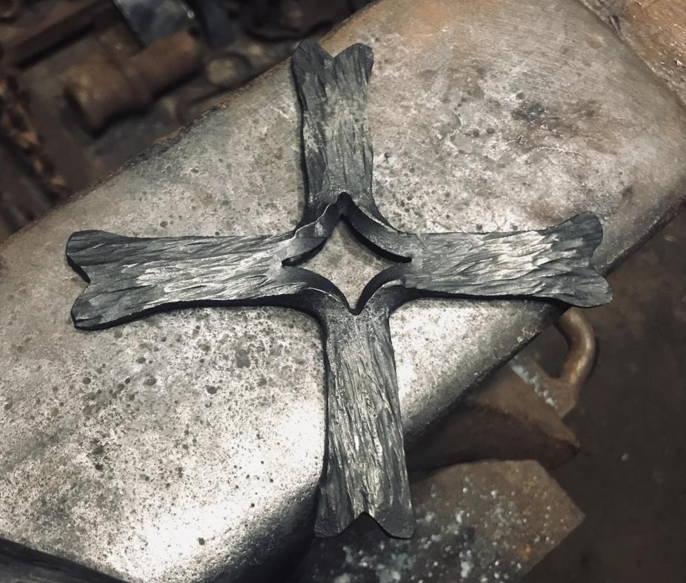

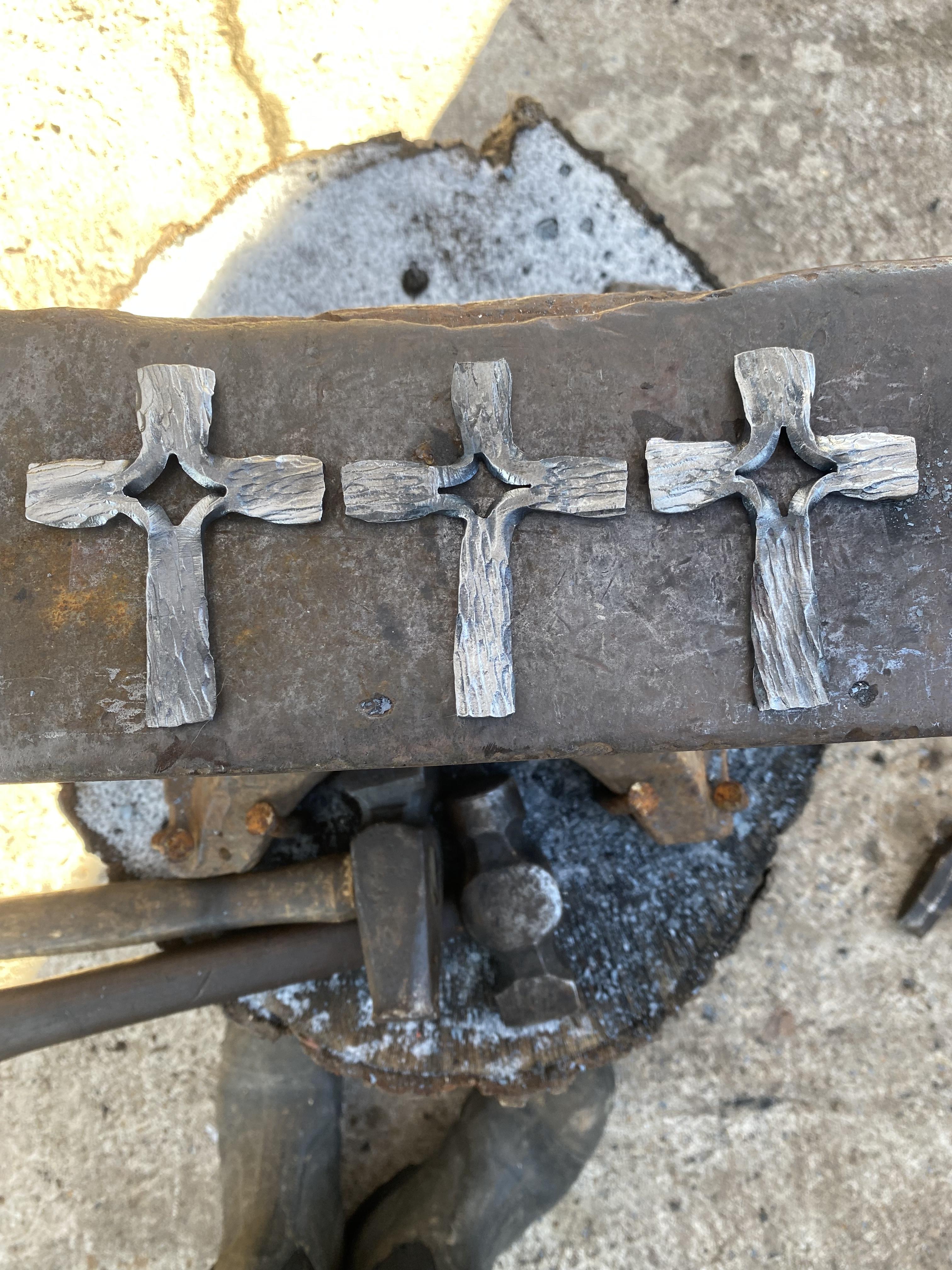

TWISTEDWILLOW Posted January 2, 2022 Share Posted January 2, 2022 Just finished up making a few more split crosses, I been playing with this cool little hammer I found awhile back, it’s a straight pean on one side and a cross pean on the other, it’s pretty light but it kinda works good for making a wood grain texture, Quote Link to comment Share on other sites More sharing options...
JHCC Posted January 2, 2022 Share Posted January 2, 2022 I’ve got one too; great for texturing leaves as well. Quote Link to comment Share on other sites More sharing options...

TWISTEDWILLOW Posted January 2, 2022 Share Posted January 2, 2022 10 minutes ago, JHCC said: I’ve got one too; great for texturing leaves as well. That’s a good idea JHCC! Although currently my leaves look more like butter knives It’s sad I’ve learned how to do more advanced projects like forge welding, but when it comes to making a stupid leaf I screw it up every time… I’ve watched videos, I’ve read threads and about everything in between, but even when I try to follow step by step I have yet to make a leaf I haven’t thrown in or (at) the scrap bucket! so needless to say it’s gonna be a little bit before this cool little hammer gets to texture a leaf lol, Quote Link to comment Share on other sites More sharing options...
Daswulf Posted January 2, 2022 Share Posted January 2, 2022 No worries TW. We all have things we are better at and things we aren't. If you want to get it, just keep trying. If you enjoy other things you are better at, do those. No one can tell you you Have to do a thing. You can try if you like tho. Quote Link to comment Share on other sites More sharing options...
TWISTEDWILLOW Posted January 2, 2022 Share Posted January 2, 2022 Lol, I haven’t given up on leaves I’ve just been alternating from repeating projects that I’ve got down good and trying to refine them to then trying new projects I haven’t done before, and every once in awhile I’ll grab some leftover bar and try 3-4 leaves till I get aggravated an move on to something else, Quote Link to comment Share on other sites More sharing options...

Chimaera Posted January 3, 2022 Share Posted January 3, 2022 Tw- lovely crosses! I thought they were wrought iron. I really need to figure those out. Quote Link to comment Share on other sites More sharing options...
TWISTEDWILLOW Posted January 3, 2022 Share Posted January 3, 2022 Thanks Gandalfgreen and George! Chimara, they are a really easy project, I watched a couple videos and started making them in a few minutes, 3” long of 1/2” square, cut down the middle 2-1/4” one way then turn over 90 degrees and flip it around to the other end, and cut down the middle to 1-1/4”, so that the cuts over lap, that’s what makes the little star in the middle, then heat and unfold the four sides, I followed the guy in the video and used a flatter to straighten it out, then heat and straighten out the four sides and used a hot cut to trim one of the long sides, Then just use a cross pean to texture, although I’m thinking about making some with a little ball pean to get a different look, ive heard Daswulf talk about a video by TecJoe showing how to make them from a railroad spike but I haven’t got a chance to watch it or try that yet, Quote Link to comment Share on other sites More sharing options...

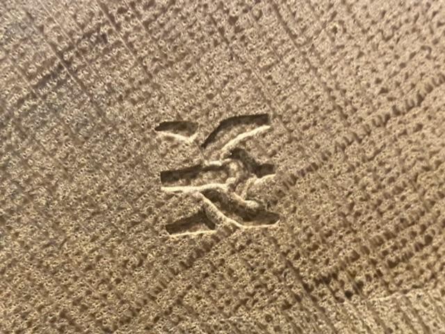

JHCC Posted January 3, 2022 Share Posted January 3, 2022 I also have a texturing hammer (made from a flea market ball peen whose face I shaped with the edge of a thin cutting disc) that I use for creating woodgrain. I don't have a photo of it handy, but here's an example of what its results look like: The face of the hammer is slightly domed, so you don't get a hard edge to each section of texture. Overlap the hammer blows slightly, and you'll get a nice even texture across the entire piece. Quote Link to comment Share on other sites More sharing options...
TWISTEDWILLOW Posted January 3, 2022 Share Posted January 3, 2022 That’s a nice texture JHCC! Quote Link to comment Share on other sites More sharing options...
