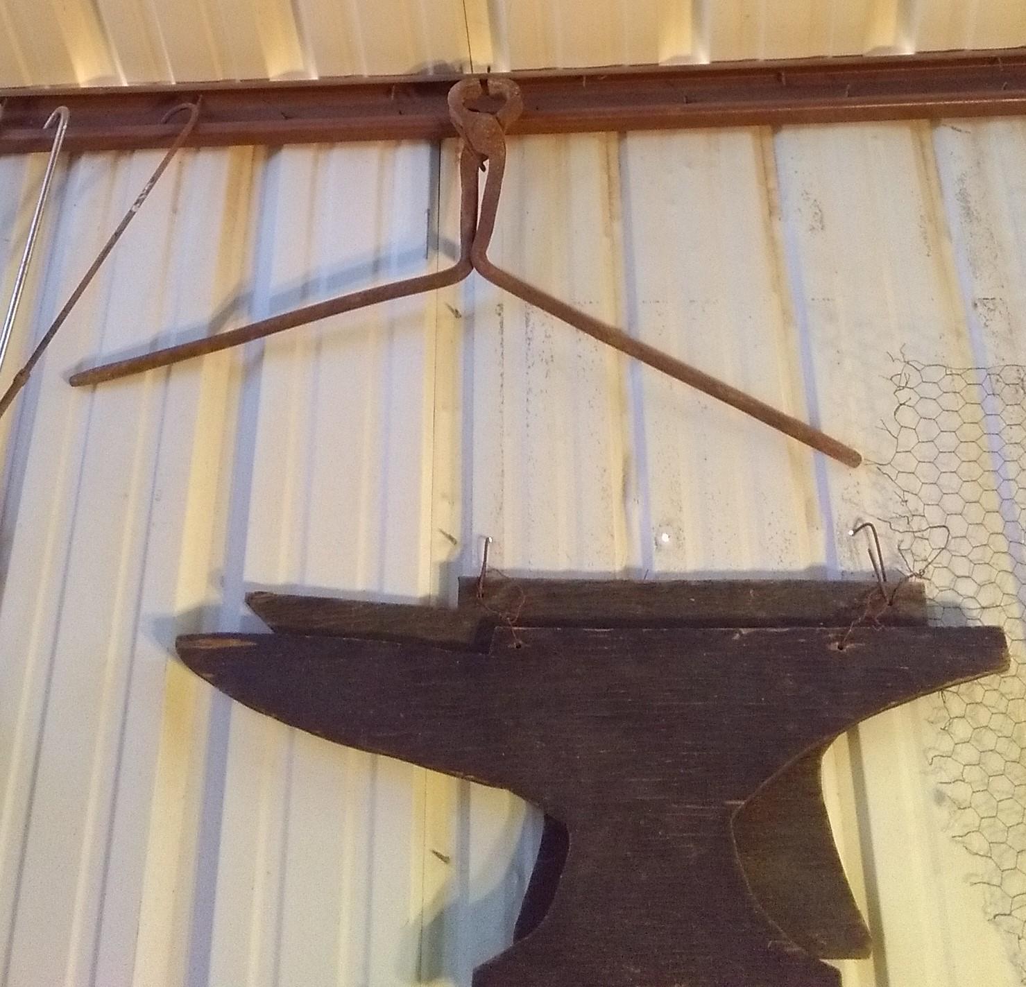

ThomasPowers Posted December 29, 2021 Share Posted December 29, 2021 DH; this one? It's a set of RR rail moving tongs. For some odd reason I keep running across old RR stuff at the scrap yard!---like the oddball spike puller: I'm off to the scrapyard! Quote Link to comment Share on other sites More sharing options...

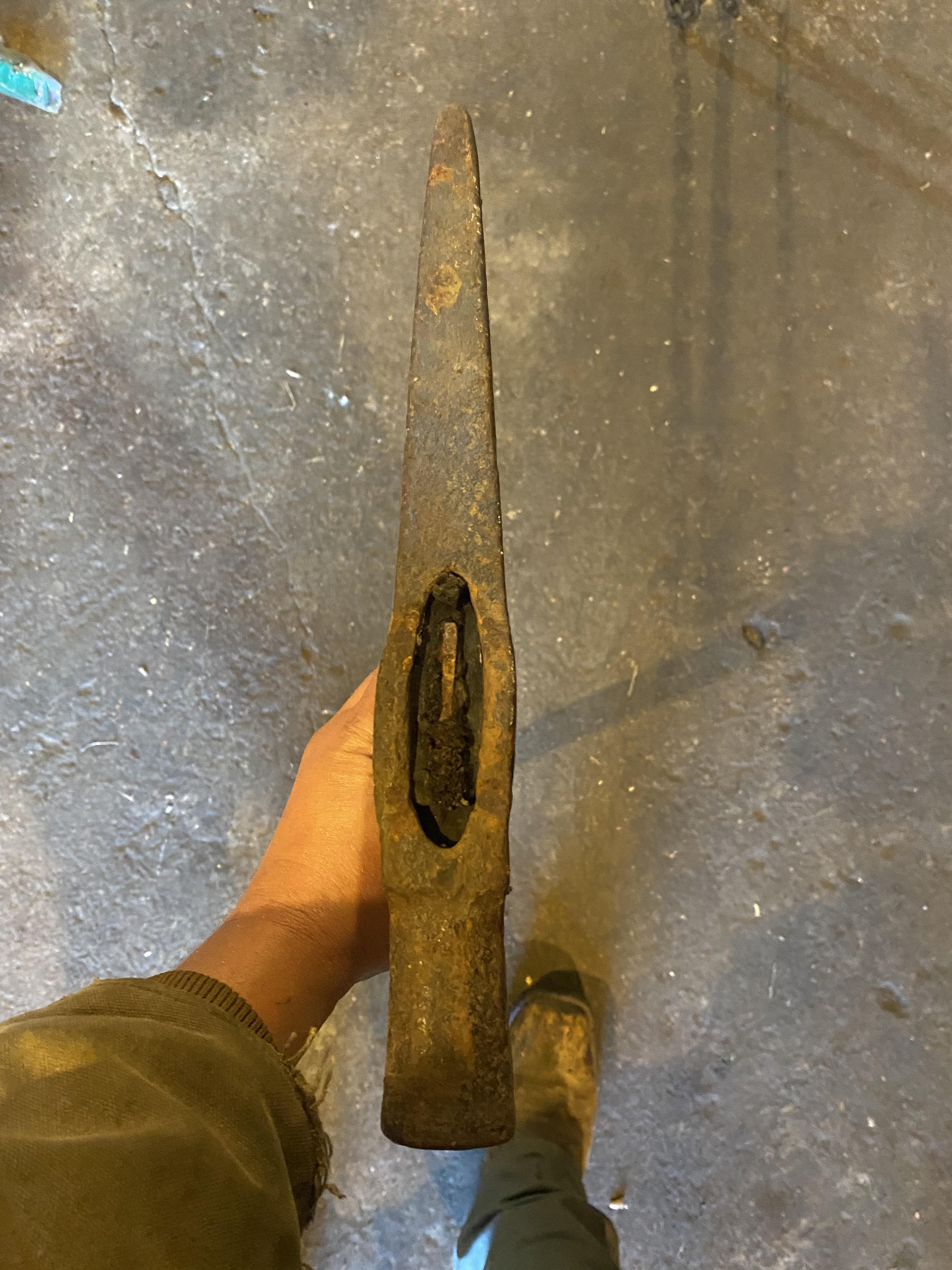

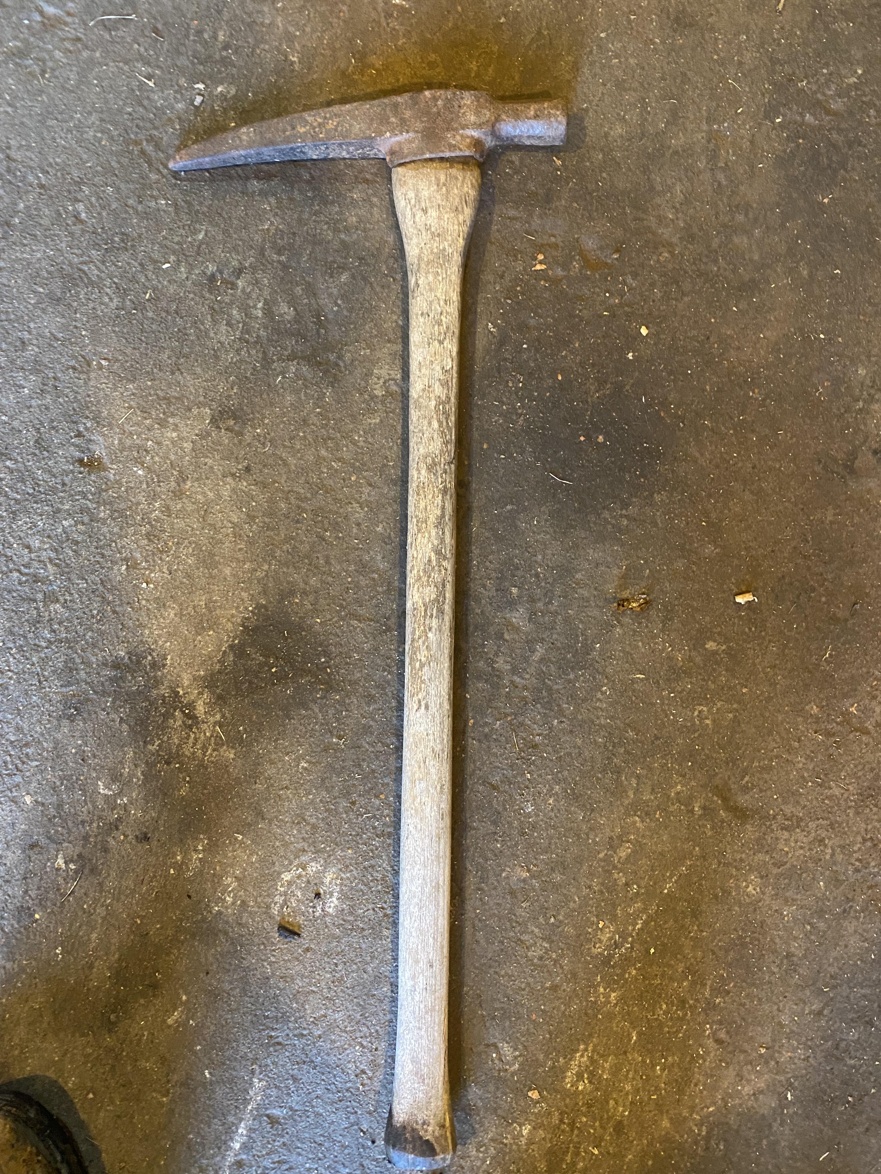

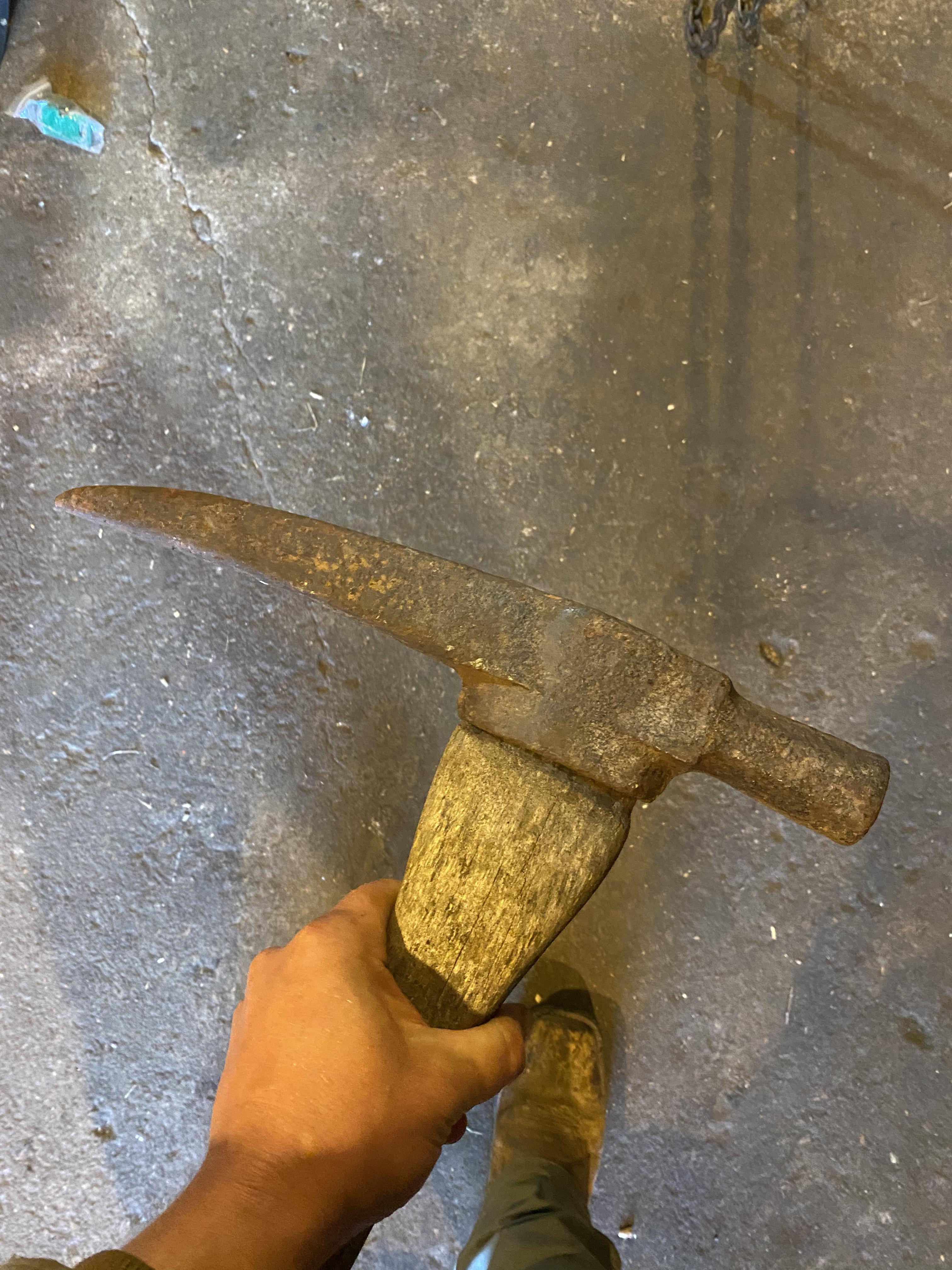

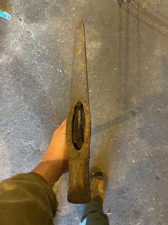

TWISTEDWILLOW Posted December 29, 2021 Share Posted December 29, 2021 I find spike mauls pretty regularly but the oddest hammer ive found is this pick/hammer and it takes a double bit axe eye handle, Quote Link to comment Share on other sites More sharing options...
George N. M. Posted December 30, 2021 Share Posted December 30, 2021 TW, it might be a mining tool with the hammer end for driving the small spikes of mine rail tracks. "By hammer and hand all arts do stand." Quote Link to comment Share on other sites More sharing options...
TWISTEDWILLOW Posted December 30, 2021 Share Posted December 30, 2021 I didn’t think about that George! That’s a good idea! I’ve been scratching my brain on what a pick/hammer would be needed for Quote Link to comment Share on other sites More sharing options...

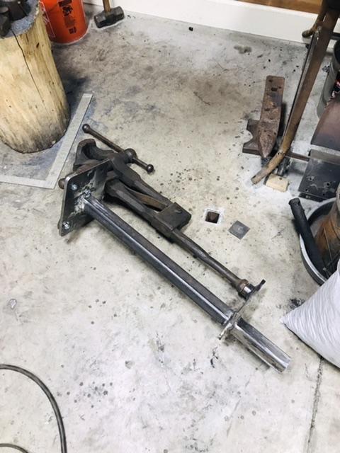

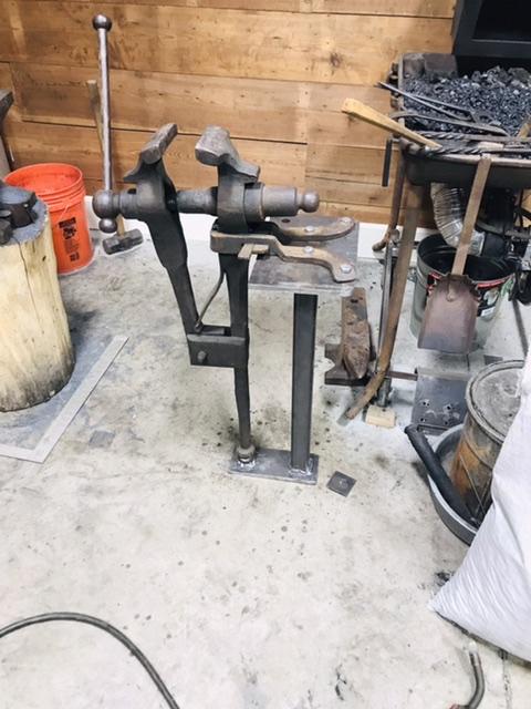

Goods Posted December 30, 2021 Share Posted December 30, 2021 I finally took the time to make a new stand for my post vise yesterday/today. It’s pretty basic, but it’s the first stand to utilize the goesinta’s in the shop floor. Probably not it’s permanent location, but it’s pretty solid (even with this goesinta being a little crooked). I’ve still got a lot of work before the hammer-in here next weekend… Keep it fun, David Quote Link to comment Share on other sites More sharing options...
TWISTEDWILLOW Posted December 30, 2021 Share Posted December 30, 2021 That’s a pretty cool idea Goods! I haven’t seen anyone with sockets In the floor before, that seems like it would come in handy for changing setups for different projects Quote Link to comment Share on other sites More sharing options...

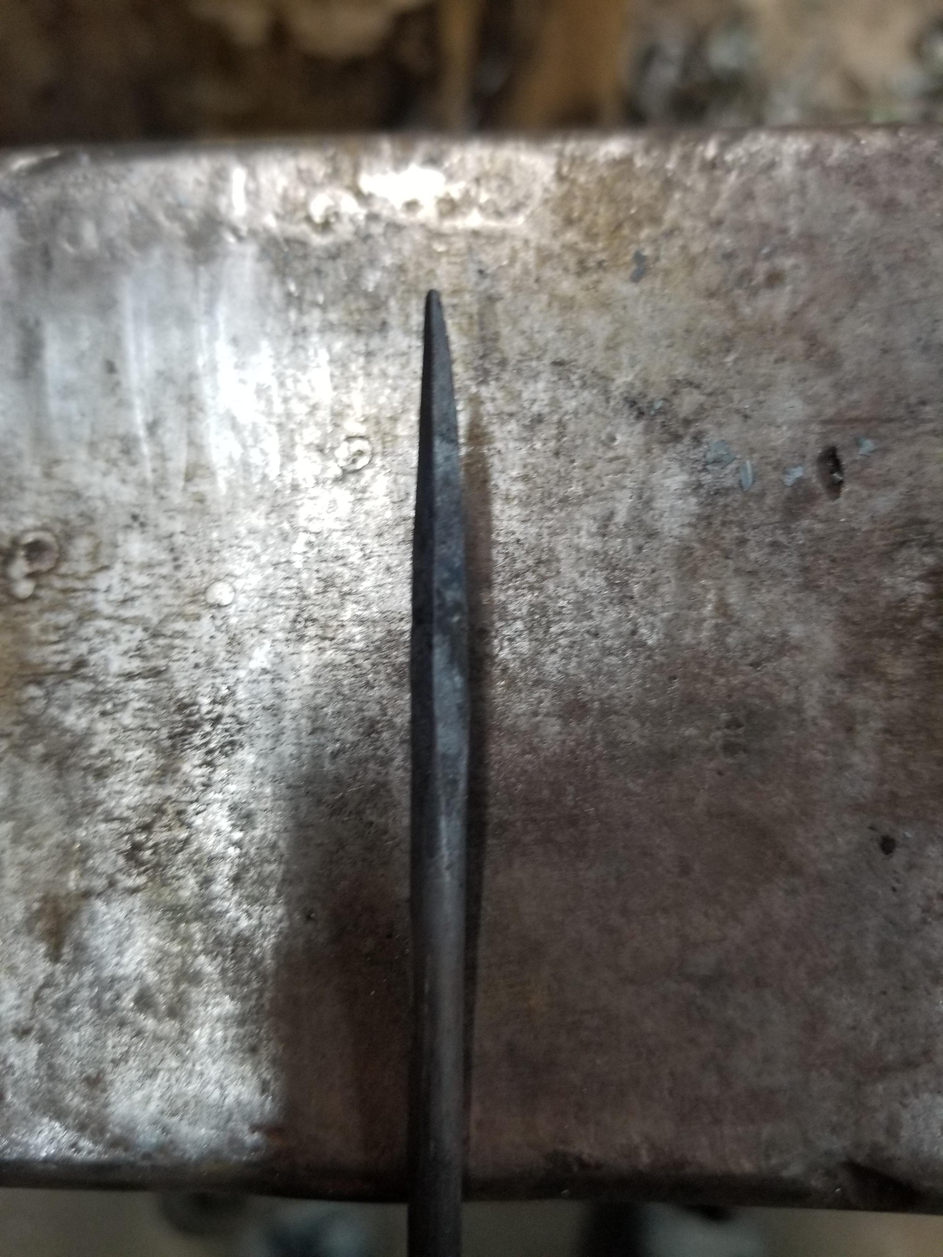

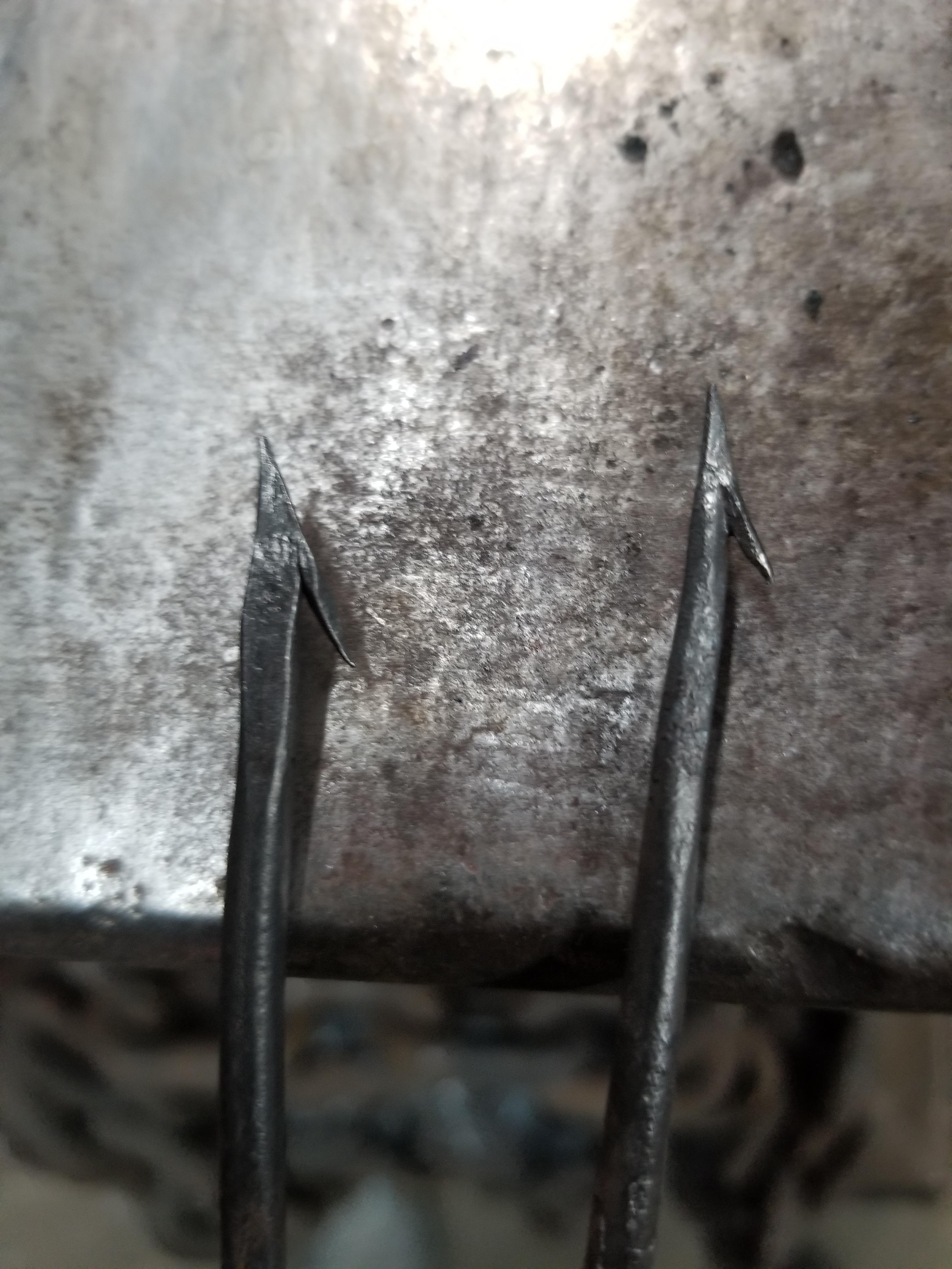

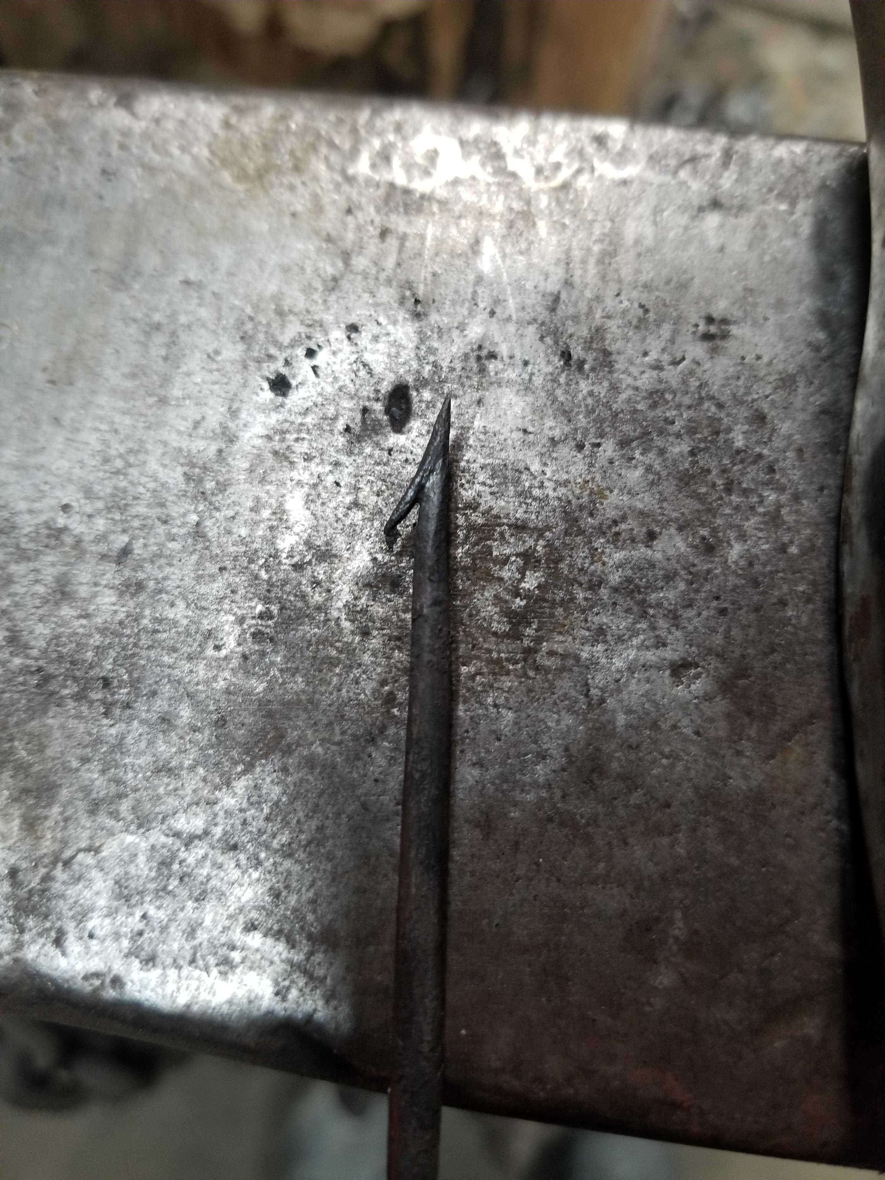

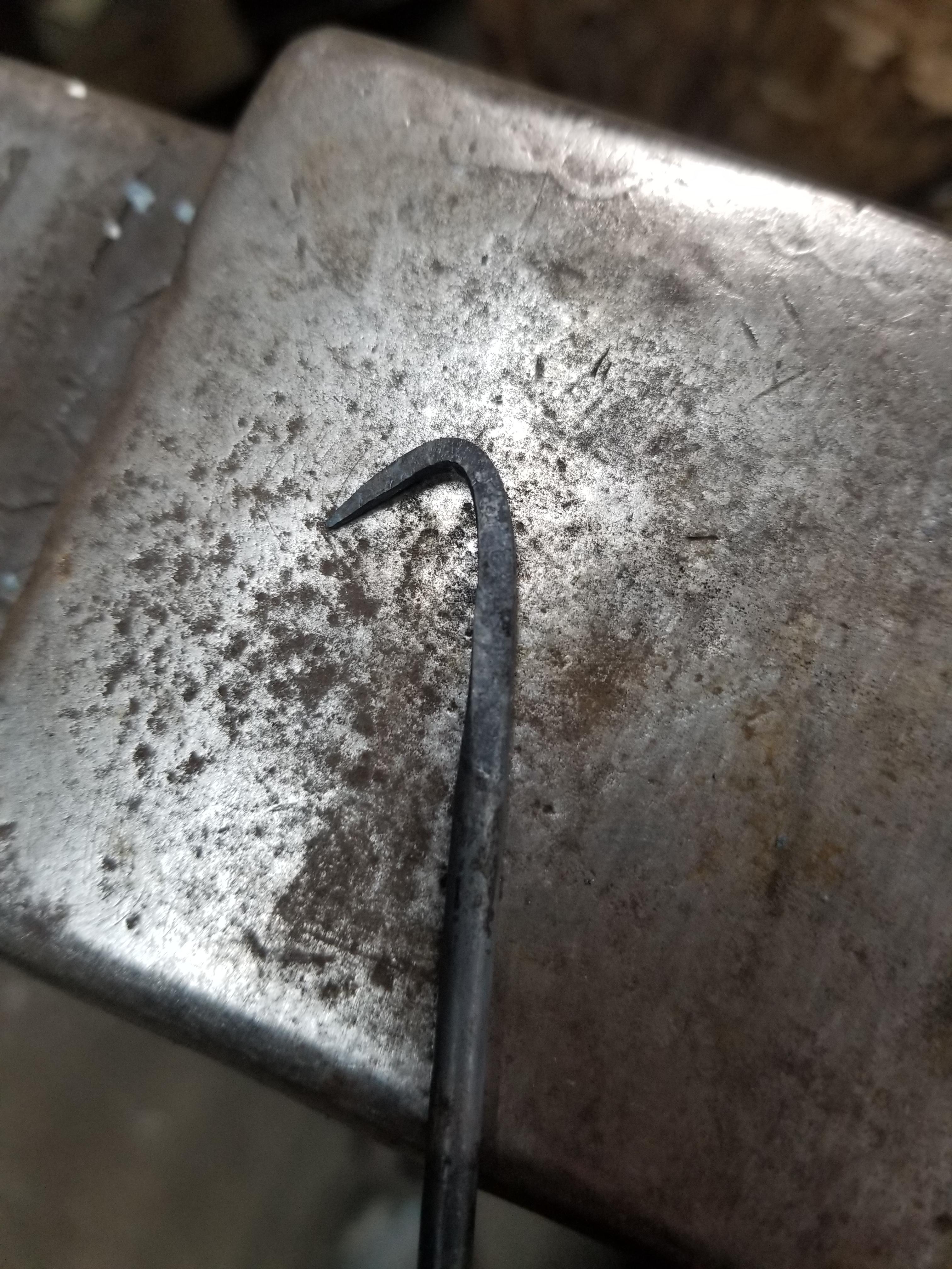

Daswulf Posted December 30, 2021 Share Posted December 30, 2021 On 12/26/2021 at 6:20 PM, TWISTEDWILLOW said: frog/crawdad gig I stood my crumbling stack back up and it still draws enough to fire it up. Just to play with the idea out I forged a couple gig spikes out of 1/8" round bar from political style sign posts. First was a little clunky. Second was more refined but could use a bigger barb. Both got poked repeatedly in and pulled out of cardboard to see if it would mess up the barb and if it would hold a bit. Not bad really. Both stabbed in fine. Barbs didn't bend or break. I'm thinking it might hold better in frog skin. Worked the material down and square and made the point that will be the barb. Made the bend over the edge of the anvil and at this point got it hot again and wire brushed and fluxed. Missed a picture in here but closed the gap and at a few welding heats tapped it tight avoiding hitting the tip area of the barb. Just tapping at the edge of the anvil with the stock slightly raised. Each heat after hammering a light brushing and re fluxed. Obviously you lose heat fast with the small material. Anyway this could be refined with a little more practice then off to a double or triple pronged piece. Or these individual barbs could be attached to a socket made from pipe. that was a fun quick little play time. Quote Link to comment Share on other sites More sharing options...

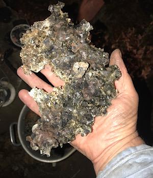

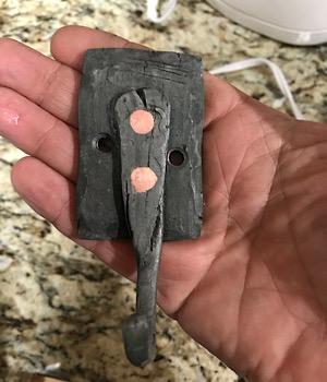

Donal Harris Posted December 30, 2021 Share Posted December 30, 2021 Twisted, I wonder if that pick/hammer could be a reshaped pick? And this is a “real” clinker, or half of one anyway. It isn’t as irritating as it might otherwise be since my grate is a little over an inch tall. The clinker falls below the level of the grate. If I had a proper bullet grate it would be even better. Which would be good since finding better coal doesn’t seem to be an option. This clinker was from burning a little over a 5 gallon bucket of coal. I finished assembling the hook. Very crude. I got the holes way out of alignment. I am blaming that on poor lighting. I work outside and the halogen lamp I use leaves me having to deal with a lot of shadows and unnatural lighting. But really I should have been able to get them closer than that. I have it soaking in diluted muriatic acid to etch. I checked it this morning prior to work and saw it needed more time. Leaving it for another 8-10 hours is sort of scary, but we’ll see if it survives the day unattended. Quote Link to comment Share on other sites More sharing options...
TWISTEDWILLOW Posted December 30, 2021 Share Posted December 30, 2021 Lol Nice clinker DHarris! Id call that hook rustic not crude, I like it! Quote Link to comment Share on other sites More sharing options...

ThomasPowers Posted December 30, 2021 Share Posted December 30, 2021 Das, For our woodstove I found 1 section of stainless at the scrapyard. Put it in the lowest part of the chimney as that gets the hottest and so degrades the fastest. Stone County Ironworks used to hang their biggest clinkers on the wall of the shop, with their firepots they got doughnuts; so easy to hang. DH; I don't think that is reshaped as the one I have that is similar is definitely a commercial one. I may have to go through an old catalog or two to find an example---when the cold weather hits. Quote Link to comment Share on other sites More sharing options...
BillyBones Posted December 30, 2021 Share Posted December 30, 2021 I totally missed that hammer. That looks like what we used to call a coal pick or coal hammer. You would use the pick to split the coal at the seam then break the pieces with the hammer part. The one we used when i was a kid took a mattock or pick style handle though. Quote Link to comment Share on other sites More sharing options...
TWISTEDWILLOW Posted December 30, 2021 Share Posted December 30, 2021 I don’t even remember where I found it now, it’s been several years since I drug it home, I haven’t ever seen another tool like it that takes that style of handle Quote Link to comment Share on other sites More sharing options...

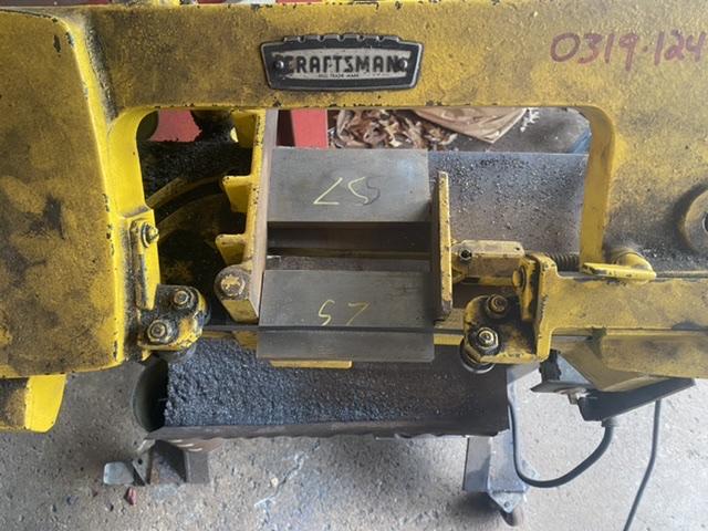

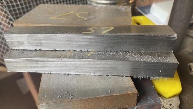

JHCC Posted December 30, 2021 Share Posted December 30, 2021 Quick experiment to see if I could slice a 5” long piece of 1/2” annealed S7 bar lengthwise on the horizontal bandsaw: Answer: Yes. The bar got a little warm to touch, but not enough to air harden. Since my plan is to make a new touchmark with this, I wanted it to remain annealed and therefore soft enough to file. I’ll harden and temper it after the design is cut. Quote Link to comment Share on other sites More sharing options...
Frosty Posted December 30, 2021 Share Posted December 30, 2021 Darn right that got "warm," John! Stand it on edge and ease into it slowly with the feed. That saw has 5" vertical capacity doesn't it? If your blade is dull and wants to wander, back off on the feed more and let it wear through while you wait for new blades to arrive. Frosty The Lucky. Quote Link to comment Share on other sites More sharing options...
JHCC Posted December 30, 2021 Share Posted December 30, 2021 I think the vertical capacity is only 4”; I’ll double check. I’ve been having a lot of trouble with the cut wandering even with a sharp blade, but I think I’m starting to get a handle on adjusting the blade guides. Maybe I’ll try with another piece. Quote Link to comment Share on other sites More sharing options...
Frosty Posted December 30, 2021 Share Posted December 30, 2021 Make an angle adaptor to fit in the vise to slope the stock and lower the vertical height. Lean it back at the top. We spent a lot of time and posts getting that saw's guides adjusted didn't we? Is there ANY play in one of the guide rolls? Just a little is all it takes. Frosty The Lucky. Quote Link to comment Share on other sites More sharing options...

JHCC Posted December 30, 2021 Share Posted December 30, 2021 30 minutes ago, Frosty said: We spent a lot of time and posts getting that saw's guides adjusted didn't we? We talked about it, but I never really got the hang of it before. Quote Link to comment Share on other sites More sharing options...

BIGGUNDOCTOR Posted December 30, 2021 Share Posted December 30, 2021 Billy Bones. the MC marked spikes were for the experimental Space Train and were marked for meteoric content..... JHCC, when I had my shop we would set the part in the vise with a riser on one end to angle the part enough to lessen the swept area of the blade. Also getting blades with a big tooth pitch help. Quote Link to comment Share on other sites More sharing options...
