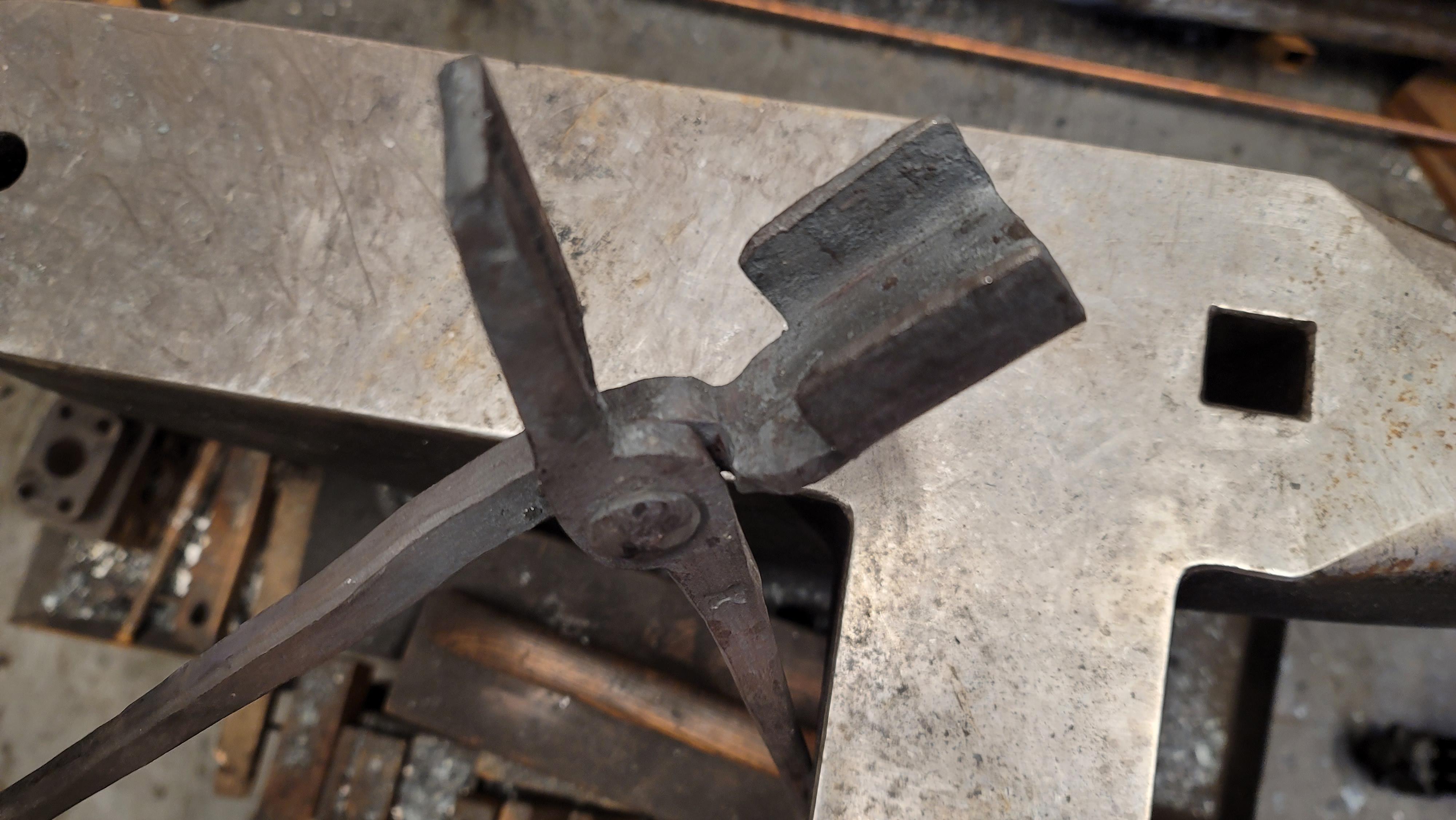

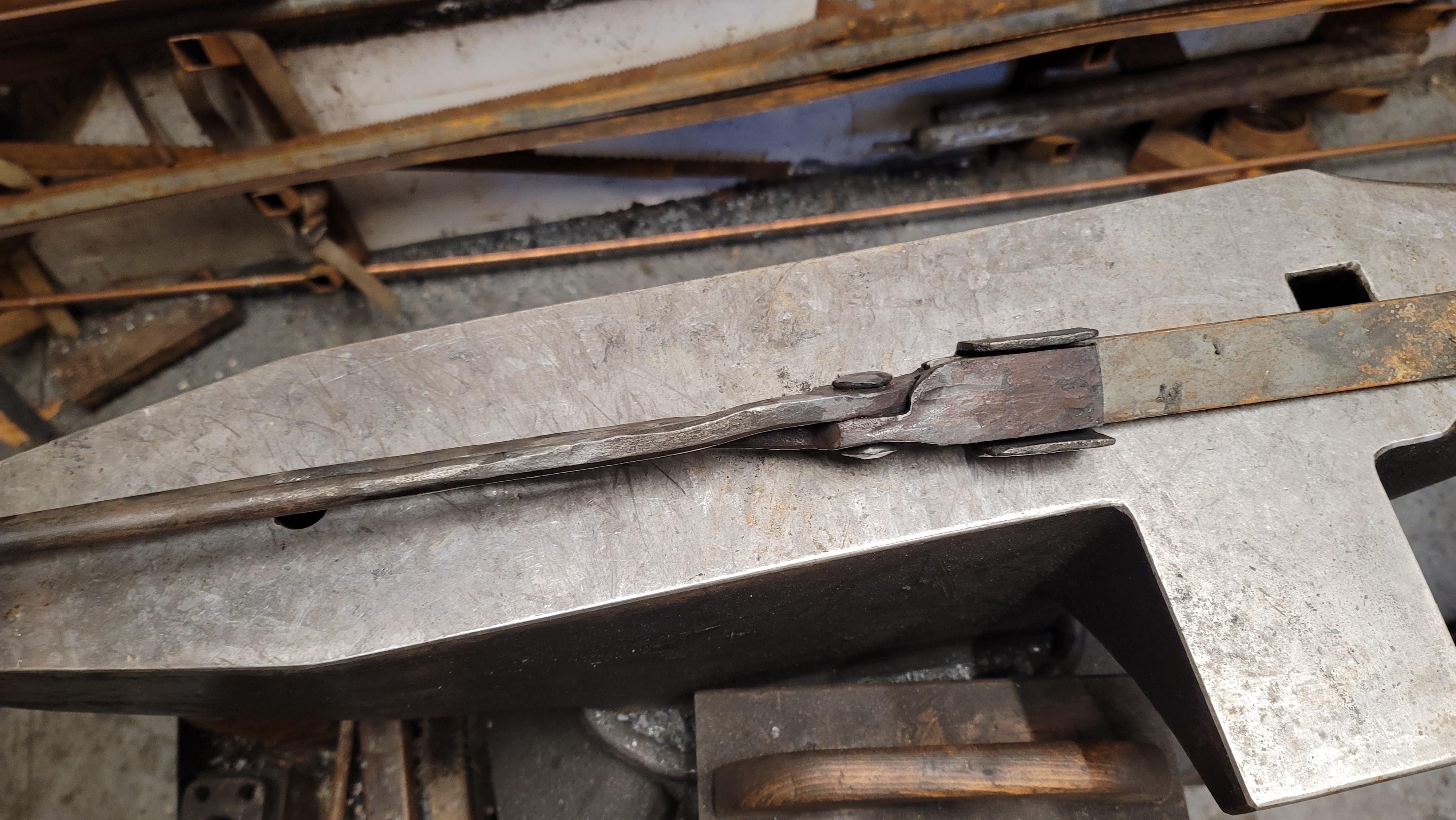

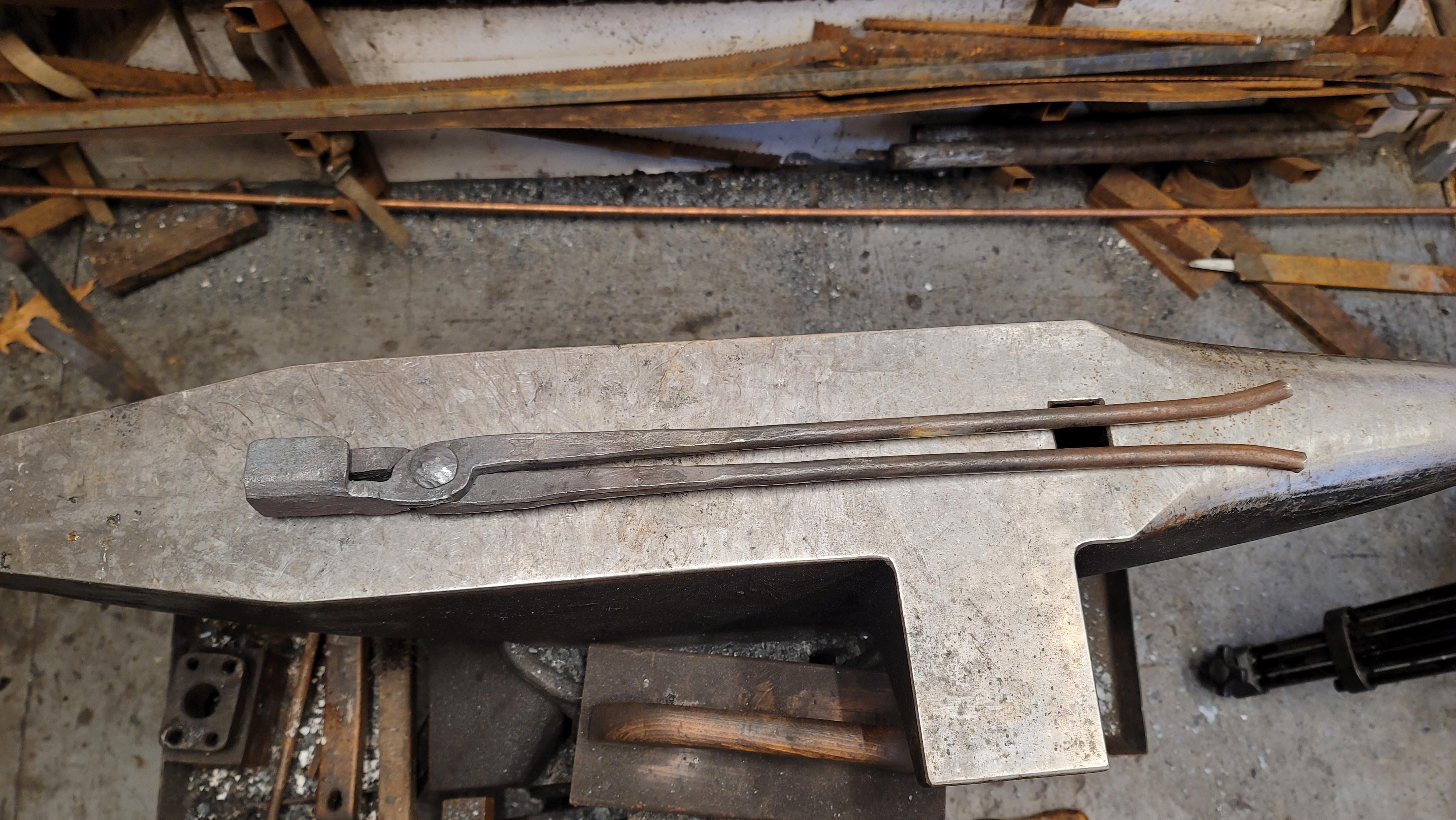

jlpservicesinc Posted January 3, 2022 Share Posted January 3, 2022 Finished these up today.. Fun, fun, fun.. I had a tough time getting things to weld too.. Maybe something in the air.. Is 20F here.. LOL.. Though I had the portable indirect heater pointed right in the door.. Was a balmy 65F in there.. 1/4x1.25 though can be adjusted for up to 1.25X1/2" Maybe even 5/8" thick. Quote Link to comment Share on other sites More sharing options...

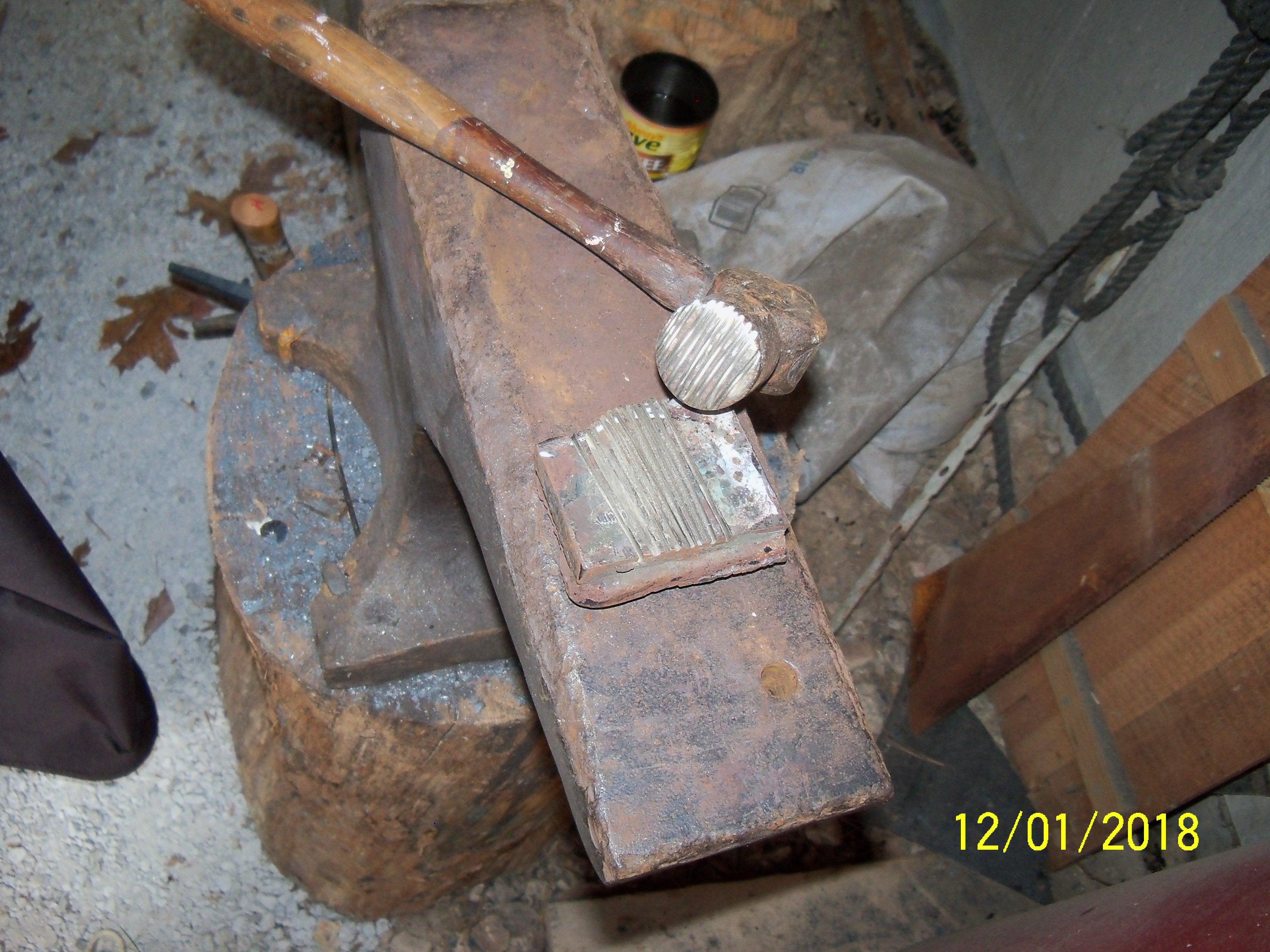

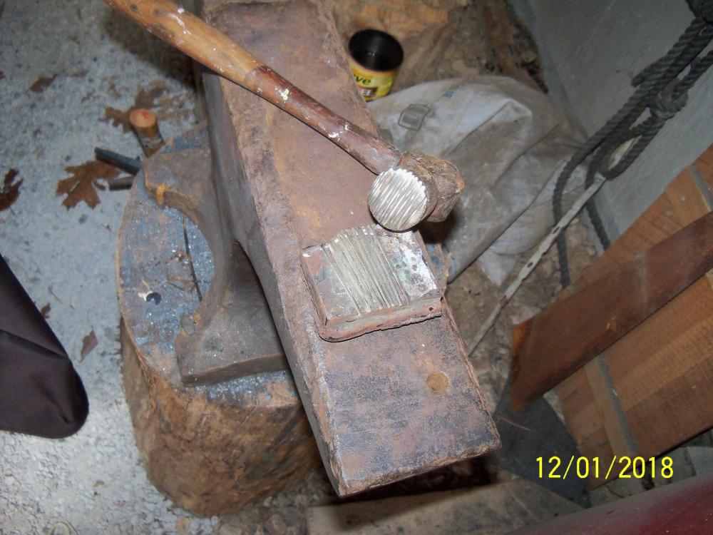

Irondragon Forge ClayWorks Posted January 4, 2022 Share Posted January 4, 2022 11 hours ago, JHCC said: I also have a texturing hammer (made from a flea market ball peen I have one made the same way, old ball peen and a hardy bottom tool from some scrap. Quote Link to comment Share on other sites More sharing options...

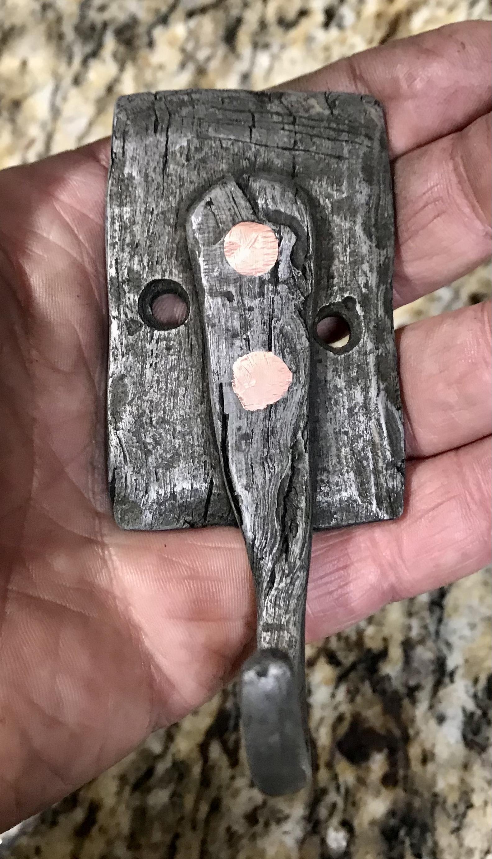

Donal Harris Posted January 4, 2022 Share Posted January 4, 2022 I have a small ball peen I use for texturing. I just put random lines in the face of it with a cutting disc and then banged it repeatedly into some steel to soften the edges of the cut grooves. I use a small sledge for the same thing on larger items. Finally finished the hook to hang my daughter’s cutting board from. If you look closely at the holes, you can see a center punch mark that had I not missed it when drilling would have put the holes almost level with each other. As Twisted said, it is “rustic” but I am not totally unhappy with it. One thing I like about it is it isn’t a leaf. I may forge a leaf some day in “the other place” but not before if I can help it. Still not finished with my employee’s bottle opener. I was soaking it on the stove in instant coffee this evening, but had to stop because my wife has decided her kitchen is not my shop. I guess I need to see if I can find a small crock pot at a thrift shop. The chasing is not bad for a first try. Quote Link to comment Share on other sites More sharing options...
Frosty Posted January 4, 2022 Share Posted January 4, 2022 If you put a center punch mark in the same position on the other hole it'll look like it's rolling it's eyes. Just don't tell anybody at whom. As it stands (hangs) it's just part of the character and charm of the piece, I like it. I'd put it on my wall. I made my wood grain texturing hammer from a yard sale ball pein, I heated it to bright red and bounced it on a sharp hardy till it cooled, reheated it and did it again until it was textured enough. Once cool I hit it with the wire cup brush to remove burs and buggers. The sharp(ish) ridges only sort of line up in groups of between about 15 and 5 so it has a sort of organic flow. Makes a decent woodgrain like texture. Frosty The Lucky. Quote Link to comment Share on other sites More sharing options...
