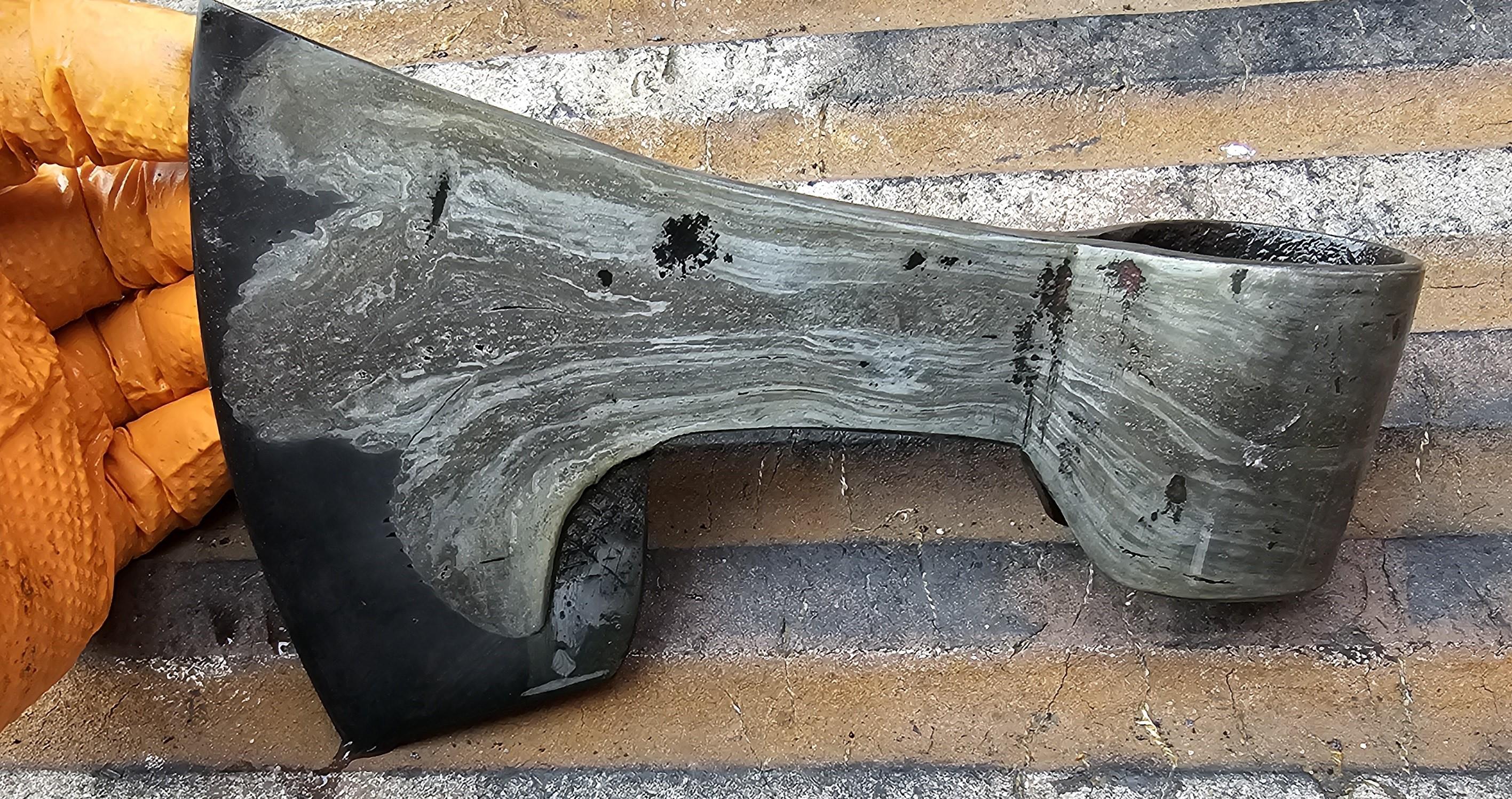

11 hours ago, aaamax said:
this is something I wrestle with a lot.  To forge the file as is, or to first grind the teeth off?
it depends what you are after and your skill set.
This is farriers rasp for the edge. forged to shape and forged welded.
The compass is rasp for the tips.  Welded..
The pattern in the rasp I wanted to be there when this tomahawk was finished..  The wrought iron filled the teeth of the rasp on both sides.. This leaves a very interesting pattern with no doubts as to the edge material.
The last photo was a 20min knife forging demo for someone who would go on to win Forged in Fire this past season  We were talking about how and way and just how fast it is a few years ago.
wow, some serious skills their on display.  Impressive.
The drawknife looks to have a Hamon line, yes?  How did you develop that, or did I not catch that it had wrought for the spine?   did you grind off the teeth on that one first?  I see no left over artifacts, so clean.
The 20 min blade as well seems so clean at the edge.  How was that acomplished?
 Punched and drifted a piece of Hyster fork yesterday afternoon.  Another hammer and tennis elbow in the making. (Just kidding I feel fine this morning.)
On the draw knife no Hamon,  all the items are wrought iron with welded steel rasp. All the items are finished by hand with no electric equipment used.  Files and sandpaper and scrapers.
as to how, lots of experience.
I don't grind off the teeth.. When I first started45+ years ago I would grind them off.  but stopped doing that many years ago now.

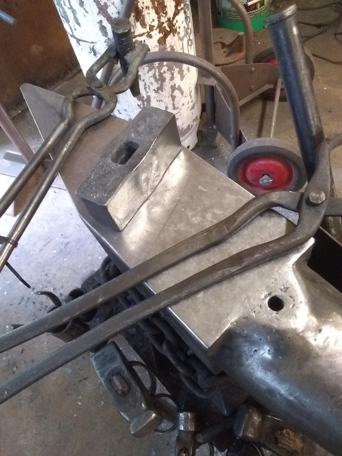

I finished up the tongs I started the other day:
And I also stared upsetting some 2-1/2” shaft to make another sledge for the IBA conference. I think I’m at the limit of my power hammer, this is going to take quite a few heats!:
4 heats down and it’s upset by about 1-1/5” (I lost a bunch to scale on my last one, so starting with 11lbs I’m hoping to end up at 8lbs…)
