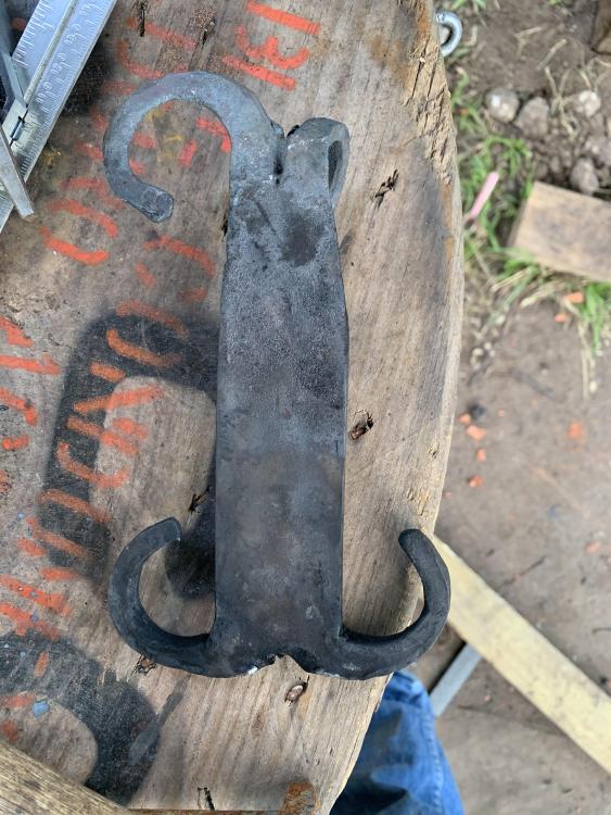

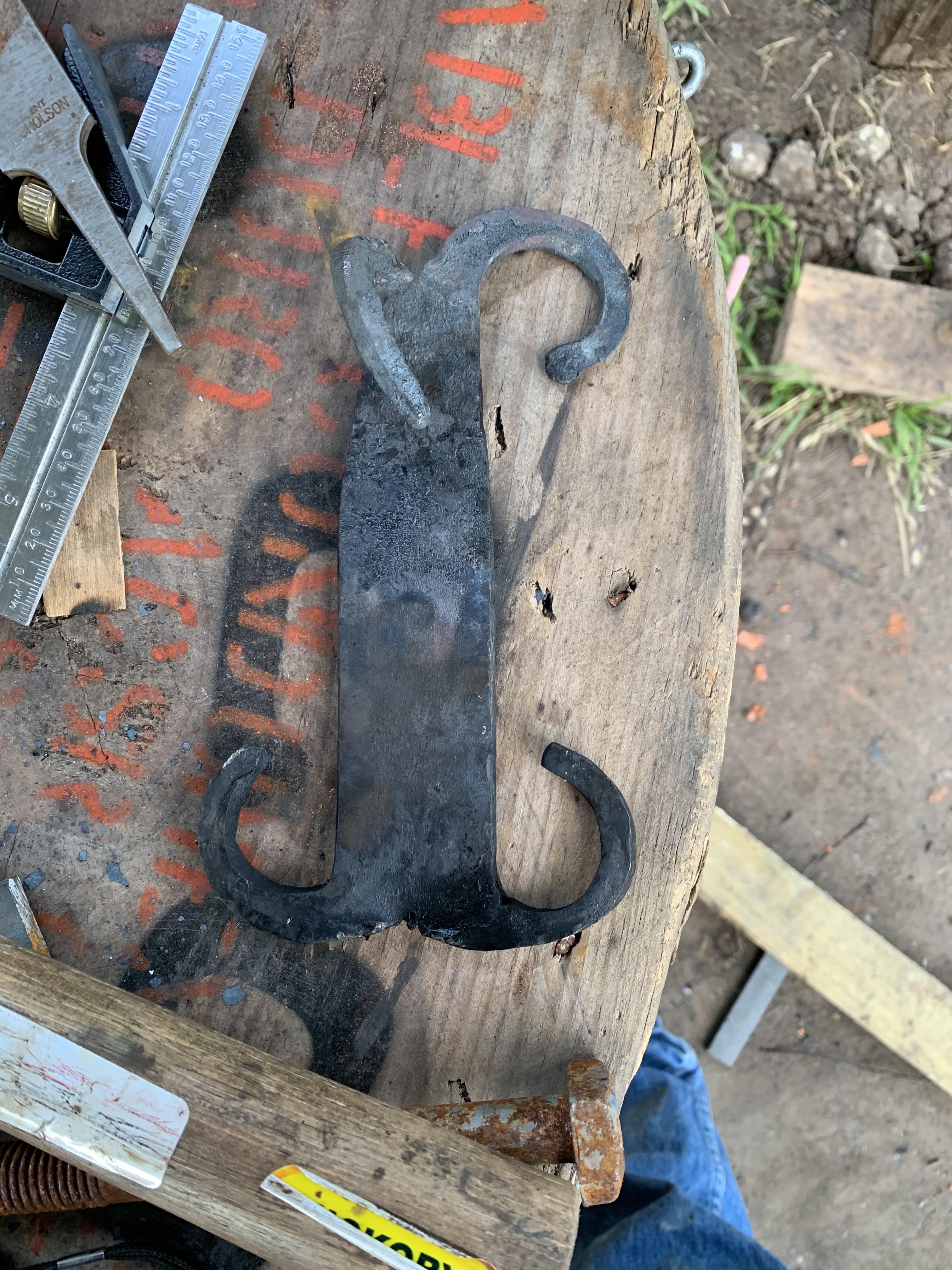

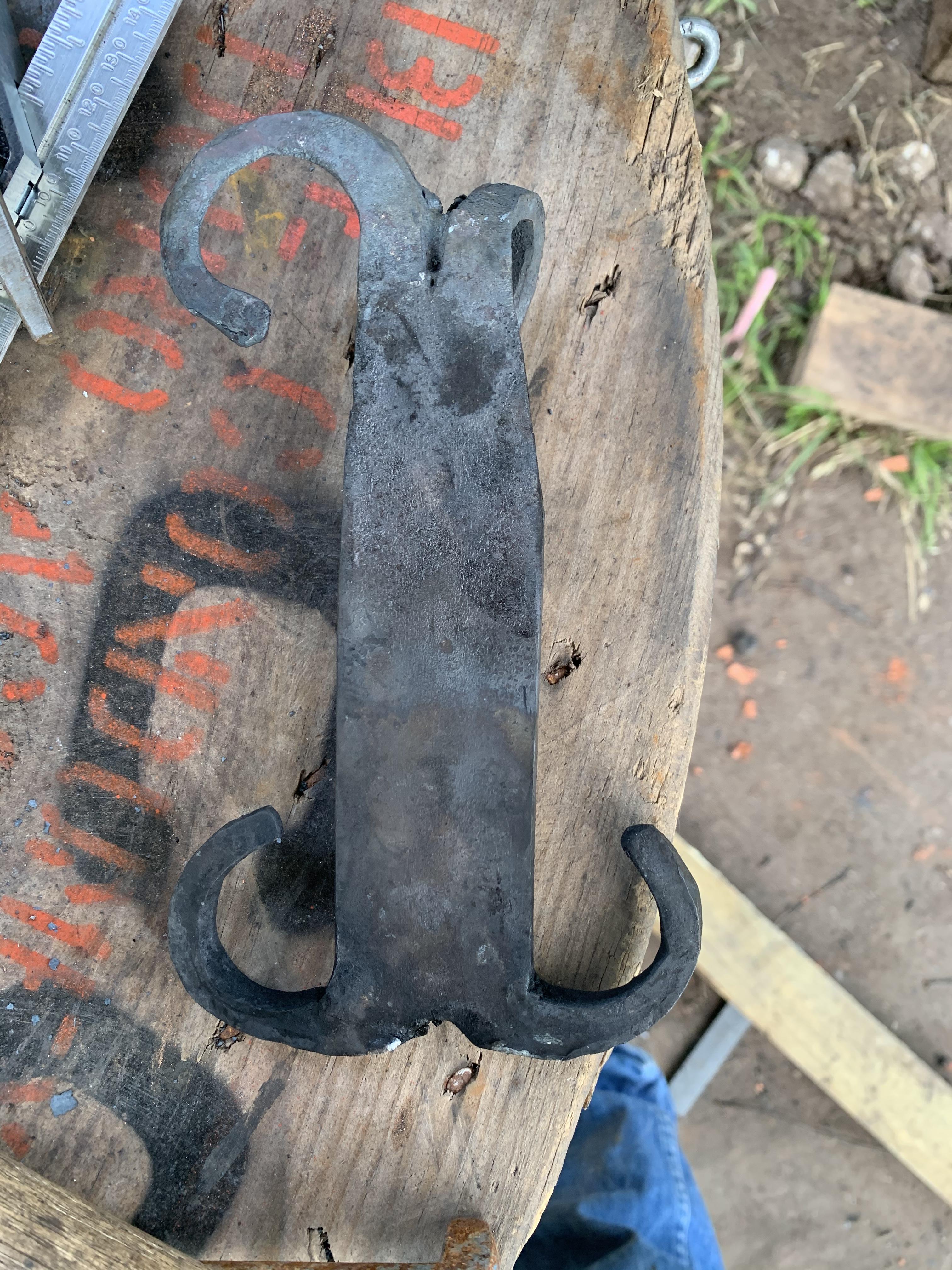

I Worked on a new to me technique for finials. It didn’t turn out great but I have a good idea of what went wrong. I’m going to try again tomorrow and hopefully have better results. I ran out of time to finish the second side. Not a big deal since it was just a practice piece anyway.
The top side is the new technique, bottom is old.9DCB3255-559E-4434-A74D-F3EE727BAAC3.thumb.jpeg.74ff960850e3c3517b49ca557891b1e3.jpeg3EDC19D1-4423-4393-8616-09BB105D21E5.thumb.jpeg.c5aac533f056960fd2193b1a7a19451d.jpeg

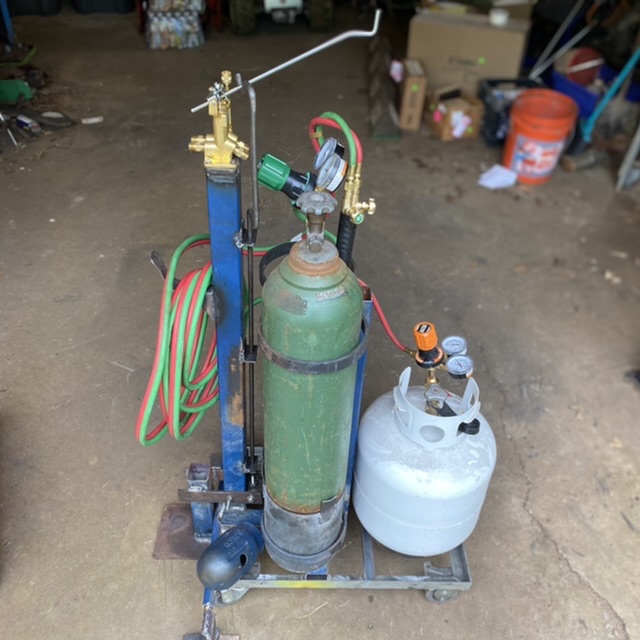

Getting back to the shop, I (mostly) finished my welding cart:

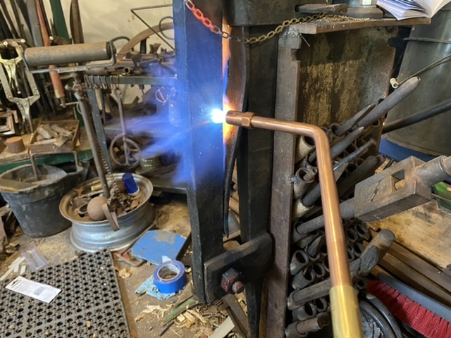

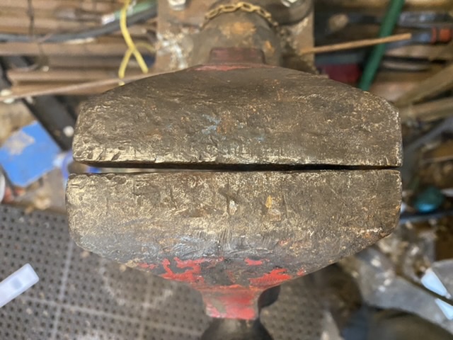

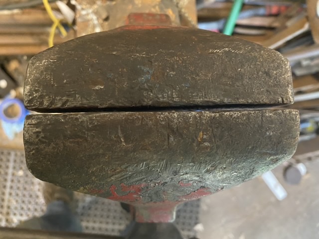

And used the torch to straighten a twist in my vise jaws:
Spot-heated the middle:
And closed the vise:
I had to use a small piece of metal (not shown) between the jaws on the right hand side, otherwise the play in the mechanism would have absorbed the twist without moving it the other way.

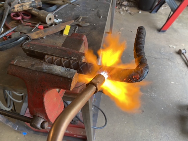

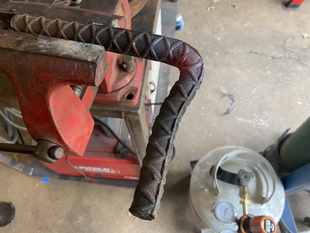

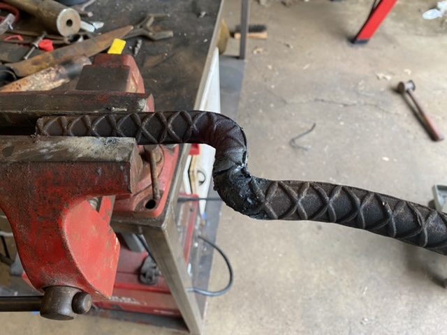

Also played around a bit with spot-heating to make tight bends. This is 1” rebar; heating only took a minute or two.
I’m liking this oxypropane thing!

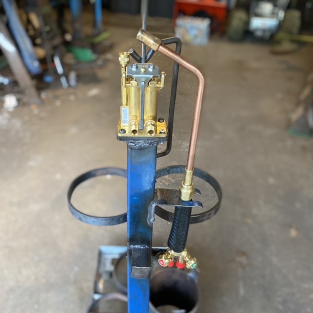

JHCC, I use a #4 brazing tip to spot heat items like that, you can concentrate your heat in a smaller area and it uses a lot less gas and oxygen than the rose bud, a little slower heating the metal, but I find it works better for me.
Noted, and thanks for the advice.
I don’t know if you’ve been following my Thinking About Oxy-Propane thread, but there’s been some good discussion there about brazing tips for propane; they’re not as common or as inexpensive as those for acetylene. I do plan to get one fairly soon, once there’s room in the budget
Does yours automatically shut off when you hang up the torch?

No, I haven’t been following that thread, but I will look for it.  I use both types of brazing tips on a regular basis, for heating metal and silver soldering, I prefer the a/o tips because I have a much wider range of adjustment with each size tip. I can use my #4 a/o to do the same work of having to swap between #2-#4 propane tips. I would not try to braze thick metal using the a/o tip with propane, but it’s fine for brazing thin metal and heating for twists and bends.
Once I get everything set up properly, the gas saver will do two things:
1. Shut off the gas when the torch is hung on it, as usual.
2. Work in conjunction with a bracket and pedal to allow the torch to be used as a foot-controlled torch stand.

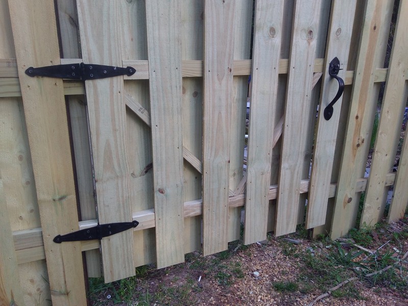

Finally, today I built the gate for the hinges and thumb latch I made a couple months ago.  Got it installed, and works just fine.

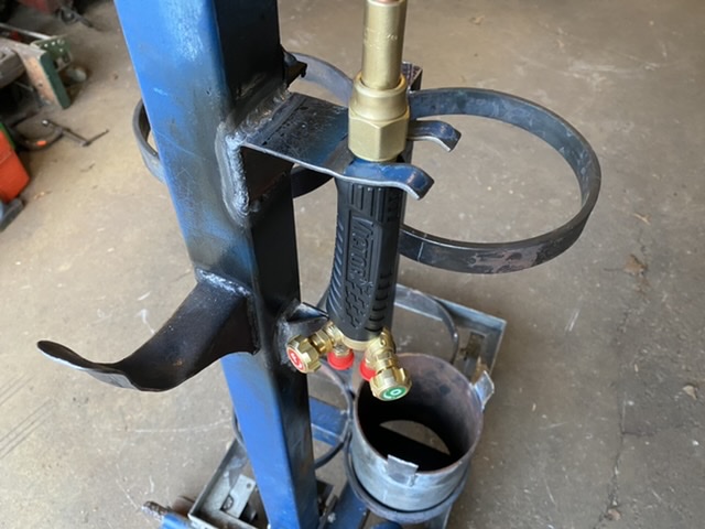

Finished the bracket on the torch stand.

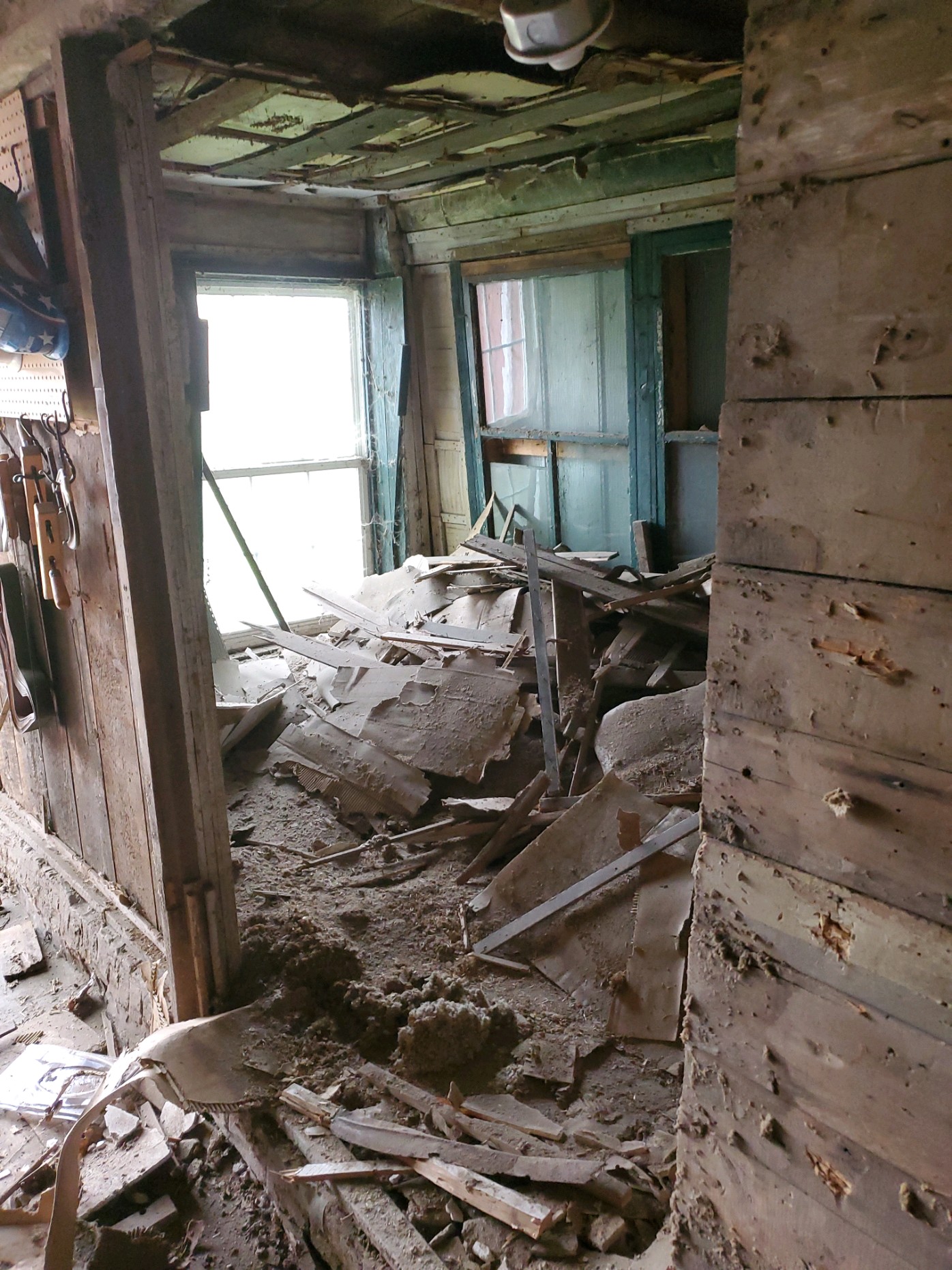

My barn has several small rooms in it.   Three of them are chicken coops.  I started tearing them out today.  I pulled wooden crate, followed by particle board with a wall paper pattern, followed by drywall,  then tar paper, 1 by furring strips, and cardboard.  This area is going to turn into a stock room.  I am going to salvage a bunch of the wood for various other projects.
