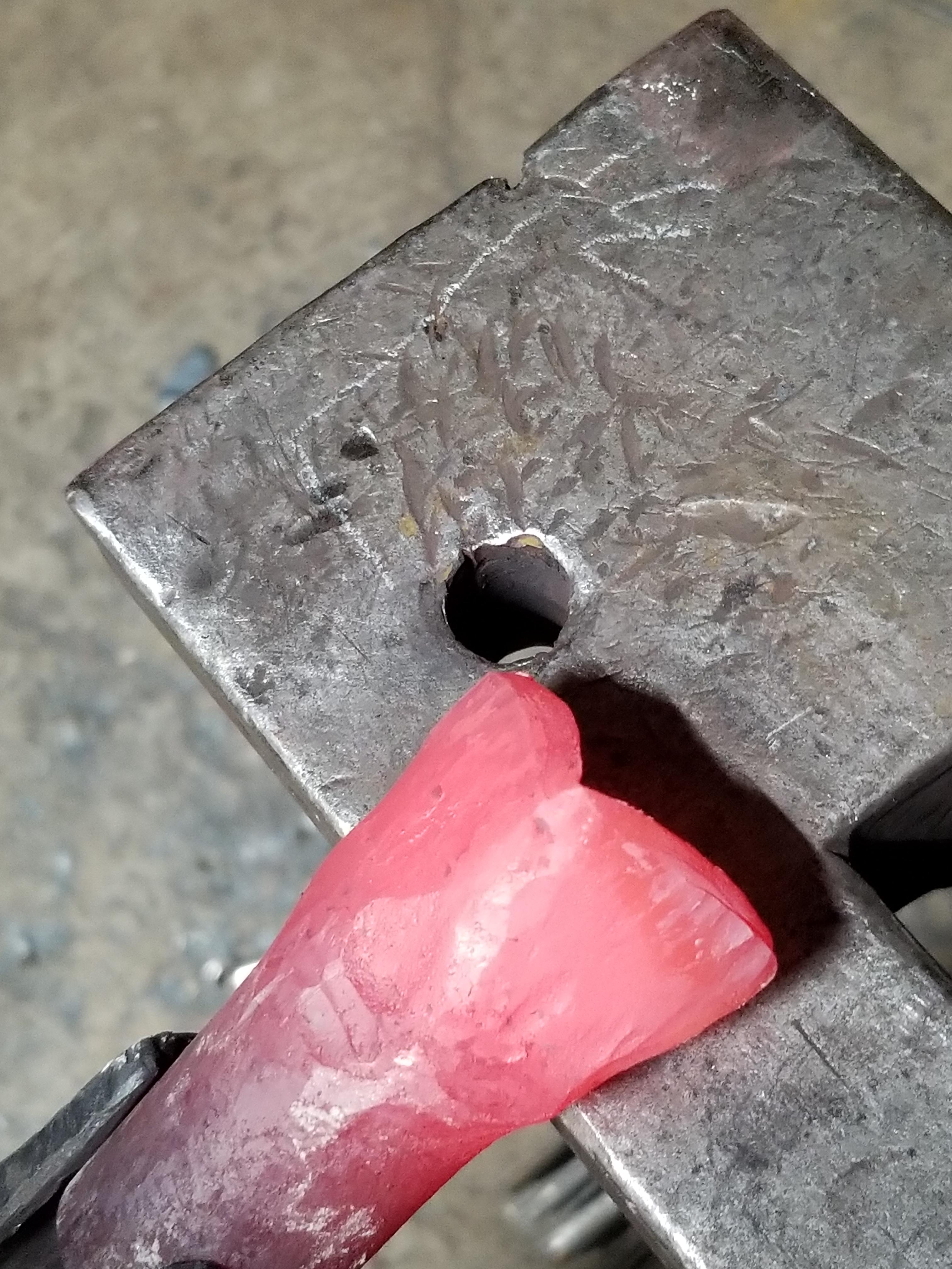

  20. Here is a photo of my first feather, I ended up doing another later that is even better but can't find the photo. The tip was ground to make a stiff quill pen. It worked with ink, but not really well.
