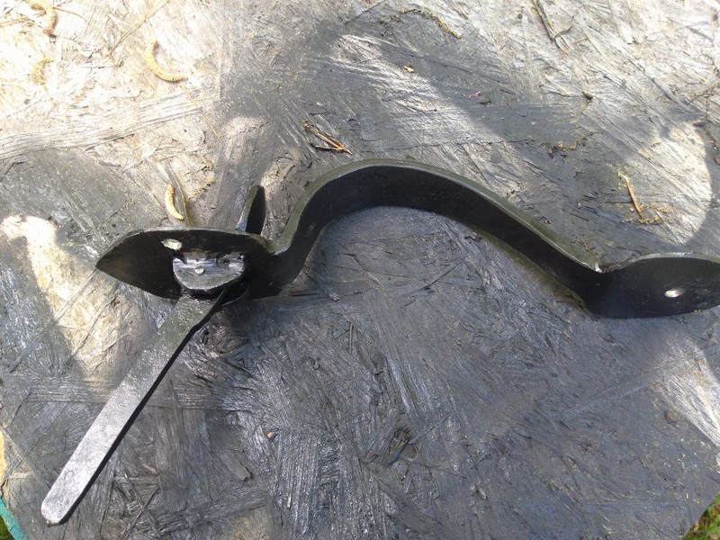

bluerooster Posted April 18, 2021 Share Posted April 18, 2021 11 hours ago, Jobtiel1 said: ...., how do you plan to attach the "thumber" to the front latch, have you left a thicker piece behind the finial, or do you attach it in some other way? Two pieces of flat steel, welded on. Through which is a hole for a rivet. I tried to slit and fold the hole for the two parts on the back side, but that didn't work out too well. So I flattened it all back out, and welded two pieces, on on each side of the hole, on the back side. I need more holes in my homemade swage block. And as sure as I write this they were welded with fire by the forge. Quote Link to comment Share on other sites More sharing options...

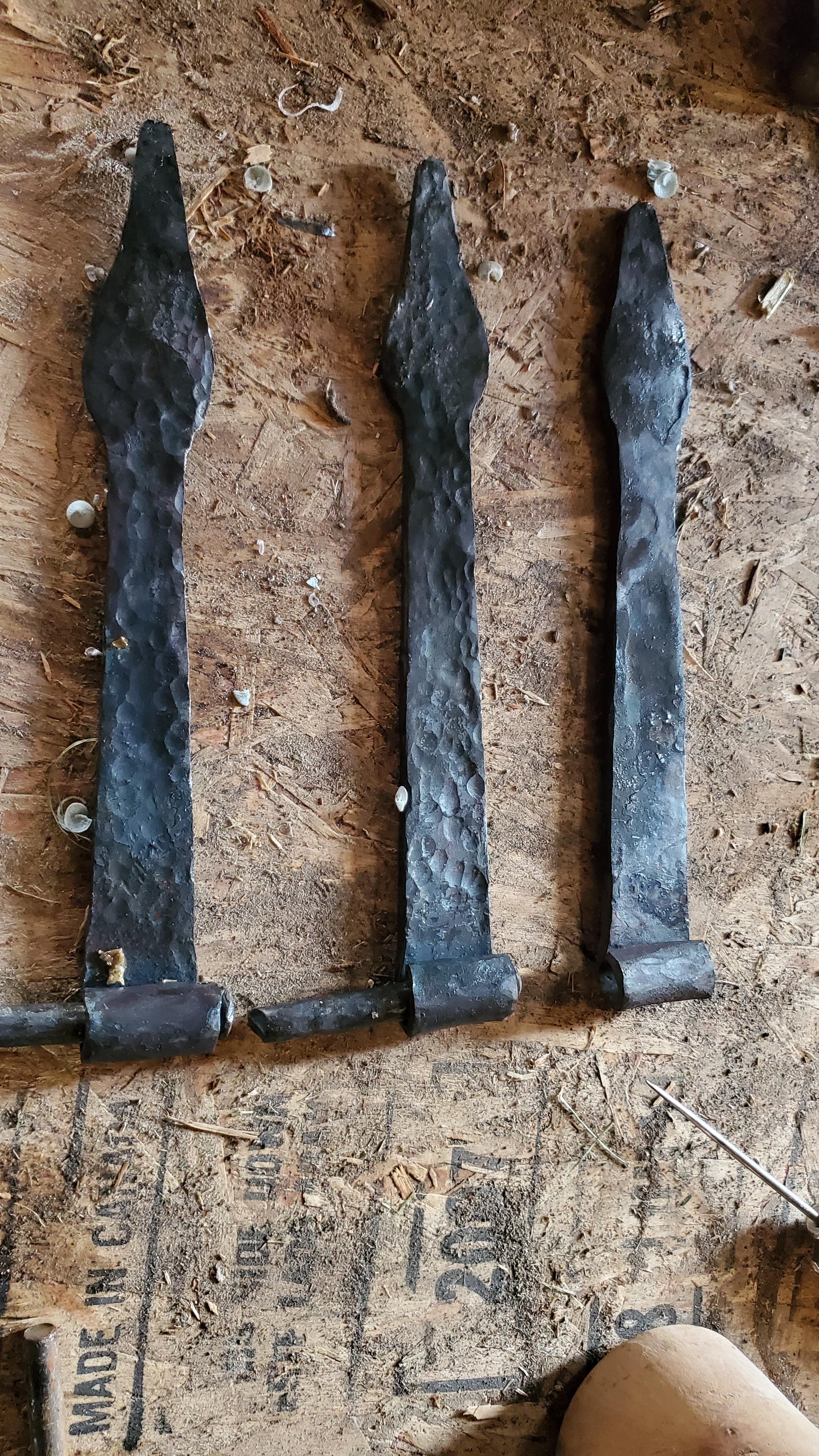

Chad J. Posted April 19, 2021 Share Posted April 19, 2021 Started in on a set of hinges for the shop door I'm building. My barn has no good way to be secured currently and I have a bunch of tools to put in it. The site is going to be 2 x 6 dowel pinned together and sealed. These hinges, a handle I'm forging then riveted steel straps going across the door. The swinging garage doors are going to be another challenge but one at a time. Quote Link to comment Share on other sites More sharing options...

Jobtiel1 Posted April 19, 2021 Share Posted April 19, 2021 Bluerooster, that's an interesting approach, I am also in the process of making a thumb latch, next time I'm in the shop I'll take a picture of how I'm doing it. Chad J, did you forge weld in the pintle pins? Or did you pressure fit them or something else? ~Jobtiel Quote Link to comment Share on other sites More sharing options...
Chad J. Posted April 19, 2021 Share Posted April 19, 2021 Pressure fit them. I am please because this was my first time trying to duplicate a pattern, even as simple as the design is. Quote Link to comment Share on other sites More sharing options...
Jobtiel1 Posted April 19, 2021 Share Posted April 19, 2021 They look great! I'm also planning on forging hinges for a new shed, currently looking at what approach fits my skills and the shed the best. ~Jobtiel Quote Link to comment Share on other sites More sharing options...

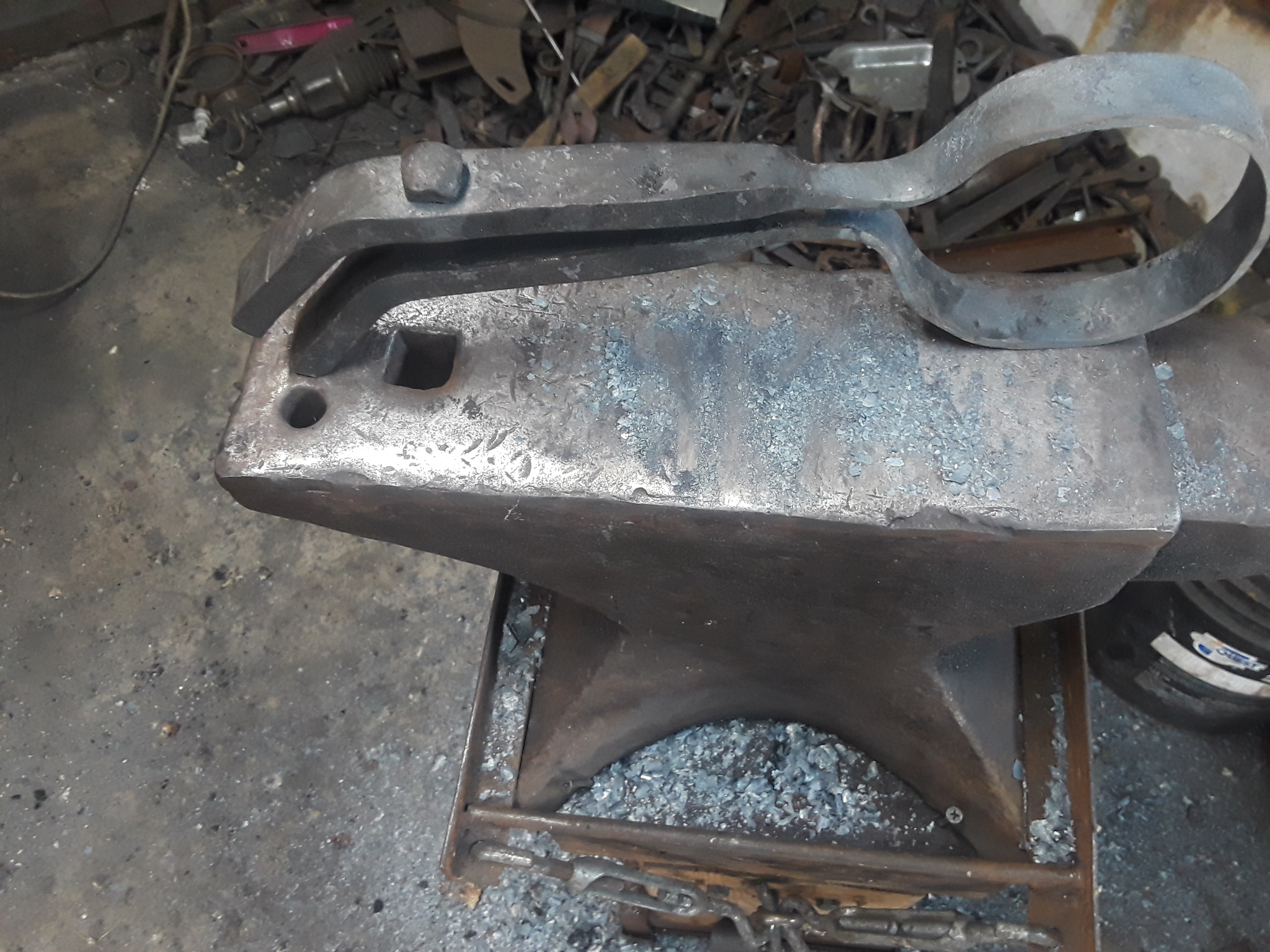

Paul TIKI Posted April 19, 2021 Share Posted April 19, 2021 I got to spend some time forging yesterday. Another leaf. It went faster than previous tries, so progress. I figure I could be pretty good at them if I do another 196. I'm also getting better at keeping the fire at a consistent heat. I would like it to be hotter, but I'm consistent enough to be able to work. good enough for now. I also improvised a holdfast for my improvised anvil that worked fairly well. Since I have a monolithic chunk with nothing like a pritchel hole or hardy hole, I can't use a traditional holdfast. What I ended up doing was taking an 8 inch C-clamp and clamped it to the anvil. I clamped it about 2 inches down from the face so there would be a "loop" and I could pivot it up out of the way when not needed. If I knew it was going to be needed I would make sure it was tight, put the piece through the loop and swing the loop of the clamp down to where it would hold it firm to the face of the anvil. It made adding the "veins" on the leaf much easier. It also meant I could punch holes in some things I am making for in house cat gates (The wife has too many cats and we occasionally need to separate them) I also got to try my hand at re-doing the glazing compound around a 100 year old window. Patience is a virtue on that. You have to do things slowly and methodically so as not to break the glass. 14 individual panes. I'm glad we only have the one window like that. It's a picture window for the living room. It's pretty, so we are keeping it instead of replacing it like we did with all the other windows in the house. Once the compound sets It will be time to paint the wood. I think maybe adding a single large pane in front of the window to add some protection and increase the insulative value. Quote Link to comment Share on other sites More sharing options...
Frosty Posted April 19, 2021 Share Posted April 19, 2021 Using a C clamp that way is a good idea, very good. You can really tighten the screw to hard to push by hand and tap it down or up with the hammer. Not getting carried away and BEATING on it of course. Another thought regarding your window. In winter we seal our windows with clear plastic sheeting that uses double sided tape around the frame. Once the plastic is attached to the tap you use a blow drier to heat the sheet and it shrinks tight. It's really clear to start but attracts dust and it gets cloudy before we take it off. However if you put it on the inside between the mullioned window and the single pane it would be protected from dust while providing triple pane insulation for the house. Hmmm? Frosty The Lucky. Quote Link to comment Share on other sites More sharing options...

bluerooster Posted April 19, 2021 Share Posted April 19, 2021 11 hours ago, Jobtiel1 said: Bluerooster, that's an interesting approach, I am also in the process of making a thumb latch, next time I'm in the shop I'll take a picture of how I'm doing it. Chad J, did you forge weld in the pintle pins? Or did you pressure fit them or something else? ~Jobtiel Here it is assembled. Quote Link to comment Share on other sites More sharing options...

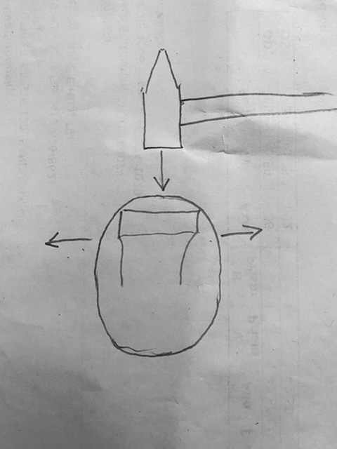

JHCC Posted April 20, 2021 Share Posted April 20, 2021 They’re all made from flat bar, bent by eye the easy way. The four small ones are 1/4” x 1”; the one large one, 1/4” x 1-1/4”. The small ones were bent hot, and the large one was bent cold (by hammering, using one of the bending tools from Schmirler’s Werk und Werkzeug des Kunstschmieds). I welded the ends together (FCAW), and then trued them up on the anvil. Here’s a fun trick: if a ring isn’t perfectly round, some parts are going to be flatter than they should be, and some are going to be more tightly curved than they need to be. If you put the latter over the tail of the anvil with the bulge up and hit straight down, you’ll even out the curve. Repeat as necessary. If the curve is consistent and the width is the same in all directions, you’ll get pretty darn close to a perfect circle. Quote Link to comment Share on other sites More sharing options...
