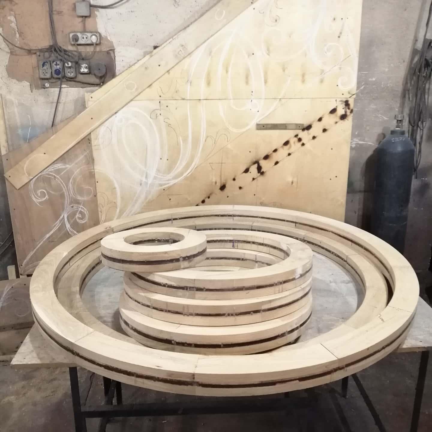

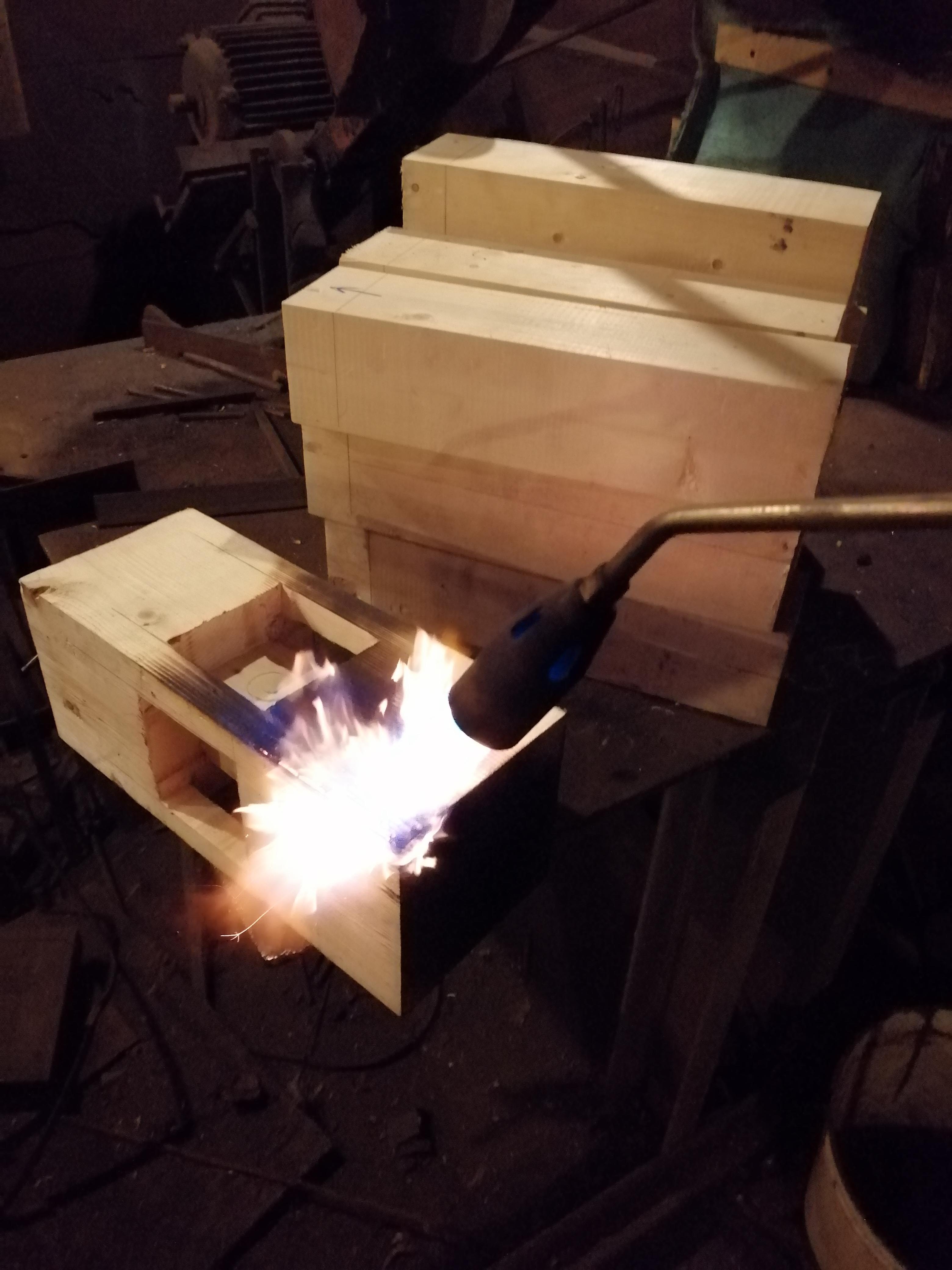

alexandr Posted January 14, 2020 Share Posted January 14, 2020 The work is in full swing. VID_20200114_210734.mp4 Quote Link to comment Share on other sites More sharing options...

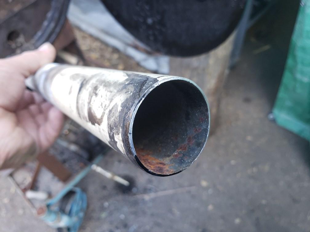

Anachronist58 Posted January 14, 2020 Share Posted January 14, 2020 On 1/14/2020 at 5:27 AM, jlpservicesinc said: Larger holes? Better spacing? Jennifer, One big hole straight out the end of the pipe, as shown. 2.86 times the previous opening area. The old tuyre was never intended for forging, and once I discovered my wood stove worked for forging, I have had a mind to replace it. Material is 1.410" ID x 1,490" OD, .040" wall welded steel tube. From one of those car port tent things. As you can see, it is consumable: In fact, it slides in and out to change the position of the hot spot. This tube also naturally aspirates and heats my steel when not being blown. Not much ash coming out, six scoops of charcoal fines in for the session, looks like fifteen scoops of charcoal made (net scoops). Who can keep up with all the great posts on this thread? Robert Taylor Quote Link to comment Share on other sites More sharing options...
