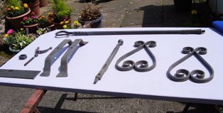

  10. You may find the ones with the handles at 90 degree to the opener "blade" awkward to use. While using these as a practising too, The use of a flatter on the opener blade would also help in removing the hammer marks to inmprove the finish, and , if the scrolled ends were more tapered to a point, they would IMHO look somewhat better., Look forward to seeing them all completed and the progress you will no doubtedly make as you get through them. Enjoy.

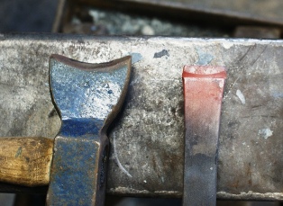

  15. Thanks all, glad it is being found useful.

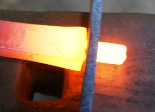

  16. Apologies for appearing to be patronising in this response, but I am just trying to go through the making process involved in producing this type of joint in a finished project, and avoid some of the pitfalls it can involve, a little forethought and planning can save a lot of time and mistakes.This is the method I use, others opinions may differ. Tenons can be round, square or rectangular depending on their purpose. Consider where it is going to be used, and how best to manage it before starting. This will depend on its purpose in the structure it is to be used in. Plan a logical way of making it for ease of forging process, accuracy in finished item, and then assembling for final riveting in situ. EG if you punch and drift a bar for the mortice, then its overall length will alter, not much for a punched hole, more for a lit and drifted hole. For a tenon, you allow that the volume of metal in the tenon means the length to start the incising is much shorter than the required finished length, excess may be cut off, but it is wasted time and effort if you make them too long. This is my take on making a simple arm to backplate item. I am going to use a square tenon as I don’t want the finished piece to be able to swivel. These are two such items I used them on. Mark out the piece where the mortice is to go, (use a centre punch to mark its location) You then have a choice to slit and drift, or punch to a size.(This gives the dimension for your tenon) Take a heat and punch from one side most of the way through (may need more than one) and when there is an indication on the back of the piece, punch from that location to remove the slug/pellet Note when you do this, use a bolster or some suitable item to support the material around the area being punched through, otherwise the bar may bend and trap the punch making it difficult to withdraw. Then drift to final size if needed. Finally flatter or hammer straight and allow to cool. Now make the tenon to fit into this hole. (You may or may not need to upset the end of the bar, depending on where the item is to be used as on a heel bar.) Tools being used, from left to right, Curved butcher, side set, set hammer. Heat the end of the bar, and use the curved butcher to mark the shoulder all around for forming the tenon, the curved blade marks the corners of the bar. Ensure the blade is square to the bar's axis, and that the angle side is facing the short end of the bar where the tenon is to be formed, you can then turn the bar 90 degrees and continue marking all four sides, this leaves a crisp shoulder to work from Repeat this, deepening the cut until you are approaching the finished size required for your tenon. Now start forming the square tenon, use a good square edge on the anvil, using the side set start the tenon and either continue with this or if your hammer skills are good enough, forge the tenon to a near finished size equally from all four sides, using the existing hole in the backplate as a guide If the anvil edge is not a clean square corner, use a square block/hardie but note a sharp edge in the corners at the base of the tenon is not desirable, and ensure there are no hot shuts or cracks in the metal. This can cause premature failing and fracture later. You can then tidy up and finish forge the tenon and mating faces using the set hammer until the tenon fits into the hole in the plate The tenon should be central to all sides, ensure it fits and beds down nicely by monkeying/monkeeing it by using the backplate over a bolster,( swage block, hardie hole or in this case the pritchel hole) of an appropriate size to support the work adequately as it is being bedded in. Allow the bar to cool slowly, if not it may be hard when you come to saw it off to the required length. Assemble and mark out for rivetting, the rivetting allowance is approximately one and a half times the thickness of the tenon, and then saw off excess. When the item is finished ready for fitting, reheat the tenon and using the leg vice or some other suitable method to hold it, rivet the item into place, use light rapid hammer blows working all around the tenon and keeping it straight to give an even head, and maintain its squareness, you should be able to do this without having to reheat the rivet to finish, as it cools it should tighten further. The workpiece is then ready to be finished for whatever you need for its other working end, and you can mark it out using the tenon shoulder as a datum. When the item is finished ready for fitting, reheat the tenon and using the leg vice or some other suitable method to hold it, rivet the item into place, use light rapid hammer blows working all around the tenon and keeping it straight to give an even head, and maintain its squareness, you should be able to do this without having to reheat the rivet to finish, as it cools it should tighten further. Apologies for poor picture quality, and I hope you find this useful.
  17. If you are cutting hot, you should not get a rebound, if you are, then material needs reheating. When you place a cutting plate under the workpiece, it may rebound then as you chisel until it is through. If you are cutting cold, then patience is the key, line up your chisel, hit, pause and then move chisel on into next position and hit again, Material may bounce on impact and is usually due to the workpice and the supporting item not being in perfect alignment, allowing top piece to spring/deflect when being struck.
  18. Either way is good, but if you don't hold the 90 degrees vertical to the cutting face and your half and half technique does not align at the same place, that is when you get a ragged edge and need to address the finish, also you can end up with different width strands, For beginers it is advisable to accurately mark out using a cold chisel, guide lines on all four sides on the centrelines of each side, and to the same extremities before attempting to slit, again the 90 degree rule is essential
  19. Thanks, whether you go all the way through, or half and half, make sure your slitter is at 90 degrees to the surface you are working on.
  20. I usually slit all the way through (onto a sacrificial plate at the last stage to prevent damage to the slitter) Then close up and resquare the piece, then repeat slitting again from this side. Resquare again, and use a thin drift over a suitable bolster to open up the slots prior to twisting and forming the cage. Open cage to desired profile (If you have any burred edges you can address the issue now, either use a mandrel, or file off any ragged bits) Twist to the required form This sample was on a 1/2" bar and not dressed at all.
