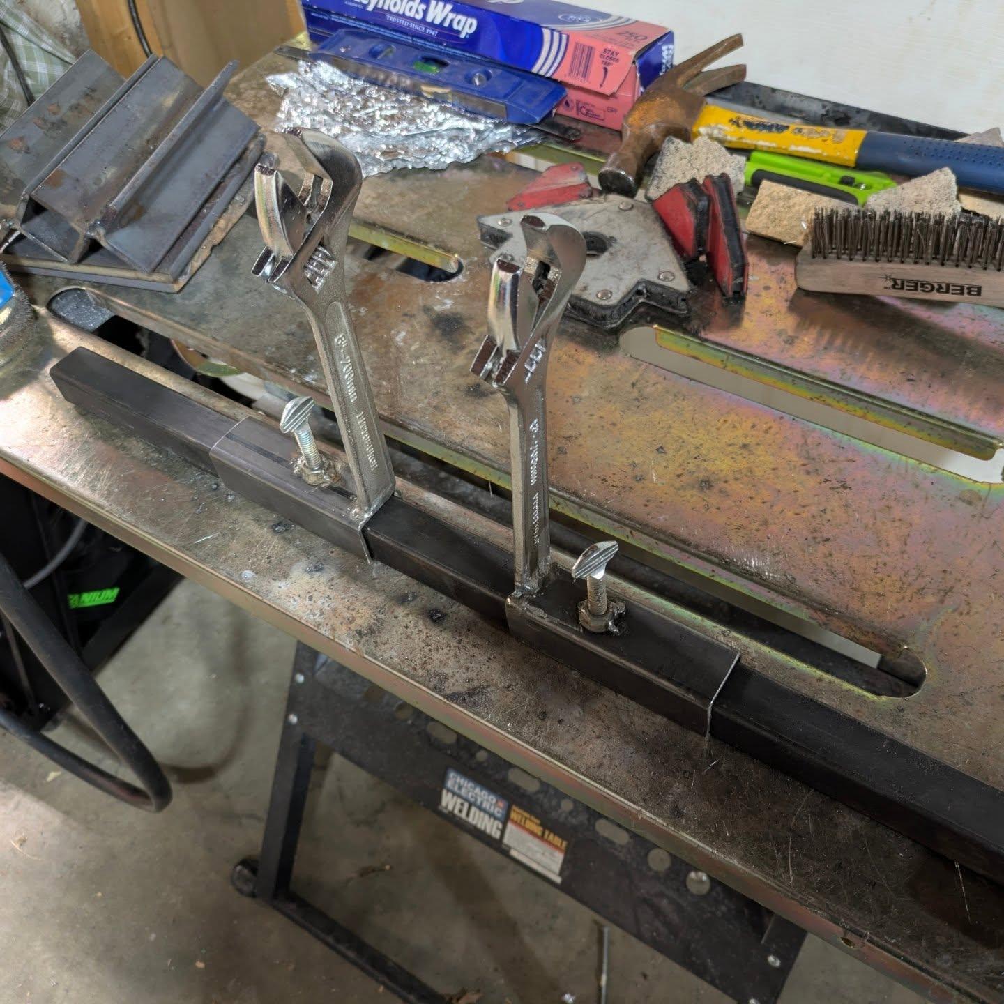

It took me over a year to finish this project!  It was 25°F when I got home. I discovered I had forgotten to replace the lid on my charcoal barrel and the charcoal is frozen solid, lol. I haven't yet patched the lining in my gas forge. And I don't have the forge built yet for using the rice anthracite coal I have leftover from a few years back. I really didn't want to stand out in the cold with the Oxy torch so I opted for fabricating in the garage instead.
Pic 1: finished. This is a jig to help make mirroring twists on a single bar. I might have to get another adjustable wrench and cut the handle a bit short so it can turn a full rotation in the center of the two stationary wrenches.

Shainaru, i used to use that 2 wrench thing to make those twists. What i do not like is that there will be a straight spot in between the 2 the width of your twisting wrench. I do the heat and quench method. Heat your stock and make the first twist, re-heat and quench up to the end of the first twist. Clamp in the vice in the same spot and reverse the twist. They come out with a nice sharp "V". That is provably the most common i do. I like to do 1/4 or 1/2 turns. They turn out looking like waves in the water i think so i call it a wave twist. The reverse twist is also kind of subtle i have found. People do not see it until they really look at it.
About those wrenches, they look chrome plated. It is quite the bad idea to weld on chrome and not as much but still a bad idea to get it hot. The fumes from chrome are straight up deadly. I would give those a good acid bath to try and remove the chrome.
Good Morning Shain,
Radius the edges of the Cresent Wrenches, this will stop the little marks from the Jaws. Same thing with the third Wrench.
Neil
Thanks for the tips Billy and Neil. I'll do that before using.
I have been doing them the way you explained, Billy. I did consider this would have an untwisted portion where the twisting wrench is placed. I thought I might try thinning down an adjustable wrench so it lessens that. Would still be a noticeable transition but less so.
Who knows, maybe I won't love this after using it. It that's the case, I will pass it on to another blacksmith!
I'd recommend making one or two fixed-size twisting wrenches, like these from Ken's Custom Iron:
kcinewphotos2024-15_1800x1800.jpg?v=1714501005
Ken's are made from 3/8" thick mild steel, but if you could get your hands on some thin leaf spring (1/4" or less), you could make one that would leave a smaller flat spot. You could also grind down the wrench just at the business edge of the notch, like this:
 Just make sure to smooth out any sharp edges before using, to avoid chewing up your workpiece.

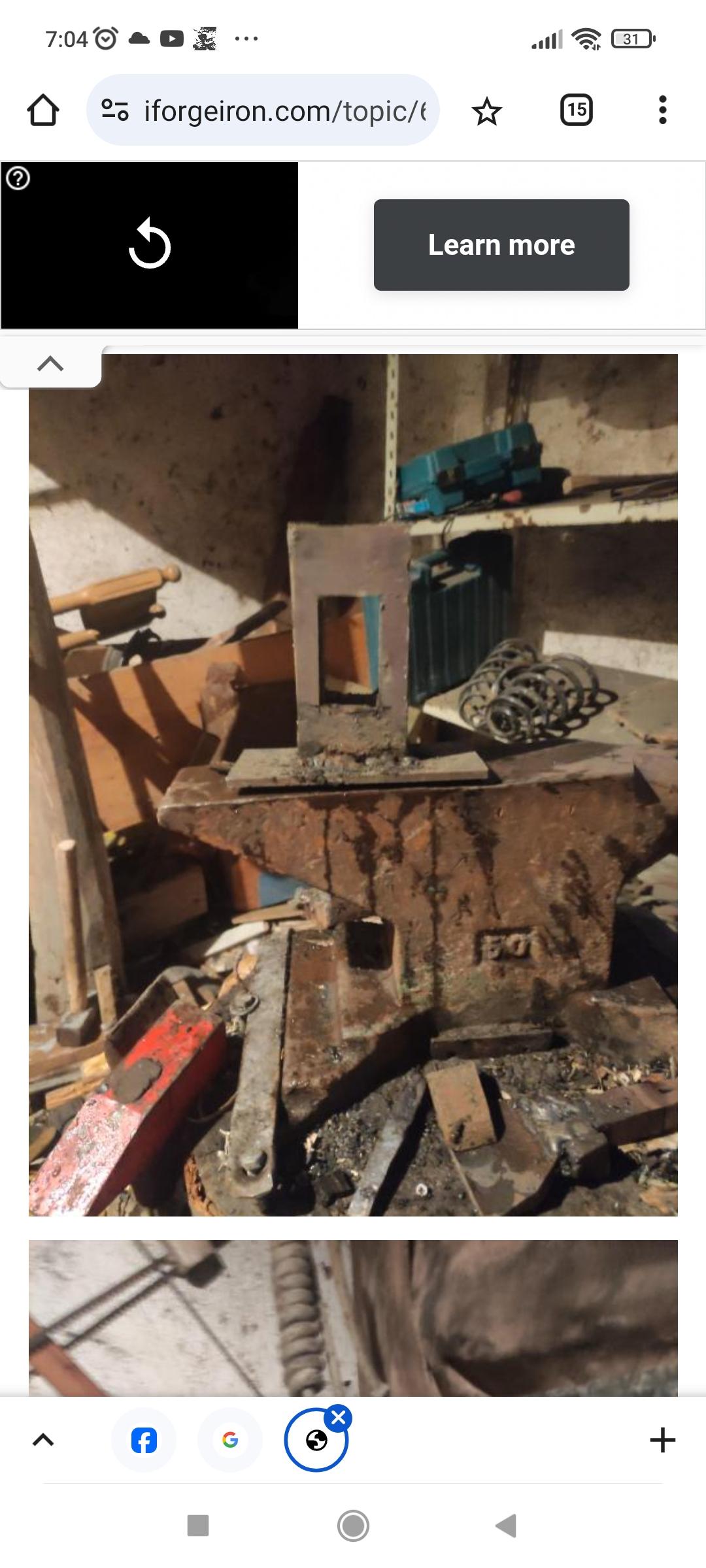

On 12/4/2024 at 7:14 PM, JHCC said:
Still no photo visible.

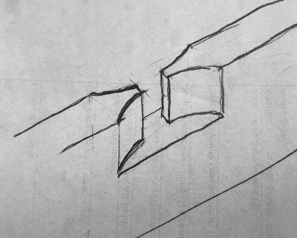

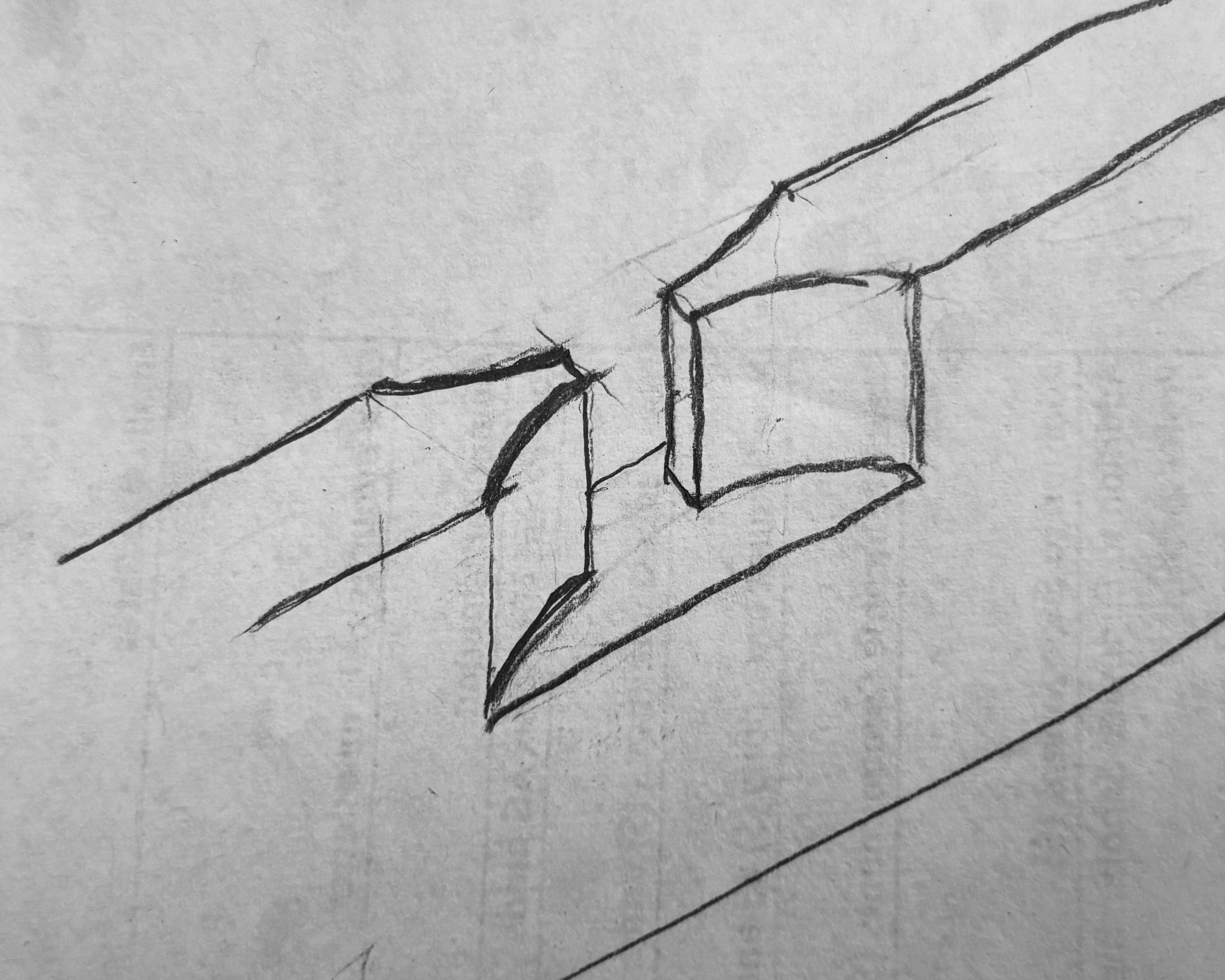

Literally it is standing on anvil.

While we had the art nouveau with fluid motions and shapes (whipline, zweepslag in dutch) inspired by japan and nature.
A free style, not very conform in "rules".
Sorry man, but the picture does not want to cooperate
This one

10 hours ago, natkova said:
This one
There we go. No idea why the other one wasn’t showing.

The more you thin the jaws of a twisting wrench the harder it is to keep perpendicular to your work.

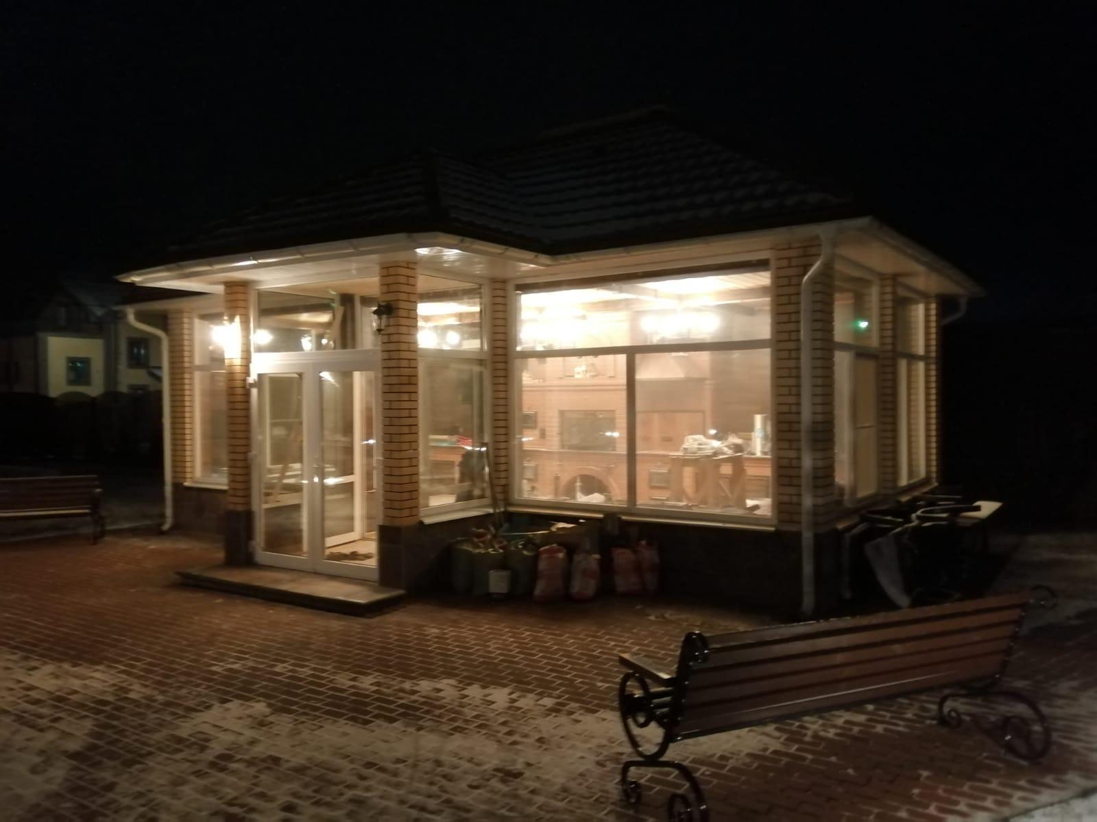

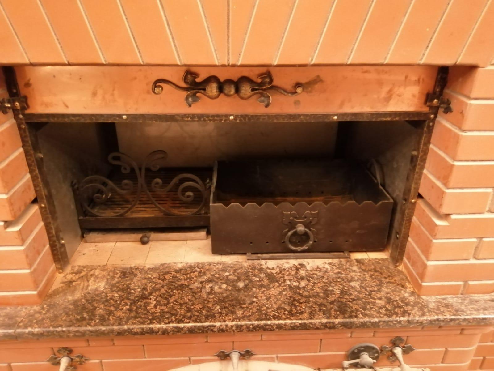

Finished the work that I started before Covid. Fireplace screen, umbrella, barbecue. Previously made chandeliers, cornices, furniture. The customer started another renovation, I couldn't take a normal photo.
