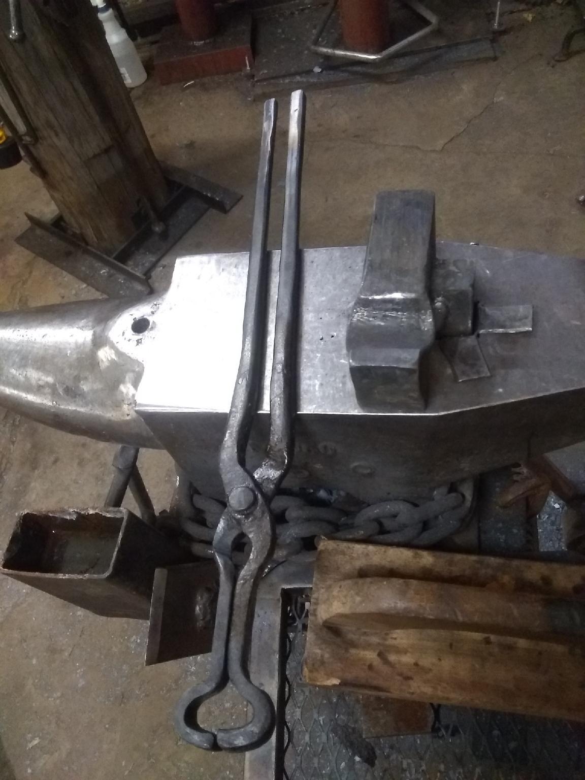

First attempt at pick up tongs finished a couple days ago. They do work for grabbing hot things that wind up on the floor. Not so sure if I'll use them much, just wanted to be able to make them.tongs2.thumb.jpg.62fef2b204d6ed84ba351b5761f269d0.jpg

I just bought a set of Pickups when I was at the UMBA fall conference at Centaur Forge.   I have used them constantly since.  Nicely made.

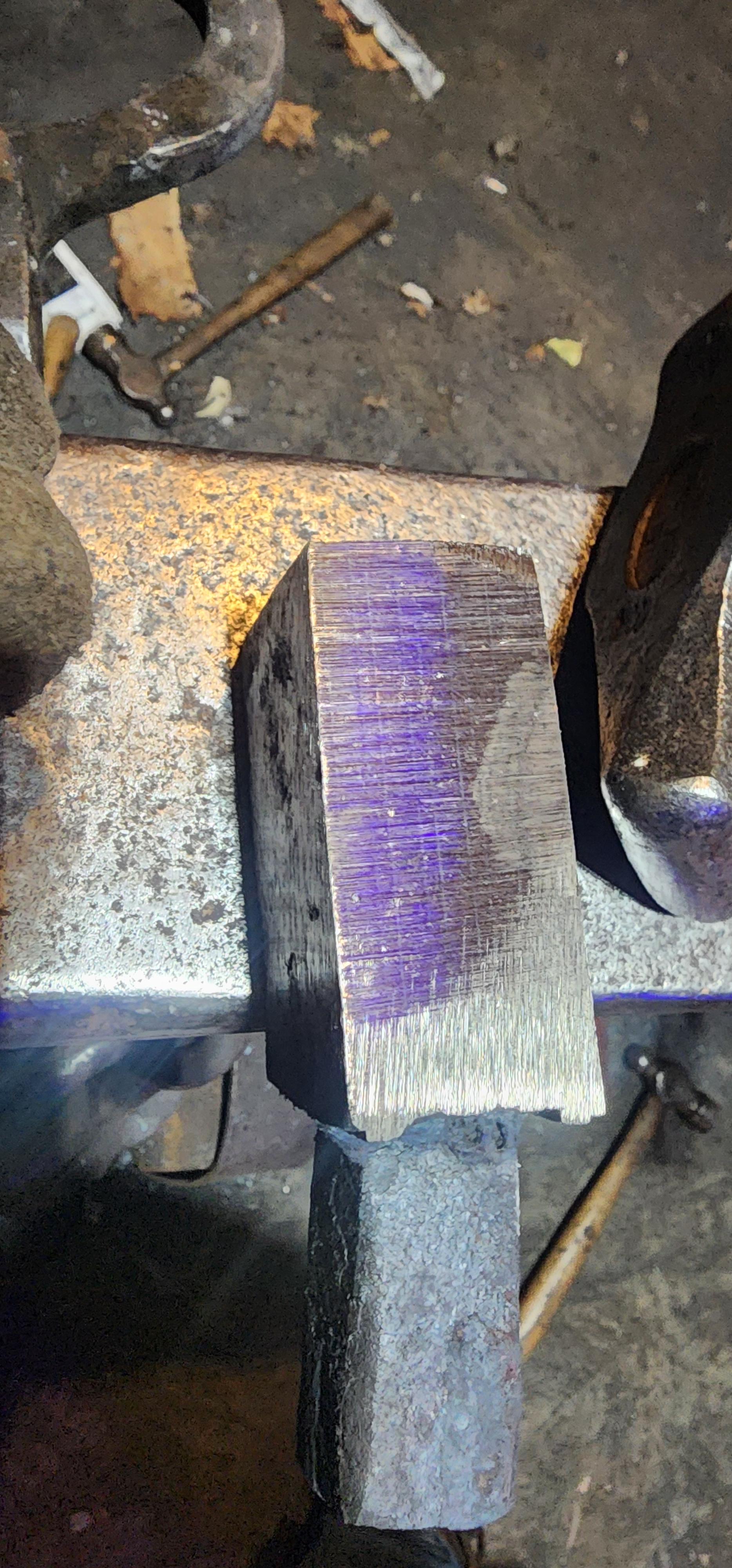

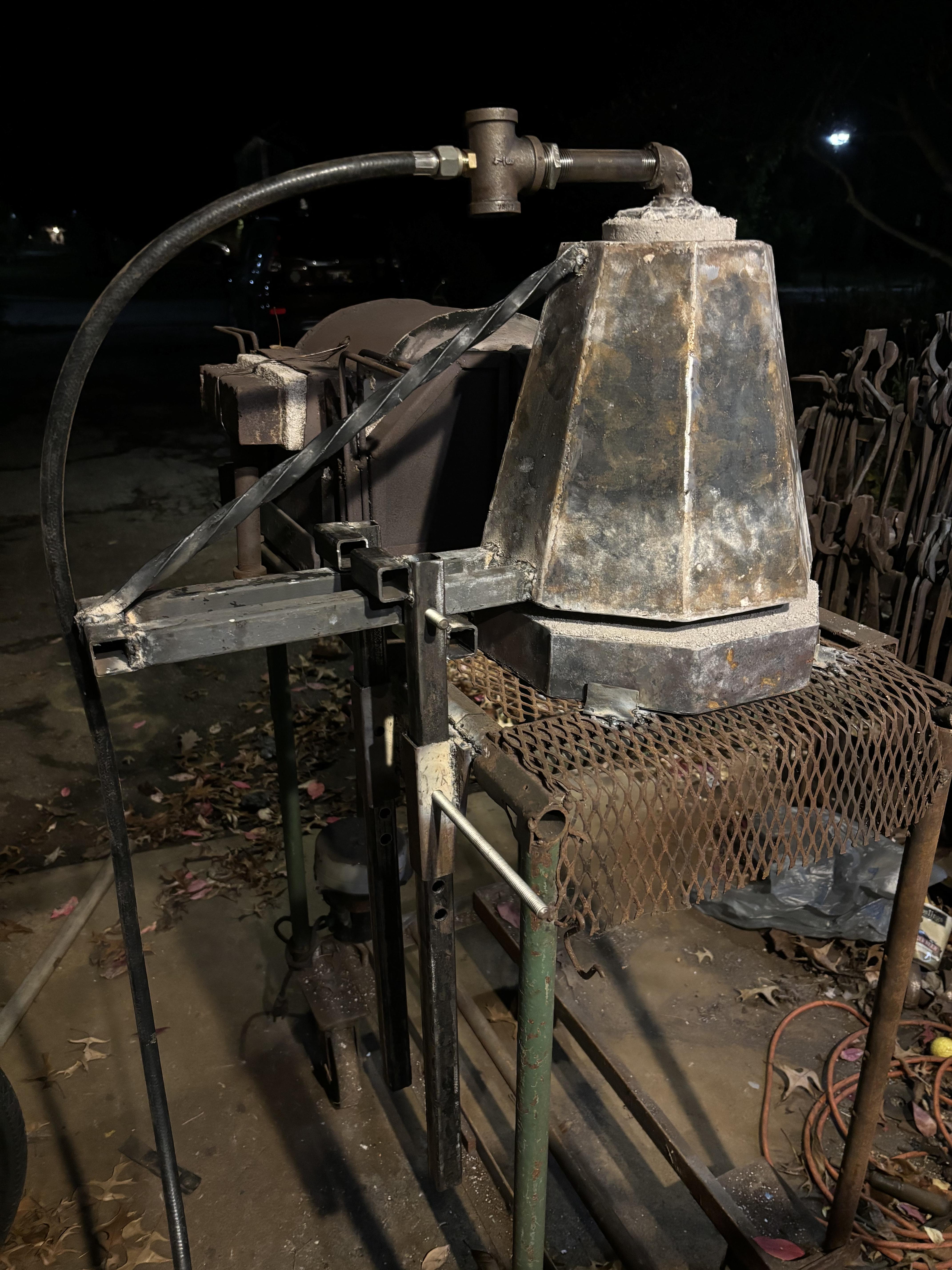

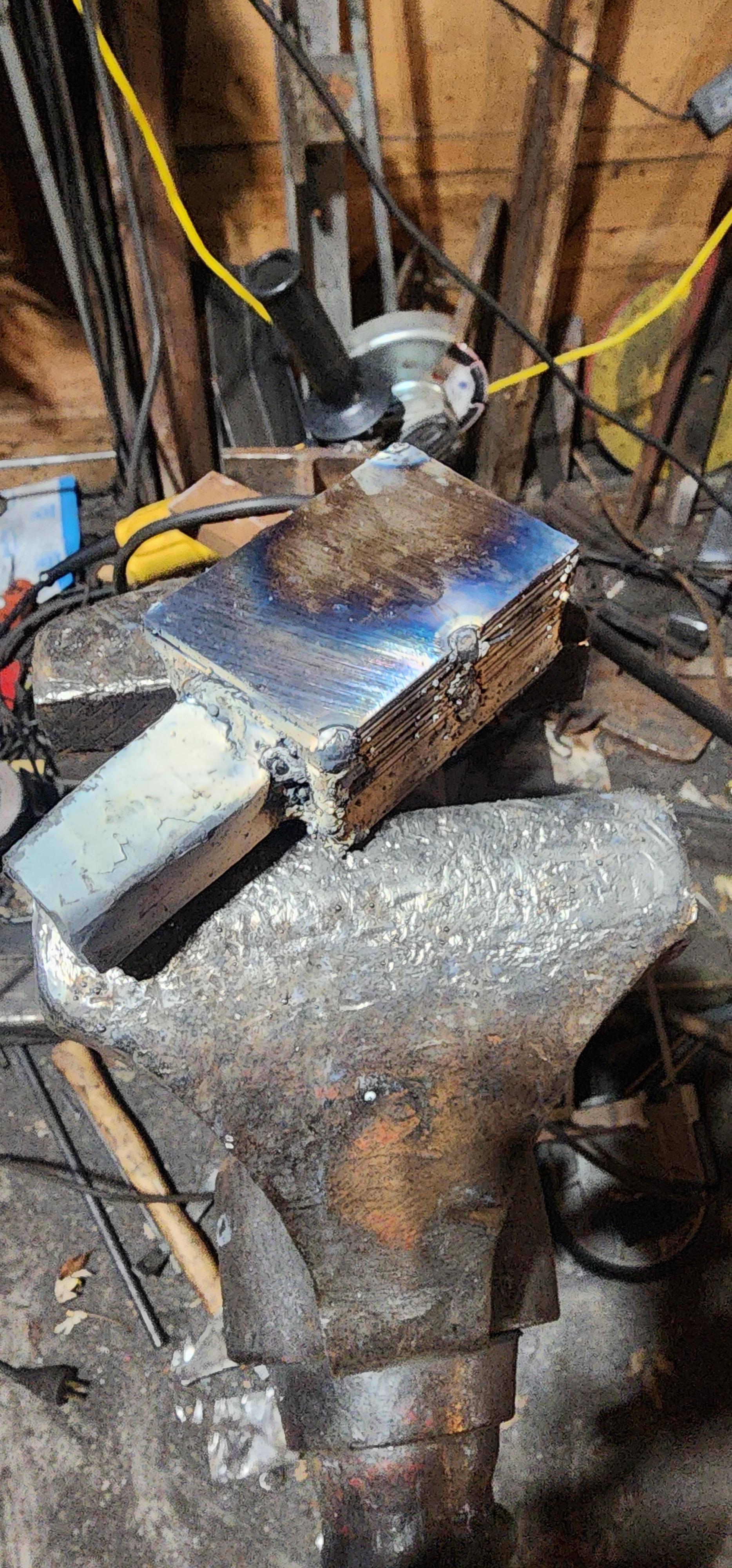

Finally got a successful forhe welded billet out of my propane forge.   To be fair I hadn't really tried before today with the new build.   I did upgrade the insulation to almost 3 inches of Koawool.  Maybe when it's going to be warm I'll put the refractory on as I planned.   Initial billet 11 layers 15N20 and 1095 hand set it.

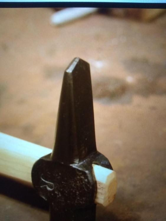

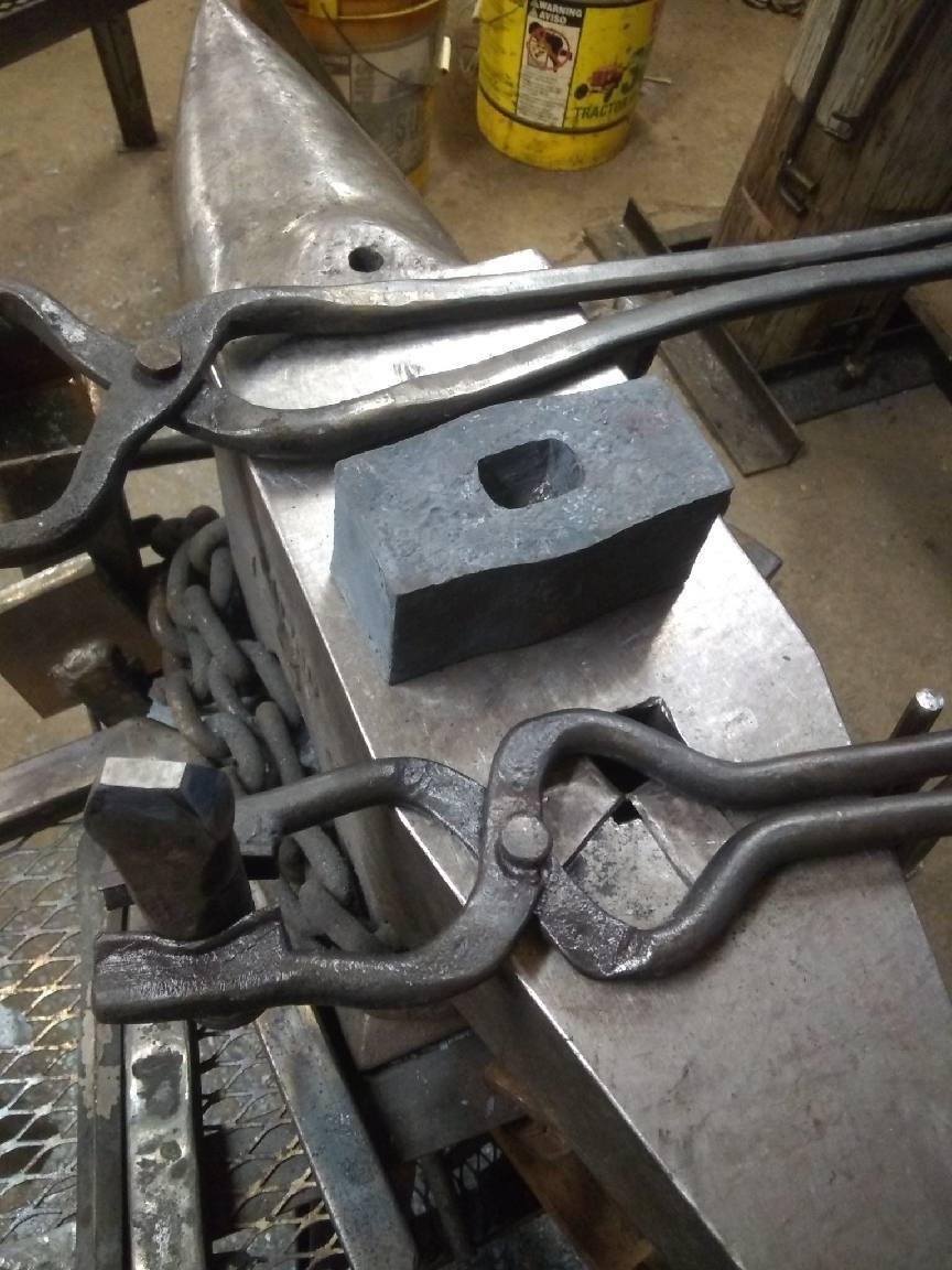

Thanks Rojo, Chad. I think I'll be making a hammer eye cutter with a sharper point. Maybee like the second picture. The railroad bolt I used is pretty tuff but taking a long time to knock out the plug.

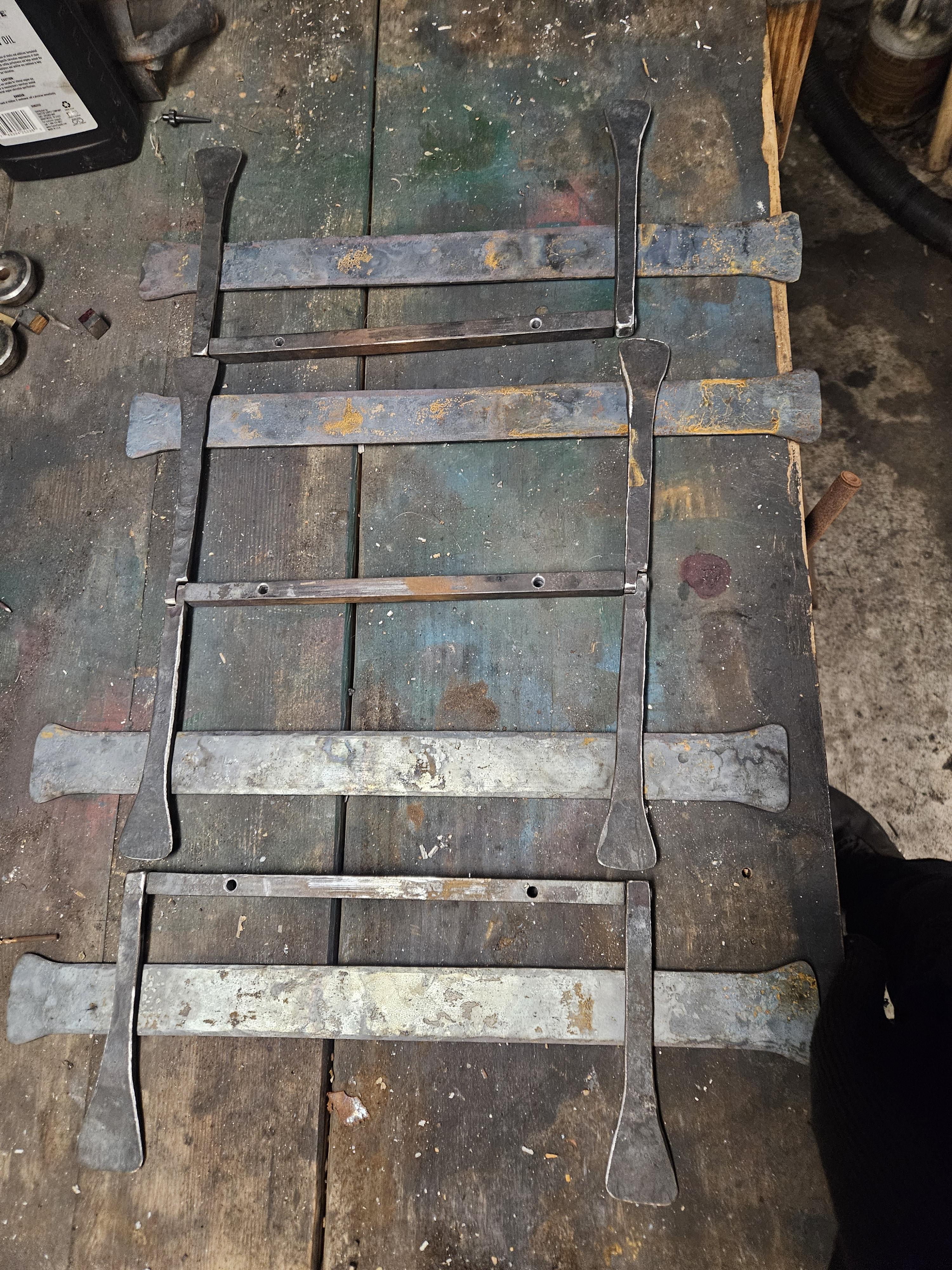

Got a few more pieces made for my cabinet/shelf thingy.
Hinges, still need holes and rivets (waiting to drill holes for when i have a bunch at once to do)Redid the backing plates to a bit smaller stock and a finial more like the hinges. Mainly because i discovered my others were to short.

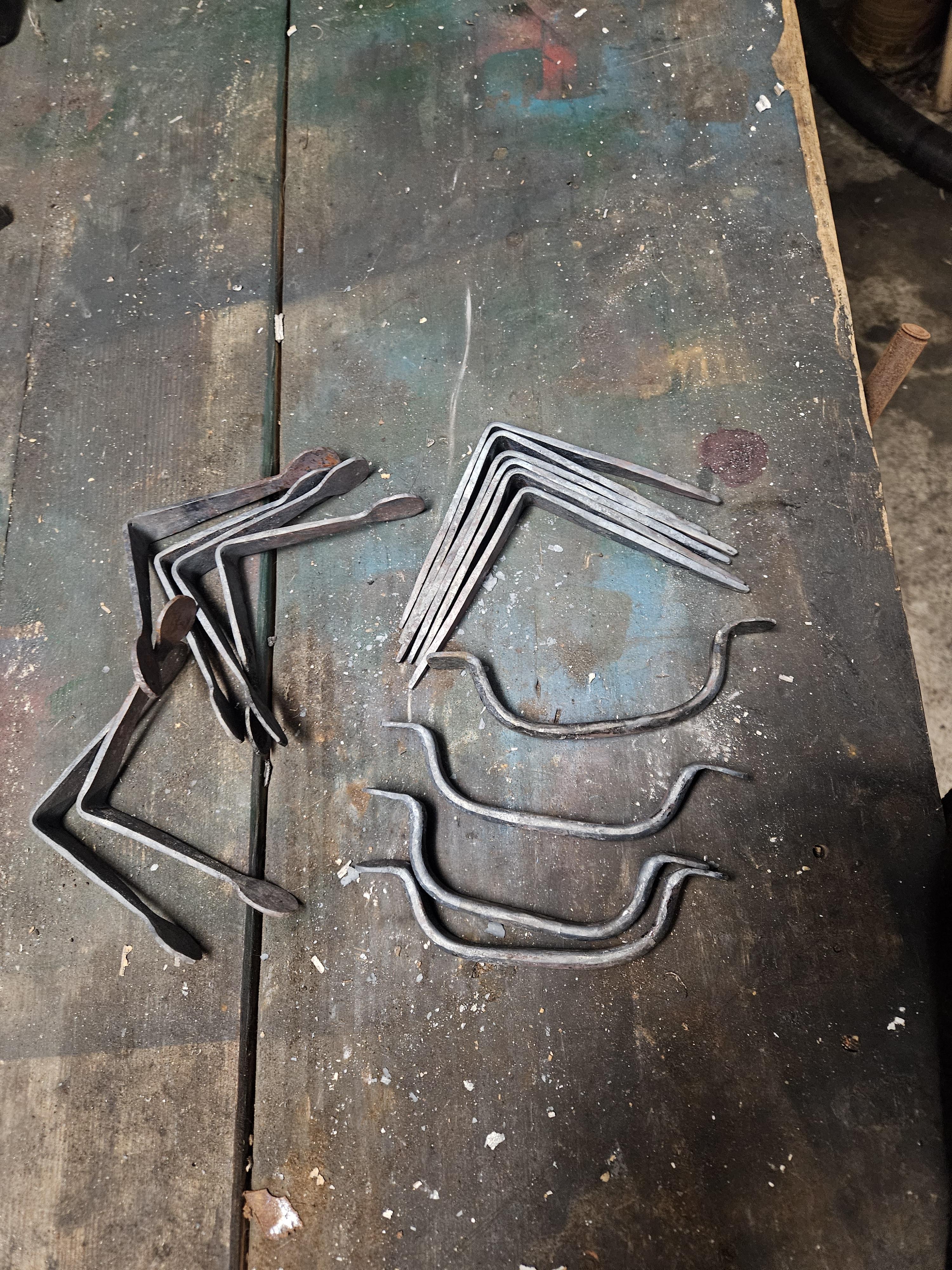

"L" brackets and handles. I am not using the ones with the round ends. Those were my first thoughts but nothing else will be rounded like that. So again switched gears on them and went with something more matching. Also still needing holes and a bit of file work.

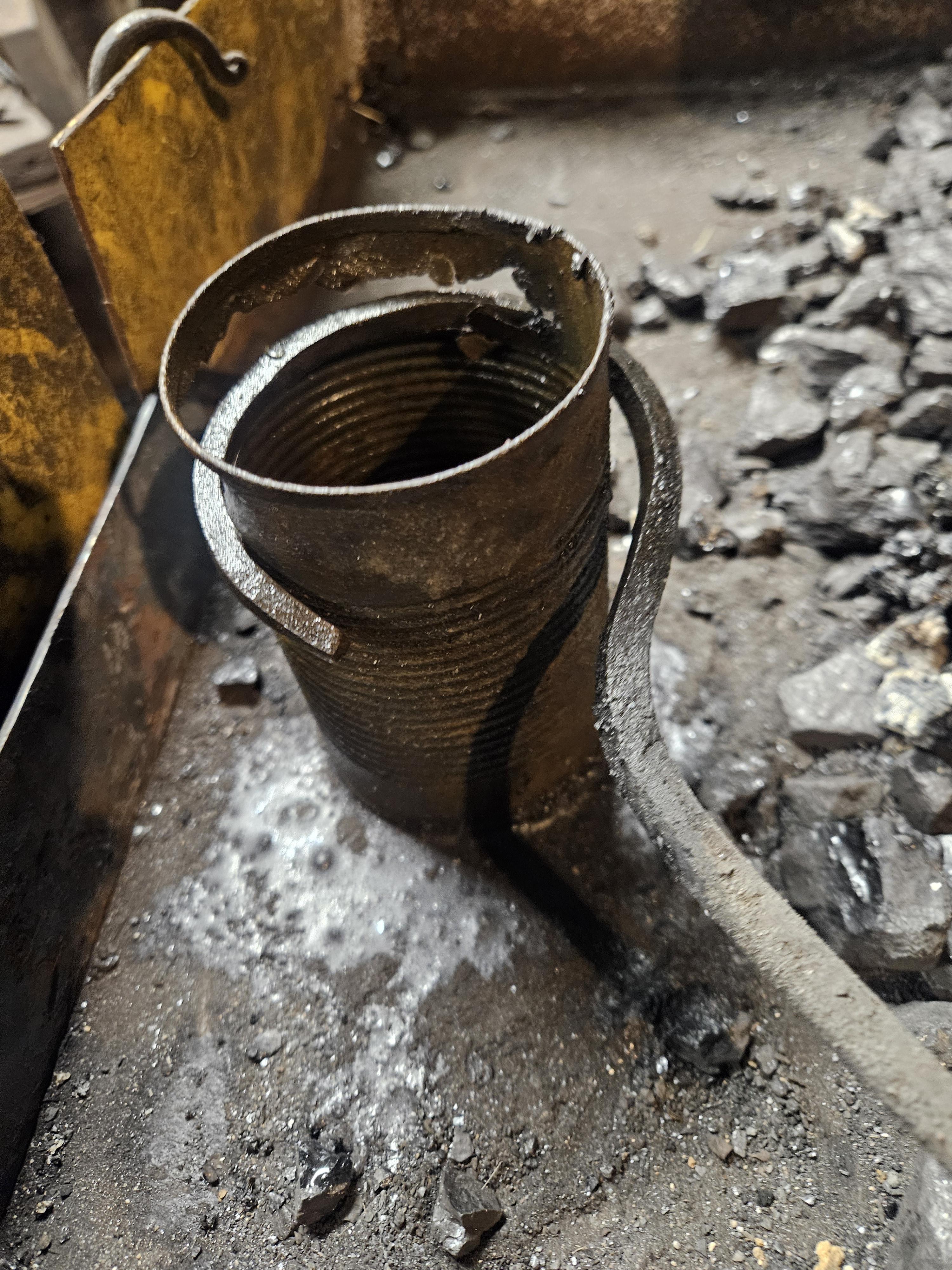

There comes a time in life when retirement is in order. So after years of faithful service i have decided to retire my watering can. I figured it was time after my 8th or 10th time fishing it out of my slack tank.  Now i just need to eat some veggies to get a new one.

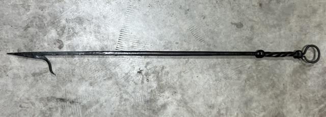

I had a request for a basic fire poker over the weekend. I guess I’m not so good at basic…IMG_0253.jpeg.7656ee1ffb7d8a6eb620cc9f26bca47a.jpeg

Non-blacksmithing folk will think it is basic, even if we know better, lol
Looks great. Are those collar welds on either end of the twist?
Yes, collar welds. 3/8” collar material on 1/2” square. Forged to octagon below the collars, tapering down to 3/8” square… taper could have be better.

Very nice.
I had an exercise in humility in the forge today so I'm just going to bask in your accomplishment, lol
Yeah, you gotta tone it down for basic David. Looks right handsome from here, I'd be proud to hang it by the fireplace.
