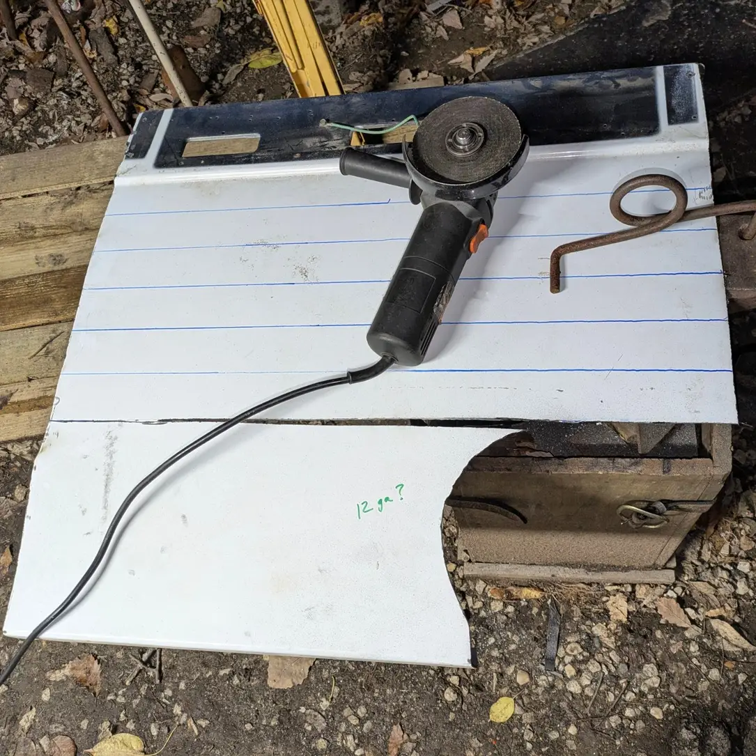

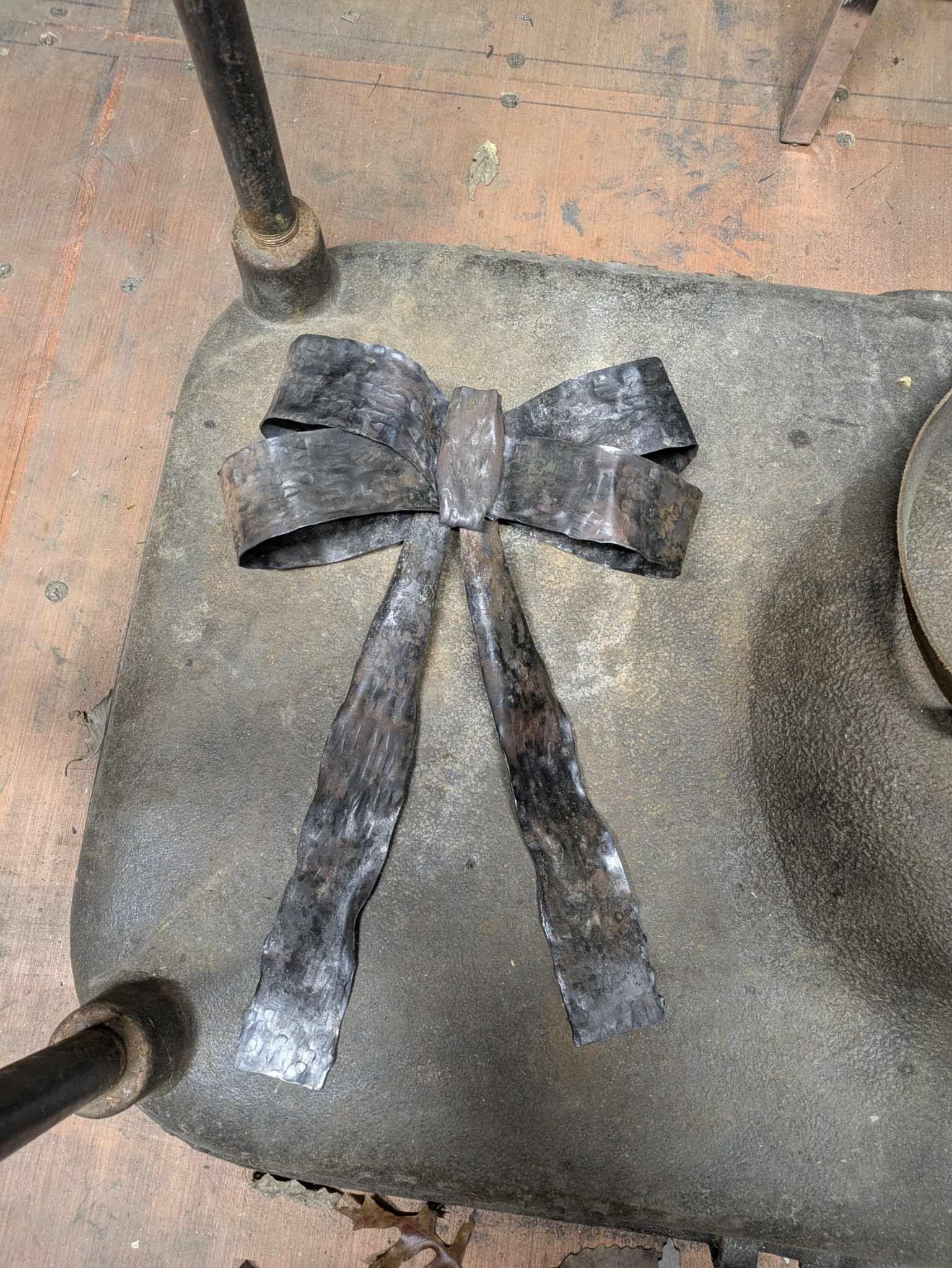

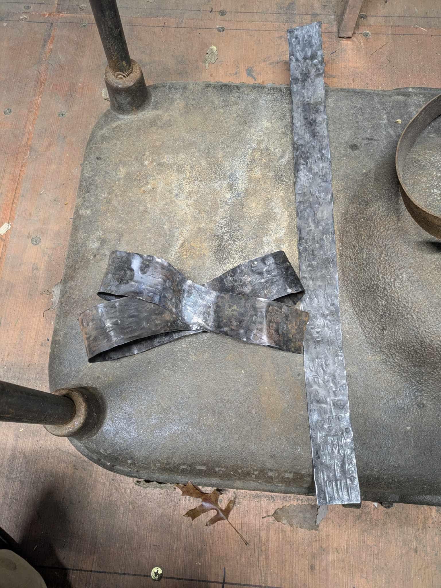

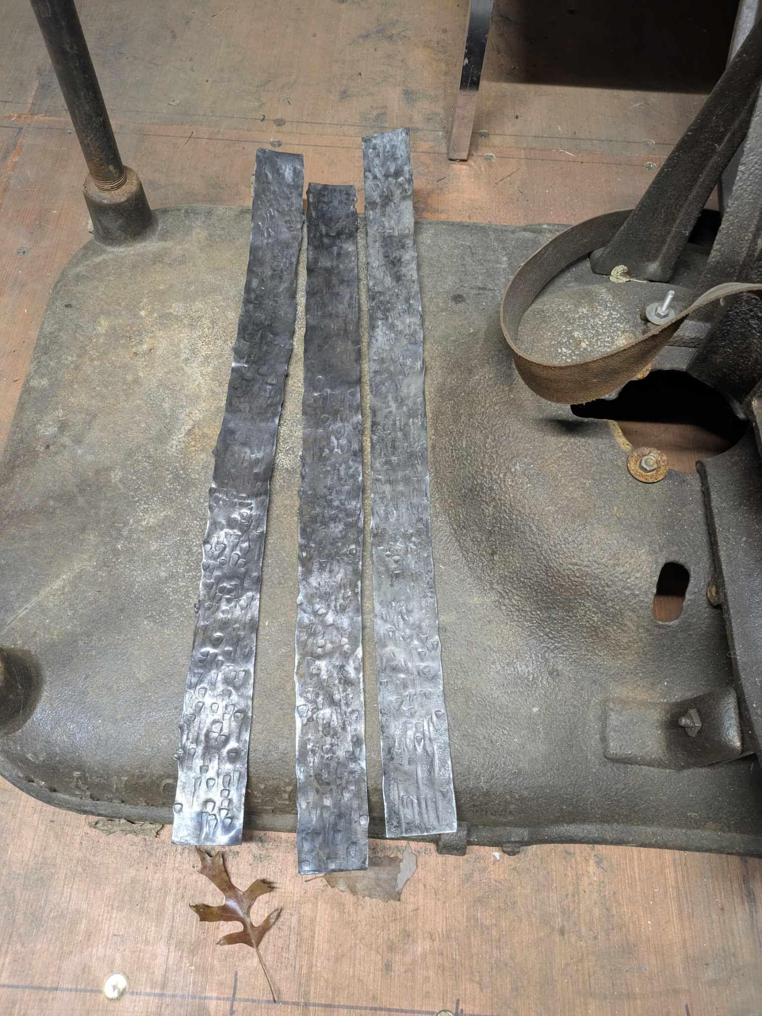

I've been working on a Christmas bow. I cut strips from an old dishwasher (I think?) panel. I got the further going and started texturing one of the strips until I noticed it was turning yellow - which means there's zinc in the coating. So I put on a respirator and goggles and used a grinder to grind all the coating off from both sides of all 5 strips. That took a few hours on its own.
I textured all the strips and cursed my apparent poor hammer control. My hand must have been weak that day because the hammer kept twisting so I'd end up hitting with the corner instead of the face of the pien. If I gripped the handle in a fist then it would stay straight on but that hand position usually results in pain so I'd switch back. I tried tucking my elbow to my side, since that can help when my aim is off. But my aim wasn't off, just the position of the hammer. Ultimately, I decided it was still texture so went on with it. I didn't want to cut and grind any more strips to start over! :lol:

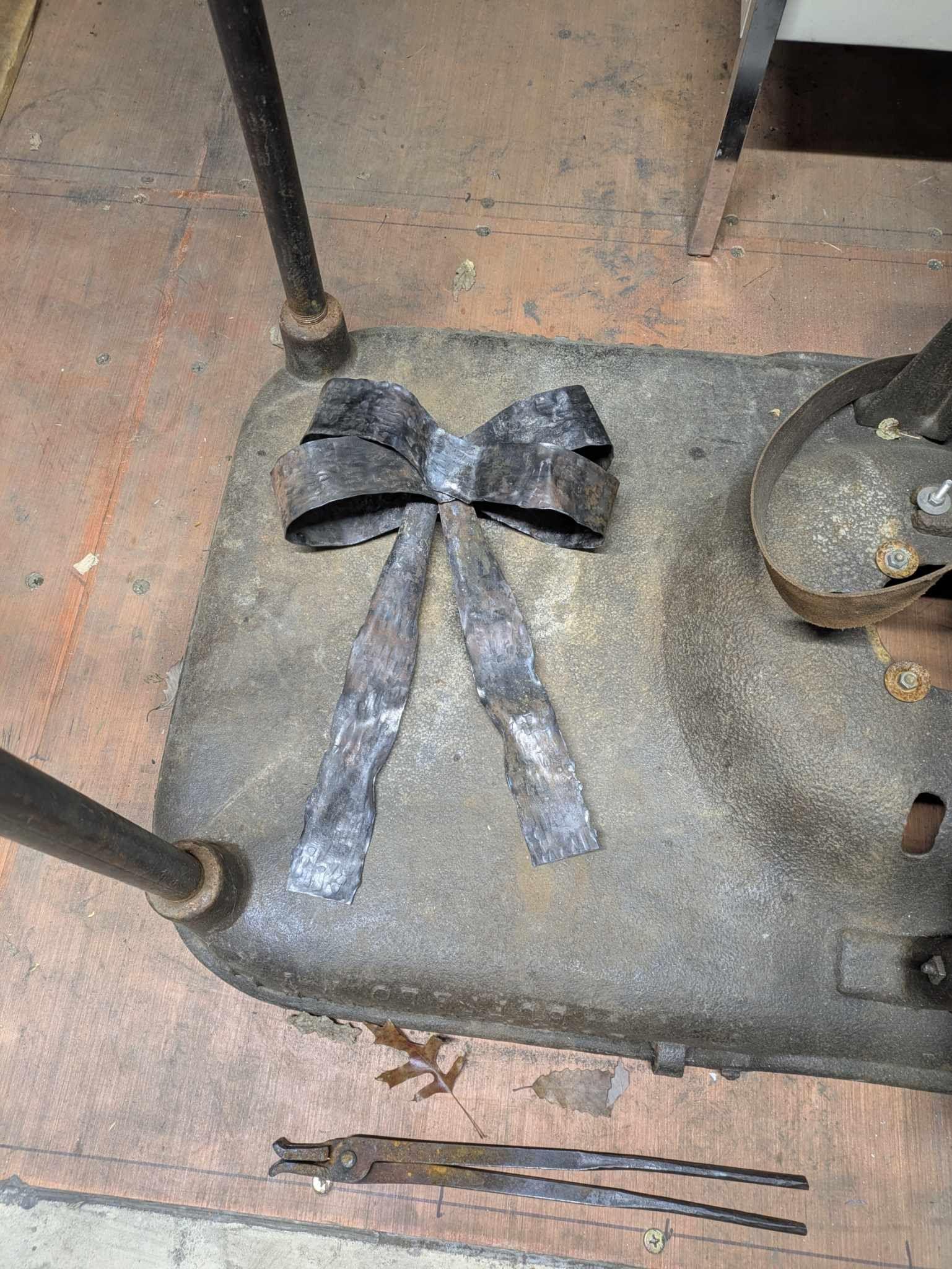

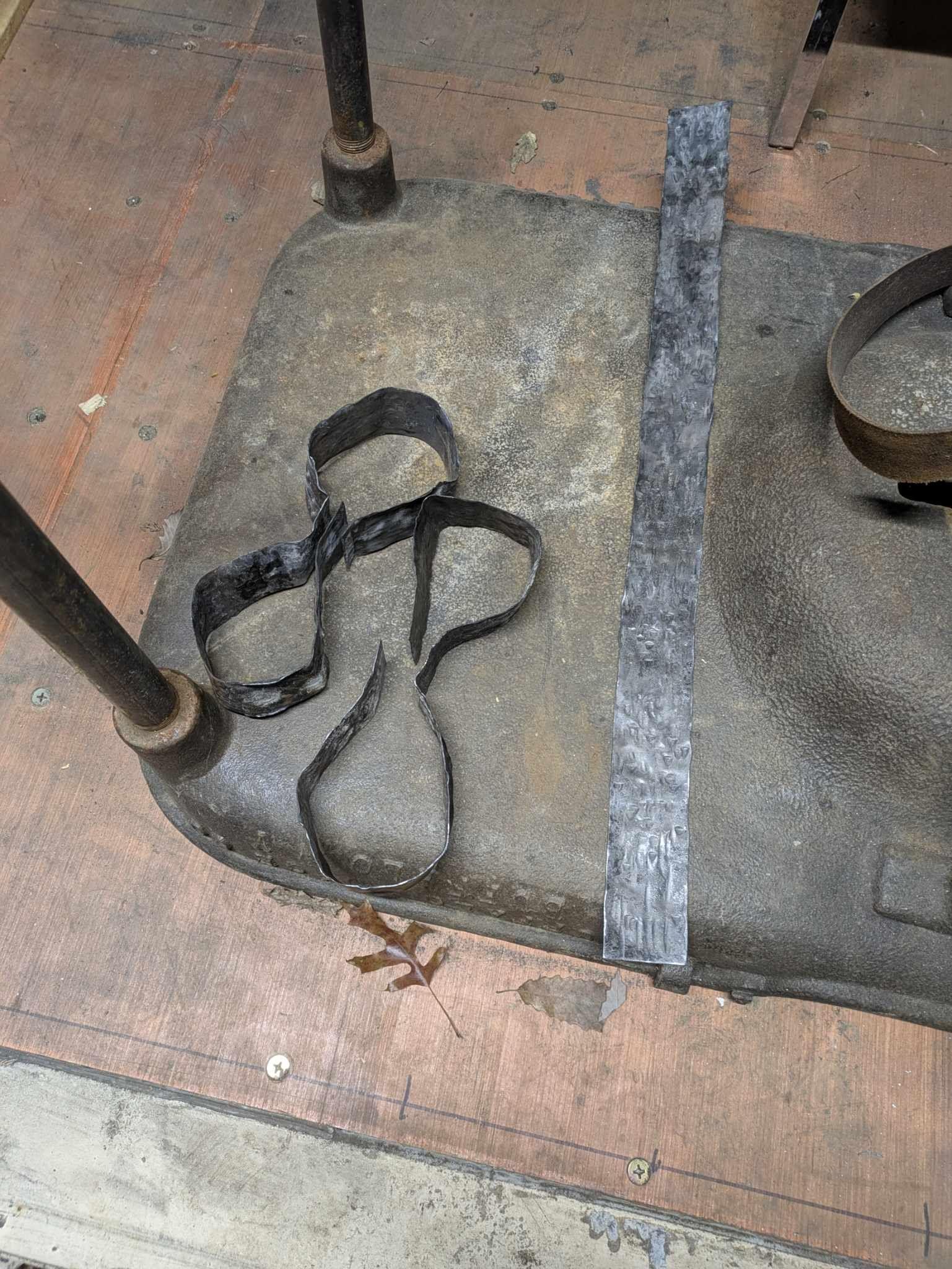

I formed two of the strips into a circle which was then pinched to meet in the center.
received_558159276830550.thumb.jpeg.d7ff2e18efef43245888fac1853447c6.jpegreceived_1208633890205712.thumb.jpeg.8deeb59b7150941036616d941cb8790d.jpeg
I intersected the two loops to look like a bow.
I rolled the tails at one end where they'd be coming out of the bow and tucked them into the loops.
My original plan was to make a center button from a piece of steel, forming a tenon from it which would go through all the layers and rivet on the backside. But it looked out of place with the sheet metal so instead, I folded another piece of textured strip to look like the button.
But now I need to figure out how to connect them all together. I have another idea which will toss the current button. We'll see.
Next steps will be adding some ribbon-like folds to the bow loops, then cleaning each piece and attaching them all together.
This was originally intended for a trade item at the December BAM meeting but I had a conflicting event come up so now it's going to be a decoration for our front porch.
That is a fine looking ribbon. I would think a small rivet through the button to the back of the ribbon would work. Are you planning to paint it or leave it clear coated?

I haven't decided yet. I figured I'd get it done up to that point and then show Ashley and ask what she wanted.
Good Morning Shain,
A tiny LED light in the center. Put a button in your pocket to activate. Morse Code??
It looks wonderful. Time to 'Tye one On'. LOL
Neil
I like the idea of lights! We have a small strand of battery powered fairy lights. No remote for morse code, lol, but would still look nice.

Jeez almighty, those pies are realistic. 5160?  1095? Looks like the heat treat went well. We did butternut here, with an old school custard type pecan pie instead of Karo, with baked meringue. Youse guys got me hooked on Tasting History.
Love the ribbon. Looks fantastic, especially with the button, but why not vinegar for the zinc? They're a bit long for the tub, but you could always bend them since they're getting forged anyways, and no respirator needed.
I didn't think vinegar would cut through the paint, which is probably either enamel or powder coating. If it will, then I'll definitely go that route for anything else I make from those panels. I actually have a trough of sorts that I made using PVC for the frame, and legs to raise it about 2 inches off the floor and a tri-folded tarp as the basin. I used clamps to hold the tarp to the frame. It's currently about 4ft long by 8 inches wide but it can easily be reconfigured to any size.
You didn't strip the paint BEFORE putting it in the fire!?!! :o BAD Shaina, Bad girl! Zinc isn't the only thing that has a yellow oxide and many are more dangerous. If you must burn paint off stock do it away and down wind from people and livestock. Zinc oxide is water soluble and pretty non-toxic. Any that settles in the trees, grass, etc. will dissolve in the next rainfall and enrich the soil. What causes blue flue is the shape of the zinc oxide smoke particles, they form long sharp barbs that penetrate the aviola in your lungs. They don't dislodge so your body must dissolve them which produces a couple daughter compounds that can make you sick, even kill in excess.
Sanding it off is almost worse, metallic zinc is NOT water soluble so is hard for your body to flush and expel. The same thing that makes zincs good sacrificial rust preventors on boats causes problems in our body. We survive by inhaling air and exchanging CO2 for oxygen in our lungs. If you dust your lungs with a metal that has a greater affinity for oxidizing that the iron in our hemoglobin the zinc converts to zinc oxide that must be flushed and dissolved to expel. What makes this less traumatic than breathing zinc oxide smoke is metallic zinc doesn't form the barbs that zinc smoke does. Not as bad but still not good at all.

I would guess that those are powder coated and not zinc plated. The yellow color is provably from something in the powder coat, could be zinc in it.
Powder coating can be a real PITA to get off. But then it is made to last. So i personally would have just paid the exorbitant price the box stores want for sheet rather than clean off the powder coat. Time is money, time is a commodity, time is the only thing that we can never get back. That is why i usually will buy new steel now rather than try and reuse salvaged steel. In the time it takes to clean it up, resize it or what ever it usually comes out as equal cost wise. And even if it is not a project i am getting paid on those couple hours i could spend with the grandkids rather than cleaning off powder coat.

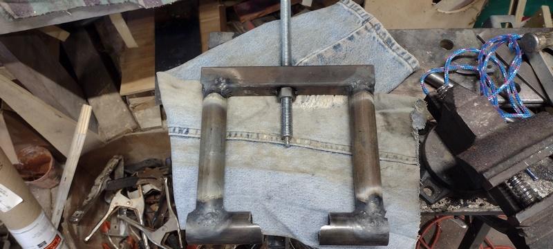

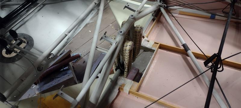

I've been busy on a project in the shop that has used up almost every available minute of my free time. So no working at the forge. But I have been working with metal.   I needed a tool to install the four bungee cords on the Taylorcraft project. So, I could either buy one $150, or make one.  I elected to make one. I had everything I needed in the scrap iron pile. It's a mix of mild steel, and 4130.  Worked just fine.
Yes, the two verticals are galvanized, But I do all my welding outside, and the wind was 18 gusting to 30, so I didn't think it too much of a problem.  It was fun welding it together. The top piece is ~3/16" thick, the two bottom pieces are 1/8" thick, and the two galvanized tubes are mabe .030" at the most.  Used a #2 torch tip, and 1/8" rod.
Here's the bungees installed

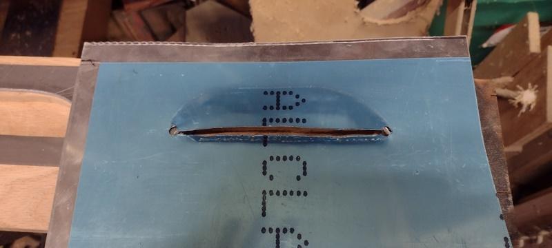

On to the next project. I need to punch four louvers in a sheet of .032" 2024T3 aluminum.  So today I made a bottom die to allow me to punch two at a time. The "top die" is a 1x4 hardwood block with a 1/2" radius along one edge. To be smacked with a hammer.  Here's the bottom die:
And a scrap to "test drive" it.
 I need to rework (make another) the top die. but I think it will work fine.

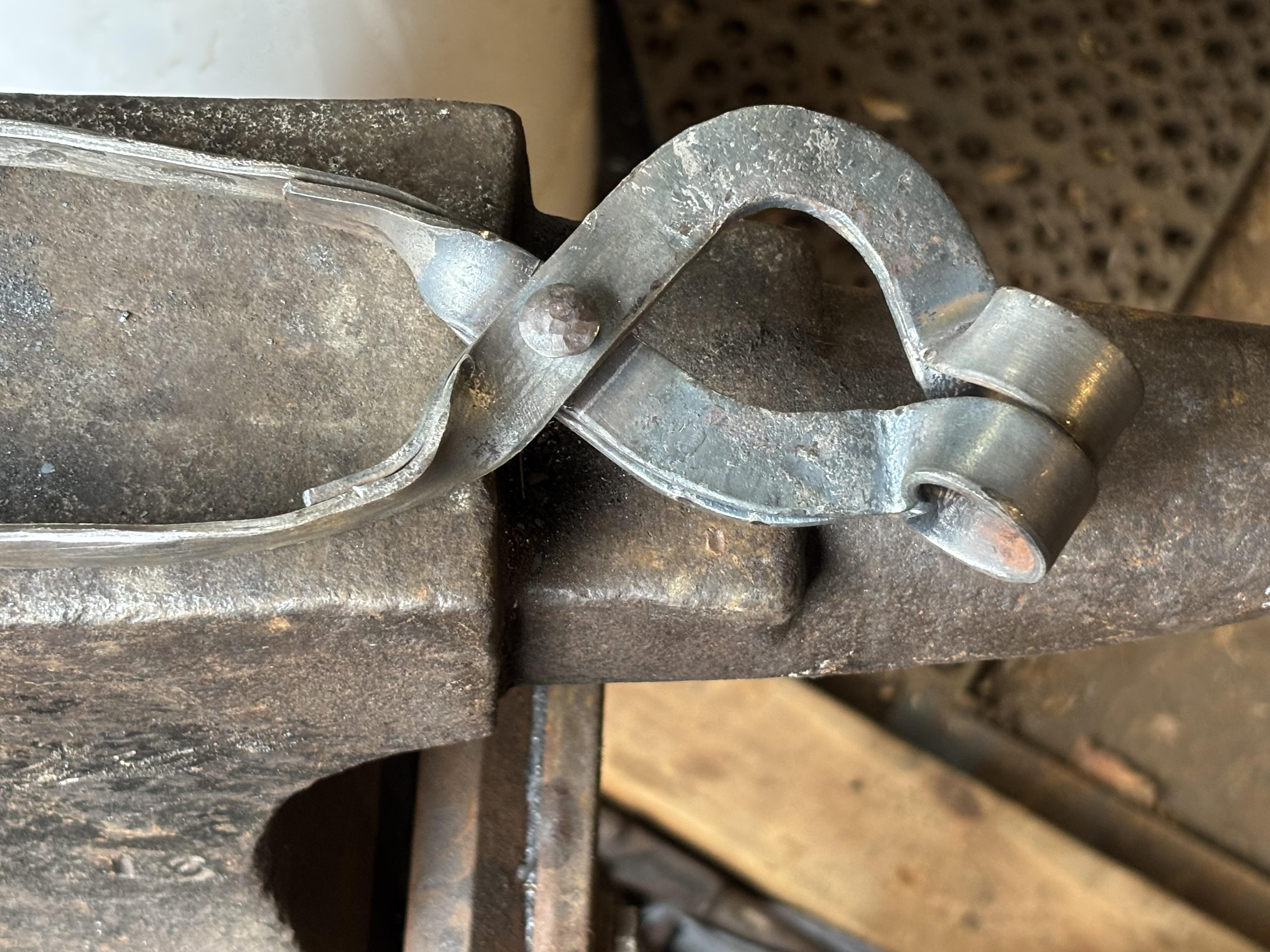

Made an experimental pair of tongs, for holding bowls and other similar forms.
For a full description, see THIS LINK.

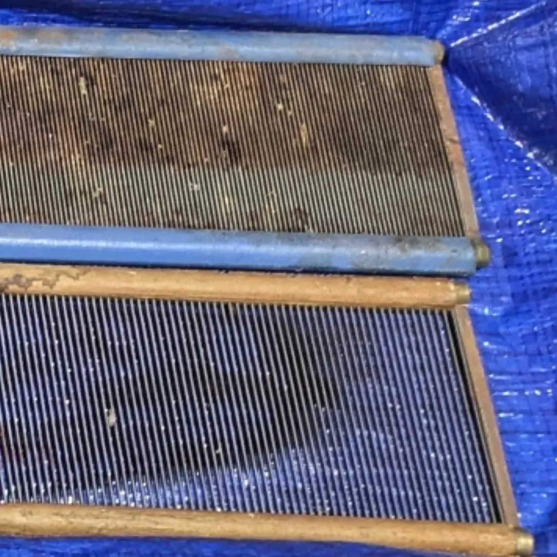

Today I finished a long overdue gift to a great friend. She technically already received it but it wasn't on a base yet and came back home with me, lol

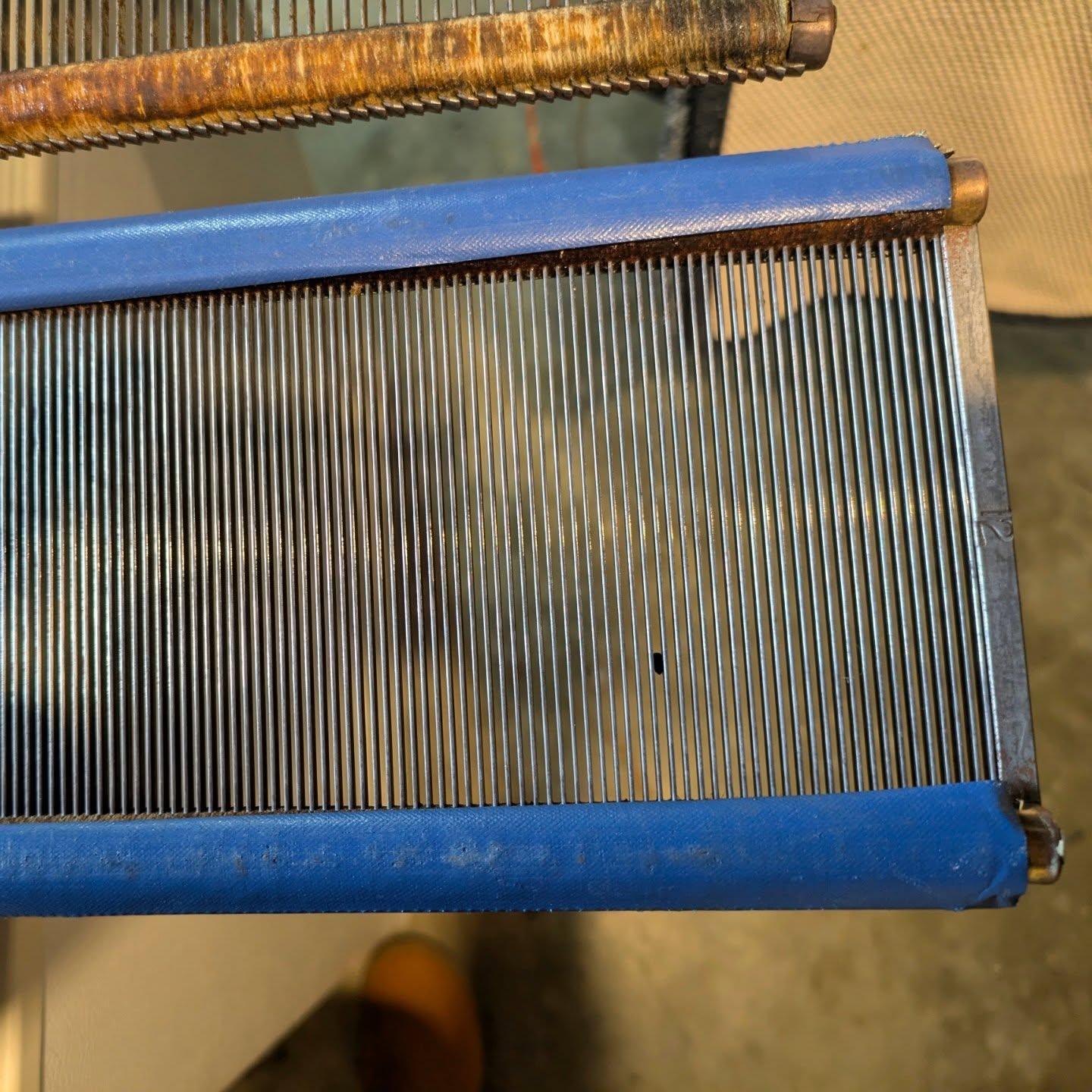

I also finally got around to getting the rust & crud off the reeds of the floor loom Ashley bought from someone who had it stored in the loft of their shed. That recipe that John (I think?) shared on here worked splendidly.
Before:
469004233_18474342277057039_6903772519822520847_n.thumb.jpg.53dbf81b0c2fdaec04d07c3517ea3fdb.jpg
After:
468851665_18474342286057039_796999913377994884_n.thumb.jpg.e8d5dbd8d3ed10dfe0f03eee09b2abbb.jpg469004241_18474342301057039_2101705937034813619_n.thumb.jpg.386132220bb0fe07952f179c3e283acd.jpg

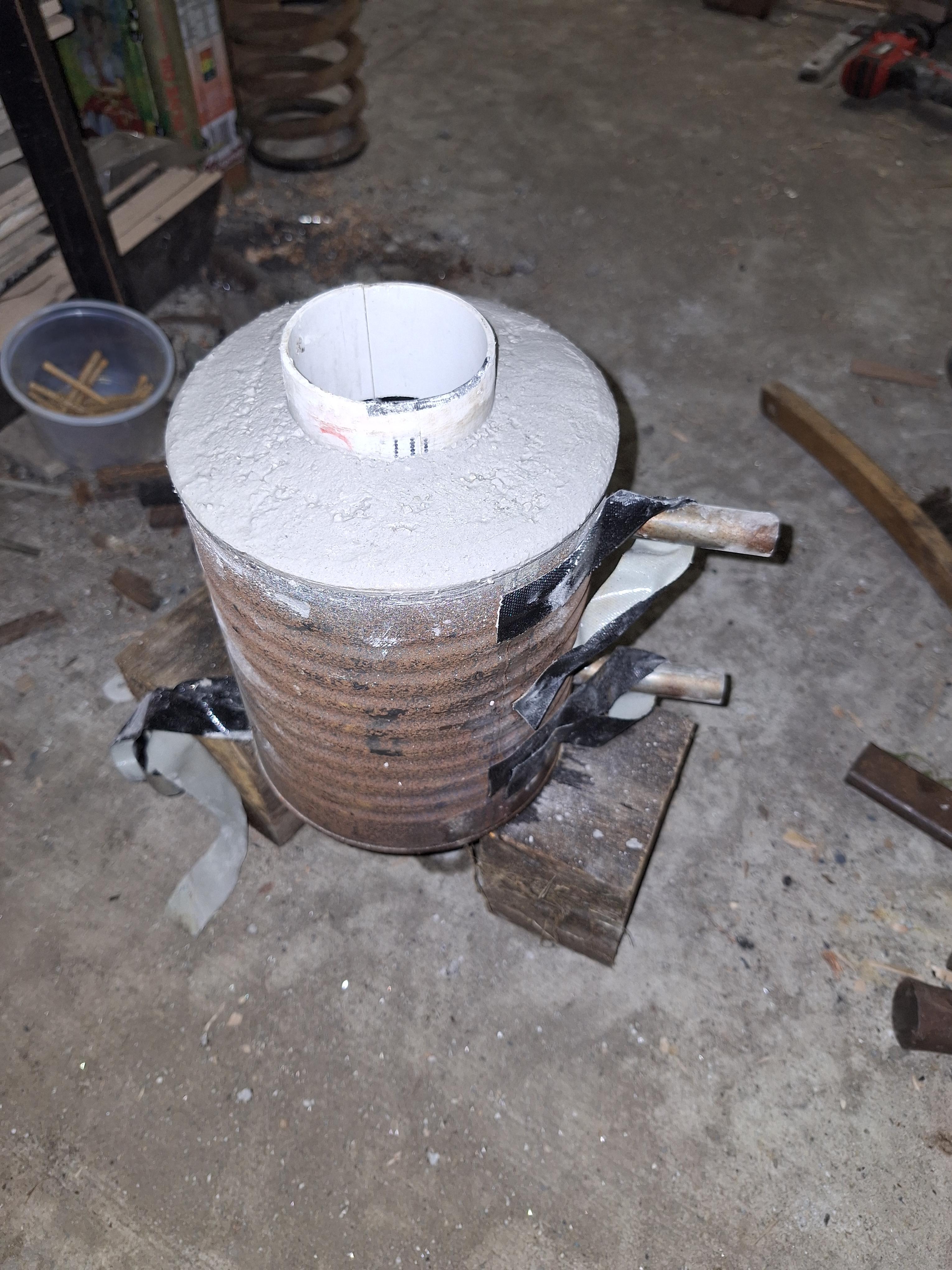

Quick afternoon session. I cast a coffee can forge out of castable refractory and perlite, as per Mikey's instructions in the Forges 101 thread:
We'll see how it turns out in a couple of days.
